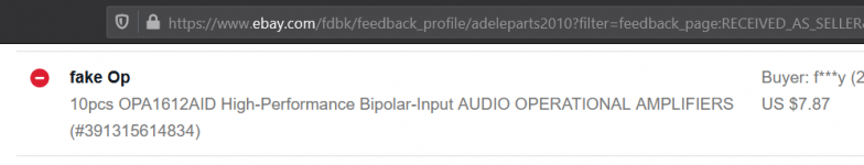

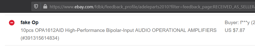

See the attached feedback report from the same seller.

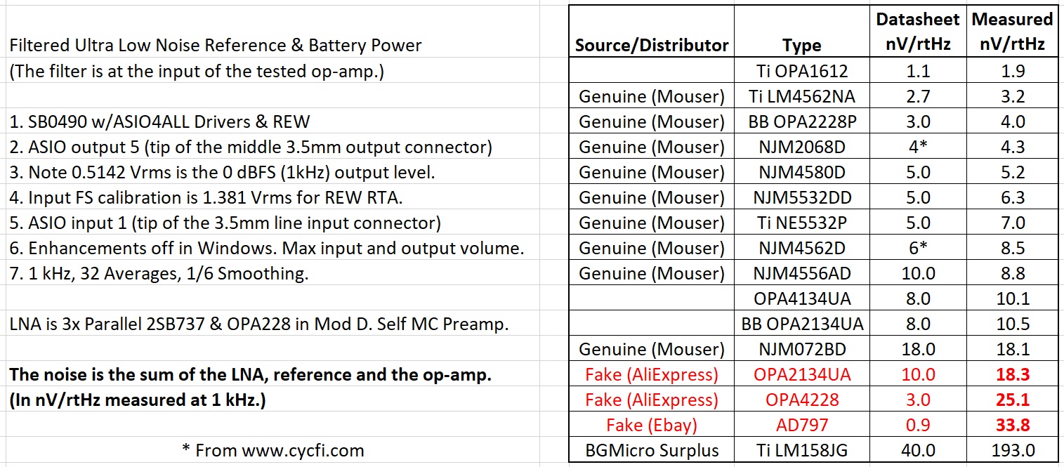

I measured the noise (sum of op-amp, LNA and heavily filtered ultra low noise reference) of a variety of op-amps today include the fake AD797.
The fake AD797 measured 33.8 nV/rtHz while the data sheet is 0.9 nV/rtHz. Thousands of these were sold by AdeleParts2010.
In my test setup the sum of OPA1612, LNA and heavily filtered ultra low noise reference measured 1.9 nV/rtHz.
