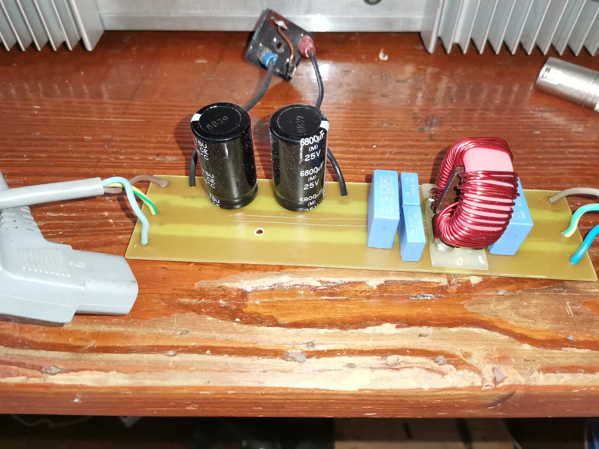

I need to go out soon, for sake of argument I quickly connected this, this is definetly DC filter + rF filter, no change in buzz. Still it's very small, but hear able. That's without speakers, just trafos.

Buzzing with no load and no DC.for sake of argument I quickly connected this, this is definetly DC filter + rF filter, no change in buzz.

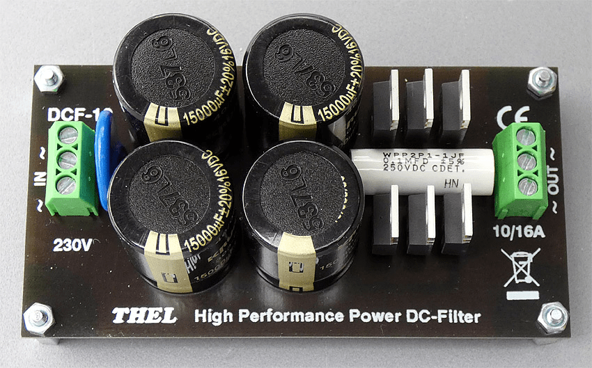

If the DC is higher than the diode voltage, it will still buzz. that is why some use two or more diodes, not only one.
This from https://www.thel-audioworld.de/module/Netzfilter/DCF-10.jpg is an example to block 2 Volt, not only 0.7V
https://www.thel-audioworld.de/module/Netzfilter/DC-Filter.htm

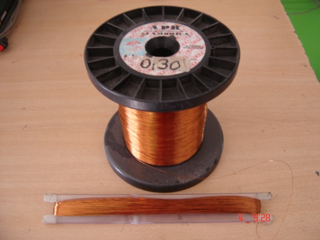

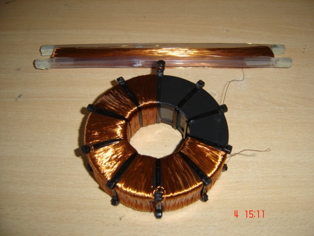

I made my own toros rewinding the secondaries from 220 to 12VAC , most owned from discarded industrial electrical apparatus or for lightning from archaic bi-pin bulbs. Most of them used for power tube amplifiers and output stages. They really perform quite well. At first attempt, I had the doubth about the induction B, and some manufaturers use as high as 1.7T.
One of 50W was my first blown transformer. I made two secondaries bifilar winding with 0.15mm enamel wire for my AM tube tuner. Suddlenly the receiver muted and the traffo got very hot. The fuse didn't blown. I unwind the traffo and discovered melted HV winding. So I made a test setup to measure insulating capabilities and discover that at 500VAC the insulation fail. I Try another (better quality) wire 0.18mm and rewound it again. It's currently performing OK.

Your DC blocker from post #23 is good for 1.2 V. I would measure DC value first.
