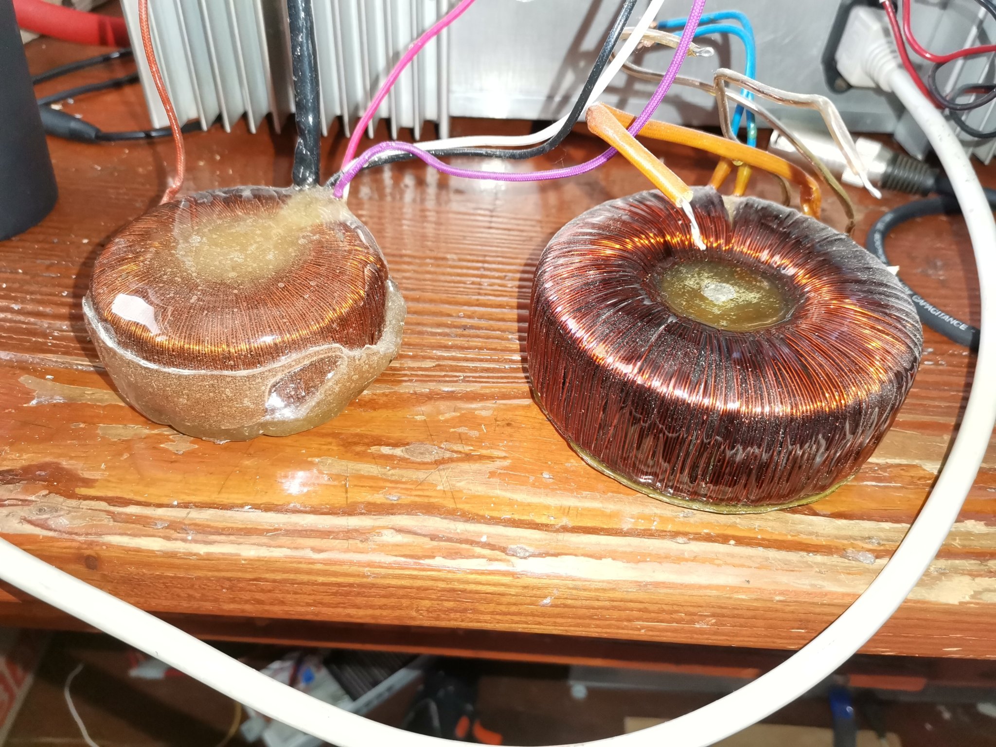

I was ordering my trafos with 20% oversized core, vacuum varnished several times (once for core, for primary and then for secondary).. This reduces buzz to minimum, but it's still there. Nevertheless it's much better than all commercial audio trafos I have bought.
This is OCD issue, with slightest music it's not hear able, but hate the buzz....
I tried DC blocker at mains input, no difference where I live.
I also sealed many trafos in epoxy,and this is very liquid epoxy with 24 hrs settling time, this penetrates deep, first I removed outside wrapping. This also helps, but still it's not zero buzz. Here are examples
Then we have commercial Amp Trafos, mostly EI core welded on corners, and the buzz is even lover than with crazy effort I put in toroids, what's the catch?

The same question, buzzing toroids, has been asked in this forum many times - all in different words. If you search publications, there seems to be contradictions and can be not totally accurate.
Core size is irrelevant to emitted noise, and its possible cores with a larger mass have the capability to be louder! In theory and books, a lacquered core is supposed to attenuate noise. In reality,
I have never found that to be an effective solution, and in fact vacuum varnishing degrades the properties of the core. The last stage in producing a toroidal core is annealing, where they run it through a furnace for 12 - 16 hours to remove stresses in the magnetic steel. Then if the core is varnished, that will re introduce some of the stresses removed in annealing.
If the noise changes daily, thats a reflection on the condition of the ever changing mains.
The best solution I believe is a simple DC blocking circuit. I know for a fact that many high end audio and video companies incorporate this in their products, so it has been extensively proven in the field and is invisible to the quality of the product. Then you have ALL of the advantages of a toroid - which are significant - with zero noise.
