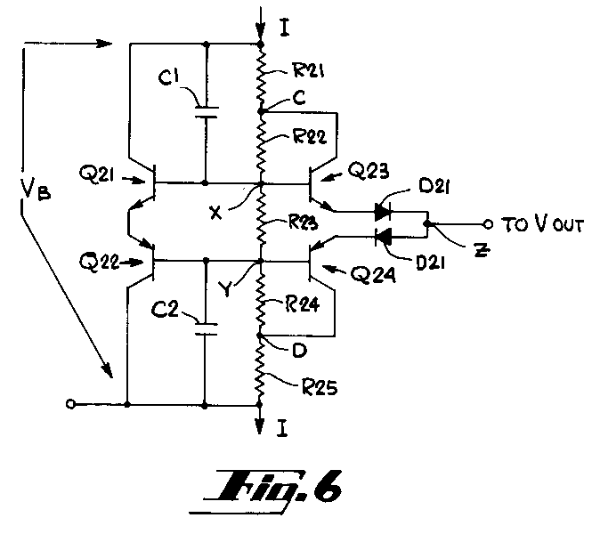

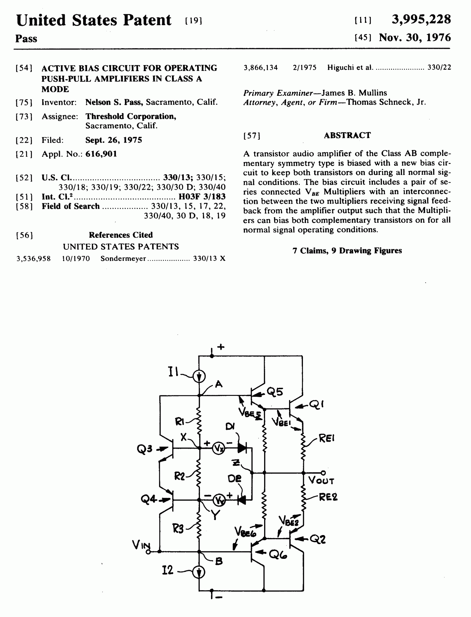

Perhaps this is of interest.

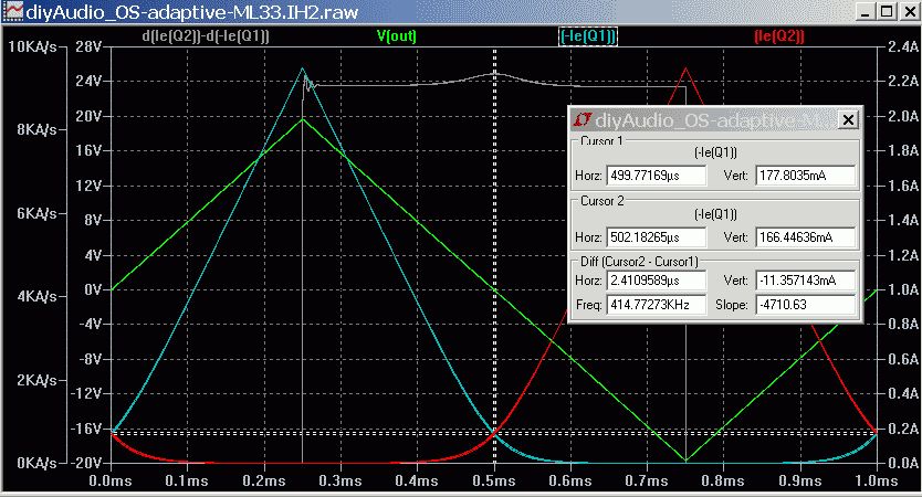

Hans Polak shared ML33 adaptive bias in The Black Hole... #8472. Seems operable without thermal compensation and simpler than #167.
Here's what I found in the ML33.
There is a significant change in bias current when the temperature of the power transistors heat up. Going from 27C to 77C the idle current changes from 100mA (my choice) to 232mA, see plot below, and still needs thermal feedback to stabilize the idle current.
(I chose 100mA by changing P1 to 33k - I wanted to see if there was an optimum bias, where the crossover gain wobble dipped down, white plot, but it doesn't, instead the bias loop breaks up (at high swing) if the idle current goes under 90mA).
There is an increase in bias current when the temperature of the power transistors heat up because the power transistor b-e junction is outside the bias loop Q3,Q4,M1,M2,D1,D2. The ML33 is similar to the Tanaka AES 3/81 circuit - the main operational difference being D1,D1 carry most of the current of M1 and M2 and bias adjustment uses P1 on the bases of Q3,Q4. The Tanaka also has the power transistor b-e junction outside the bias loop and therefore needs thermal feedback to stabilize the idle current.
However, if the ambient temperature is increased and the power transistors also increase by the same ambient change, then there is a very slight drop in idle current of 1mA for a 10C ambient increase
The attached file includes MOSFET models with tempco's. Notice the MOSFETs are inside the bias loop so they are not sensitive to their temperature changes.

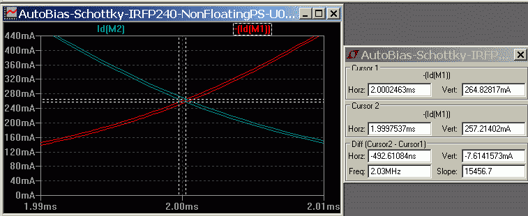

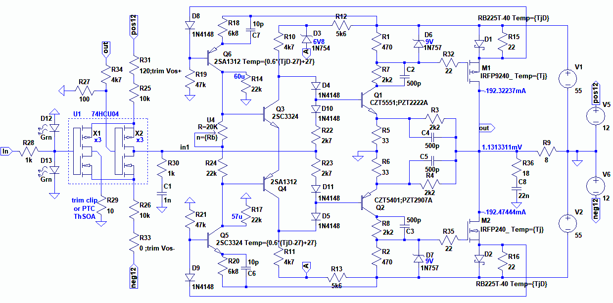

Hi Ed,
Here's a way to make it autobias with a non-floating power supply:

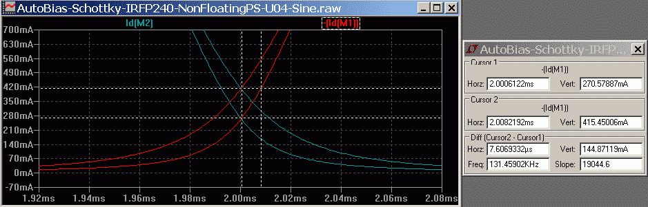

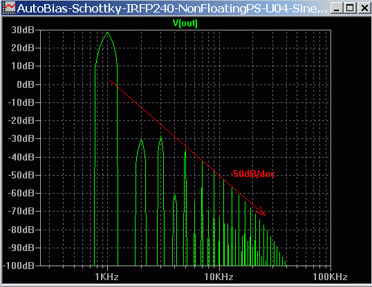

The Schottky diodes are now connected to the rails, with Q6,Q7 as shifting their voltages to autobias transistors Q3,Q4. The output stage gain from 'in1' is about 50. The input stage has a gain of about 10 for extra feedback and soft clip. The FFT for 100W below:
3rd harmonic is -60dB which is I find inaudible, and with -50dB/decade roll off the higher harmonics are falling fast enough to remain inaudible. What I have found more significant than harmonic distortion levels below these is for the power amp to have soft clipping and clean recovery.
An additional benefit of this input stage is the clip level can be reduced by increasing R29, eg with a PTC thermistor, which can allow heatsink over-temperature dynamic limiting without shutting down altogether and making a very robust amplifier. The clip is shown below:
Clip is setup here to begins at 200W peak (100W average) and is nice and rounded above 100W. The amount of feedback in the output stage determines the start point for this clip, set by R3,R4.
As for thermal effects of bias shift from using Schottky diodes for sensing the output stage current, this can be cancelled by thermal linkage of D1 to Q6 also D2 to Q5. The plot below shows no linkage and then with linking both for a 10 deg.C change in diode temperature:

Ian, have you already explained why you prefer generic small signal transistor models (e.g. "Q3 NPN" , "Q4 PNP") rather than fitted-from-measuring-real-devices-in-real-life models ("2N5551C" , "2N5401C") such as the ones Bob Cordell has lovingly created (here)? Would you please mention the post # that discuss this? Thank you!!

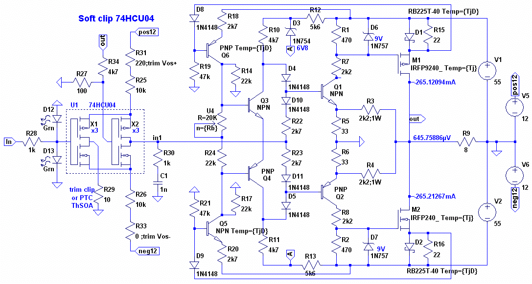

Hi Mark,
My bad:oops:. Well spotted! It was a shortcut to save a few minutes. I was aware of it when posting but assumed most of the character of the circuit is due to the MOSFETs and not the BJT's. The MOSFETs are fully characterised models. I will get some real BJT models in next. BTW I have been using SMD PZT2222A/PZT2907A with 2SC3324/2SA1312 for the flea power ones (since they are on hand) for my other (floating supply) autobias build.
Hi Mark,
Here's the circuit with real BJT models (eg CZT5551/5401 for above 40V rails):
It requires phase advance capacitors to stop it oscillating with real BJT models, since there are extra HF nodes compared to my generic BJT models. Bench tests are needed to see if it can be stabilized in practice. So I prefer the floating supply version for this reason - it doesn't oscillate on the bench without adding capacitors. So it's a trade-off between a non-floating PS for convenience and floating PS with simplicity and stability.
Perhaps a better option is shown here? https://www.diyaudio.com/community/...other-rail-to-rail-output.325128/post-5491858 with less HF nodes.
Cheers, IanH

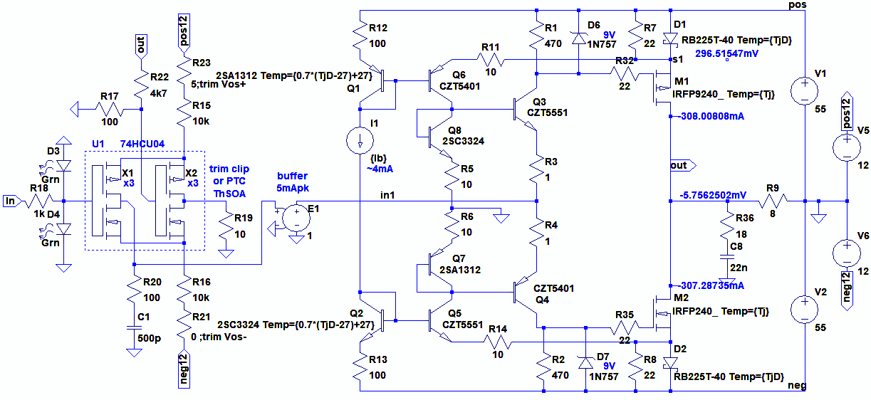

I couldn't get the circuit in the link to work as autobias, so I modified it, then added the soft clip input stage:
The distortion is about the same as the previous one but the bw is about 10 times higher (due to higher currents in the autobias loop). So a buffer is needed with the U04 array to drive 5mA peak since a U04 gives 1mA peak. Alt, a pair of FDC6320's could give the 5mA without a buffer but it is now EOL, so the FDC6321 can be used. Thermal feedback from the Schottkys is to Q1,Q2.
