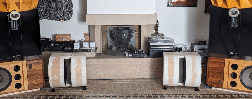

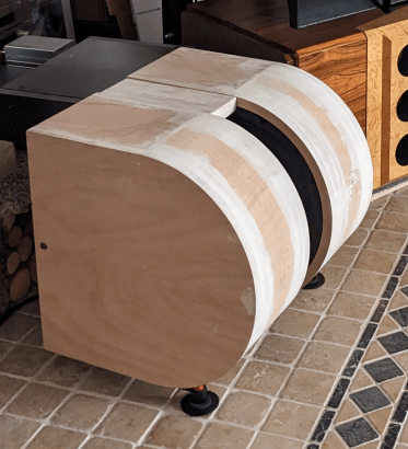

Very nice ripole sub! Are these 15" drivers? I'm also fascinated by the ripole principle. Has anybody built a 21" ripole yet?
Oh no : mine is a 2x12", using BEYMA 12BR70 speakers.
A friend of mine has built a 2x18" ripole, based on the more classic design with parallel faces speakers, and no embarked sub module nor slanted internal panels :
The Ripole - invented by Mr Axel Ridtahler, a German Audio Engineer - is very interesting by the fact that it can provide deep, natural, floating infra bass extension. The impulsional response is excellent and well-damped, without boxy / boomy tones, and all this in a very compact format, without servo or active correction.
As a side note, the Ripole is the perfect infra-bass addition for panel/flat speakers like Martin-Logan or Magnepan (below). We know that marrying a bass bin with flat speakers is problematic : I experienced this... The Ripole is the ultimate weapon here - at least for me !
Of course, the Ripole has some inconveniences : the efficiency is quite low, so you need large Xmax speakers to allow power. The placement can't be against a wall or in a corner : it must be placed centered between the two speakers at some distance from the wall to allow the back ports to play their role.
For music playing, the Ripole is an excellent alternative for pure, extended infra-bass in a compact size - assuming you can place it as required (above).
For Home-Theater, the requirements are different IMHO, notably in power handling and loudness over the bass quality, and I am not sure that a Ripole is the best choice, then...
That said, I have no experience about Home-Theater... Only Music.

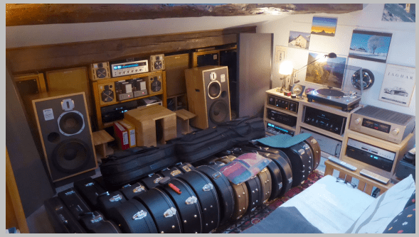

@profiguy : by my personal experience, that is to say :
- using the Ripole as an infra-bass extension occuring below the natural cut-off of my speakers.
Then the frequency cut-off is to be set between 40 to 60Hz, with a 12 or 24dB/Oct slope. In this setting range, the Ripole operates satisfactorily.
Now - and unlike me - if you cut suitably (by an additional high-pass crossover) your speakers, then you can possibly reach FC = 80Hz, but I personally would not go over - below why :
The Ripole cavities show a resonance located between 200 and 400Hz usually, depending on the geometry and the size of the construction. Indeed, you must stay way below this resonance, otherwise you will obviously obtain an unwanted, muddy, focused high-bass sound and loose the Ripole advantage : that famous floating, deep, enveloping but unobtrusive infra-bass, that other principles of subs provide with great difficulty...
You can have a look to my little, non-business website, for more construction details :
https://guilhemamplification.jimdofree.com/hi-fi-other-projects/
Here are the dimensions of my 2x12" Omega Ripole - a variant on the principle that I devised for integrating a sub module in it. Not sure that all the dimensions are perfectly exact, sorry, but at least, you've got the picture ! ;)

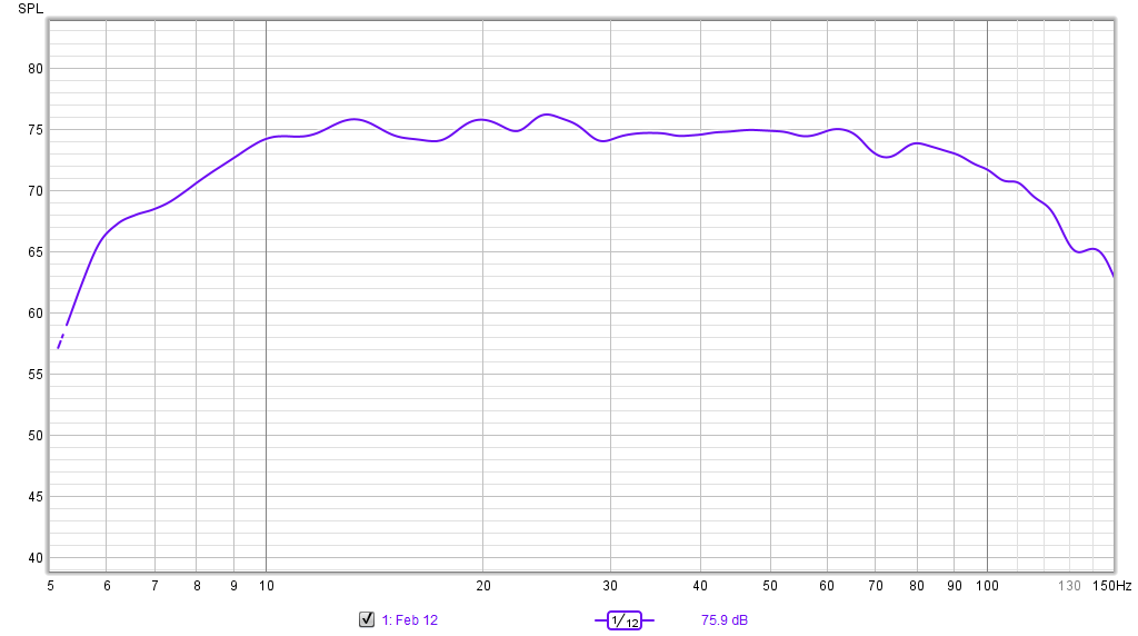

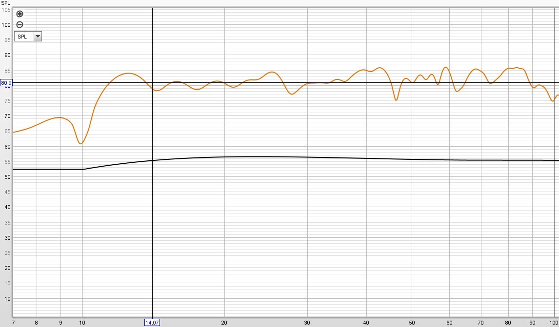

Anyway - here's my Double Bass Array measured in the main listening position, with LPF at 120 Hz :
Question about measurement method: looking at say 10 Hz, is the FR showing the output which is at 10 Hz or is the curve at 10 Hz including output at 20, 40 etc???
No question in my mind or in the contents of the replies preceding, that a 32 Hz organ note has substantial output at 64 Hz. And the 64 Hz output is far more of the sound we experience.

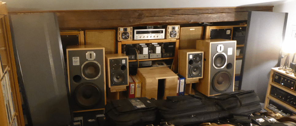

@profiguy : my friend built a pair of 2x18" Ripoles... Just like your idea. He has the room to do so, unlike me !
Unfortunately, I can't tell about the turntable arm resonance and the Ripole, because I have no pertinent experience in that field. I do have a turntable (TECHNICS SL-1200G) but my listening levels are moderated, so the influence between Ripole and arm resonance is irrelevant, moreover if I consider that my main menace is much more the "flex" floor of my little auditorium !
That said, Axel Ridtahler mentions in his Ripole description that the acoustic pressure diagram is a 90° pattern (2x45° from axis) due to the interaction between front and back openings. He states that a turntable placed at left of right of the Ripole will then be less influenced by the infra-bass, due to that peculiar radiation pattern. I think that it is described in one of those articles :
https://www.lautsprechershop.de/hifi/ridtahler_en.htm
https://patents.google.com/patent/DE19830947C2/en

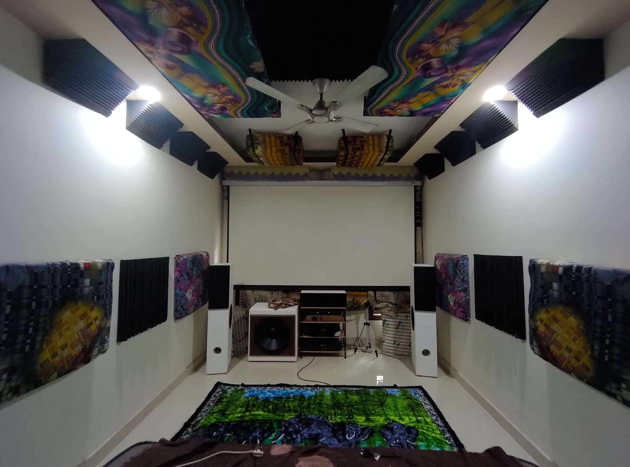

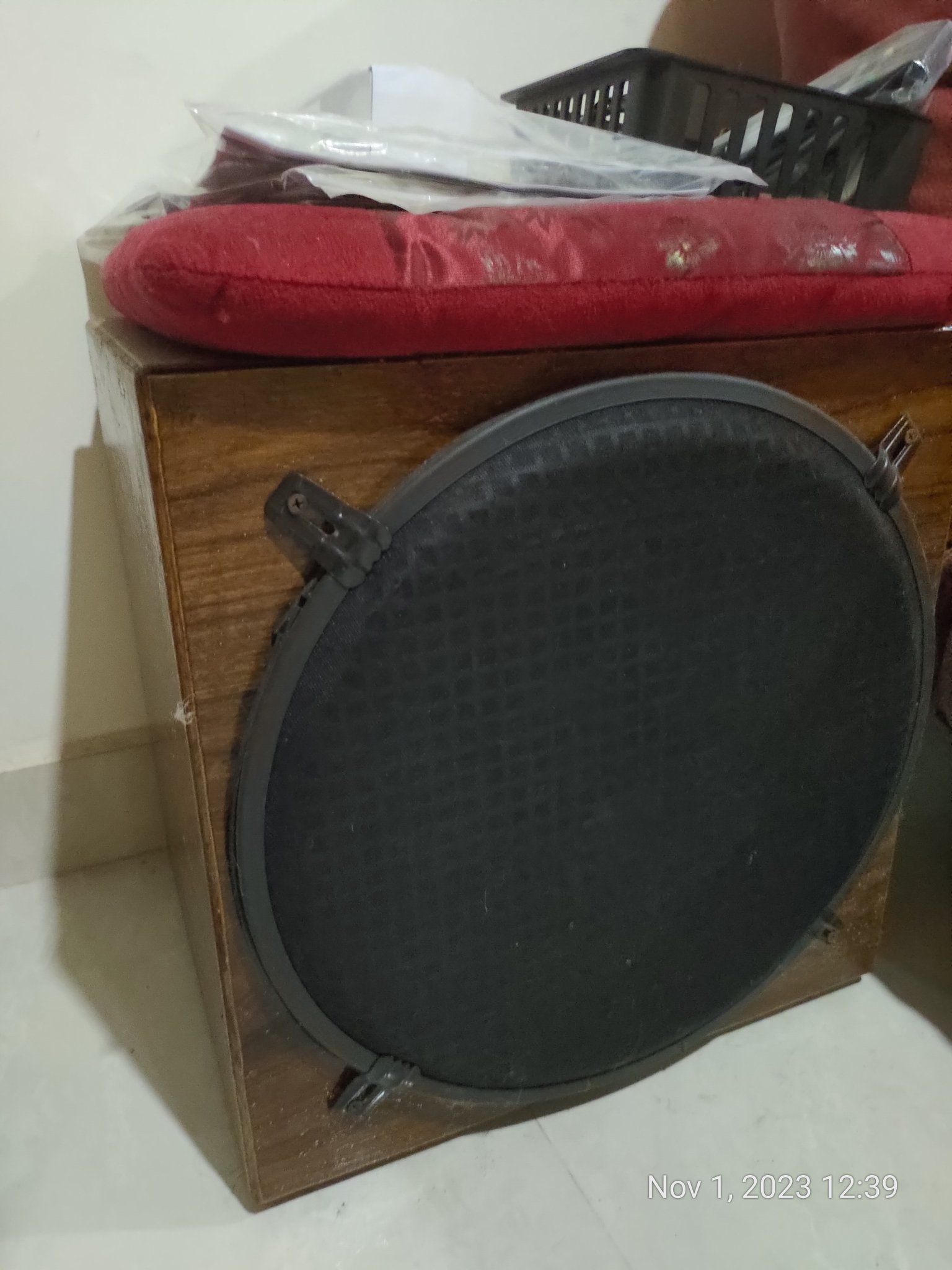

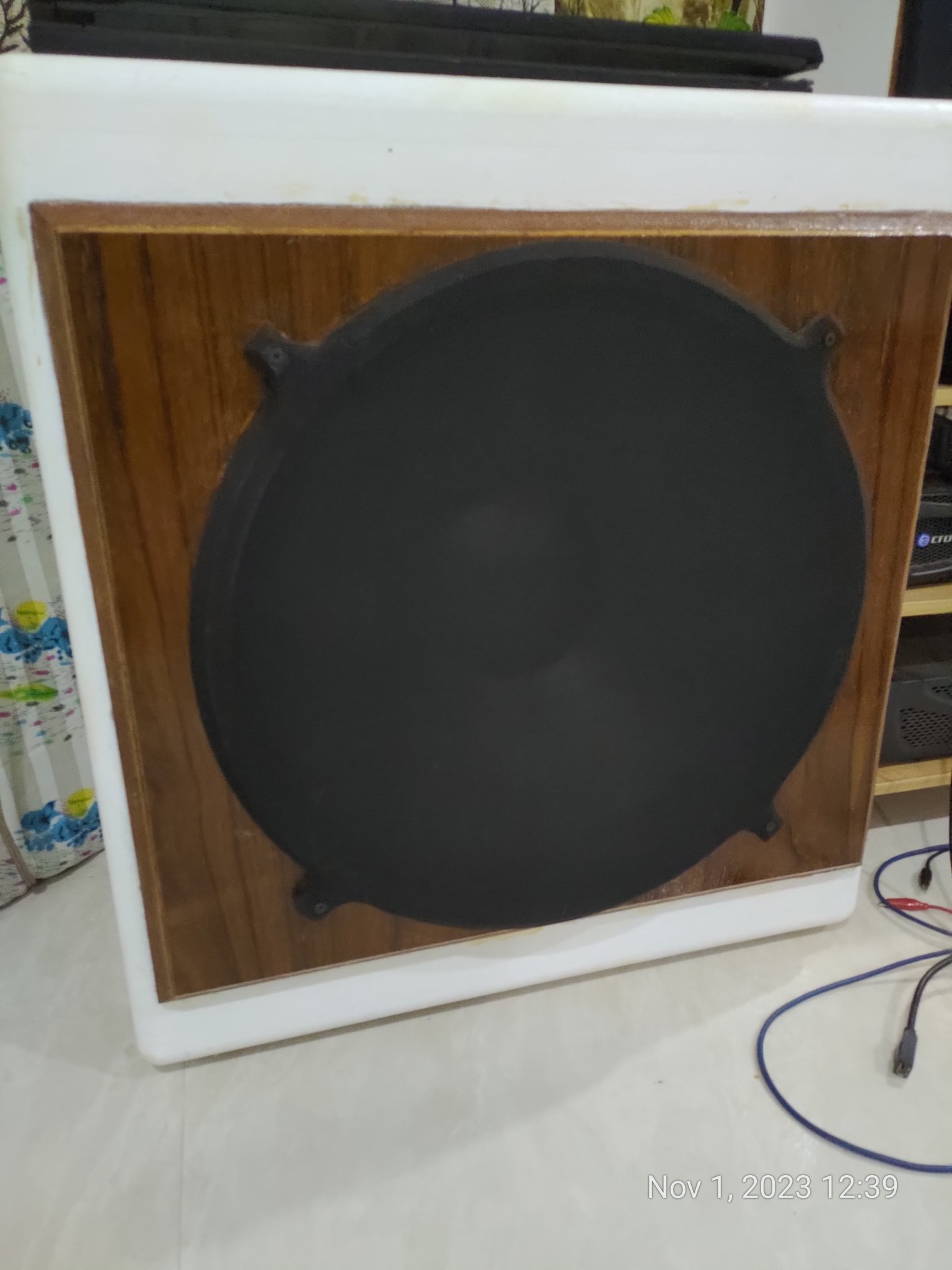

I got the bass I was looking for with going all sealed down to 10hz flat without dsp for both music/ht. Some treatment and minimal analog eq.
4 low freq drivers in total. 2x10inchers, 1x18inch and 1x12 inch subs.
Some improvements can be done below 100hz in time domain. But I am limited with space.
Pics are slightly old as I upgraded now to 5.4.6. Sounds are really immersive now with 6 overheads. I was pleasantly surprised with Auro2D for music at the same time it's not perfect since it messes with bass in a way I don't like.
