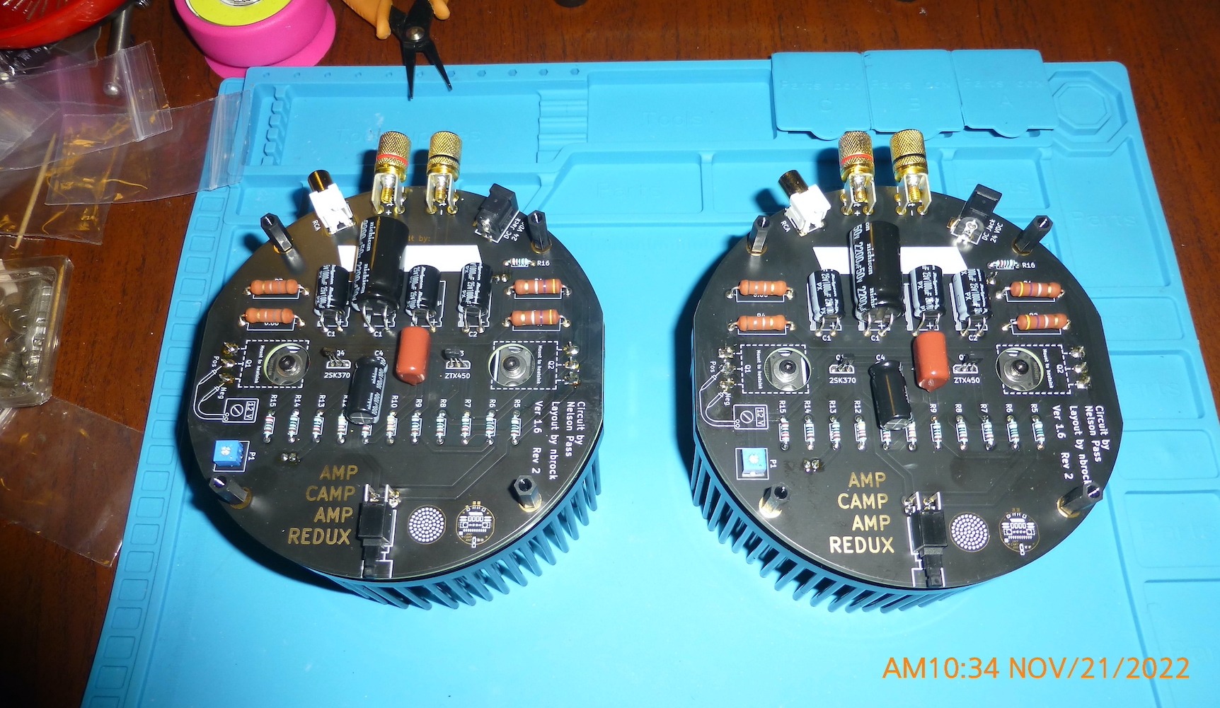

I finished the two boards in my kit on Monday morning, and have been listening since.
The kit was very easy to work with, especially with the guidance provided by the temporary build guild that Nelson Brock posted, plus the existing body of info available on the ACA generally, and Ver. 1.6 in particular.
Based on discussion over in the “ACA with premium parts” thread and that I had a some appropriate parts on hand, I decided to incorporate a few of ideas presented there, particularly those by TungstenAudio. I substituted a 2.2µF/450V Panasonic PP film cap into C3 (input coupling), and a 100µF UHW for C4 (filtering of the 24V PS). I also substituted a 2200µF UHW for the middle of the 3 paralleled 1000µF C1 caps (output), raising the total capacitance at C1 from 3000µF to 4200µF. If any of these prove problematical, they are easily reversible, but so far so good.
Below is a photo of the builds.
I’ve tried the ACA Redux with two different sets of speakers, both in 12’x12’x8’ rooms: Advent OLA and DCM Time Windows. In both cases, the speakers were driven to the top of my listening range with 12 o’clk on the preamp volume control, with no strain apparent.
The “no strain” deserves additional comment. There is something about the two Pass ACA amps I have made, the Mini and this Redux. I experience a calm, a serenity, when I listen to the music I love on them. I don’t know how to describe what it is; perhaps it is a feeling that the music played through them lacks any sense of compression and feels so natural. It is as if there is space around, for example, soloists, quiet space within the sound field. Much of the music I like seems to take on an ethereal quality when played on these amps, and I find it intoxicating.

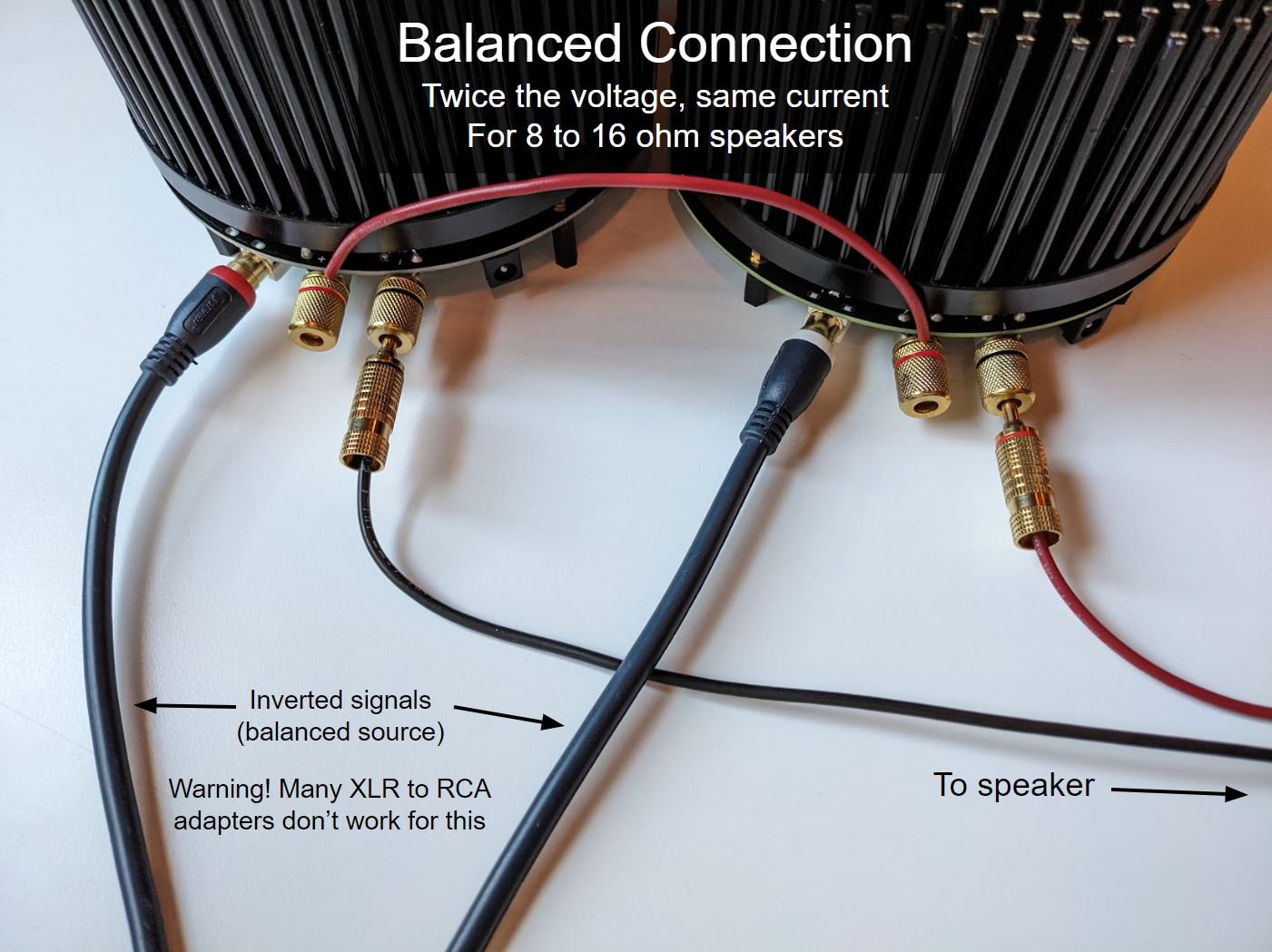

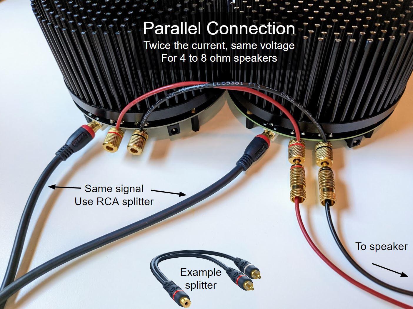

Those familiar with the ACA will know that two channels can be connected to make a single mono channel in a few different ways, each of which increase output power and lower distortion. My monoblock design makes this a bit more difficult compared to the store kit so I've attached a few images to show how the different connections can be made.
