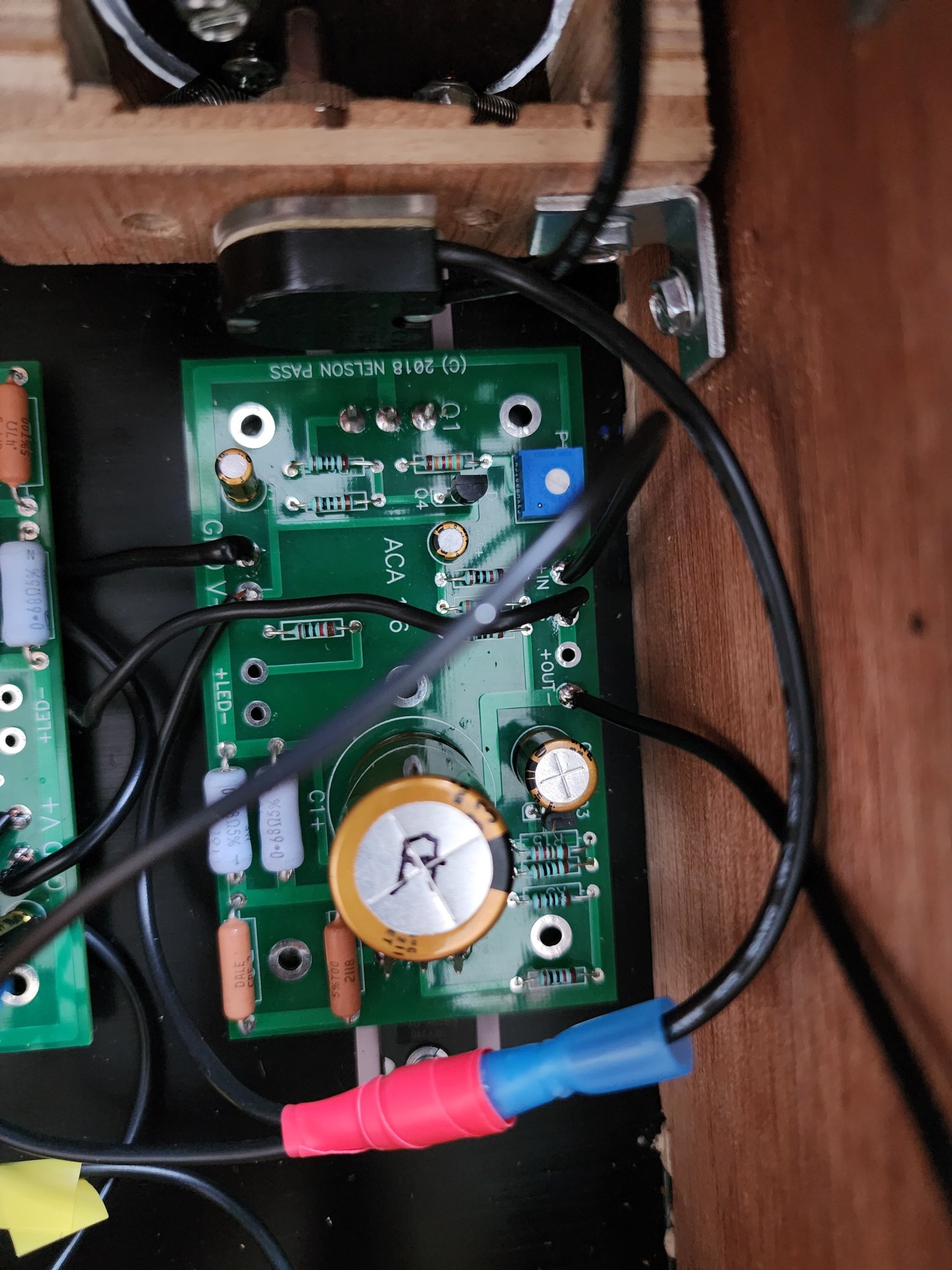

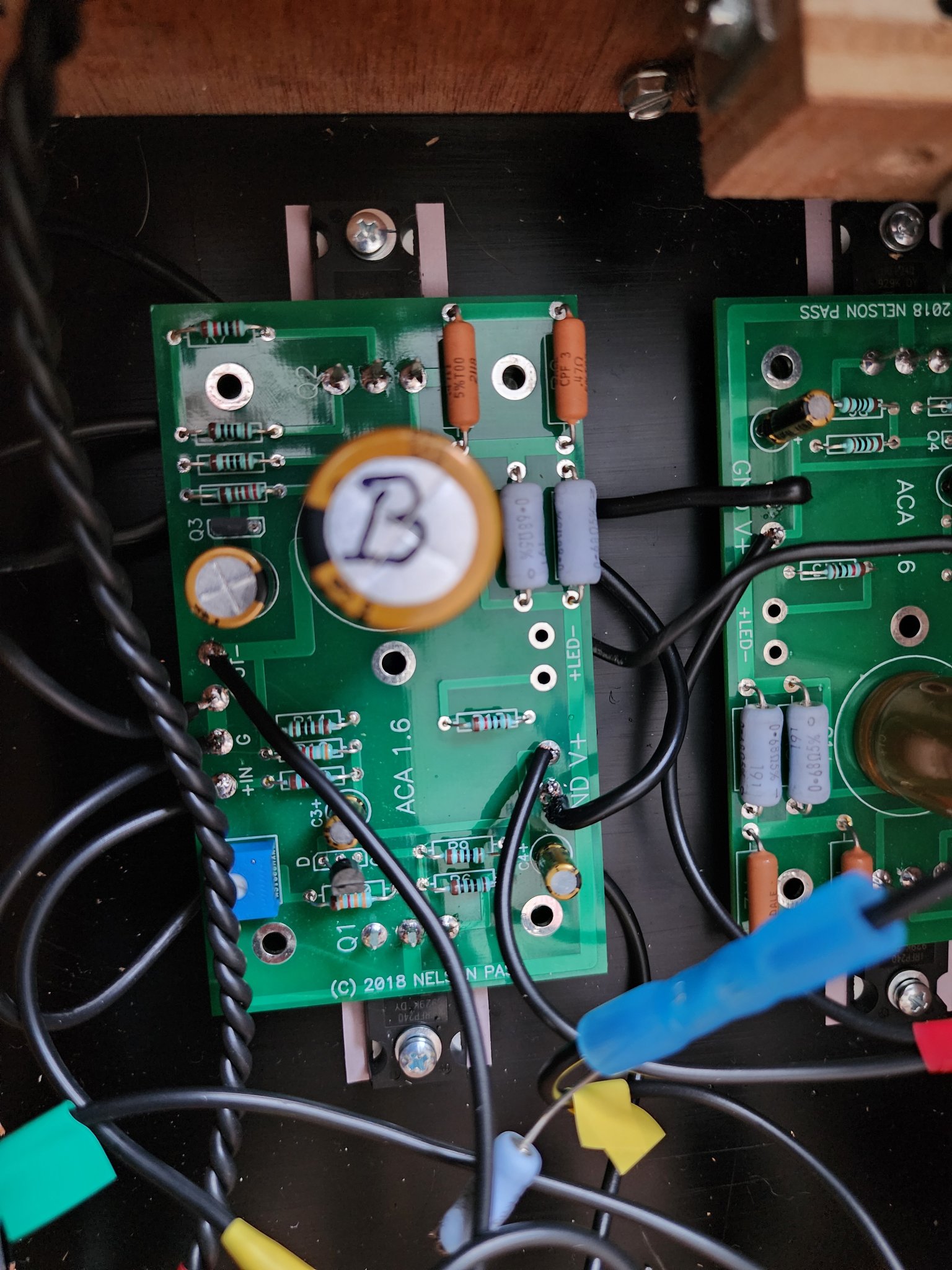

Hello everyone,

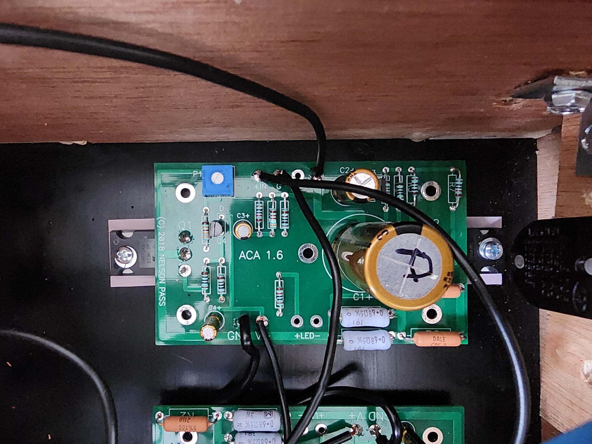

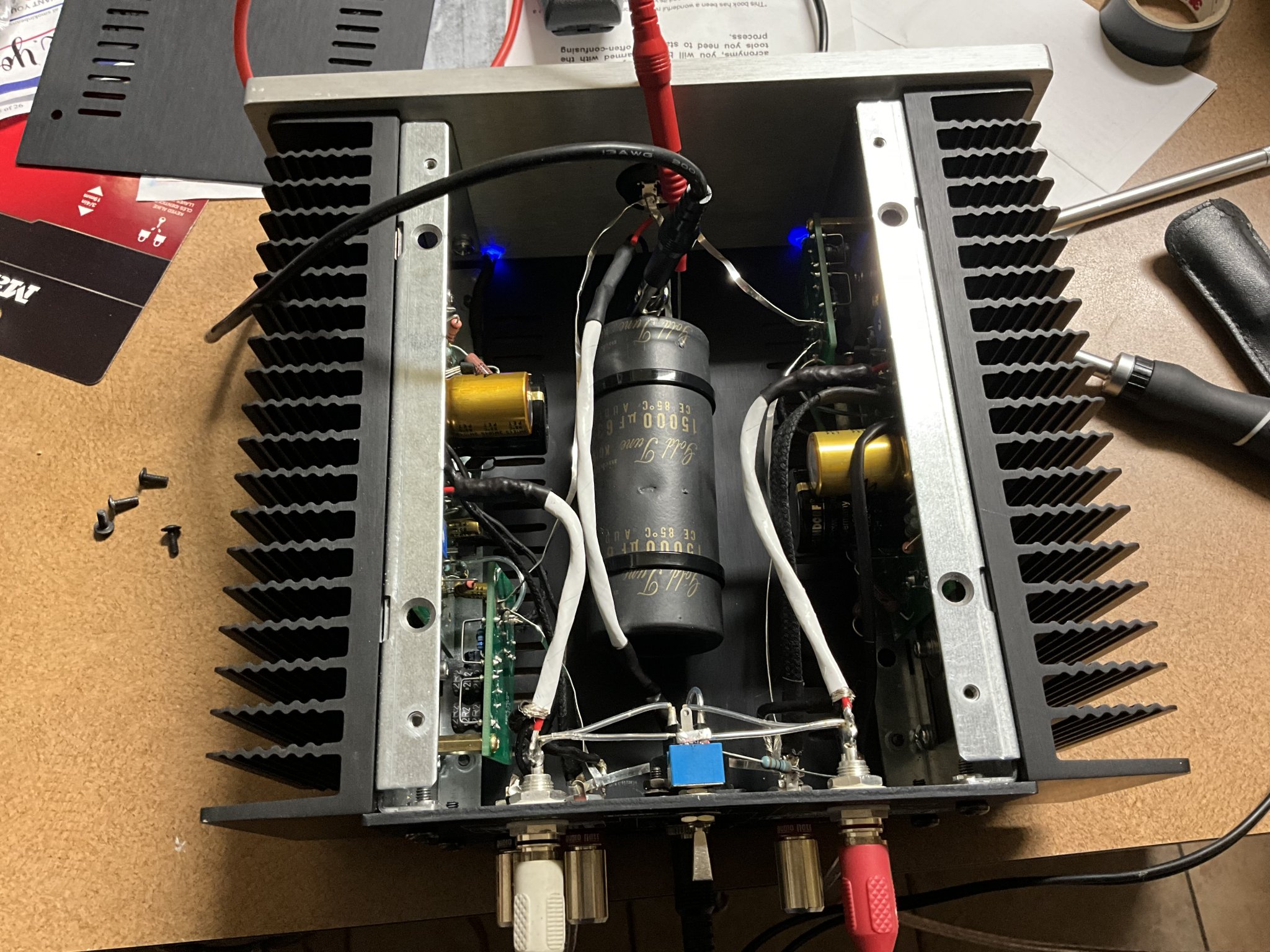

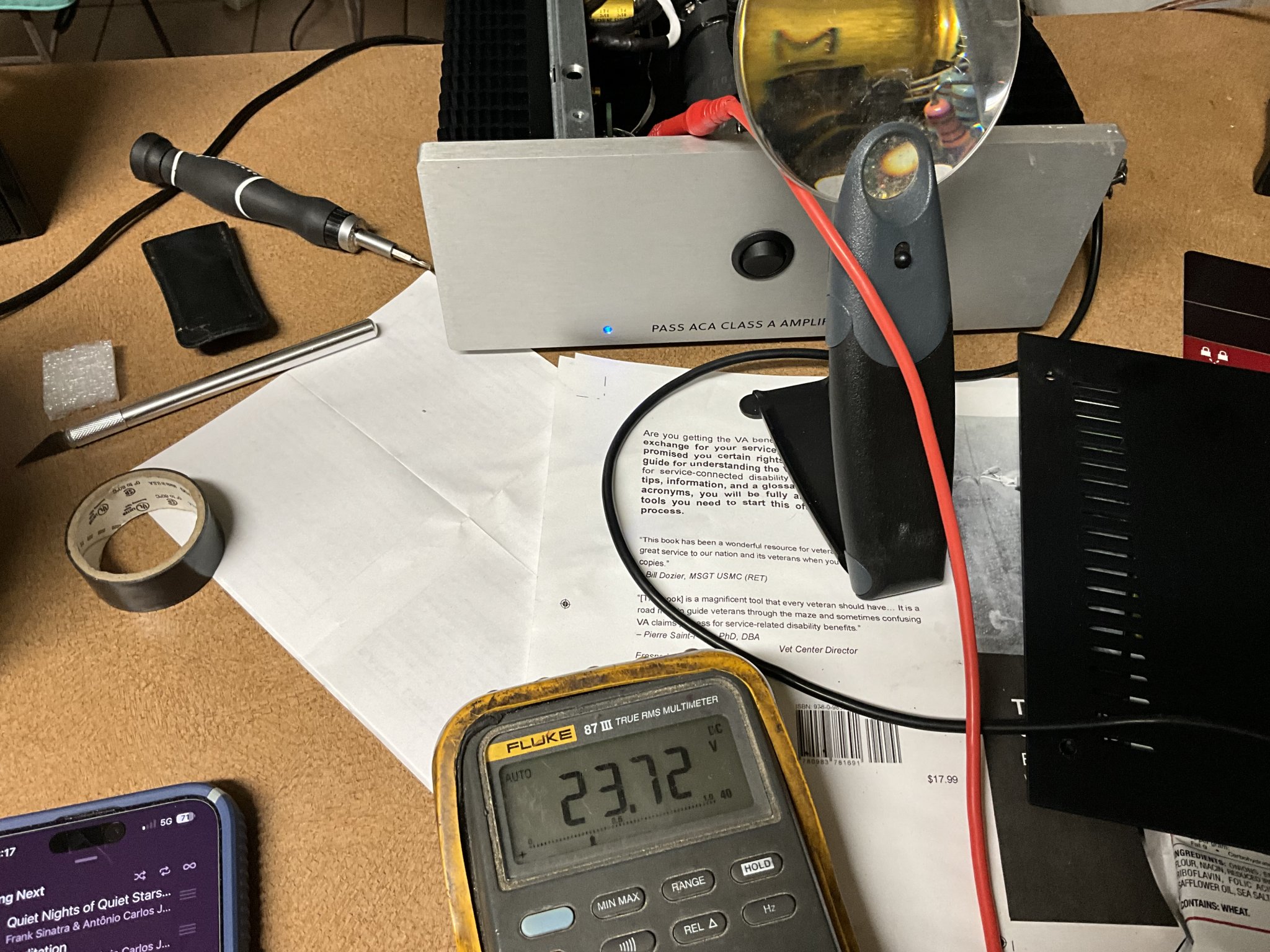

I said I'd follow up in post #11,952 regarding the ACA with TRS inputs. It was a success in terms of the TRS, but I am having a heat issue! I used 5u 250mm wave-fin heatsinks from a Dissipante chassis, each with two ACA boards (4 transistors) mounted, and expected more dissipation than the original ACA chassis. However, the amp is running FAR too hot for the given DC voltage. I have turned the trim pots all the way down to 4.44V and am still getting up to 147 deg. F (~64C) on the sinks with a 72F ambient temperature and moderate airflow after around 30 minutes. At the specified 10-12v the amplifier reaches these temps in approximately 15 minutes. (Using 24v MeanWell SMPS power supply)

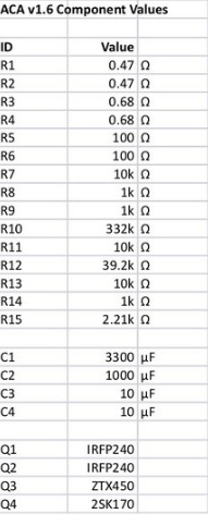

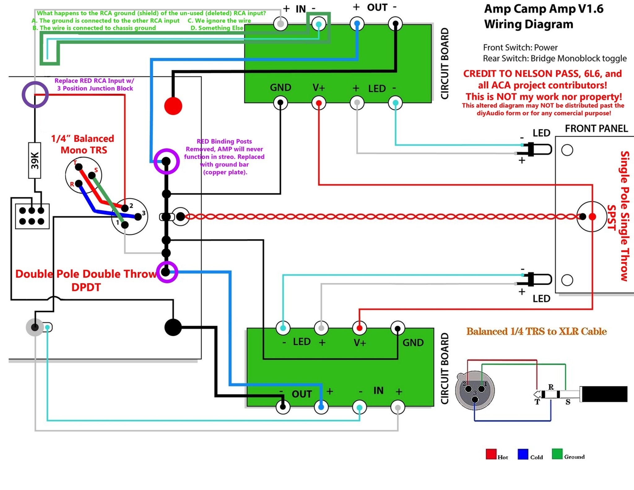

Below are photos of the boards, along with the wiring schematic and BOM we used. All resistors were double-checked before being soldered. We used all black wiring, but it was double-checked to match the schematic provided.
NOTE: The LED's are currently NOT installed on the board. Oh, and don't judge my woodworking too hard, it was done with hand tools as I'm in college!

Joined 2017
Hi.
First...i Like you work...nice Amp!.
Then check If your smps has the 24 V.
The heat has nothing to do with the "Operation Point" Set by the trim Pot.
Trim Pot at 4.44V each Board has 24 v with about 1.5 smps...so IT IS 36 Watt Power...Heat. you have 2 Boards...72 Watt. Too much for one Heat sink i guess
For heat ventilation use feet under your nice housing.... plus plan some ventilation holes.

Joined 2012
What chermann said.

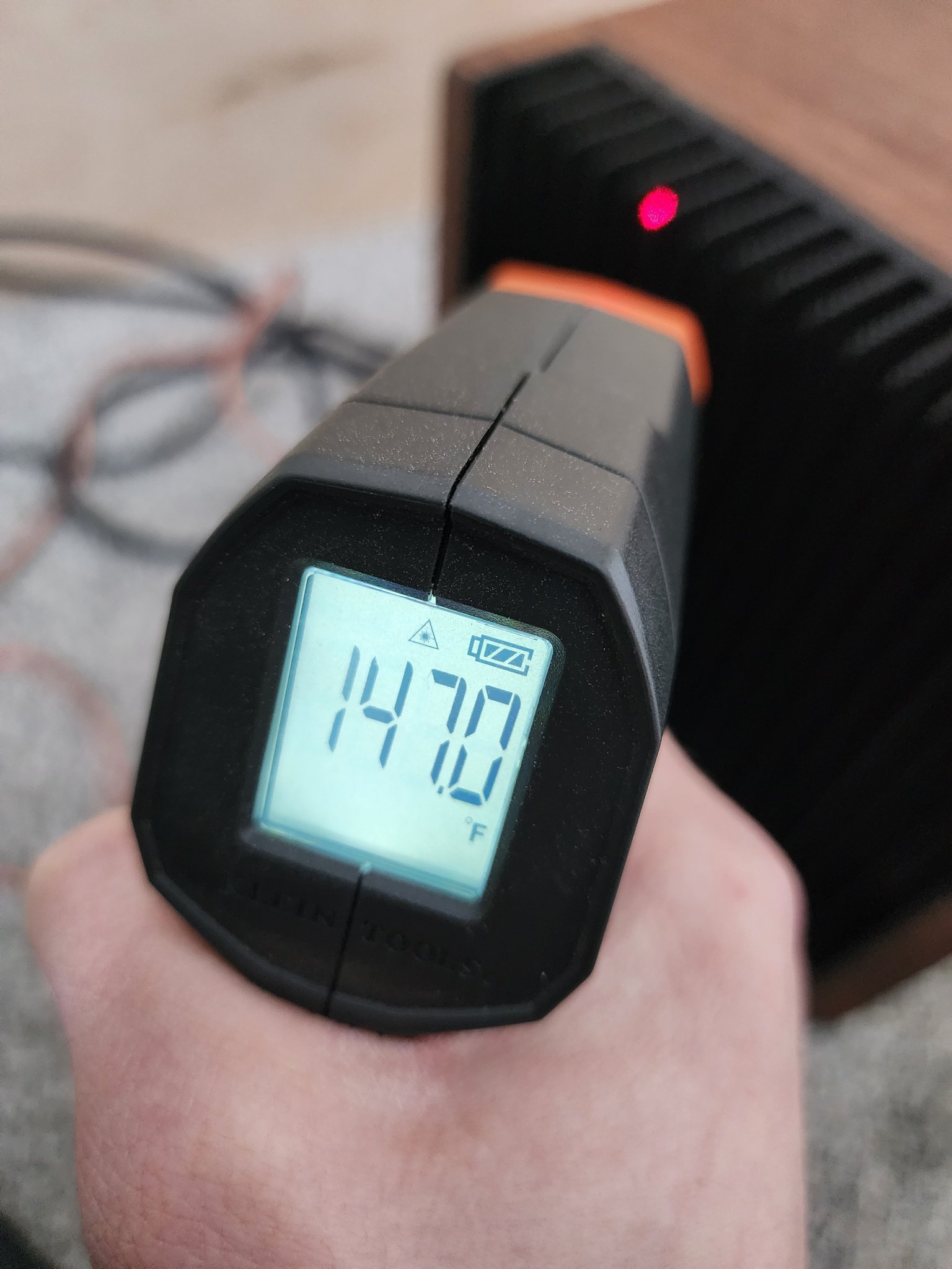

Use feet to raise the chassis and heat sink above the supporting surface so that air is able to enter the heat sink fins from below the heat sinks. That will help establish a vertical flow of air at the fins.
The transistors and heat sink also radiate heat into the interior of the chassis. That heat also needs to be evacuated to keep the temperature of the electronic components at a safe level for long life. It will also lower the heat sink temperature. So cooling holes/vents need to be placed in the top and bottom of the chassis. Raising the chassis also allows air to enter the chassis through vents in the bottom plate to establish air flow through the chassis to vent out at the top plate.

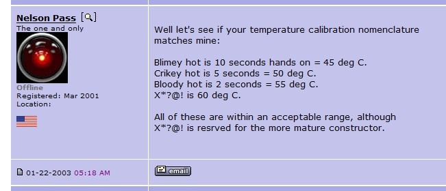

How long can you hold your hand on the hot heat sink? Sometimes infrared thermometers do not give accurate temperatures.

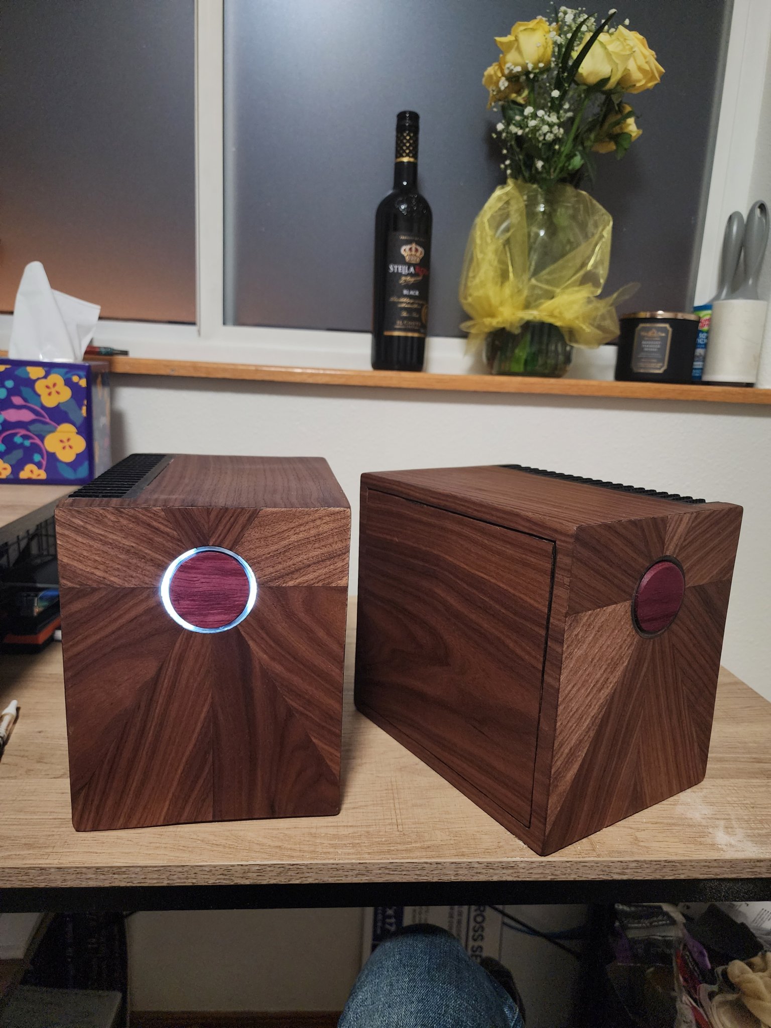

Thanks for your recommendations and compliment, I attached a photo below of them with my LRS+s and next project- a Klein Horn 😎 I improvised some feet yesterday (AMD heatsinks), and am not currently worried about internal component temperature. All the caps and resistors are well within their operating temps, the MOSFETs are hot (150F case temp) but it doesn't seem to radiate back into the chassis. (I'm guessing my rough cut edges of the magnetic sides provide some airflow.)
With the feet (3in off floor) its still in the X*?@! territory.
I'm looking a method (mod) to lower the dissipation of the amplifier. In my F5T there are resistors controlling the range of DC bias, I'm assuming its set here, so potentially increasing its resistance may help lower the dissipation. Alternatively, I could purchase 20v power supplies, has anyone compared the temperature difference?
ModuShop claims the heatsinks performs ~0.19-0.28 C/W, 57-70 above my 72 deg. room, if dissipating 72 watts (ignoring a bunch of important maths and graphs)

Joined 2014
That is some beautiful wood work.
Those heatsinks are usually installed in a metal chassis that allows more ventilation from the inside of the amp. There is also some heat transfer to the front plate and backplate. These little things add up and make a significant difference in how much thermal energy a chassis can dissipate. A standard chassis construction could easily handle the heat from two ACA boards.
If there is a way to allow some airflow from inside the chassis, that would help a lot.
The ACA has a fixed bias that is set by the 0.47 and 0.68 Ohm resistors. This is would be 1.45 Amps with those values and a 19V supply. The 24V supply increases bias to about 1.5A.

Good point about front and rear plates, they get quite hot on my F5T. I designed these amps with ply that tolerates higher temperatures without warping over time, but it doesn't dissipate heat like metal can. I'll see whats possible for ventilation tomorrow. The supply doesnt seem to make a huge (%) difference. So, if anyone knows a post with an inceased (or extra spliced in) resistor, please let me know!
Woodworking is a hobby of patience and precision to me. Tolerance goal on the Klein Horns is 1/16 in, working with 3/4 Birch ply, and mitered corners. I'll never make another project with compound (3 axis) miters, it takes an awful amount of trig.

Joined 2017
Hi Dalton
normal a trim pot is on the pcb of the SMPS - so you can setup the SMPS to 19V. the trim on the ACA pcb should be adjust to the "operating point" half of that -so about 9,5-10V. measured after the big cap C1. to GND.
to set down the bias through the resistors (bias of your amp in Class A) you have to dismount the PCB and change the resistors to a higher level.

I've performed my fair share of 'amplifier surgery.' Anyone have predictions of what changing the 0.47 Ohm to 0.68 ohm resistors would net me for a bias decrease, or should I be making bigger changes to the values? I'll look for a pot on the MeanWell supplies to lower output voltage 👍🏼

Joined 2012
You can decrease the bias current by decreasing the value of R8. Try paralleling a resistor to the existing resistor. This should be easy to do as you do not need to take the board off the heat sink. Try paralleling another 1k resistor to the existing 1k. That may reduce the current perhaps 15 percent. You can reduce the value of R8 further if you want an even lower bias current. Lower bias current does affect amplifier performance though.
I strongly recommend that you provide air flow to the interior of the amplifier. Without air flow the internal temperature will be high after a long period of operation. Electrolytic capacitor lifespan is highly dependent on their temperature. An 10 degree C increase in temperature halves their lifespan, and each 10 degree C increase halves their lifespan again. It is best to keep electrolytic capacitors as cool as possible.
Since you have nice wood enclosures that you probably do not want to mess up, one way to provide some air flow through the chassis is to add some venting to the chassis bottom plate toward the front of the chassis for air entry and some venting toward the top of the back plate for air exit. That hopefully would provide some air flow through the chassis to evacuate some heat that radiate from the mosfets.
Joined 2014
Another way to decrease the bias current is to eliminate R15. The original ACA did not include this part.
Ben has mentioned some good ideas for improving airflow, which I would recommend before reducing the bias current.

Administrator
Joined 2007
About 15% reduction in current.
