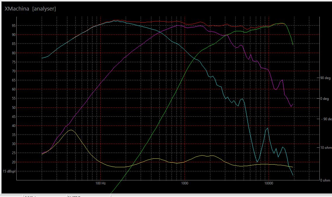

System dBspl characteristic of the design fits the target with c.a. +-2dB tolerance margin:
Design process shown in the demo is only a software functionality presentation. The files used are not suitable for application in a real design, as they reflect the "infinite baffle" conditions.

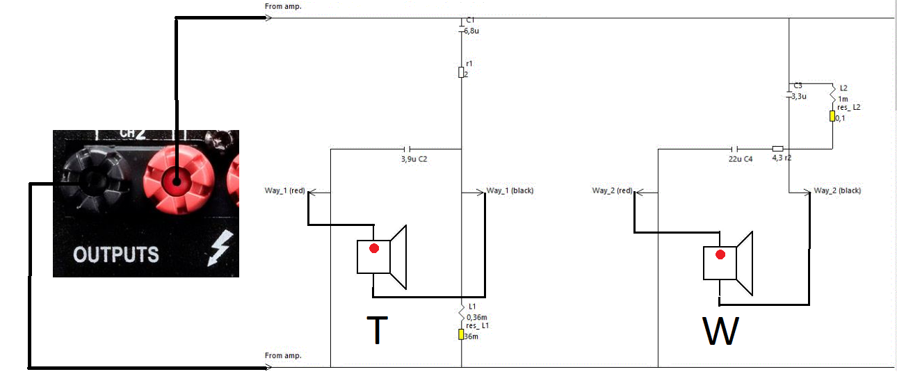

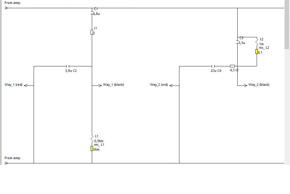

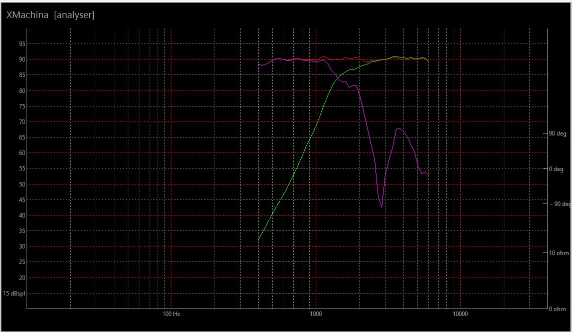

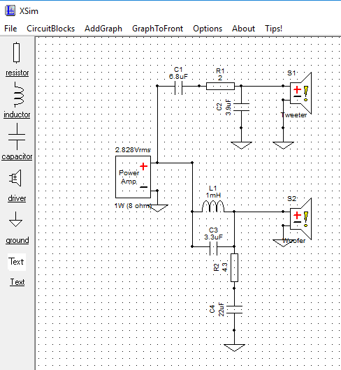

I was trying Xmachina, a two way xover, using actually measured frd and zma files (Klipsch K24K woofer, Visaton TW70 tweeter). I set the constraints to medium accuracy, 90dB spl target, 400 to 7000Hz range optimization.
Program give three solutions, I liked the second one, but, but.. I have no clue on how to interpret the proposed filter schematic... any idea?
It's just that:
attachment.php
Maybe one remark here, in the task setup windows the first Way is named "Woofer" and the Way with the highest index is named "Tweeter". It looks that it is swapped in your design but there is nothing wrong with this as it is only a naming convention.
After grounding the amp's black connector and inverting polarity of both speakers, the designed crossover appears like this:

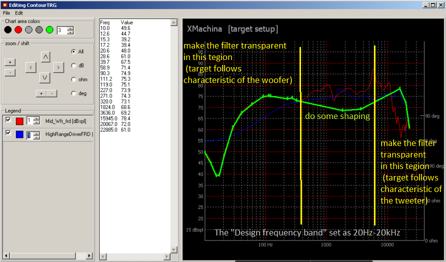

One more comment, it's about the "Design frequency band" in the task setup window. It defines the focus frequency range for XMachina. In other words, XMachina assumes that it's not importatnt what's going on outside, which may lead to undesirable effects if the range is set too narrow.
If the intention is to optimise (shape) characteristic in a region but also make filters "transparent" outside, just let the target spl follow the drivers characteristics outside, keeping the "Design frequency band" wide enough.
To clarify, I attach a screenshot from XMachina doc as an example (chapter "Target dBspl setting", target characteristic is marked green, woofer is red, tweeter blue):
attachment.php

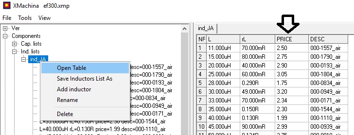

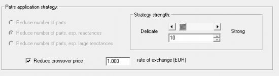

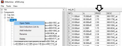

XMachina latest version: [1180918]

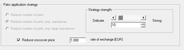

There is a new option in „Parts application strategy” task settings: „Reduce crossover price”.
attachment.php
Remarks on the new feature:
  • All components on lists selected for the design should have prices entered (see "Loading componets" chapter in the .pdf).
    attachment.php
  • This feature was tested with prices converted to EUR, but I think it should also work with a currency that has roughly similar exchange rate like USD or CHF. It’s still possible to use any currency, just enter the exchange rate in the task settings (with reference to EUR).
  • If bipolars are undesirable in the tweeter circuit, create a separate list without bipolars for the tweeter. When „Reduce crossover price” is checked, bipolars are preferred over other cap types (because bipolars are usually cheaper). For simular reasons, creating separate list with ferrite-less (or core-less) inductors for the tweeter should be considered.
  • With the “Reduce crossover price” feature you can easily encourage XMachina to prefer a subset of parts from list. For example, apply half (or quarter) price for the components that you have in your drawer.
