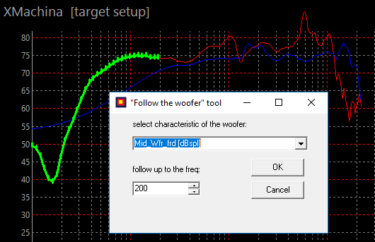

1) Impedance phase equalization option introduced.
2) Protection against impedance module fall for high frequencies added. Basically the impedance targets are checked a decade beyond the end frequency for dBspl target (that is to 200kHz typically).
3) To avoid application of large inductors/capacitors/high power resistors it is recommended that dBspl target curve follows the woofer characteristic in the low frequency region. You can use "follow the woofer" tool to set it this way, it's available in the context menu of the chart area:
attachment.php
then click some points to define the rest of the target, for example:
attachment.php

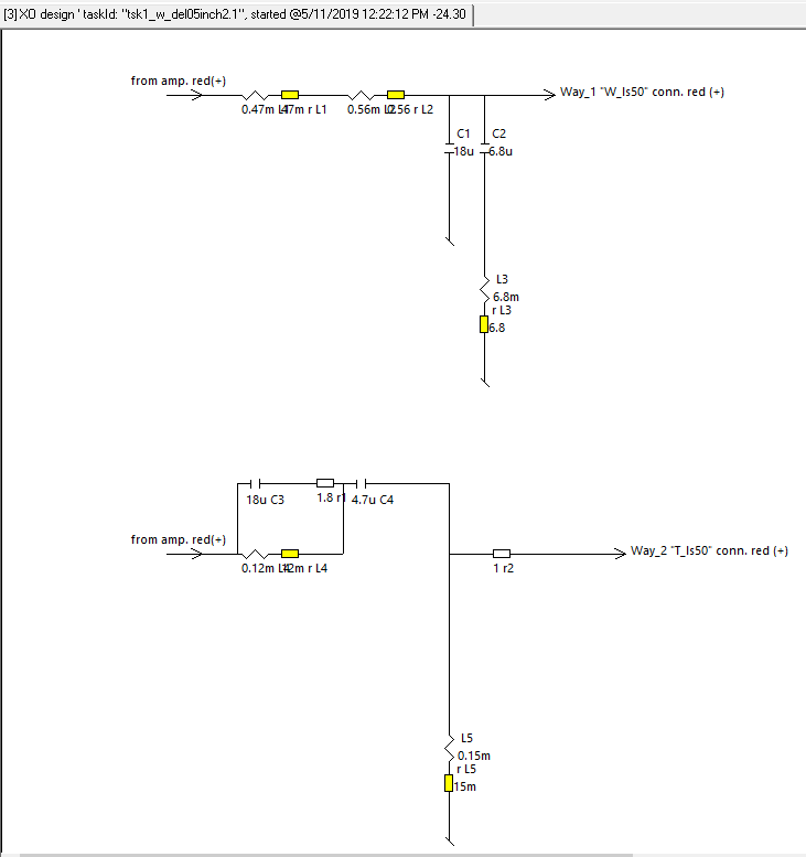

Hello there,

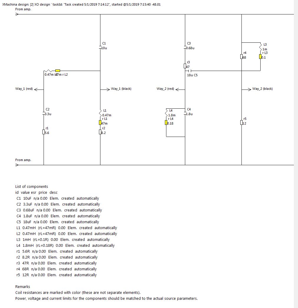

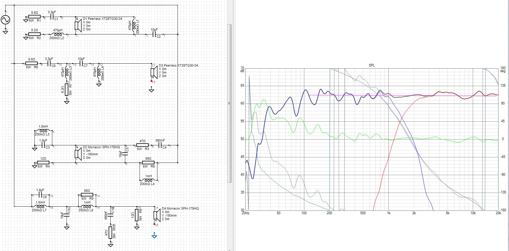

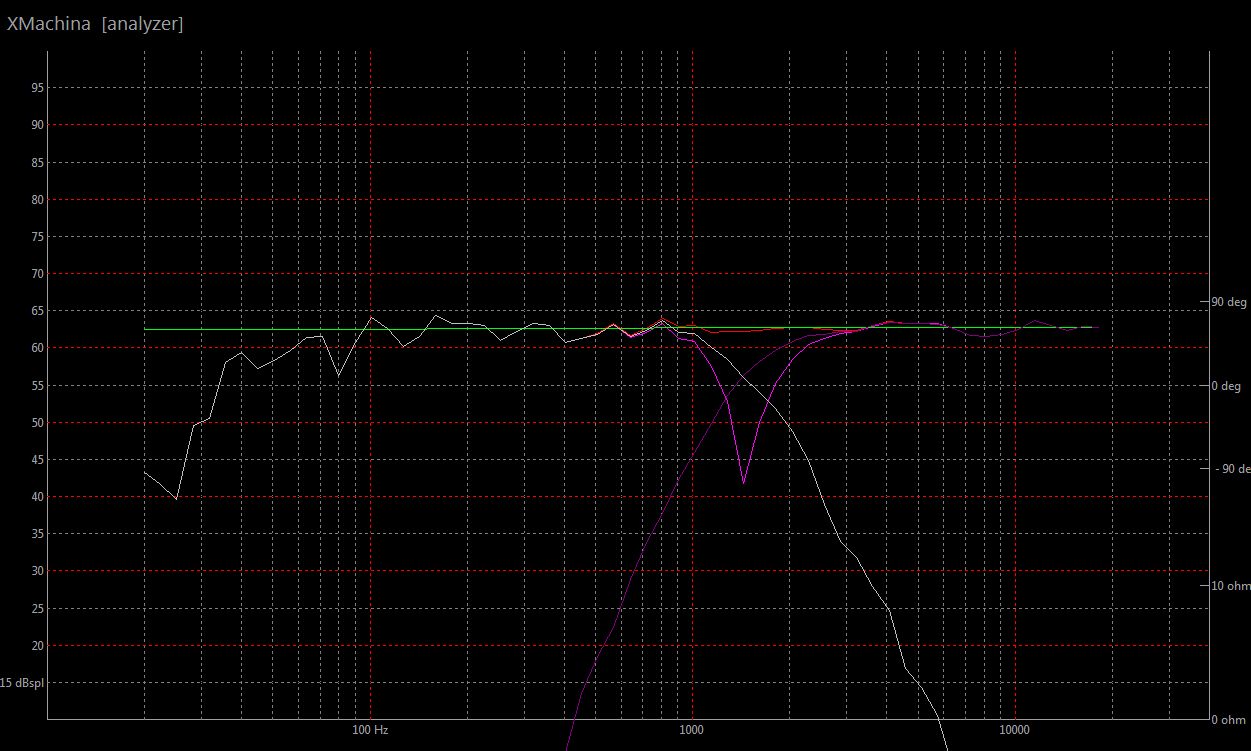

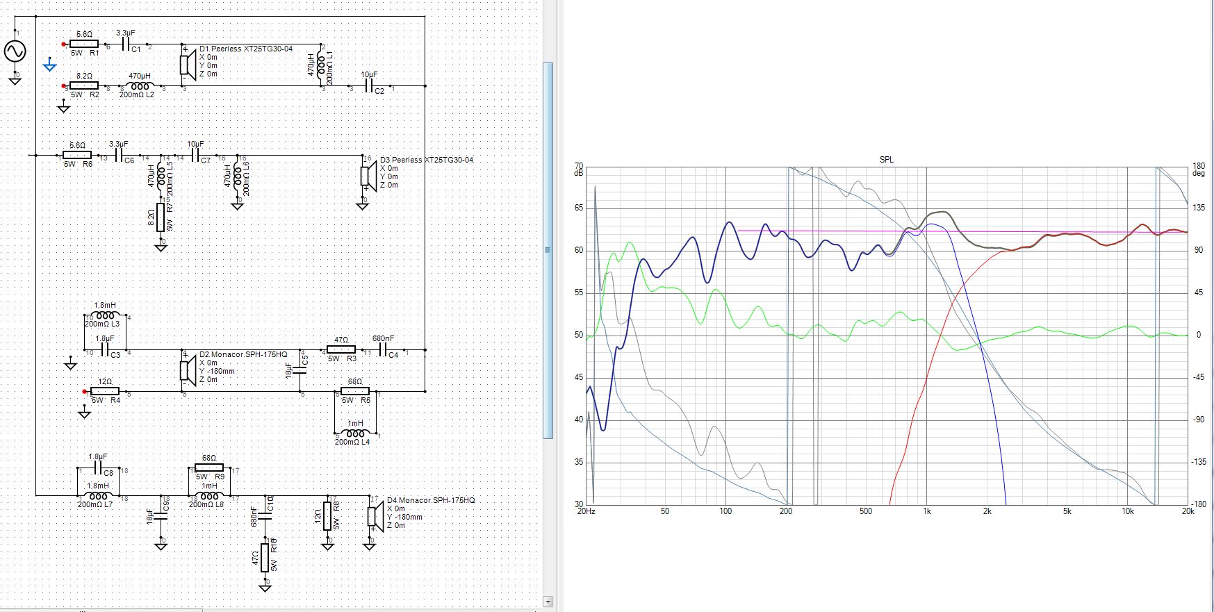

For whatever reason, I have great difficulty translating anything other than a simple crossover Xmachina provides into what I would consider a "normal" looking crossover schematic that I can actually understand and build.
The first image is my interpretation of image 3 and looks like I have done it correctly.
The second image is me translating it into a "normal" crossover layout, and obviously I have done it wrong.

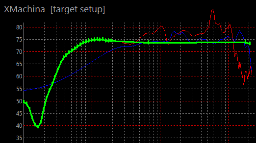

The third image is the actual Xmachina circuit drawing and fourth is the graph.
What mistakes did I make and where?

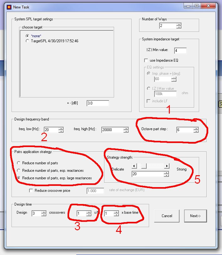

Understanding Xmachine Design Task Settings?
Hello,
I was wondering if you could help me understand Xmachina Design Task Settings?
1 - What does the number in the "Octave part step" represent?
2 - I understand what "Reduce number of Parts" means, but what is "Reactances"?
2b - Is there a way to turn off "Reduce number of Parts"?
3 - What does the number in "s/f" represent?
4 - What does the number in "x base time" represent?
5 - What does the number in "Strategy Strength" represent?
5b - In Strategy Strength, what is more "Delicate" and what is more "Strong"?
Thank you,
David - London, Ontario, Canada.

Hello there,
Transformation for D2(Monacor) is not correct imho. I'm afraid that this type of circuit (impedance bridge) is not easily transformable to the "common ground" architecture.
In the next version of XMachina (coming in a week or two) there will be an option of limiting designs to the "common ground" architecture only.
"Reactance" here means a coil or a capacitor.
You can set the "strategy strength" to 0. But it can easily end with the fact that the designed circuit will have several dozens of elements, so it will be expensive and difficult to implement.
Hello,
It's all described in the "Design Task creation" chapter in the pdf document.

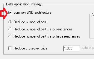

1) Common ground architecture option in the design task setup window.
attachment.php
Check it to get circuits designed with common ground, for example:
attachment.php
I got some feedback that previous output from XMachina was difficult to read. I hope that it will get better with the new feature.

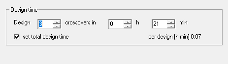

2) Design time manager.
For example, to get 4 designs until the same time next day set it this way:
attachment.php
so XMachina will spent 6 hours on each design.
Needless to say the longer design time the better results to be expected, however before starting such long lasting designs it’s recommended to execute few test 5 to 10min designs just to make sure that there are no issues in the design task settings. It’s also easy to setup a test run with the time manager feature, for example:
attachment.php
XMachina can design in the background. No special settings are needed, for example while XMachina is working on design nr 3 of 4 you can analyze or edit finished designs nr 1 and 2. The design process nr 3 is being continued in the background (next nr 4).
