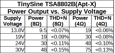

If this suffices, it may be a workable solution.
DSP and Bluetooth onboard.
Full review here:
https://diy.midwestaudio.club/discussion/comment/48302/#Comment_48302
