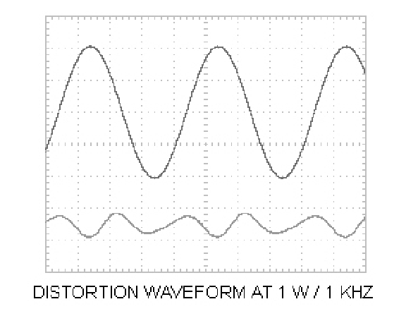

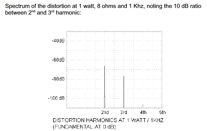

FirstWatt F7 Owner's Manual
F7 is H2 dominant - roughly 10dB over H3
and if it matters, it is also negative phase H2
Reactions: 1 user
Joined 2004

the F7 (and maybe the F5) was an exception to that being a third-harmonic type of amp.
I believe that this meant that there was significantly higher H3 than other designs due to the push-pull nature of the F5 and F7. A properly implemented single-ended design will have very low levels of H3 compared to H2 when running at a similar bias point (one of my designs with bipolar outputs has about -40dB H3 compared to H2 in sim and about -30dB in a real circuit).
It is also possible, using P3 on F5/F7, to completely trim out the H2 component. I've always preferred the trimmer to be set so that H2 and H3 are roughly equal.

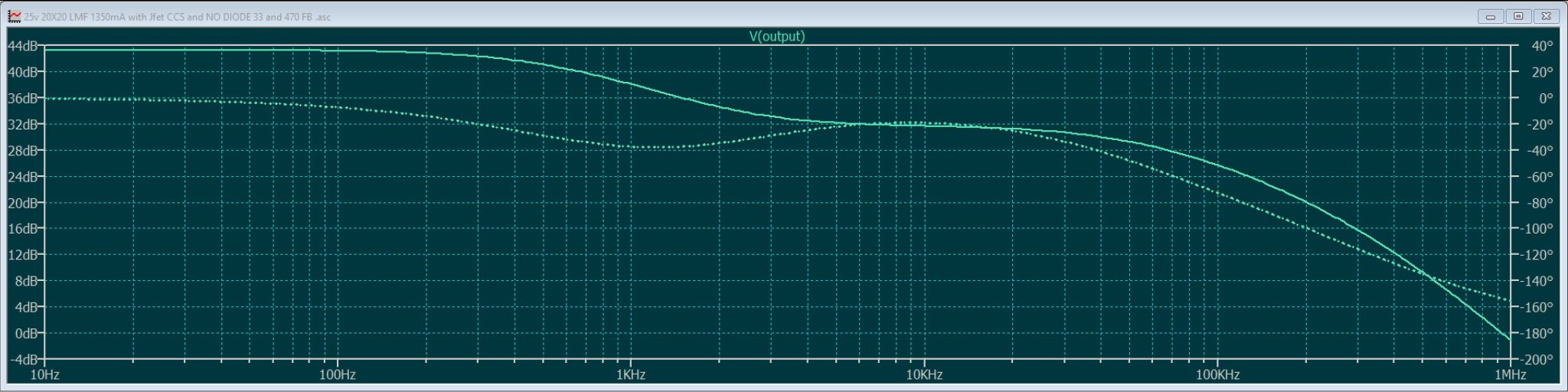

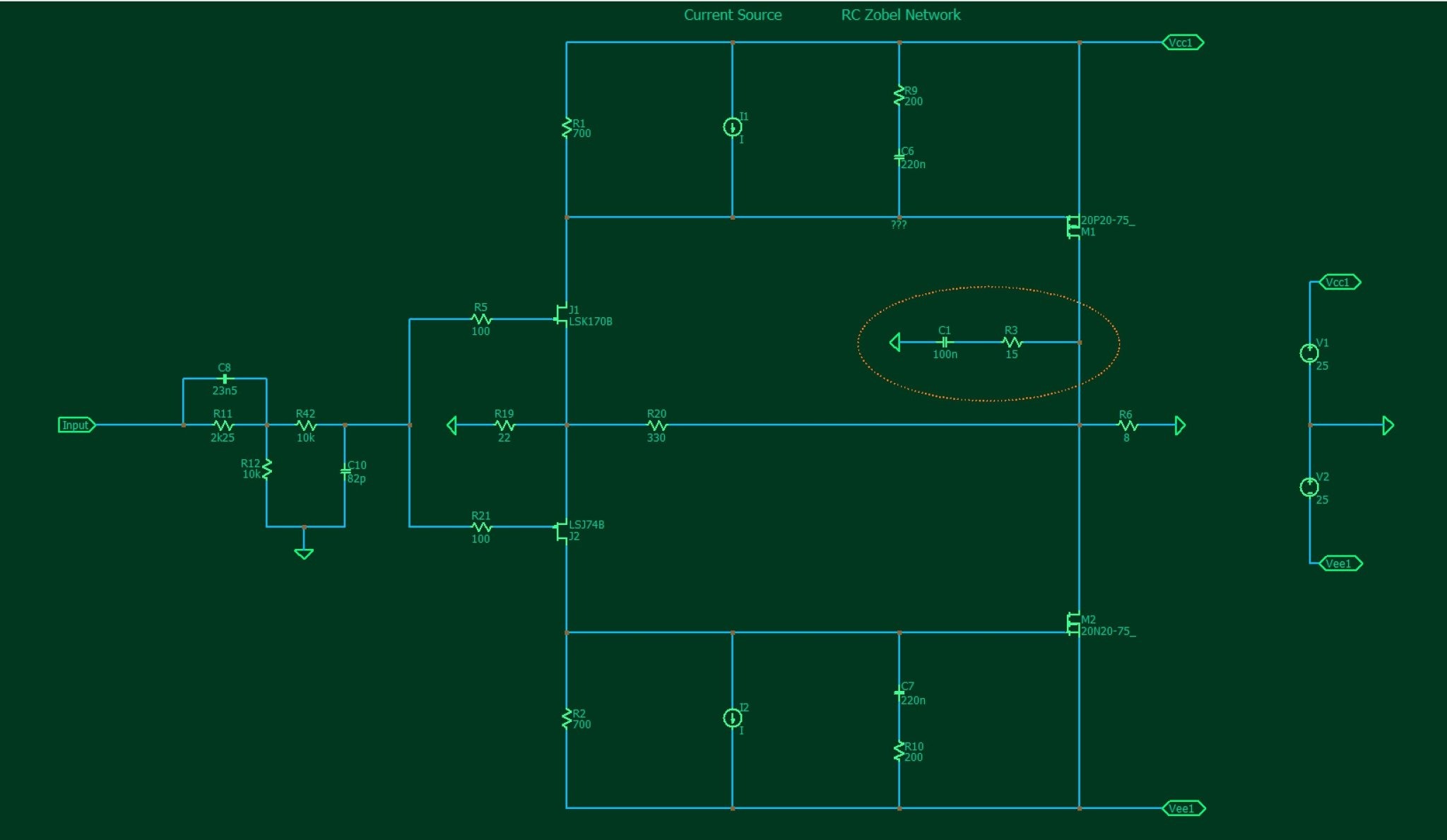

I still working on an F7 type amp that has two plateaus of OLG that looks something like this:
Recently, I added a Zobel network to the O/P shown in a simplified circuit here:
My motivation for adding this was that I have noticed that this kind of amp ( F5 / F7 ) has a tendency for some exagerated sibilance ( still there despite the fact that on my latest version there are only very small amounts of feedback 5k - 20k hz region. )
Regarding this sibilance, the zobel network was not particularly effective but it had a wonderfully positive subjective effect on midrange purity, imaging and reproduction of low level detail.
Anyone that has built an F7 / F5 type circuit might like to try adding a zobel across the amp O/P ( as close to the amp O/P as possible. ) and would be interested to hear if you notice the same subjective improvement.
If I succeed in taming the sibilance I am going to very happy with this F7 type amp.
If I do succeed I will post the final circuit here.

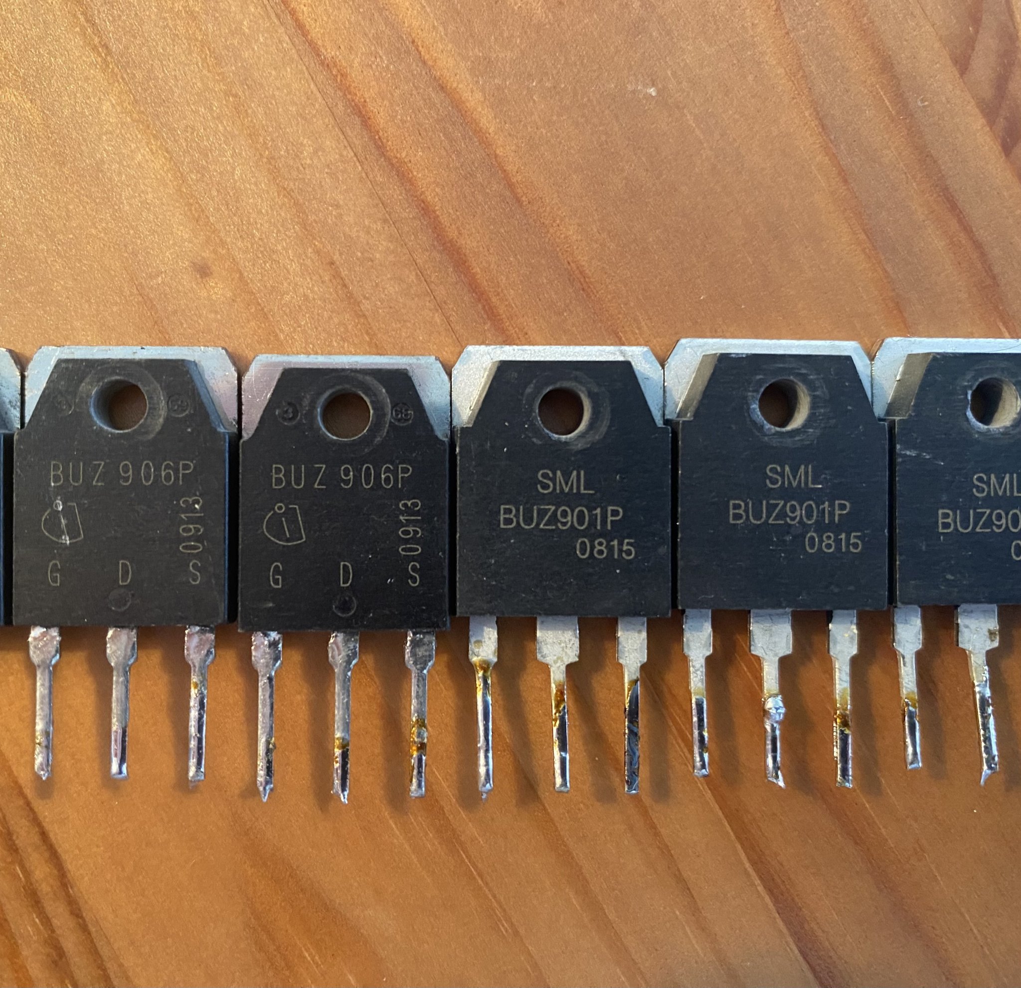

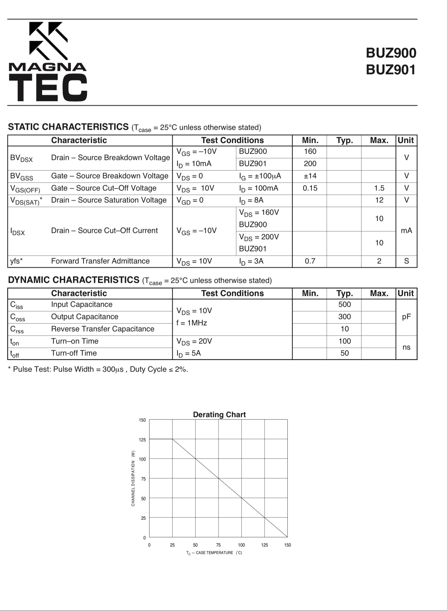

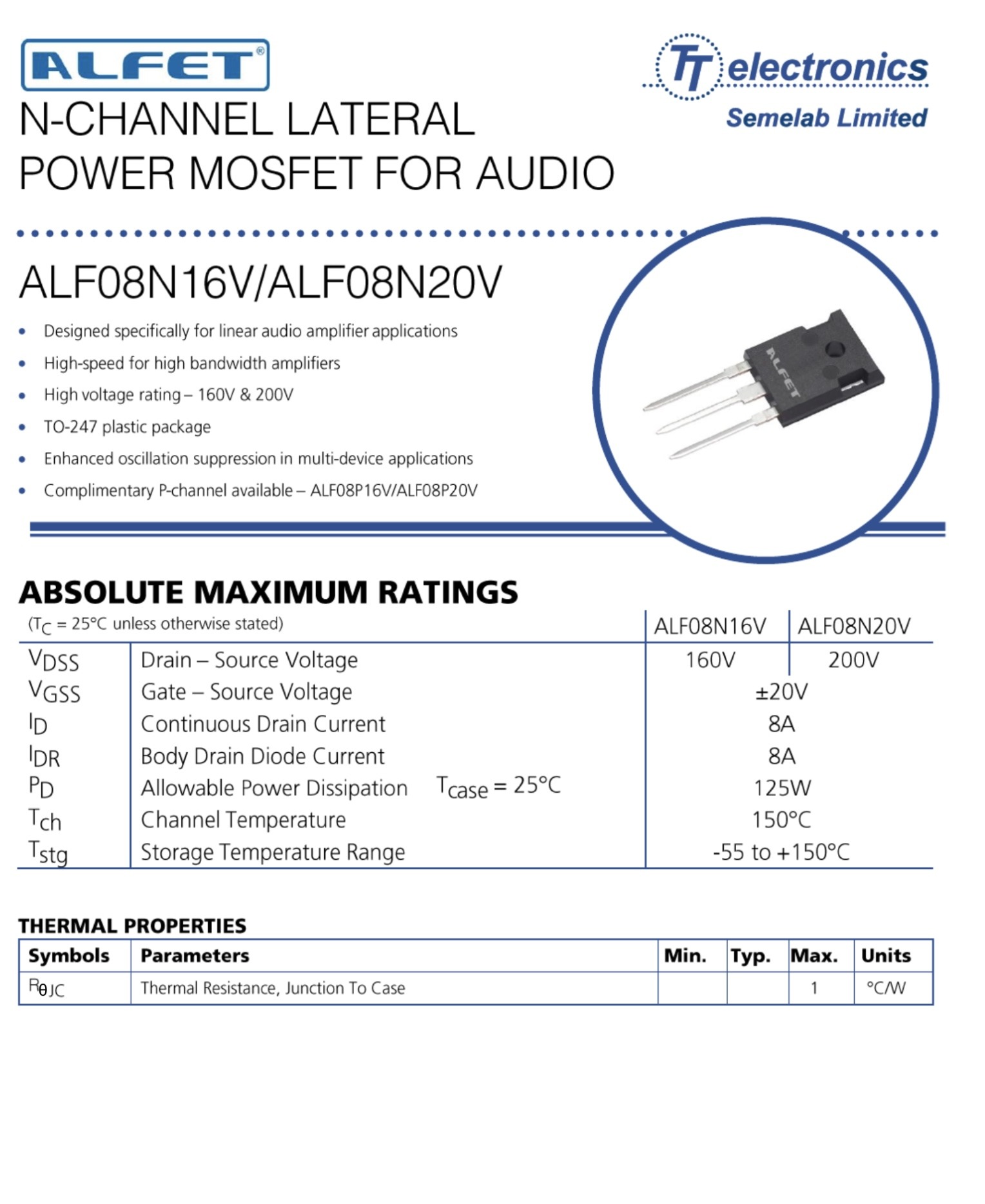

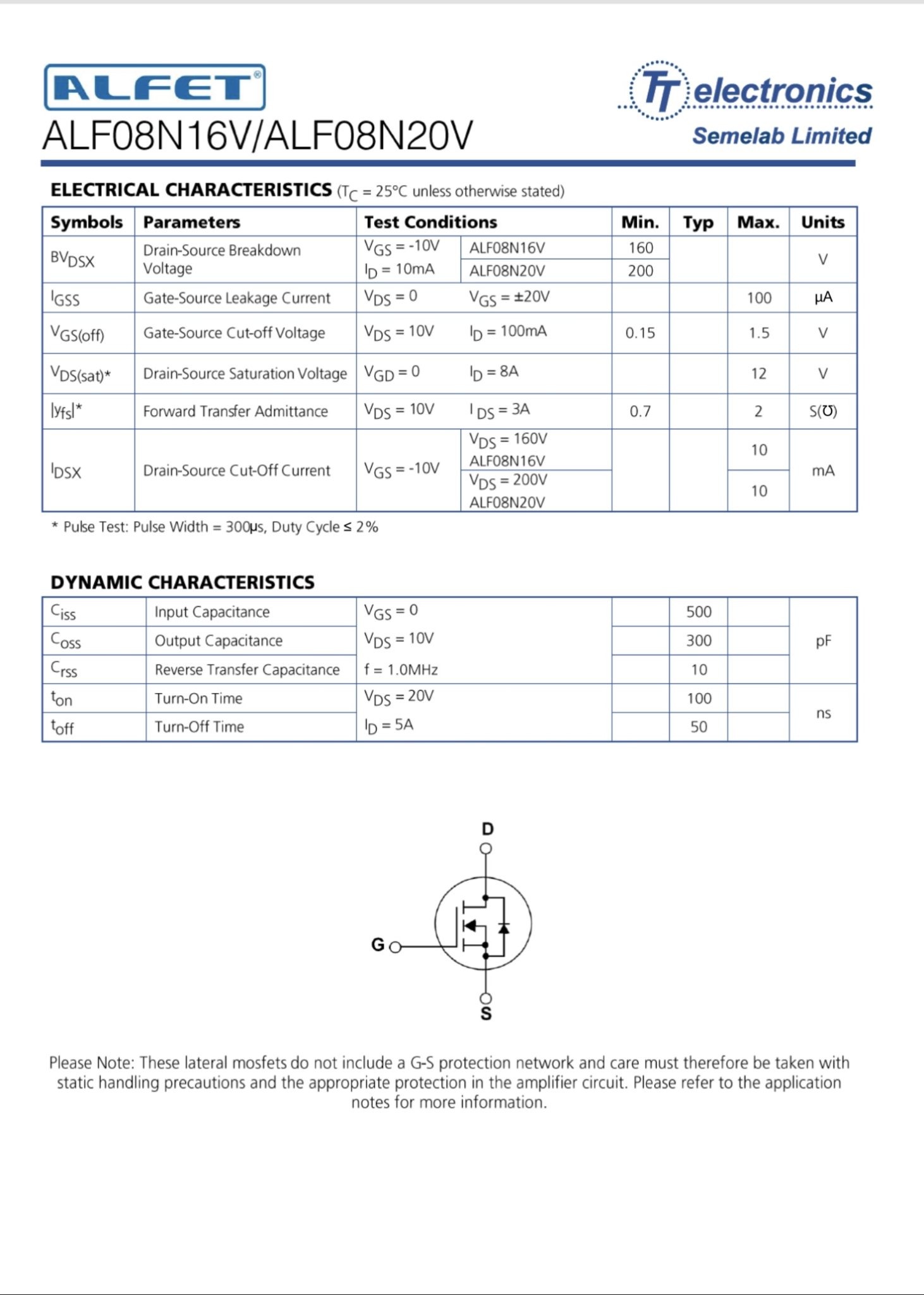

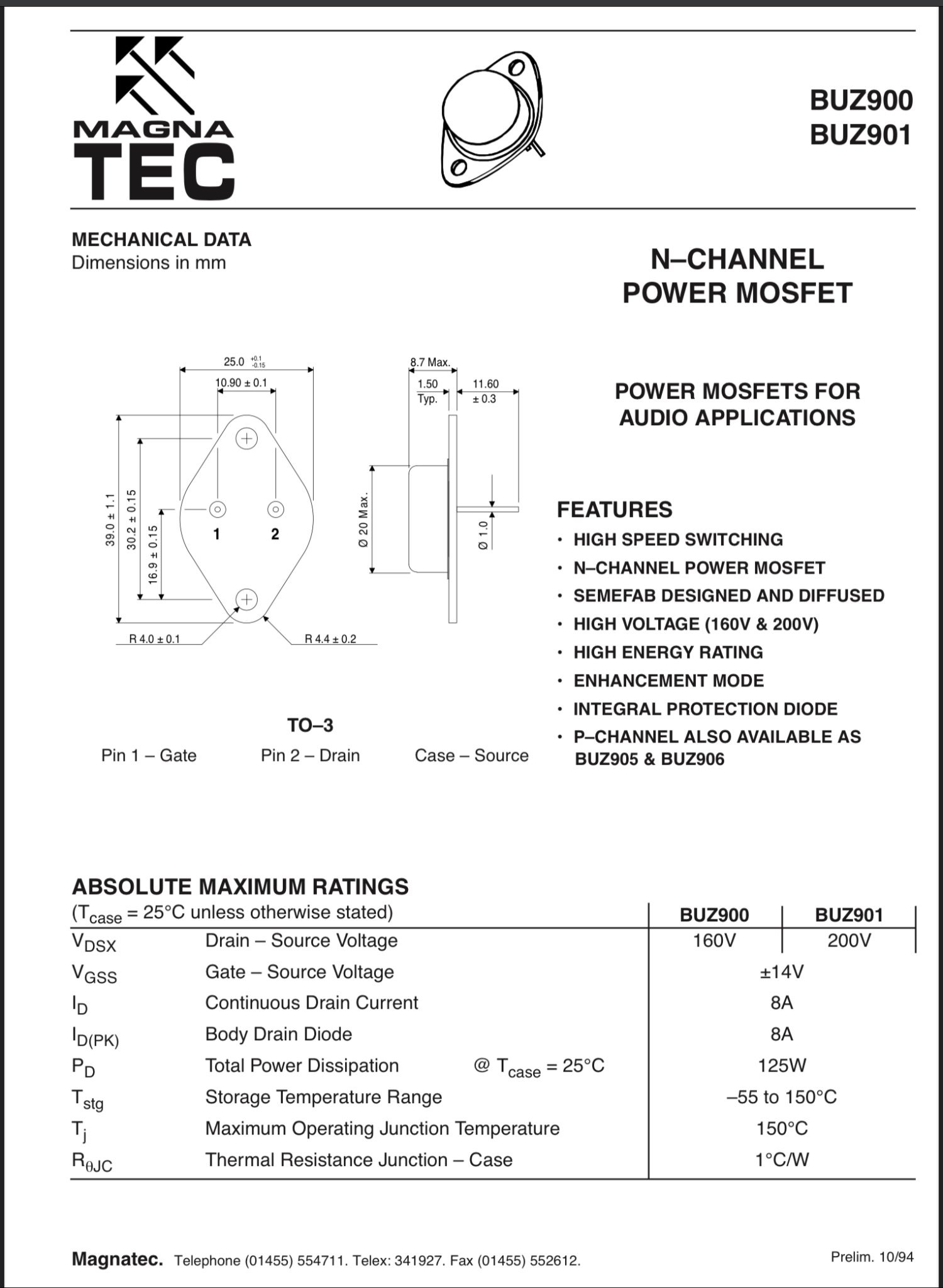

I just found that I have some BUZ 901p and 906p in my part bin. Looking at the data sheet, they look like they are the same part than the Alfet alf08n20v alf08p20v. Anyone having some experience with those? The F7 seem to be a good candidate to use them 🙂
