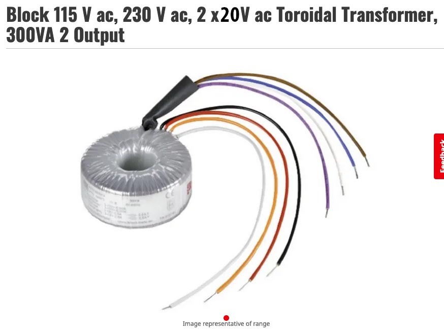

I have this transformer, is it enough for F5/F7? Can I use 20V on the secondary?
