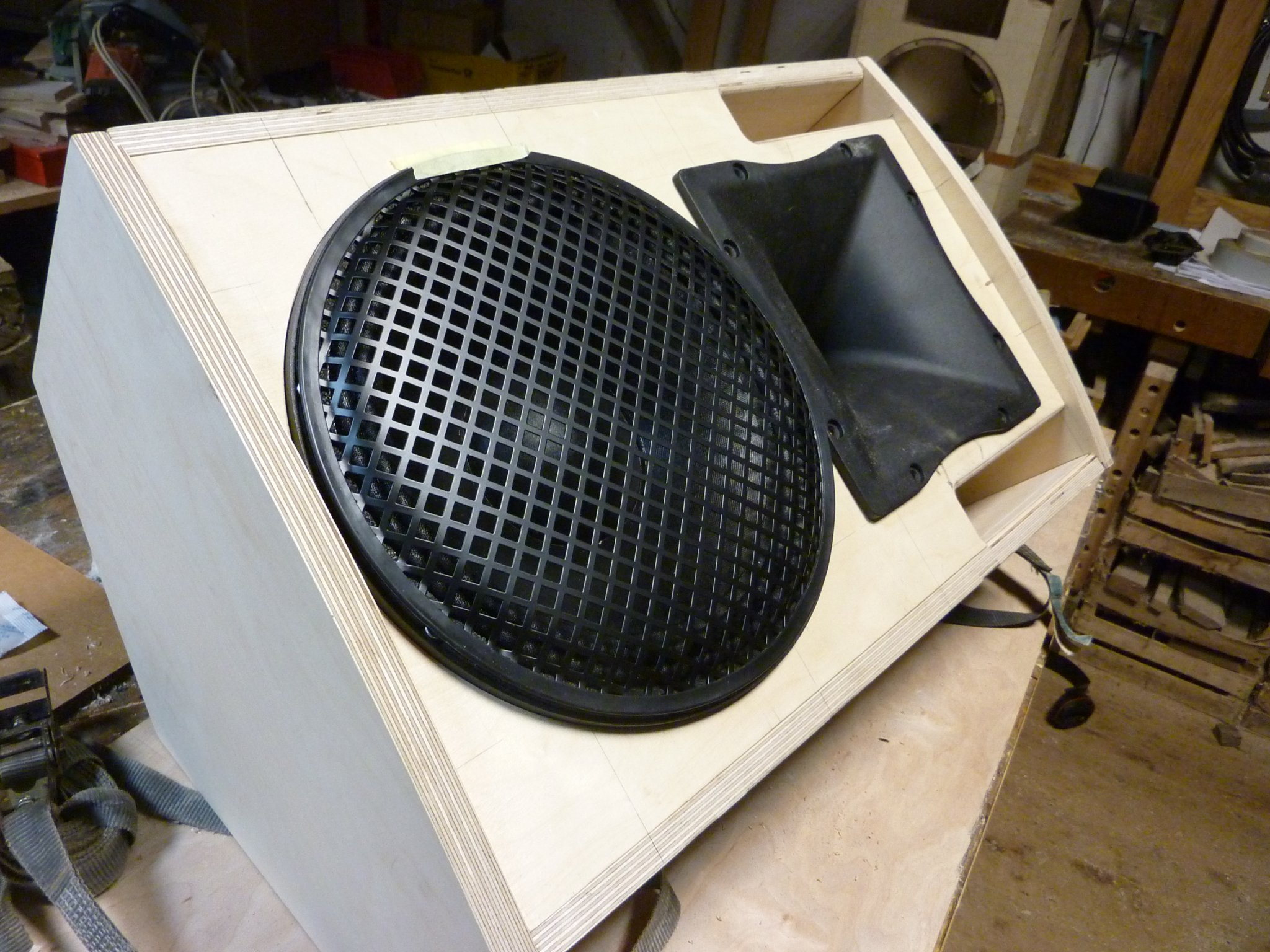

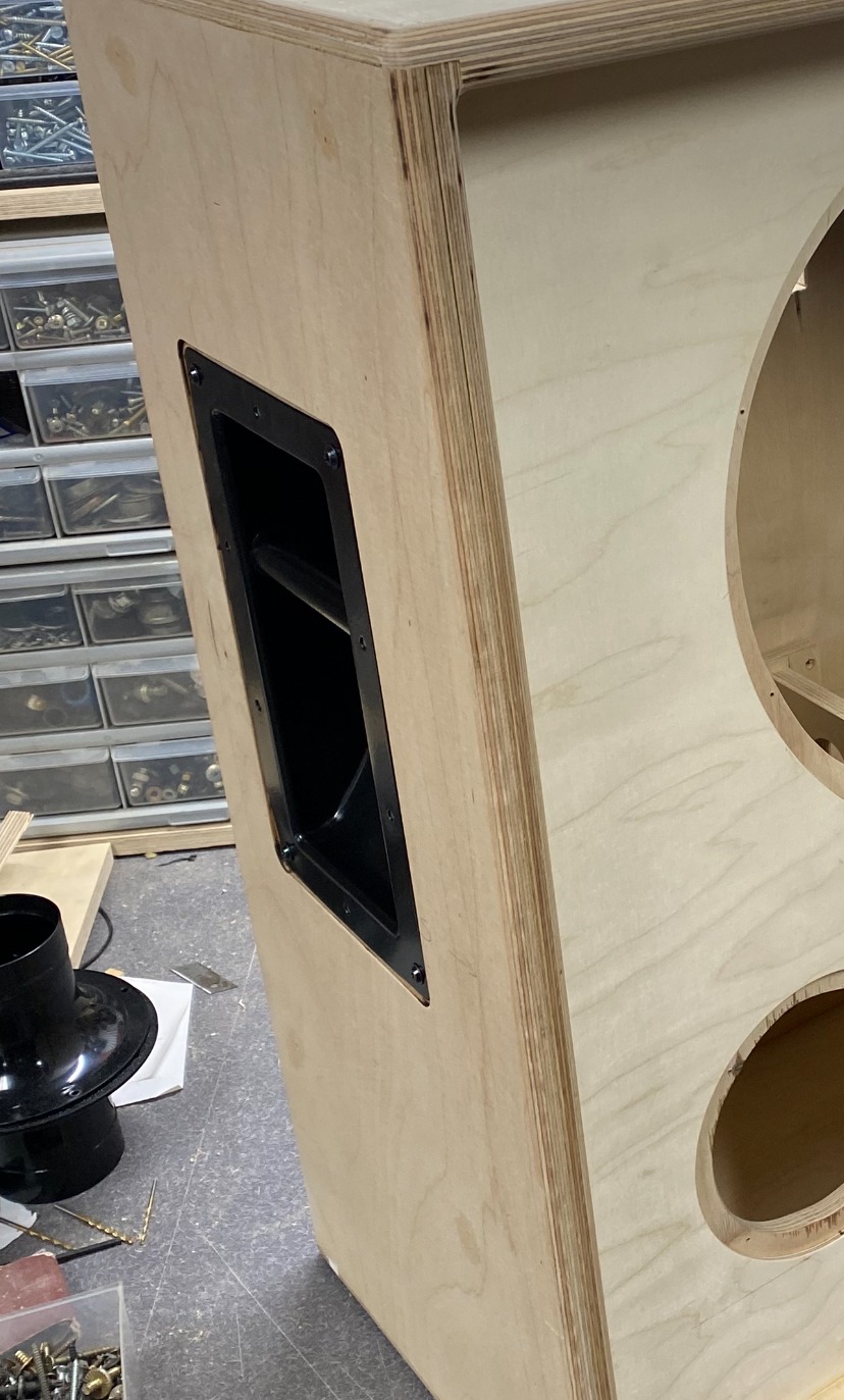

the handles will be mounted like you can see it on the pictures, i do not see a reason to recess them completely.
i am now shape the bracket so the handles are fitting.
once the tops are finshid i want to be able to hang the speakers from the two handles, to adjust the tilt and fix the position i need a third point on one of the back sites, i am not sure where i will put this lashing point. down or up ?

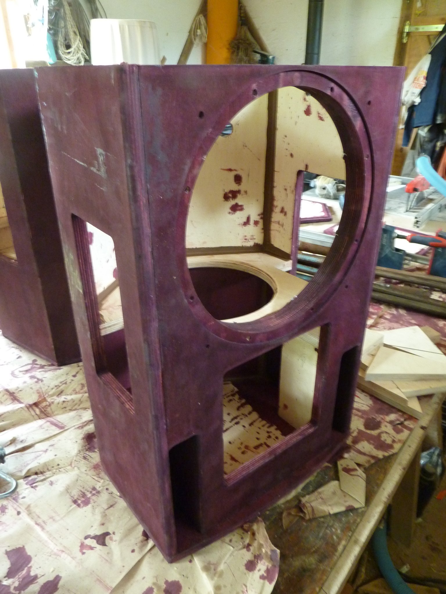

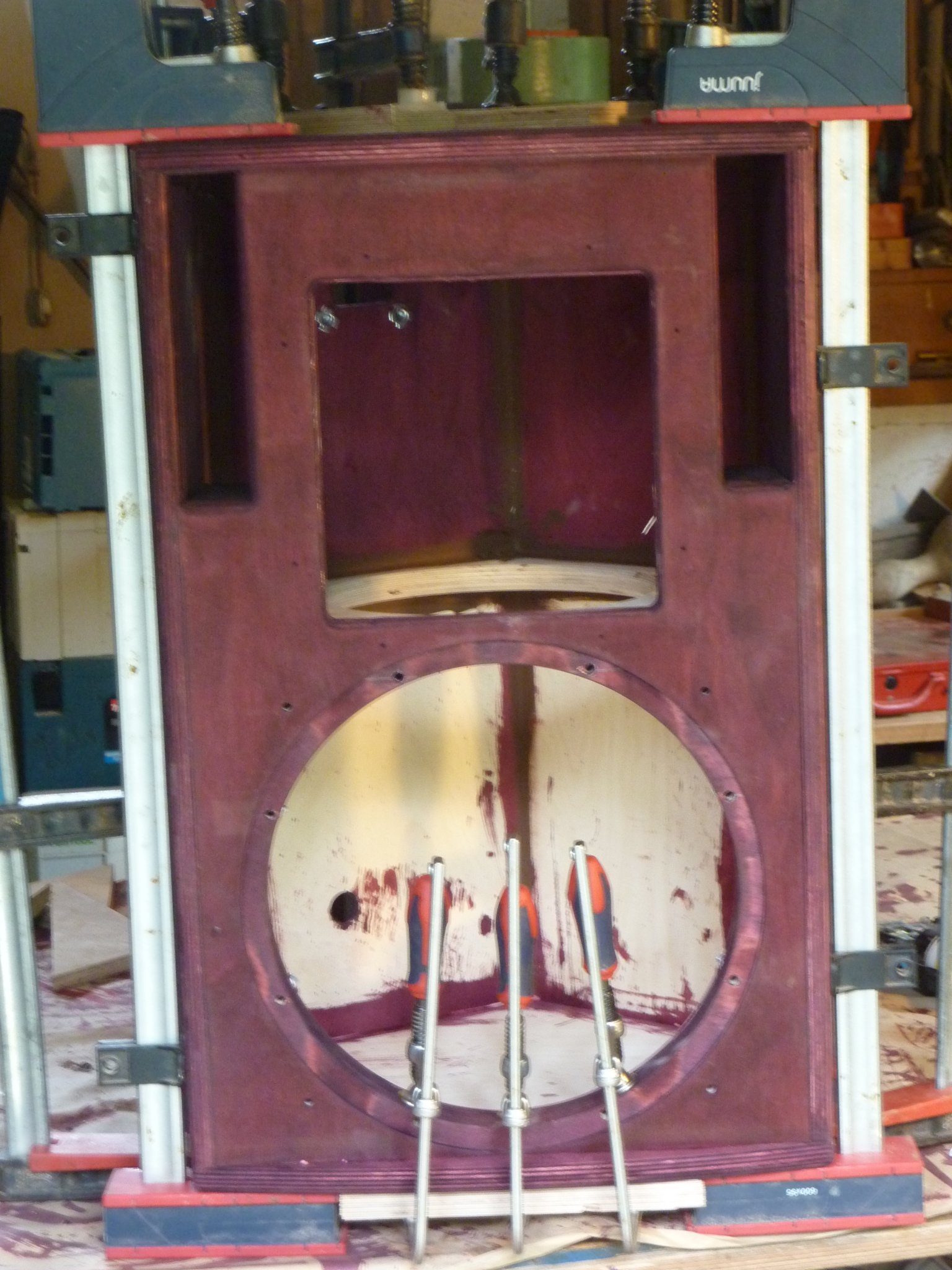

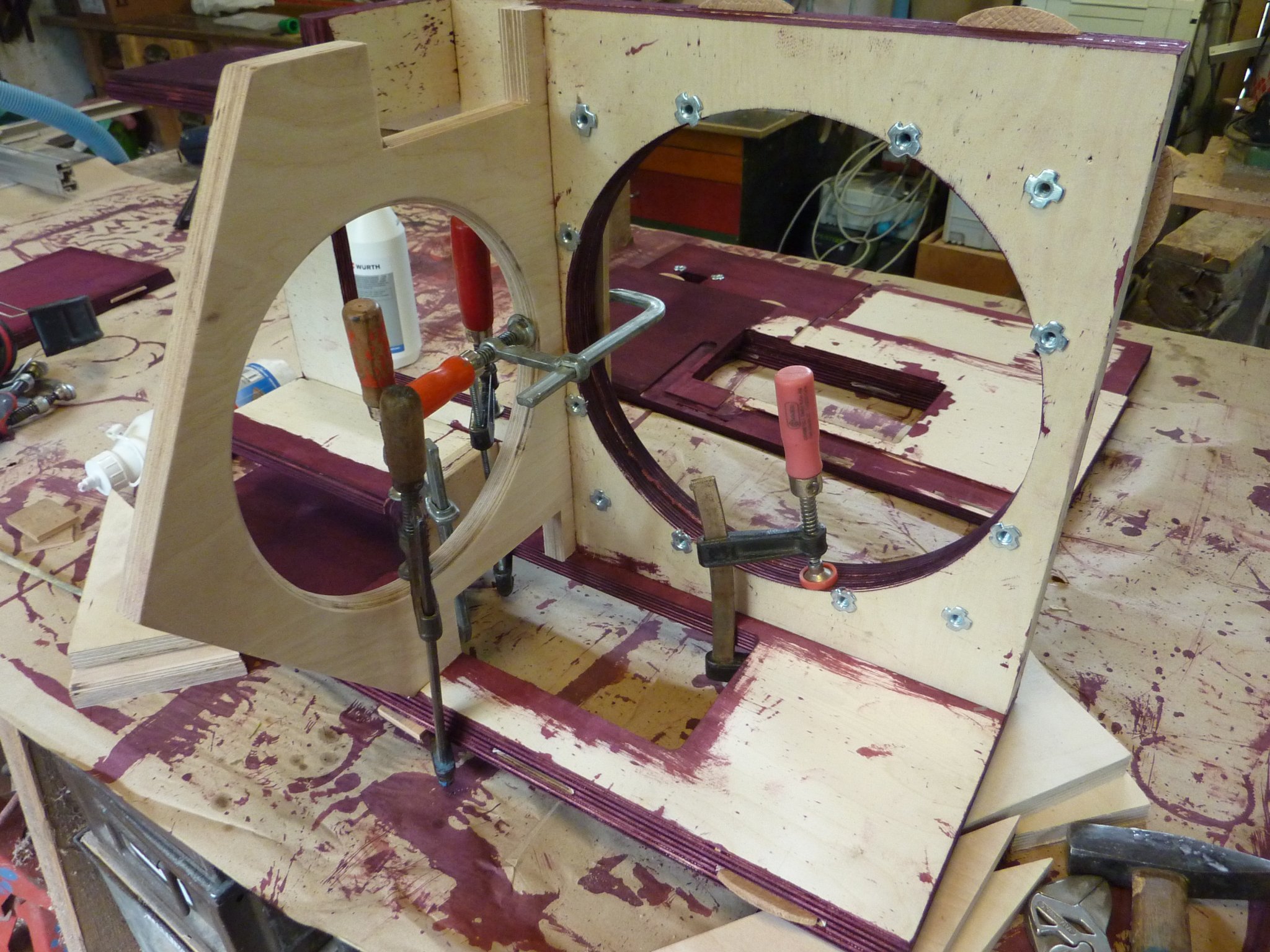

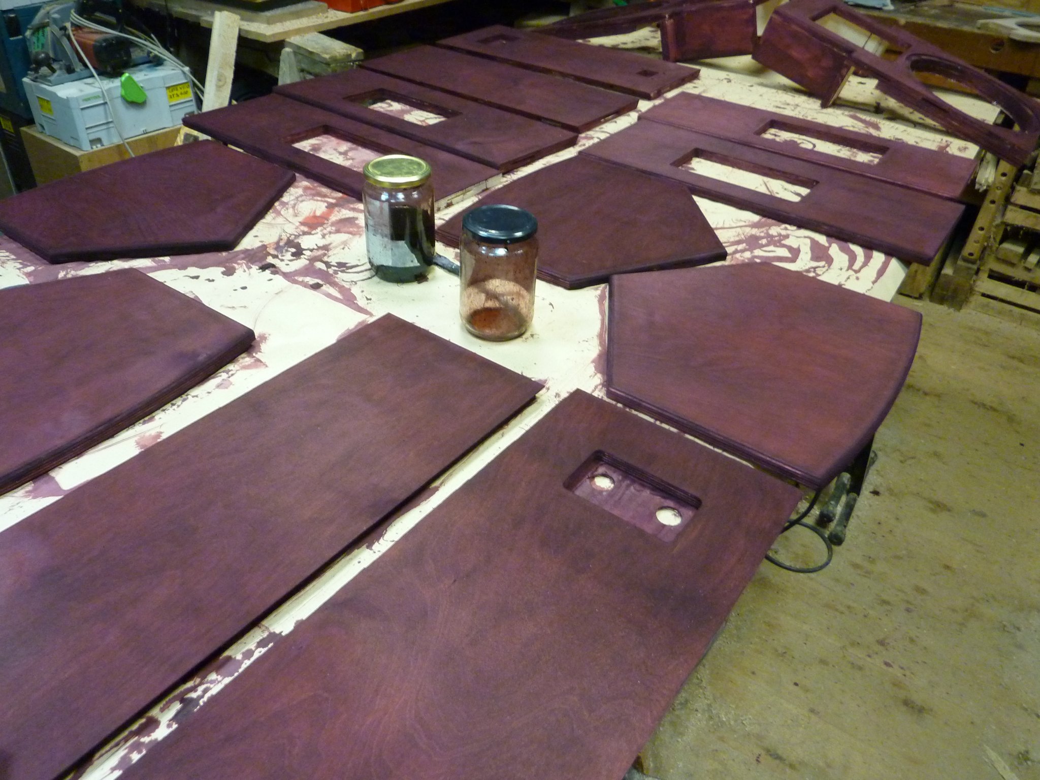

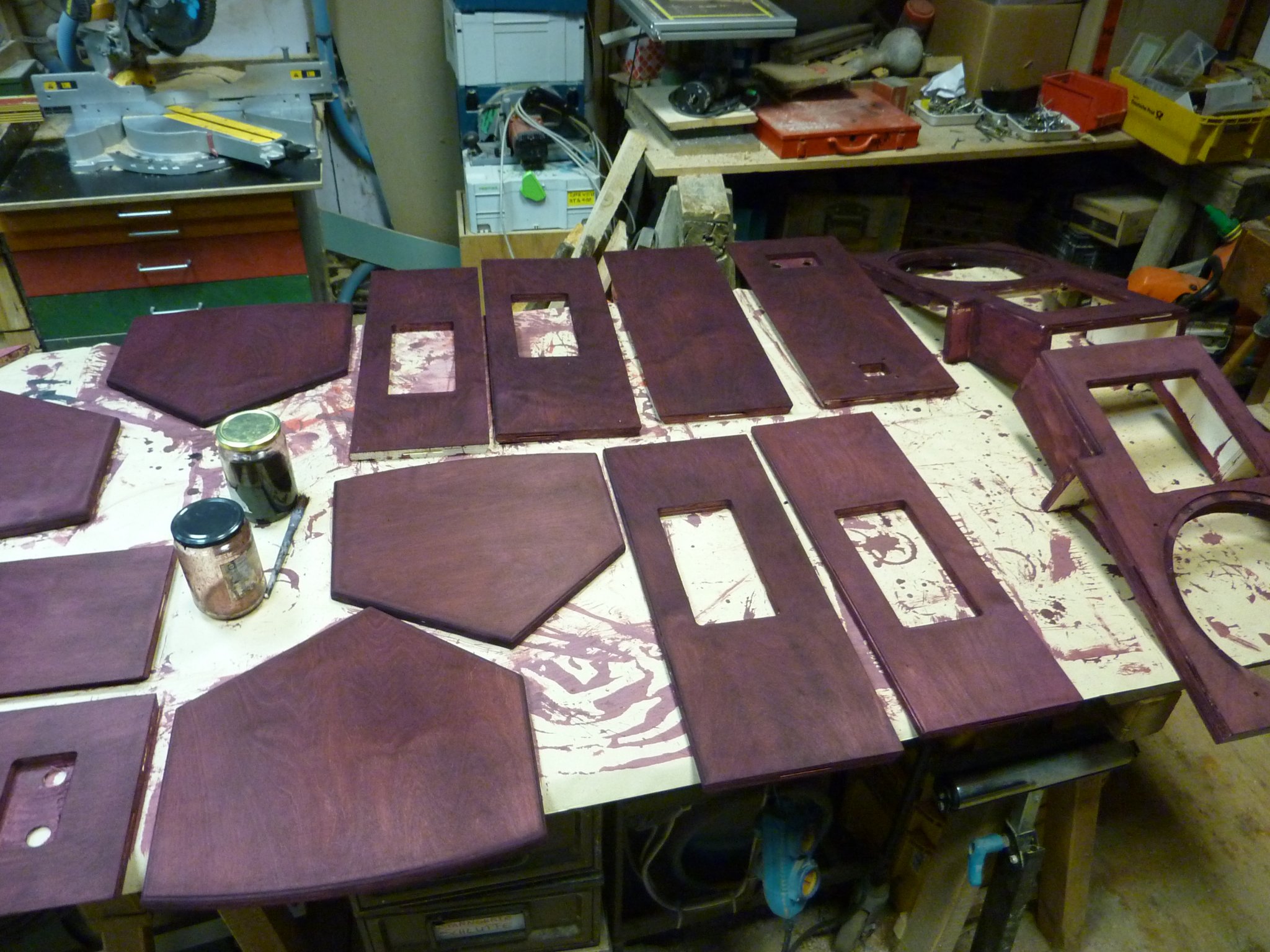

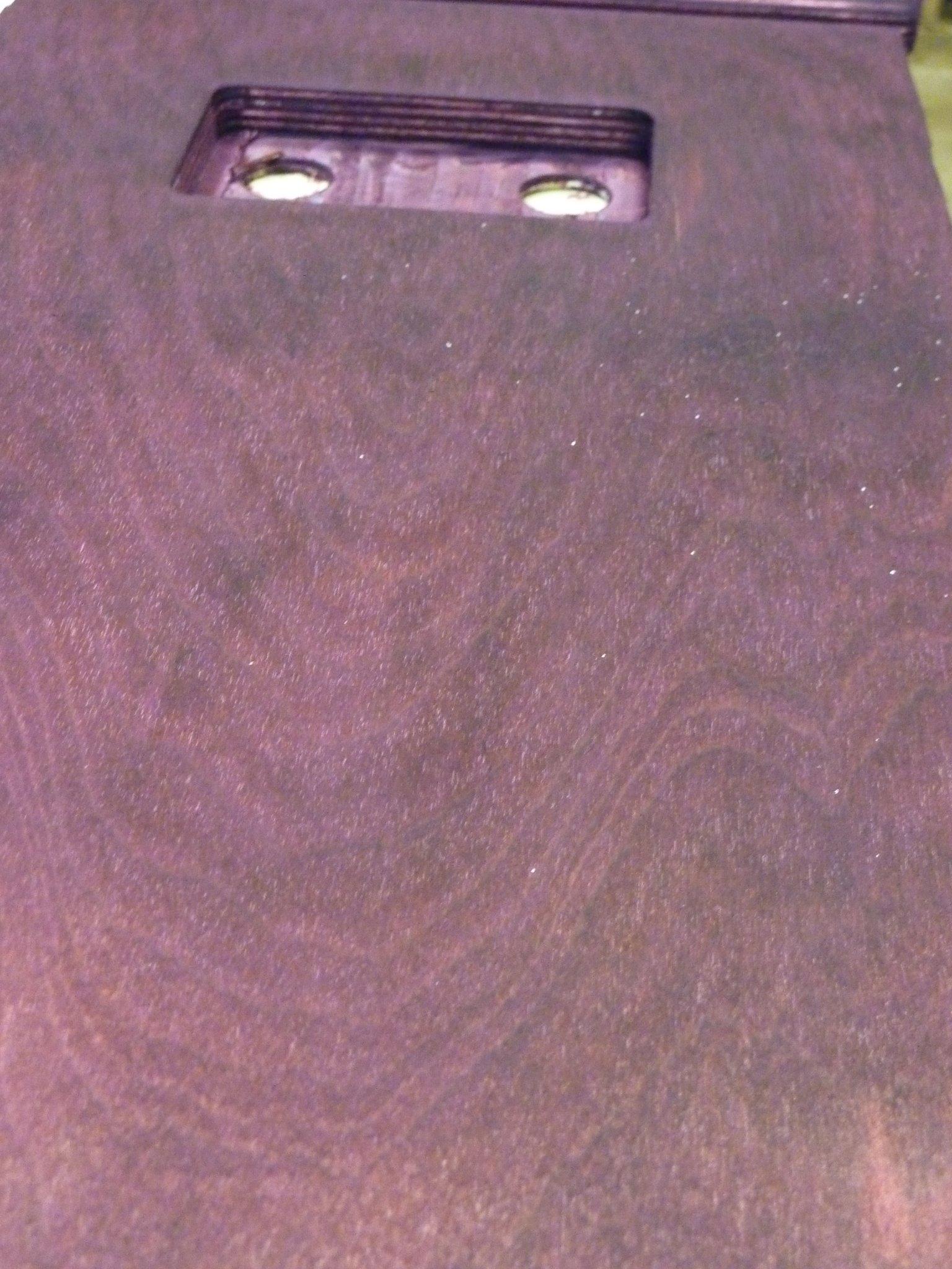

I drill the holes for M6 with a 6.5 wood drill completely thru, and from the backside with 8mm the same hole just 10mm deep to fit the drive-in nuts.
is it needed to seal the screws with aryl as well ? (to get it air proof)...

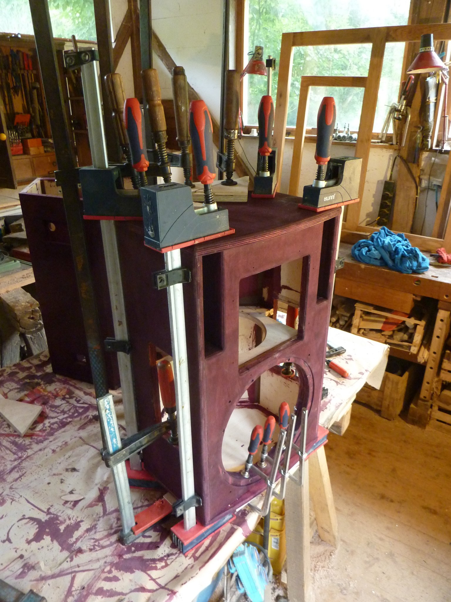

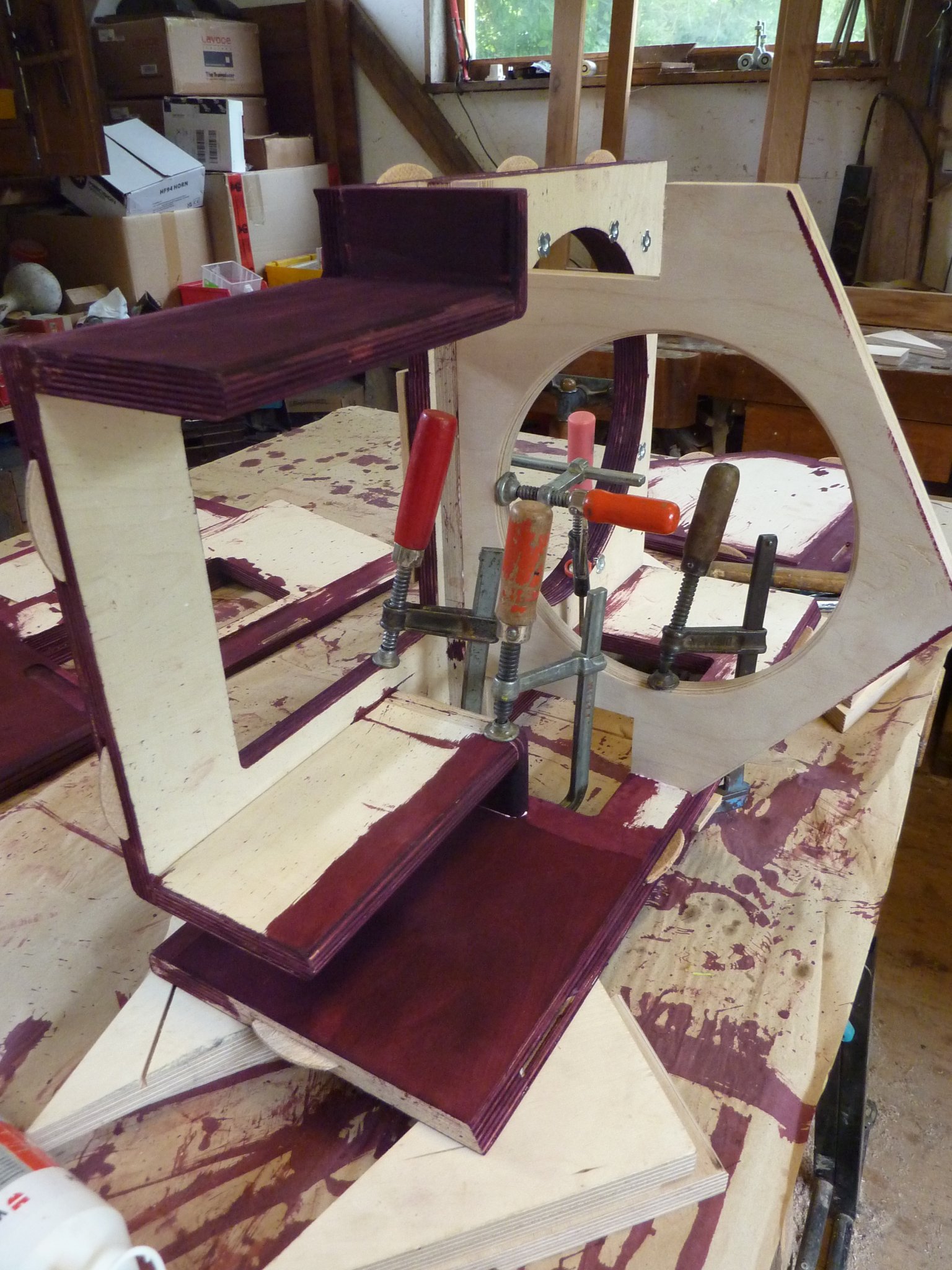

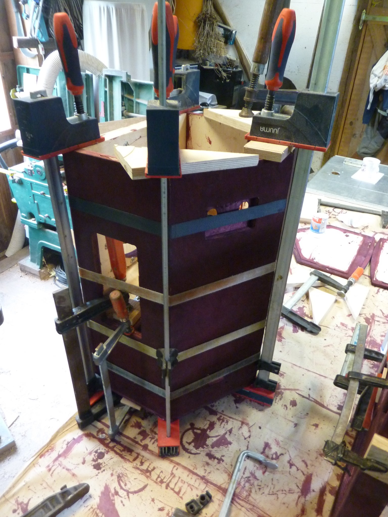

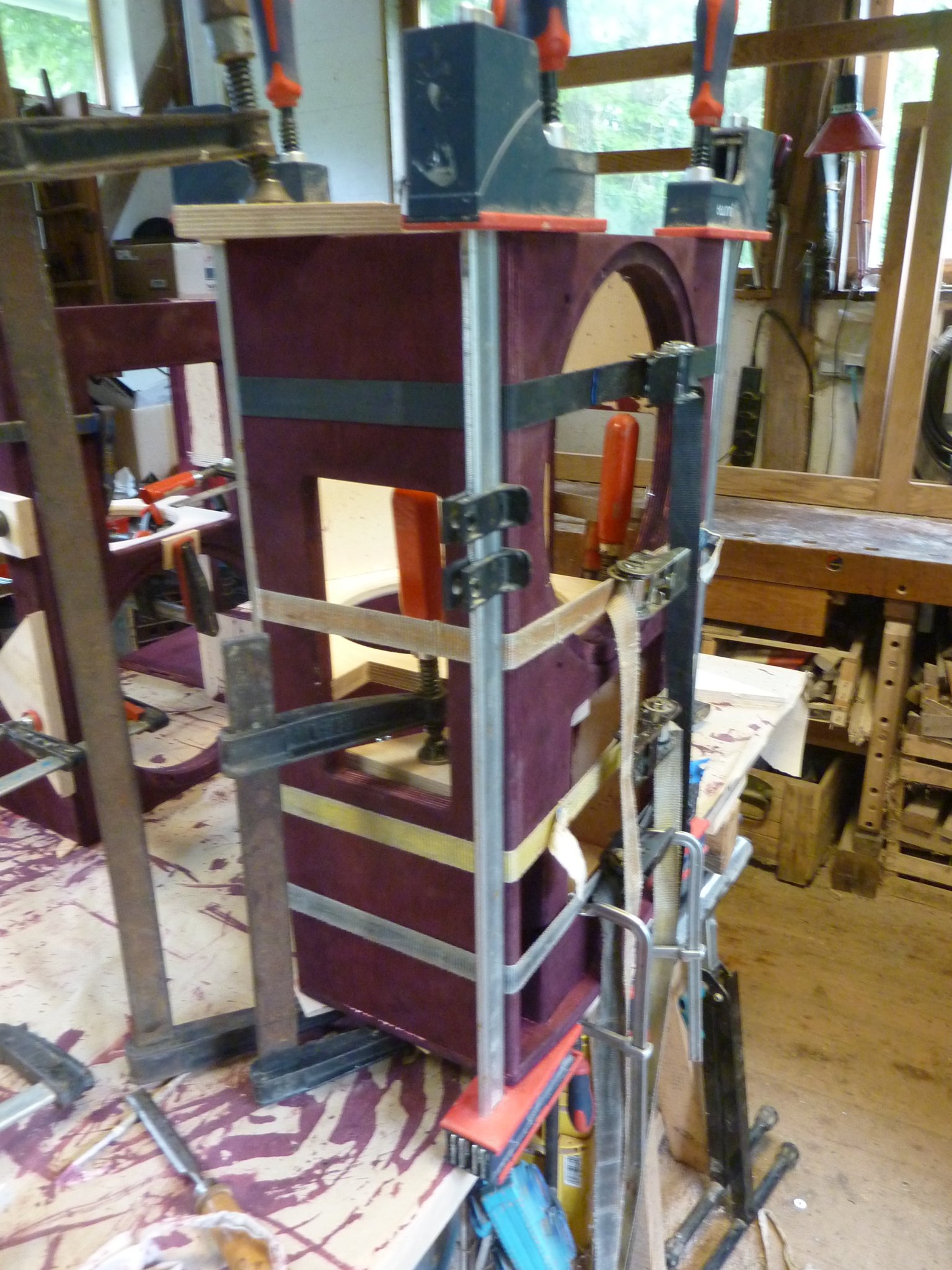

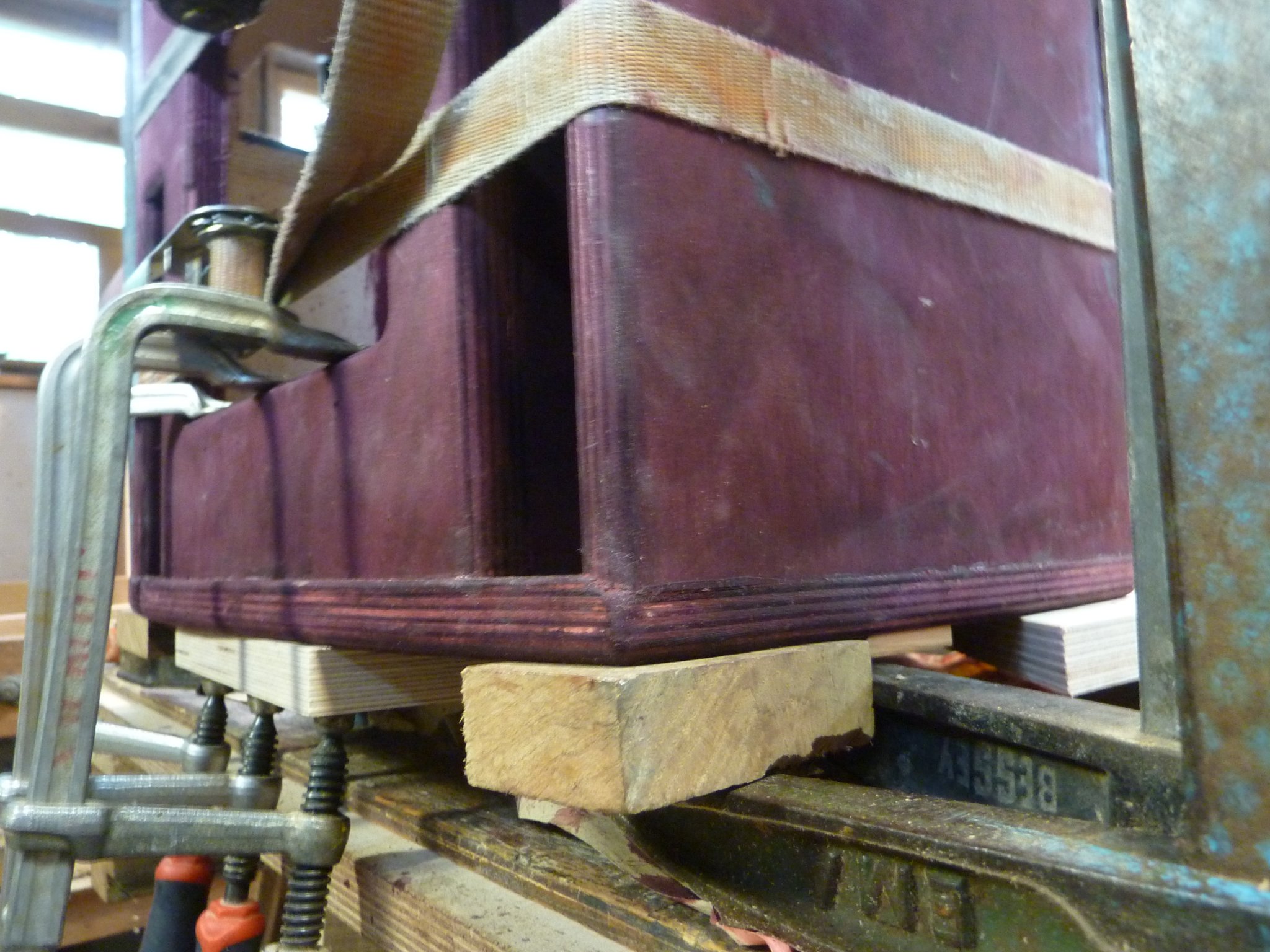

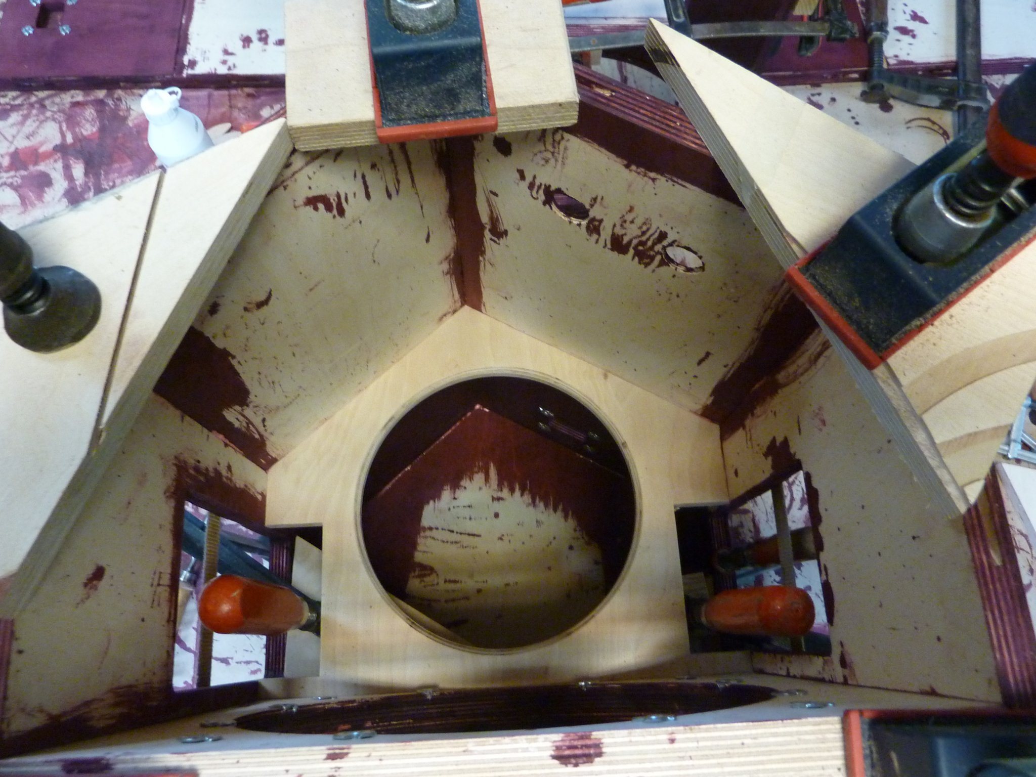

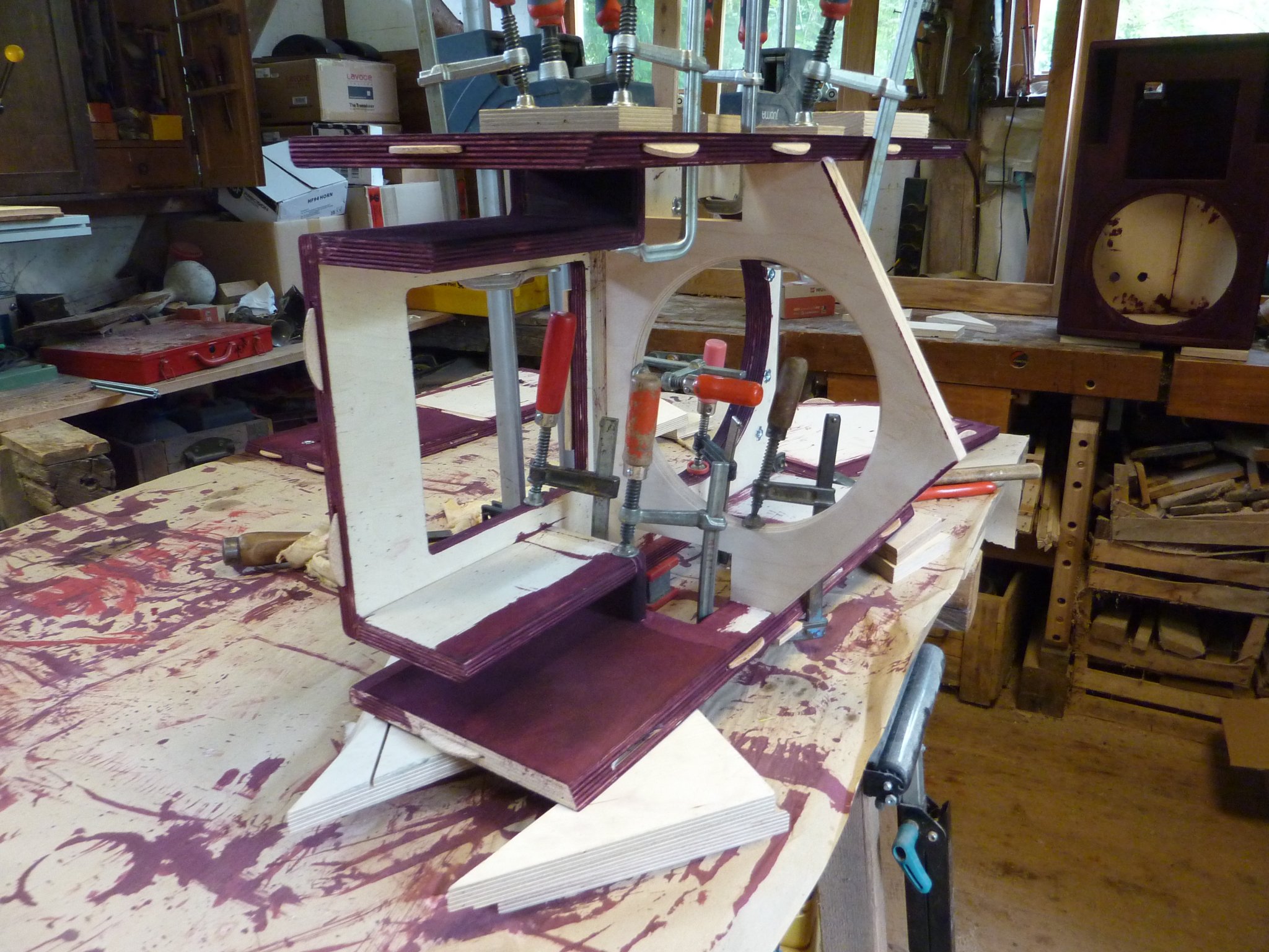

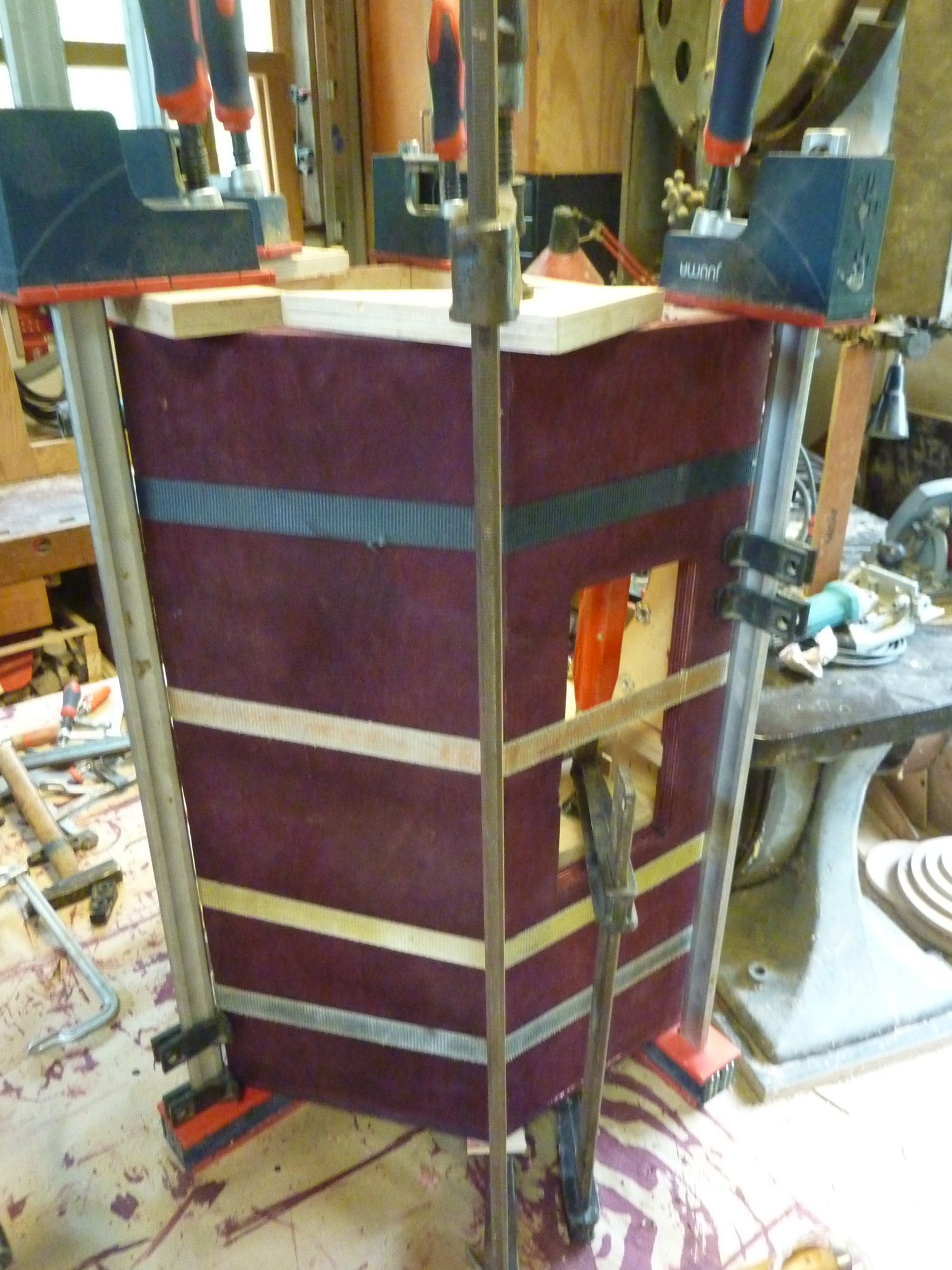

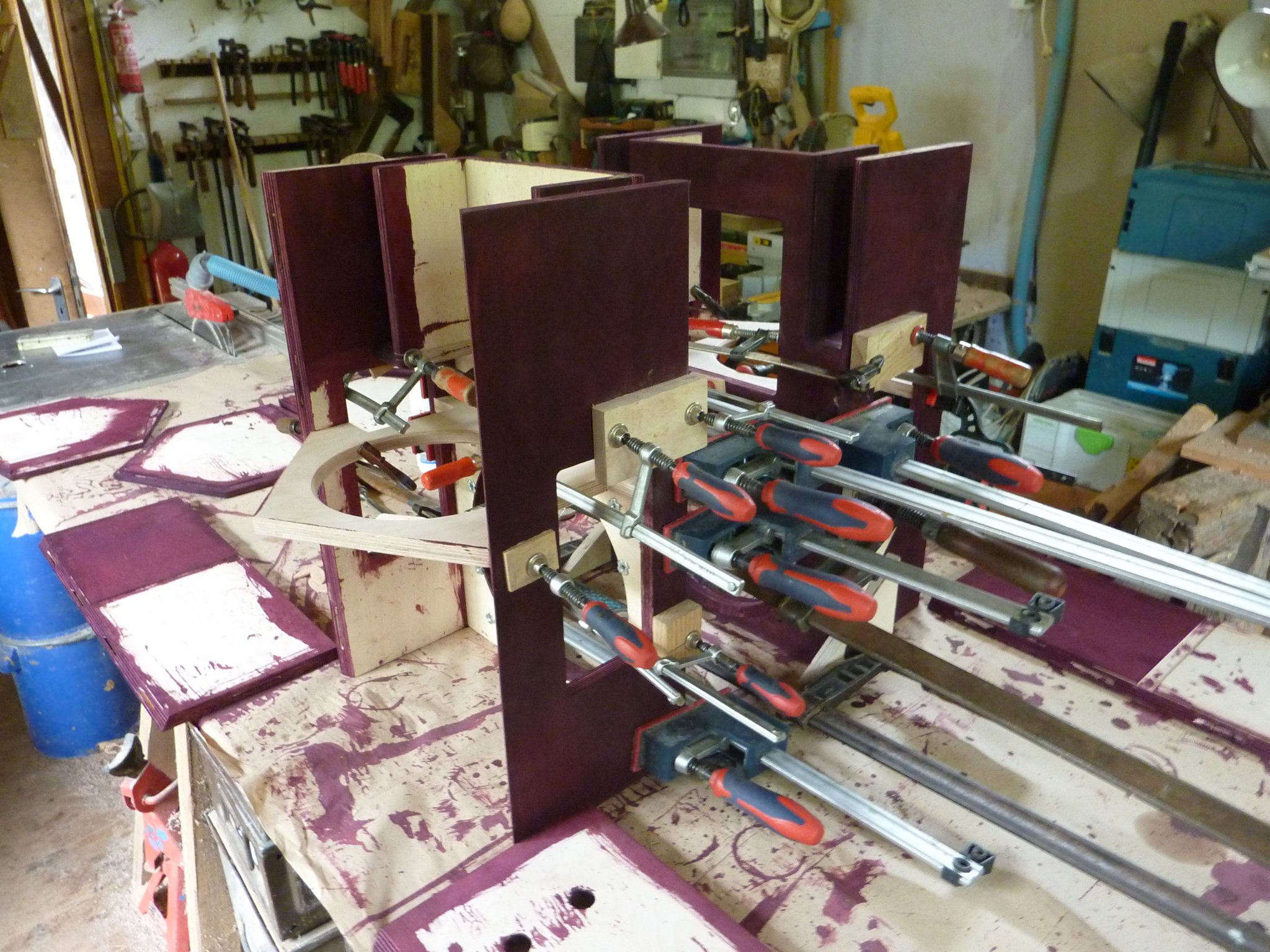

to get the cookies slots right on the beveled angles is not so easy, take soem practice and some re adjustments, the glue will fill the gabs where the slots got wider as intended...

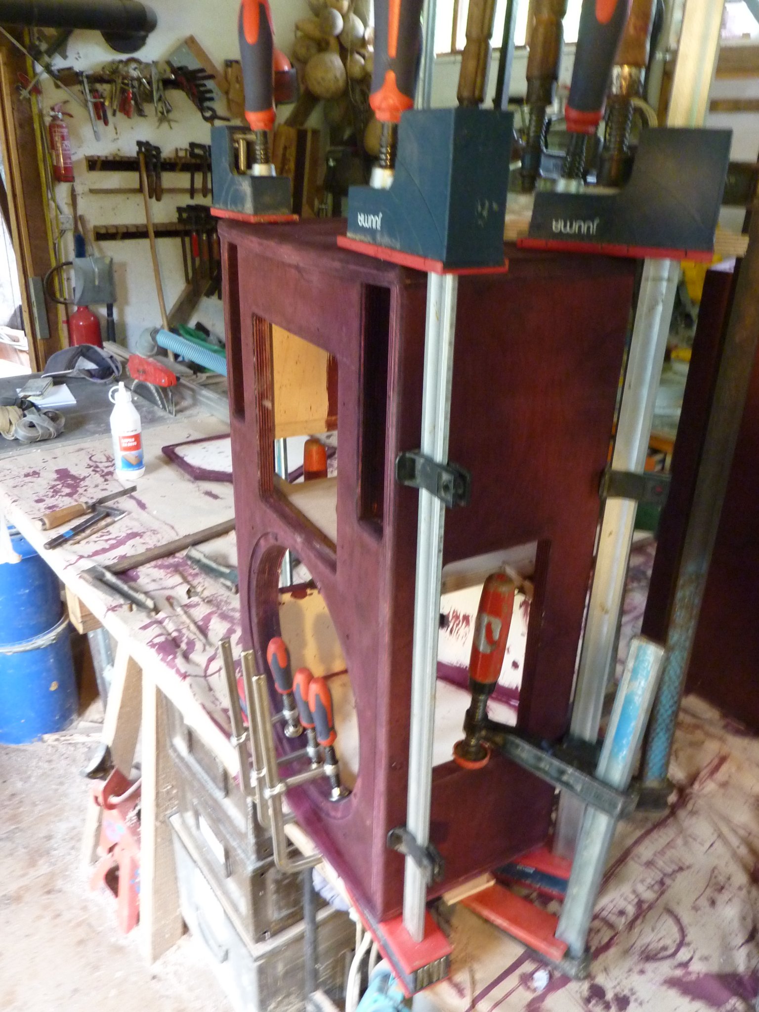

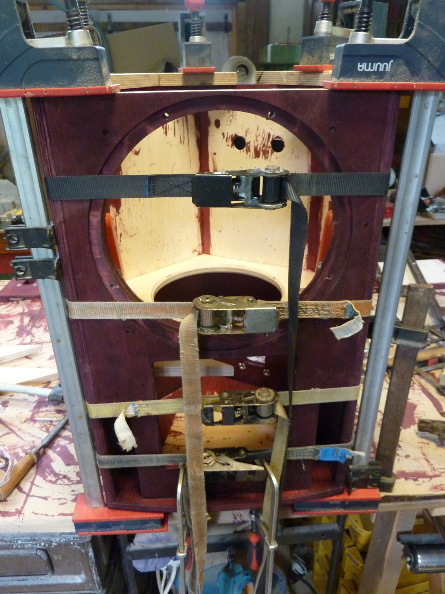

more pics of cookie joins for the second speaker:

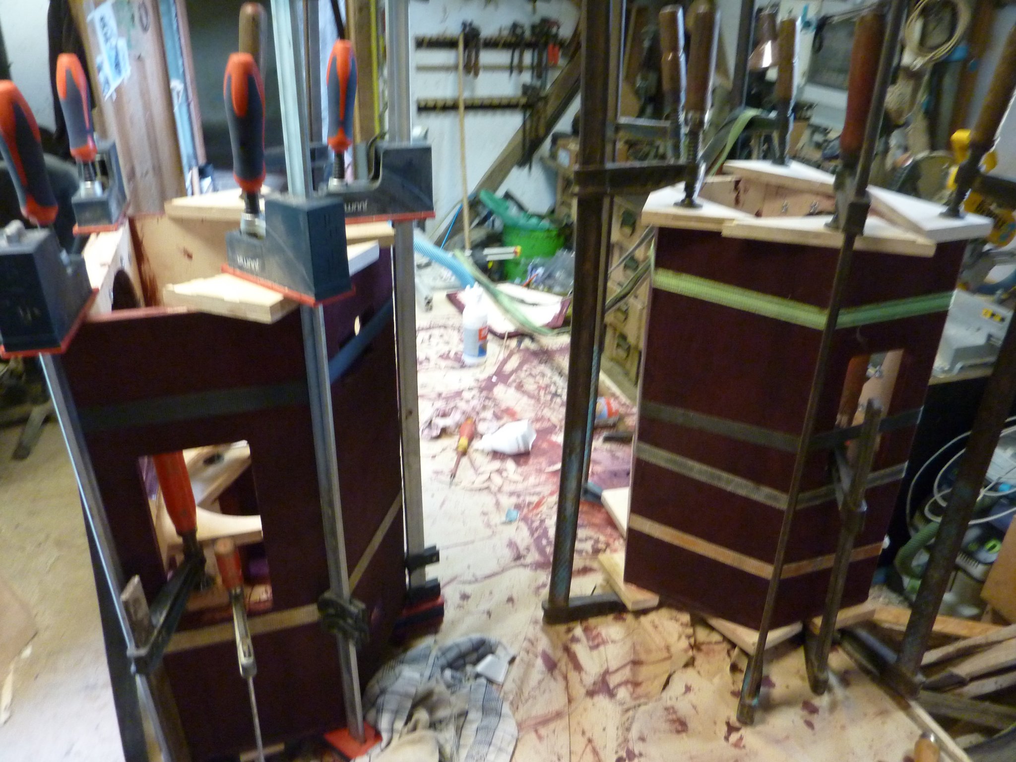

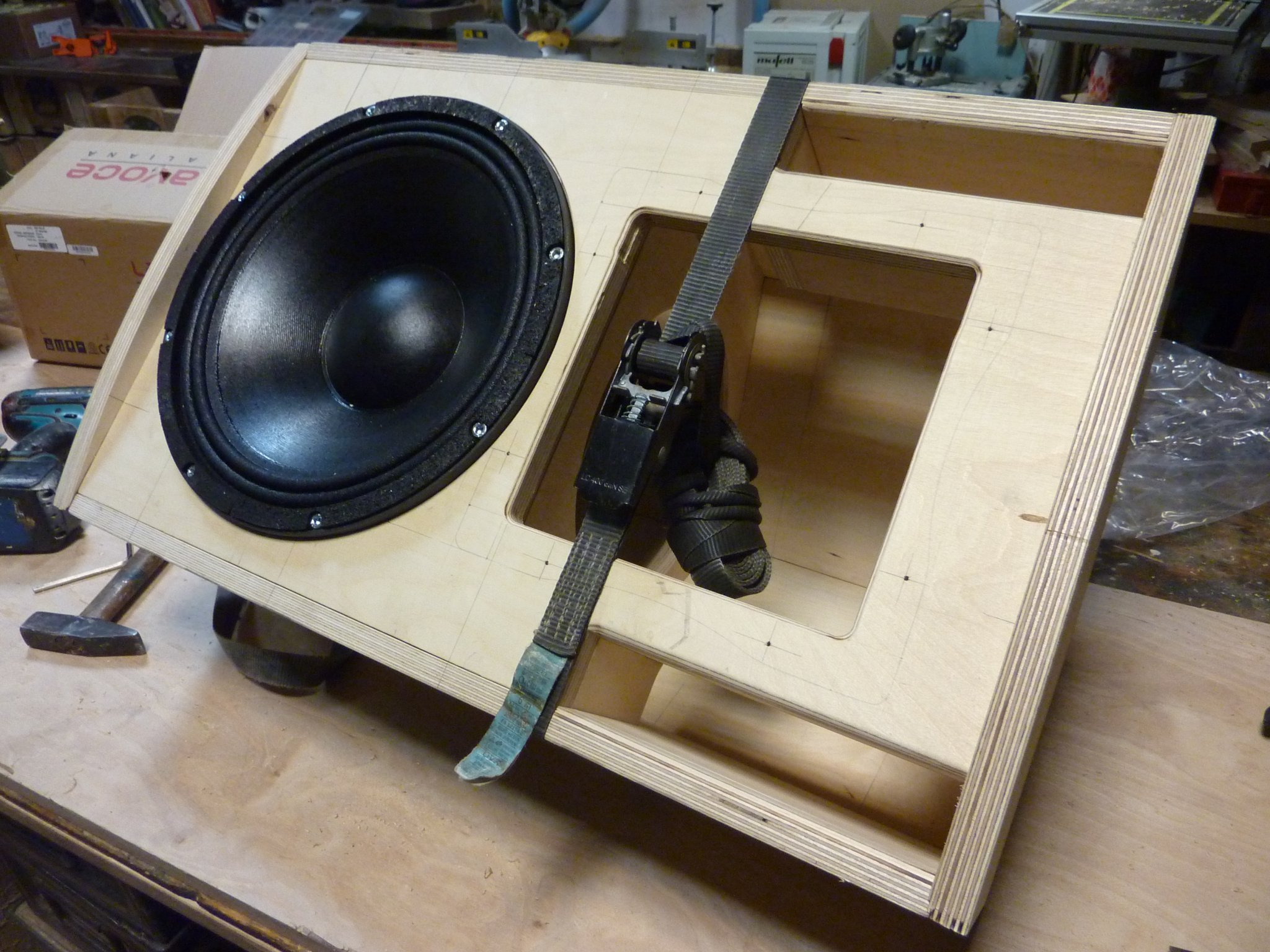

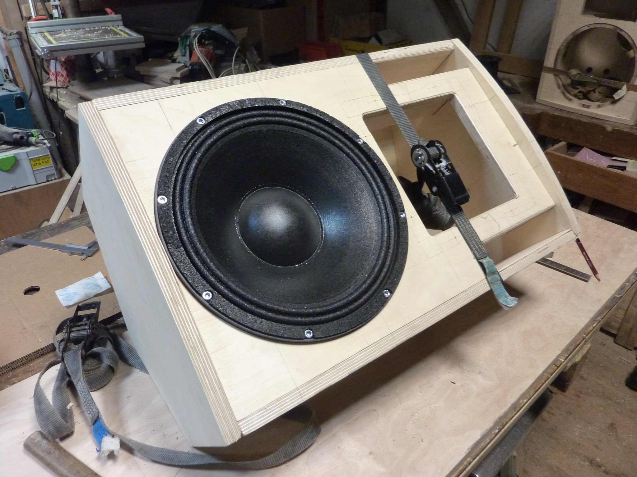

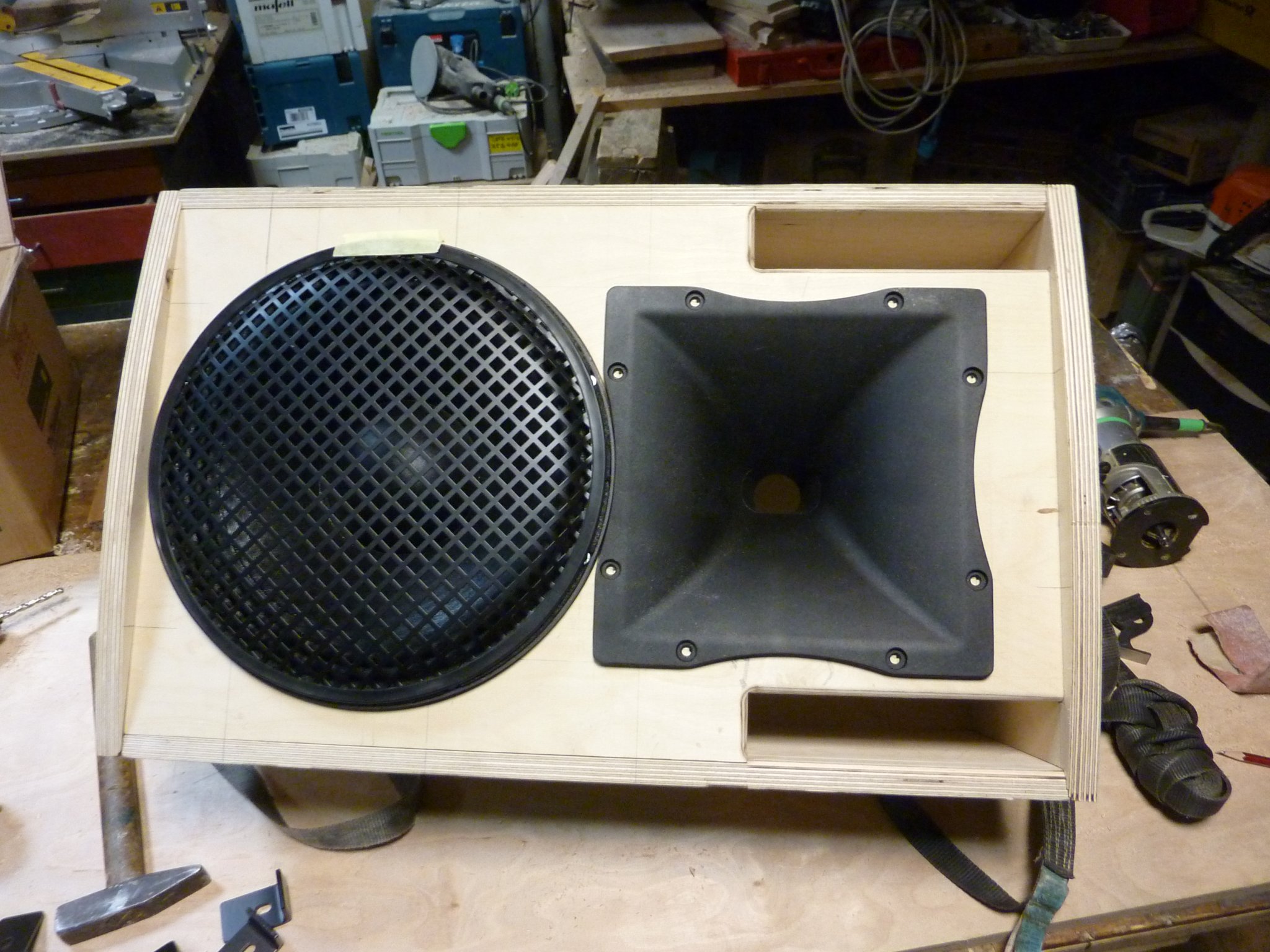

the first test fit, the cabinet is not yet glued, but i think its ready for it now.

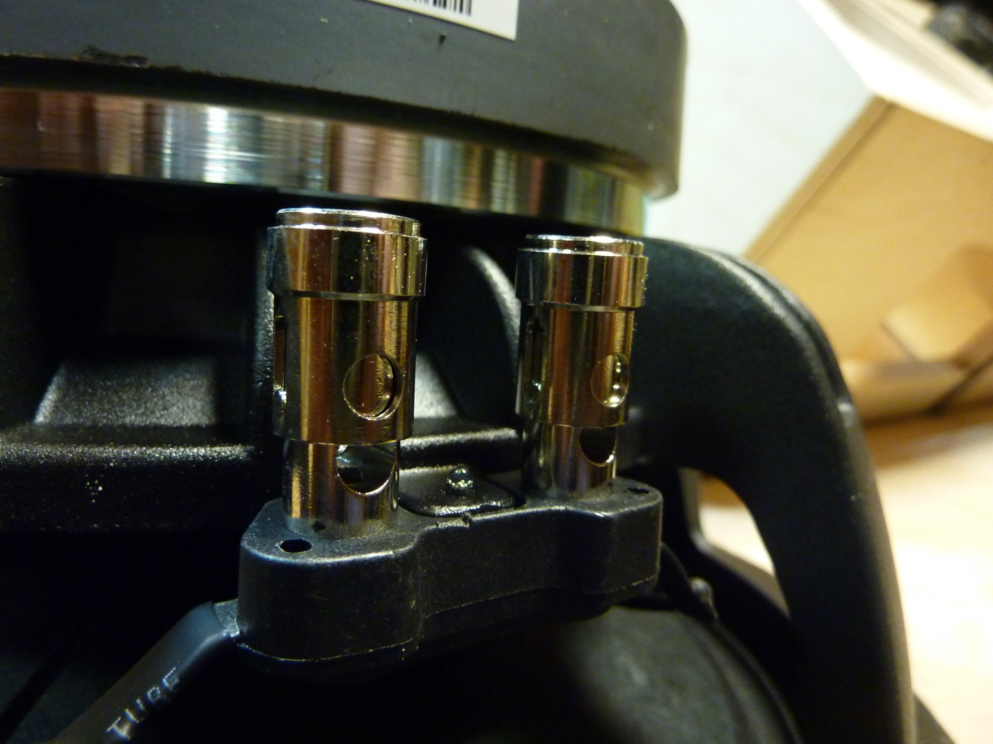

should i just strip the cable and but them in this spring loaded terminal? or other method are better ?
would you crimp or solder the neutric connector what i build in the back wall of the cabinet ?
