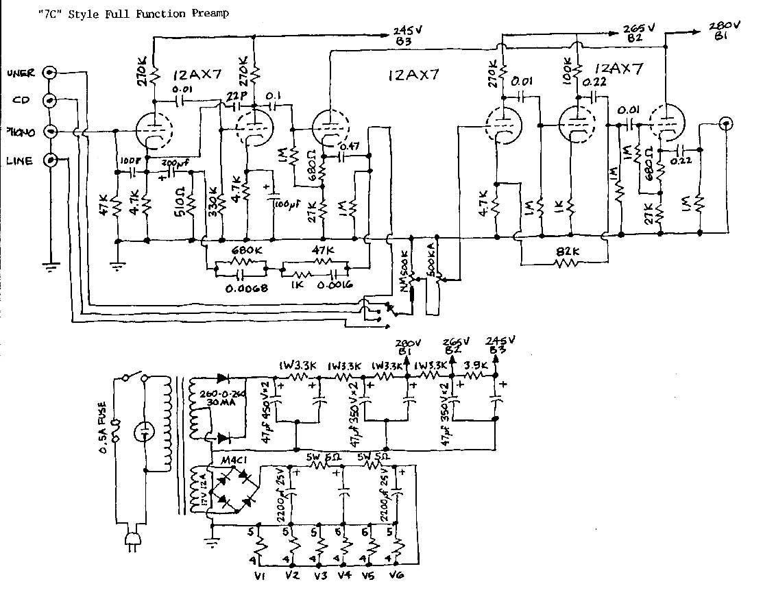

I hope I can connect it like a regular AC output from a standard transformer and build the power supply for a Marantz 7C clone using a silicone rectifier bridge and capacitors? Do you think I can skip the capacitors for the tube heaters? Simply connect them directly to 12V DC stabilized power from the 12v 8A adapter?
See attached schematic I found on YouTube
It's similar. Different transformer so you'll need a Delon doubler, and usually these switch at 20kHz where the DC one I linked is set for 37kHz.
As shown you can't use it in that schematic because there's no 520VCT output hence the Delon doubler (Full wave)
Otherwise you can do whatever you want but use fast diodes like HER208 or similar. 1N4007 will fail shorted.

I found a schematic on YouTube, see my previous, edited post, but I may buy this board/kit on Ali:
SUQIYA PRT07A tube preamplifier finished board reference Marantz 7 circuit|Amplifier| - AliExpress
or this McIntosh C22 variant:
Tube Amplifier Preamp PRT03A Tube Preamplifier Board DIY Kits C22 Electric Circuit 068|Amplifier| - AliExpress
They both seem to require 280 VDC and 12.6 VDC.
Not sure why they write 280 VDC, Two groups, though.. In the schematic they just added resistors for voltage drops to the three valves. Do you understand why they specify Two groups? Would I need Two of the DC to AC converters?
Not sure why they write 280 VDC, Two groups, though.. In the PREVIOUS schematic they just added resistors for voltage drops to the three valves. Do you understand why they specify Two groups for the kits? Would I need Two of the DC to AC converters?

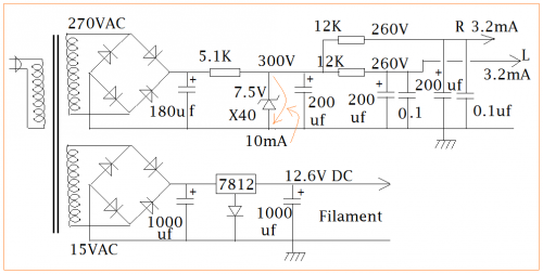

This guy in this chinese article:
彷制马兰士 Marantz 7 M7 胆前级放大器 | TTRadio
uses 40 7.5V Zener diodes in series to regulate the voltage, see attached pic:

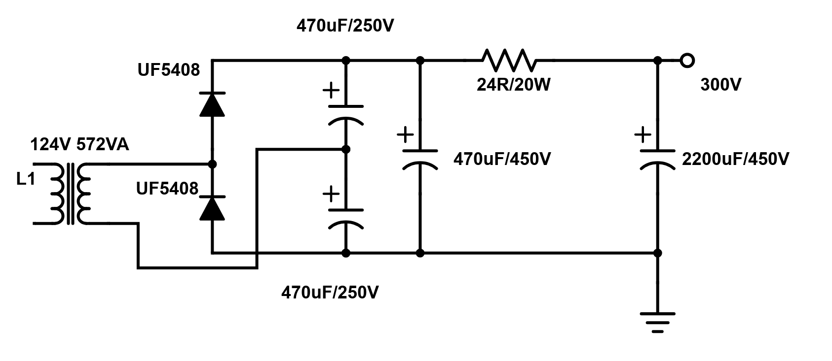

You can the the above schematic, but replace two of the diodes with 470uF 250V capacitors and go from the 175V output (this will give you nearly the same voltages at in the above pic you attached...
Here's an example of the Delon. Not the right values for you, but you see how it works. With your square wave input, RMS becomes 0.5x peak so this makes 175x2=350V. If the above example below was square wave, the output voltage would be closer to 230V

Thanks for the schematic!
Three big capacitors, one even bigger and special diodes are all required to get the Delon to work?
I think I will go for the model you recommended first, and pay import duties, after all.
I just wish there were smaller converters that could do the trick. The tubes only require 280 VDC @20 mA, efter all.
I am not very skilled in high voltage designs, the Delon looks a bit intimidating. I wish there was a simpler way to create 280VC 50mA (for some headroom) from 12VDC.
