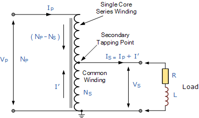

Has been done in the past. If done now (here at least) no insurance company will help out when things go wrong. Problem is that it only works OK/safe when one always connects L and N to the right wires which is not guaranteed with for instance Schuko sockets. If not for the end user then the tech that services/repairs such an installation is in straight danger. One might argue that transformers work both ways as well so when things go wrong on the AC part of things an unsafe voltage can occur at the primary/input side of transformers. This is often forgotten, also in industrial installations. Needless to say that it also will never be approved.
As it is solely price driven it makes no sense (P goes before S and Q). Big no no, plain wrong engineering.
Usually the autotransformer follows. I have recently seen a 25 kV version of it. Nothing but trouble and forbidden since ages for consumers here.

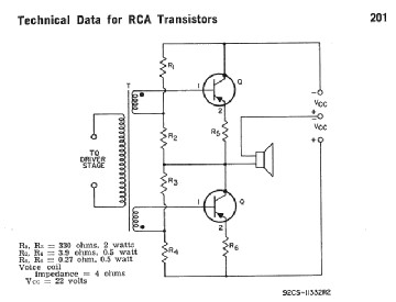

At the time I built this there, were at least two commercial guitar amps using a similar design and running a pair of Delco high voltage transistors directly from rectified line voltage. The one that I got to repair was a Danelectro brand. It was a combo amp and used a pair of 16 ohm speakers in series. It flamed out in spectacular fashion when the owner tried to wire up some external 8 ohm speakers. The Delco transistors were no longer made, so I had to add a power transformer and convert the thing to a conventional guitar amp design.
I enclosed the typical totem pole schematic from an old RCA transistor manual. Mine did not use split supplies, it had a large cap in series with the speaker.

Interesting that, the yopology is nearly identical to that of a Class D RF amp.

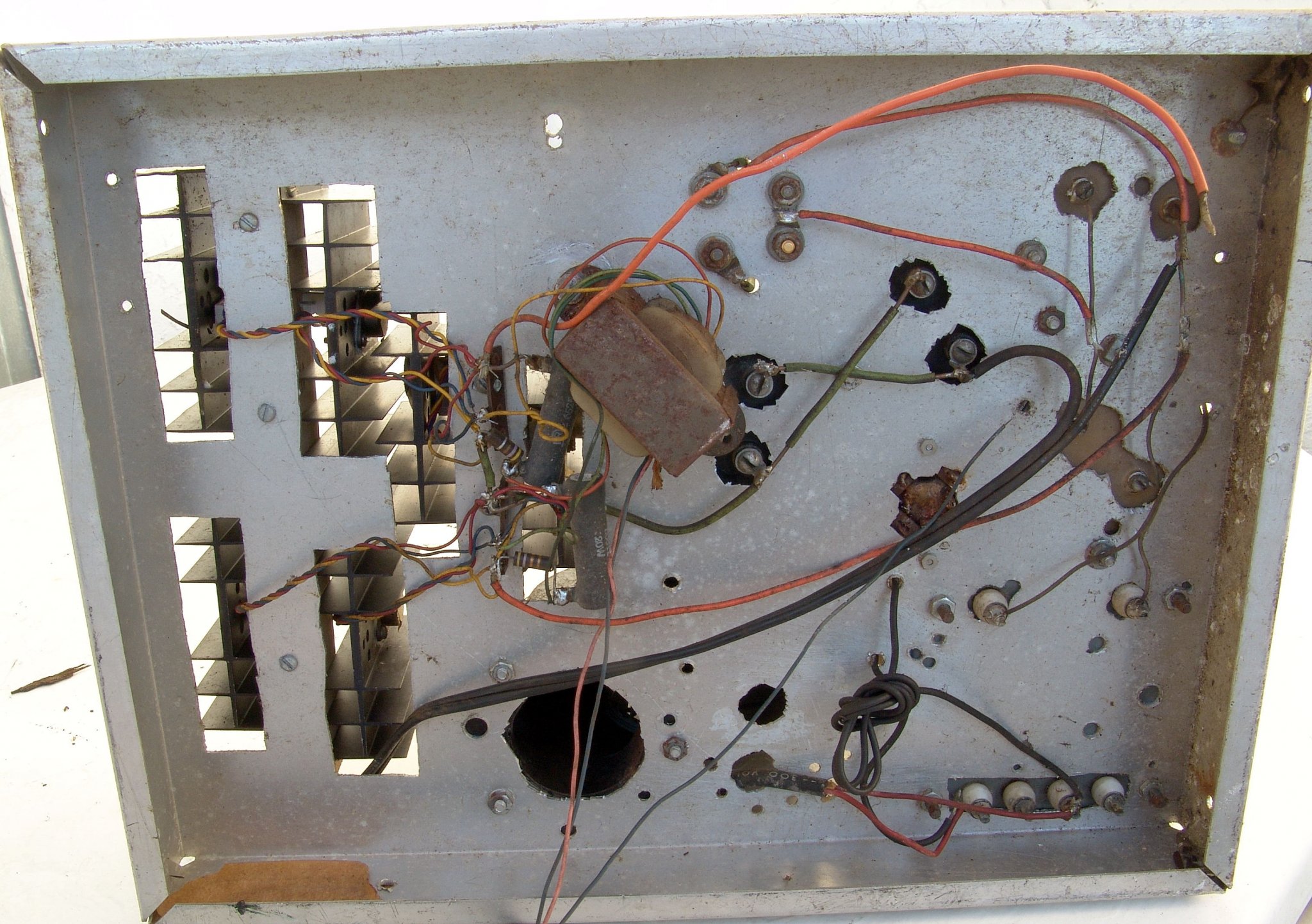

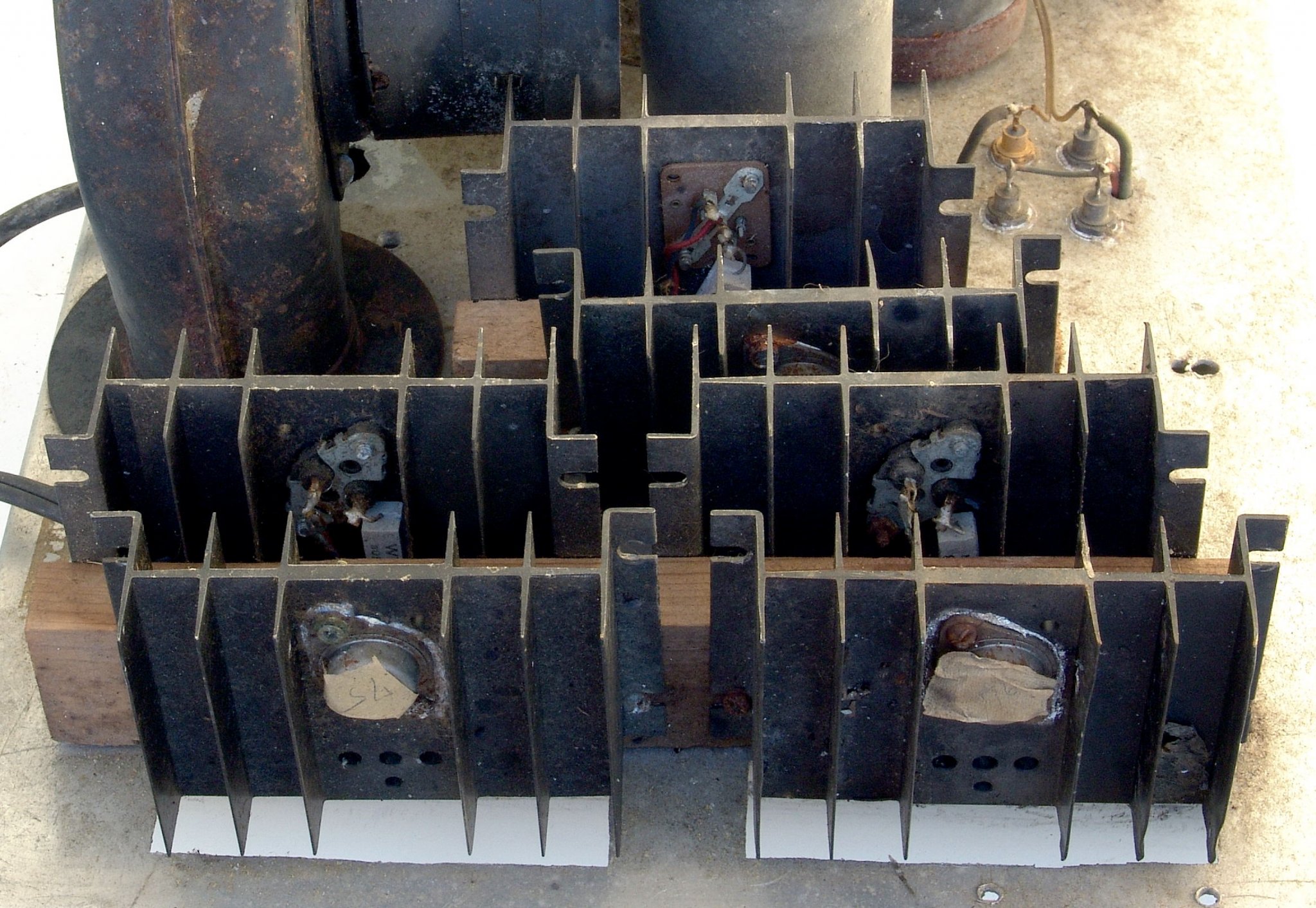

The circuit I showed, often called a "totem pole" design was pretty common in the mid 60's. I learned about it when I built a Heathkit AR13 receiver kit for my neighbor when I was 12 (1964). I saved up enough money to buy one of those three winding driver transformers at the Heathkit store and started making my own amps, mostly for guitar as I only had one transformer. Almost every amp I saw that used that circuit as a repair guy in the late 70's used 2N2147's. As a kid I used what was free, those big old TO-36 "doorknob" transistors found on the back of early 60's car radios. My variable power supply was a DIY rectifier and filter connected to a big Lionel train transformer. With the transformer at "full speed" I got about 24 volts which was about the limit on those "free" transistors. Want the guitar amp louder? Then keep connecting more speakers until it blows up, fix it, then remove the lousiest speaker. Most of my speakers came out of old radios, TV's, and stuff. Only the strong survived.....my guitar playing.

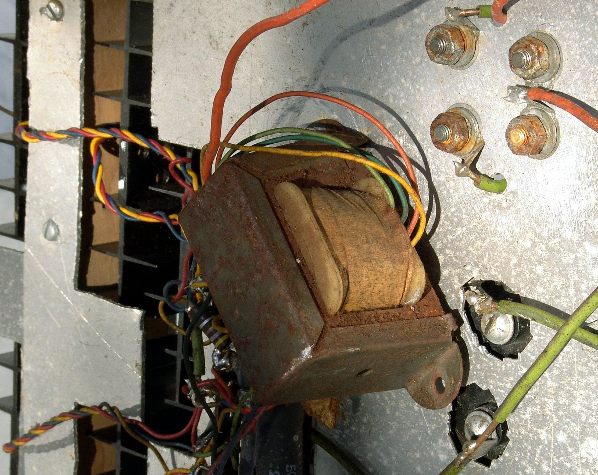

A few years later I was winding my own driver transformers and connecting up multiple pairs of transistors to them. About 50 years after its construction I found one of my early creations as I was planning to move everything I owned out of Florida. This was made in 1967 or 1968 using only a hand drill and a nibbling tool. The driver transformer was wound on the core of a fried Radio Shack filament transformer. The 6 output transistors were a salvage yard find, sold as "2N3055s." Whatever they really are remains a mystery, but these ran for years on a B+ supply of just over 100 volts, note the labels from my "HFE matching" exercise. I saved the transistors and heat sinks, and tossed the rest, as it was not worth moving. It had been left in a shed that was decapitated by hurricane Wilma. Smoke happened when I jumped the blown fuse and plugged it in outdoors. One of the big electrolytics spewed.

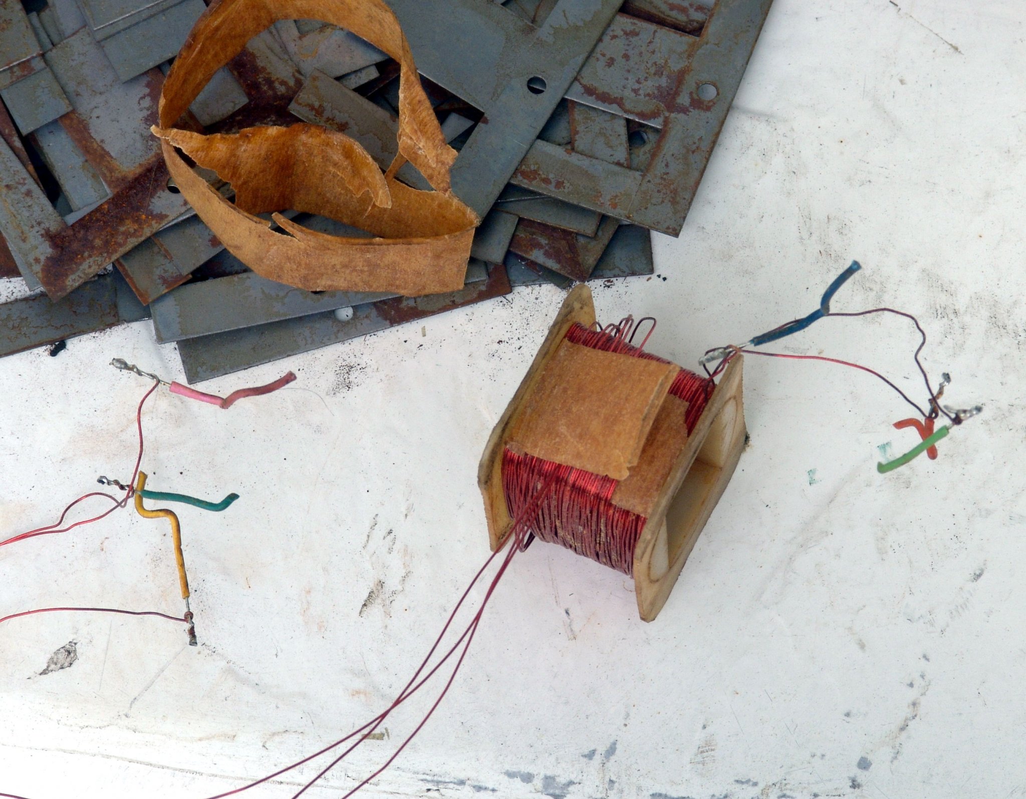

I took my DIY driver transformer apart to see what I did when I was 15. Yes, that is masking tape after nearly 50 years. I used the same stuff when winding new secondaries on the primaries of transformers removed from dead TV sets. Cheap or free transformers for solid state amps were not easy to find in the 60's and you can only connect so many random non-identical filament transformers together before the weakest one fries. I would not do any of this stuff today, but 15 year old kids are invincible in their own minds, right? Unfortunately two of my friends did not live long enough to finish high school, but drugs and stupidity were involved there.
The BIG amp with 24 X 2N3773's used the same circuit and DIY transformer. At least it was a dual bobbin transformer.
