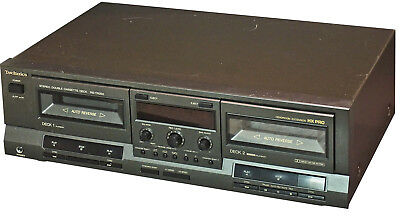

I purchased my Technics RS-TR333 new in 2004, for $199.
Amazing build quality, still on original belts and playing perfectly.

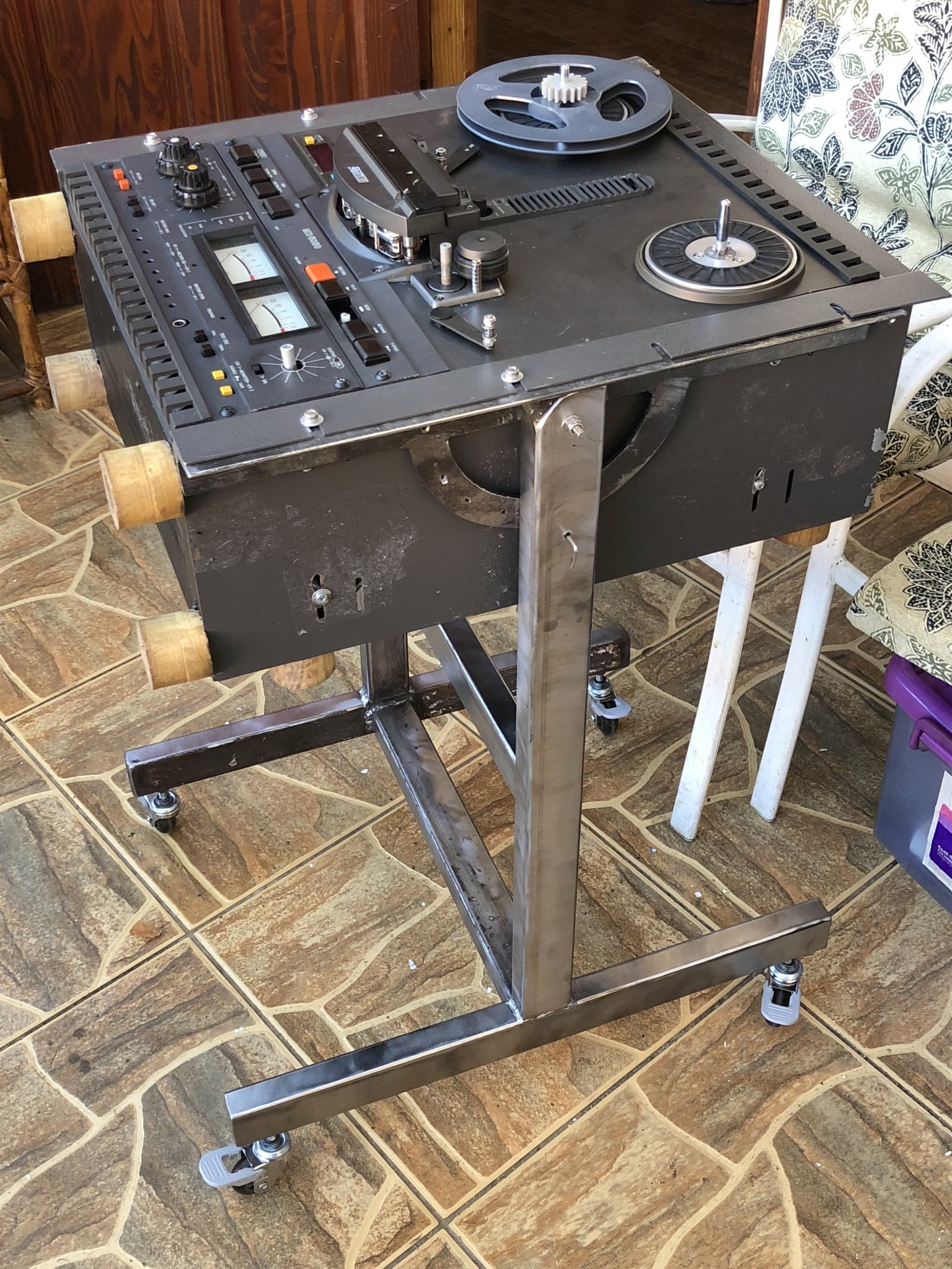

PS: I even made a cart fot it...

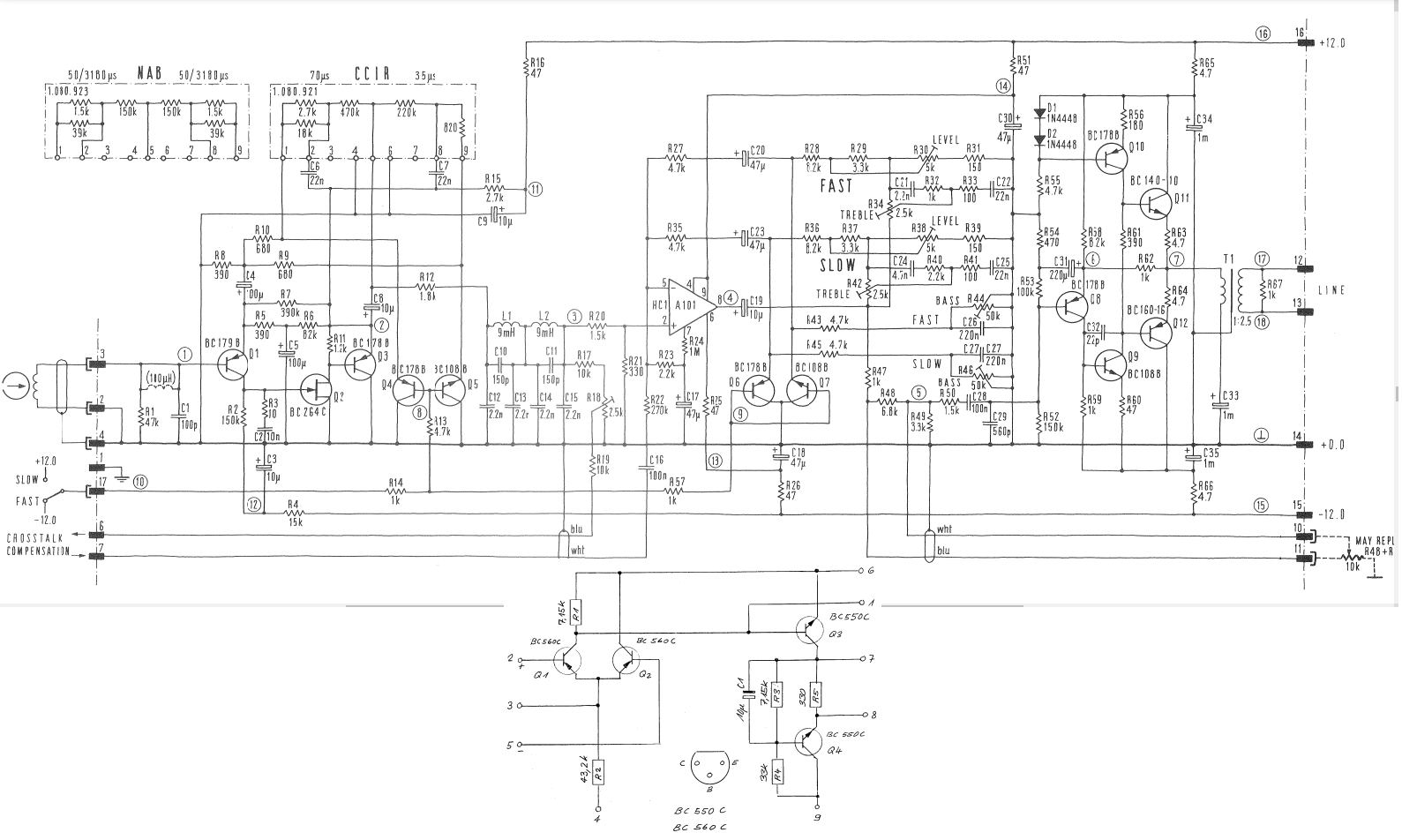

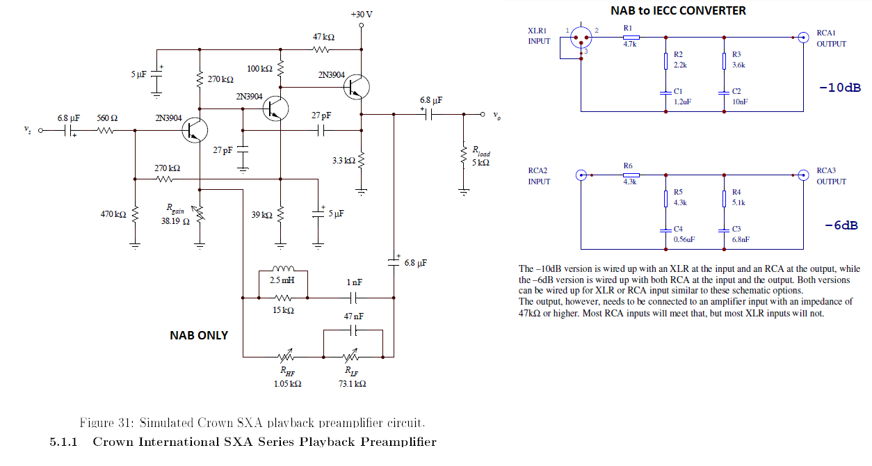

About external repro preamplifiers: indeed I was searching for them when I stumbled upon your thread. The previously quoted tesis about "transresistance preamp" showed a Crown discrete preamp and their siblings can be found on hifiengine, with Studer B62 which is also feasible. The hard part would be the several speeds and the bias circuit and adjustement...
https://www.hifiengine.com/manual_library/crown/pro-800-series.shtml

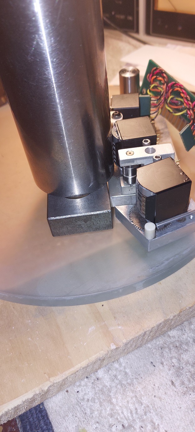

WRT head re lapping discussion (some time ago), it can be a little more challenging on wider pro formats.
Shown here I use a flat ground glass surface plate, Toolmkaers ground parallels to build height and a Toolmakers cylinder square to check the heads perpendicular accuracy.
Wider tape formats such as 1" and especially 2" can take a little more time to get right. Also shown 1/2" repro head after re lapping.

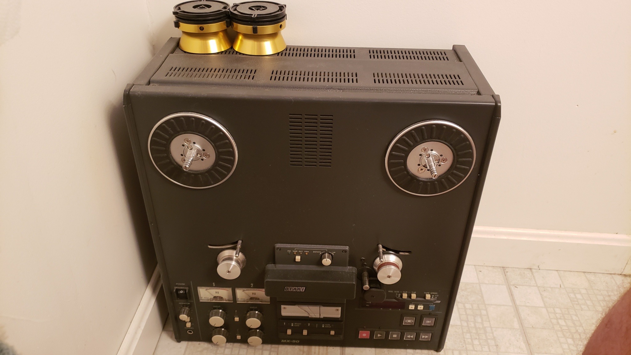

HELP! Otari MX-50N-II Made in 1992
Help needed. I picked one of these up for $499.00 at a thrift store. I tested it and everything seemed to work however I neglected to check to the capstan! The item does not appear to be mistreated or over used. I have until this Saturday to return if I can not get it going.
The capstan moves very smoothly with my hand, other than that it is completely dead. It does not seem to be seized. I have used deoxit on all buttons with no response from the capstan motor, checked fuses and looked for soldier cracks on the boards. All looks good.
I know the MX-5050 has a switch (V-5-1A44 UND.LAB.INC) that often needs to be cleaned to turn on the capstan motor. I have not found a switch like that on the MX-50N.
The following video shows that switch.
I am a novice any suggestions would be greatly appreciated. Thanks.

Did you load tape onto the machine? I have an MX-50N, and an MX-50NII both needed a complete recap.
Does the capstan pulley solenoid pull in? It does not run at either 7.5ips or 15ips? Does not respond to position of the tension arm?
I paid the same sort of money for each of mine in non-running condition, but was comfortable with the risk and was able to fix both of them. IMO they are better performers than the ubiquitous MX-5050 BII-2.
It has been a long time since I messed around with these machines, and they are quite complex and not easy to fix if you not know what you are doing.
If the capstan motor is actually nonfunctional it would be best to return for a refund, otherwise the price is reasonable for a project deck. (Good working ones sell for as much as $2K although some sellers ask more)
Administrator
Joined 2004
Download the service/operators manual for the MX-50NII, and consult it for more details. The MX-5050 is a very different machine in a lot of respects.
Most of the circuitry in the N and NII is identical except in the headphone monitor circuitry. Make sure you are not in cue mode. (Capstan motor does not run in this mode.)
