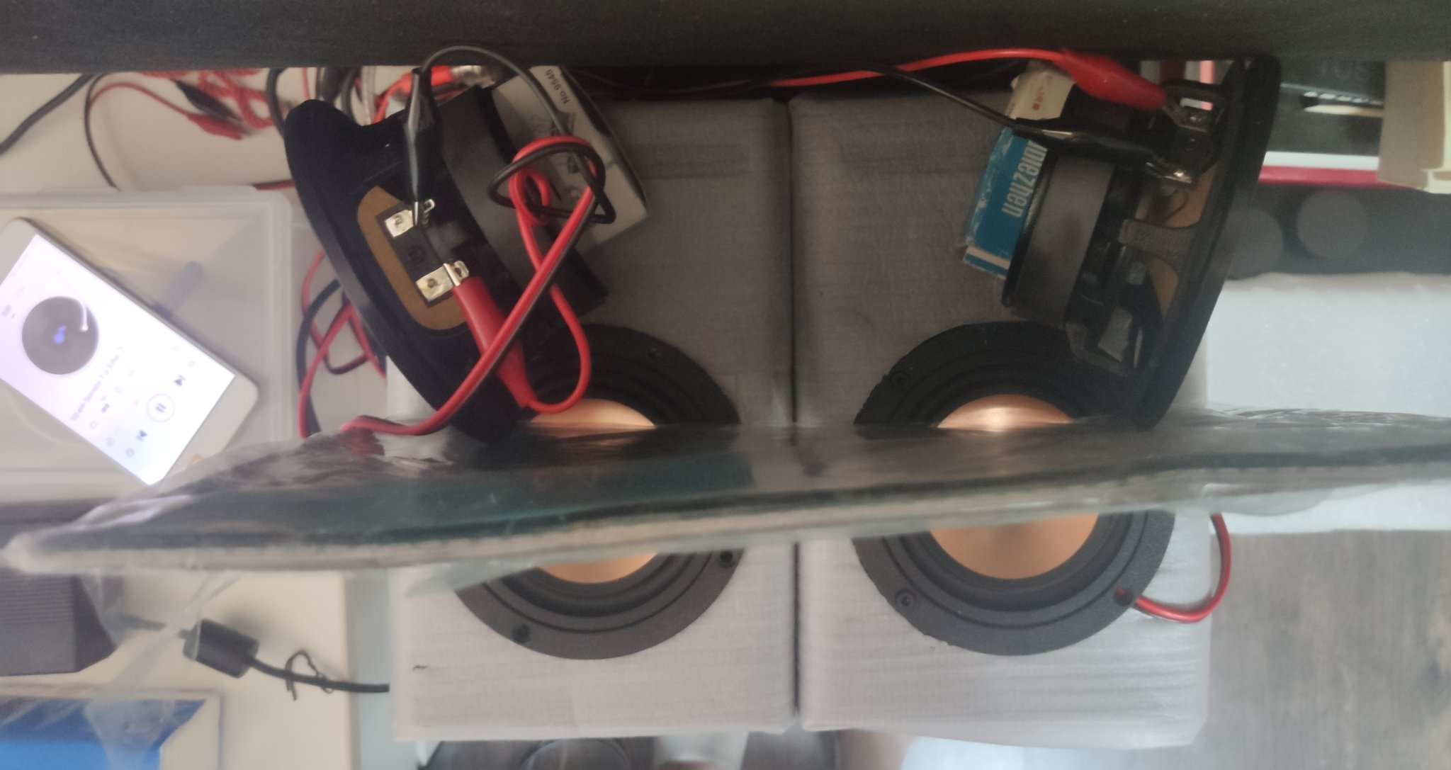

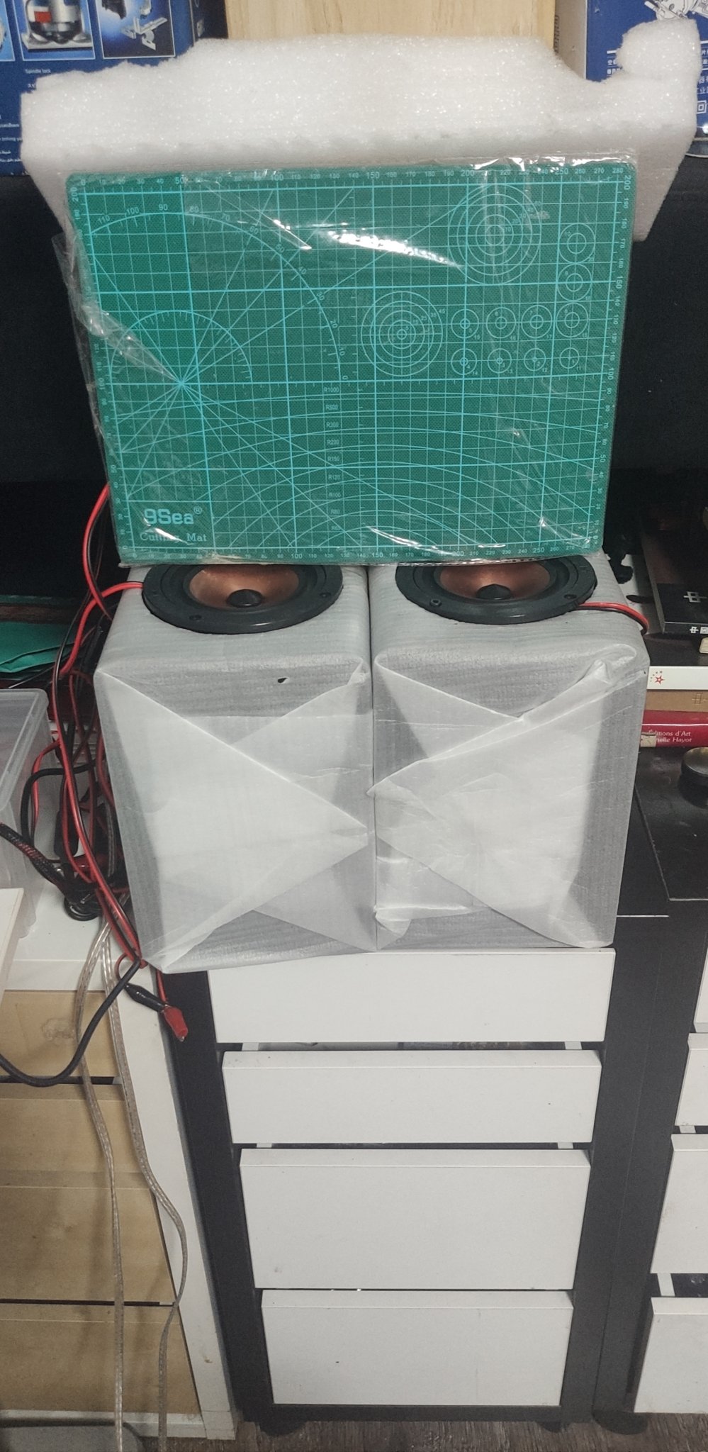

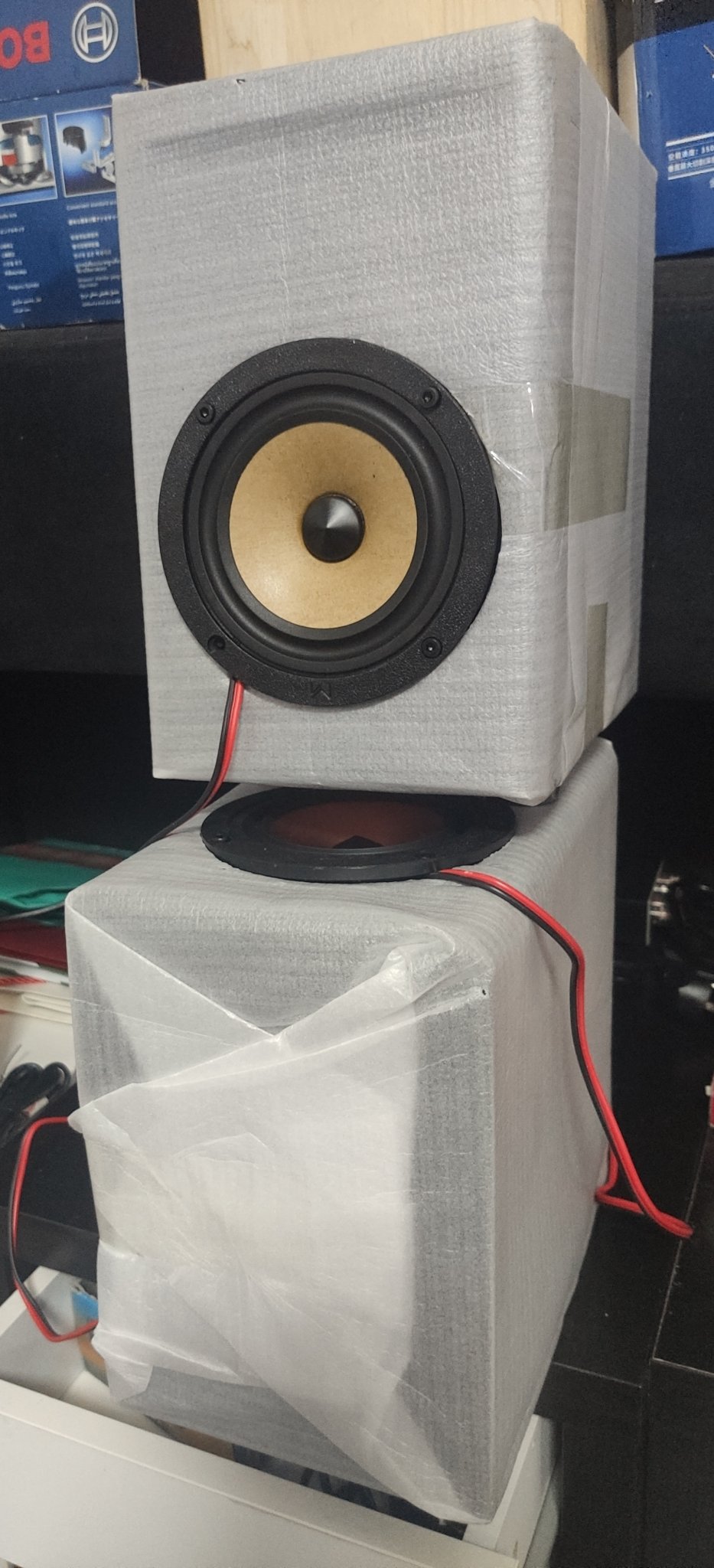

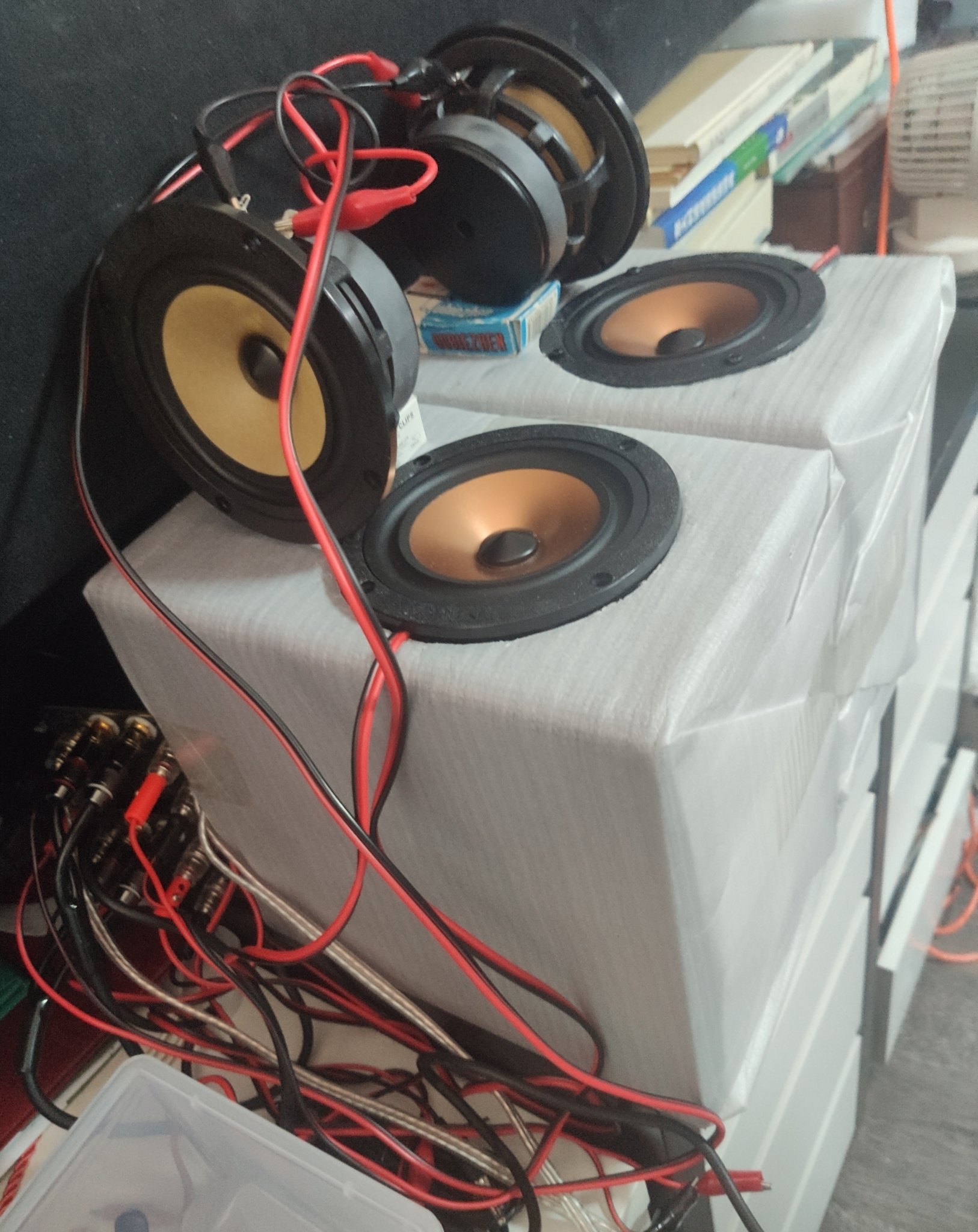

OK here's what I've got working, and I should just declare success, clean up and go to bed (Beijing time).
I simply used a 3.5mm Y-adaptor to two sets of RCAs, to connect my hi-fi phone to two TPA3221-on-steroids integrated amps. One amp drives a pair of up-firing omni 4" speakers (touching), the other amp drives a pair of nude 4" drivers (dipole) firing to the sides (toeing helped a lot). Through tweaking I settled on blocking the nude drivers (else lose floating effect); covering the nude drivers (else lose depth); adding ad hoc reflector on the right (wall on left worked much better); first turn up the omni pair to get decent bass (but not quite enough) and the floating image, then turn up the dipole pair to spread out the image; finally tweak the overall volume so the floating 3D sound stage distance is consistent with the loudness (quite important but my phone volume control isn't granular enough). I tried 1-5 meters and they all kind of worked, with caveats noted above. Whew!
The split formula is (L+R)+f(L-R) | L+R | (L+R)+f(R-L). (f=2 then @acmn; f=3 then closer to @Elias)
I simply use a 3.5mm Y-adaptor to two sets of RCAs, to connect my hi-fi phone to two TPA3221-on-steroids integrated amps. One amp drives a pair of up-firing omni 4" speakers (touching), the other amp drives a pair of nude 4" drivers (dipole) firing to the sides (toeing helps a lot). Through tweaking I settled on blocking the nude drivers (else lose floating effect); covering the nude drivers (else lose depth); adding ad hoc reflector on the right (wall on left worked much better).. First turn up the omni pair to get decent bass (but not quite enough) and the floating image, then turn up the dipole pair to spread out the image; finally tweak the overall volume so the floating 3D sound stage distance is consistent with the loudness (quite important but my phone volume control isn't granular enough). I tried 1-5 meters and they all kind of worked, with caveats noted above. Whew!
p.p.s. If the "omni" speakers are backstopped (like I did with the green cutting mat), the front output will be greater than the sides, say double -- f=1.5 yields 0.5(L+R)+1.5(L-R) | L+R | ... i.e. Elias 2L-R | L+R | ....
So I'm not sure which split formula I got working haha. I might have to swap in my TA2024 amps with dB-stepped volume control.

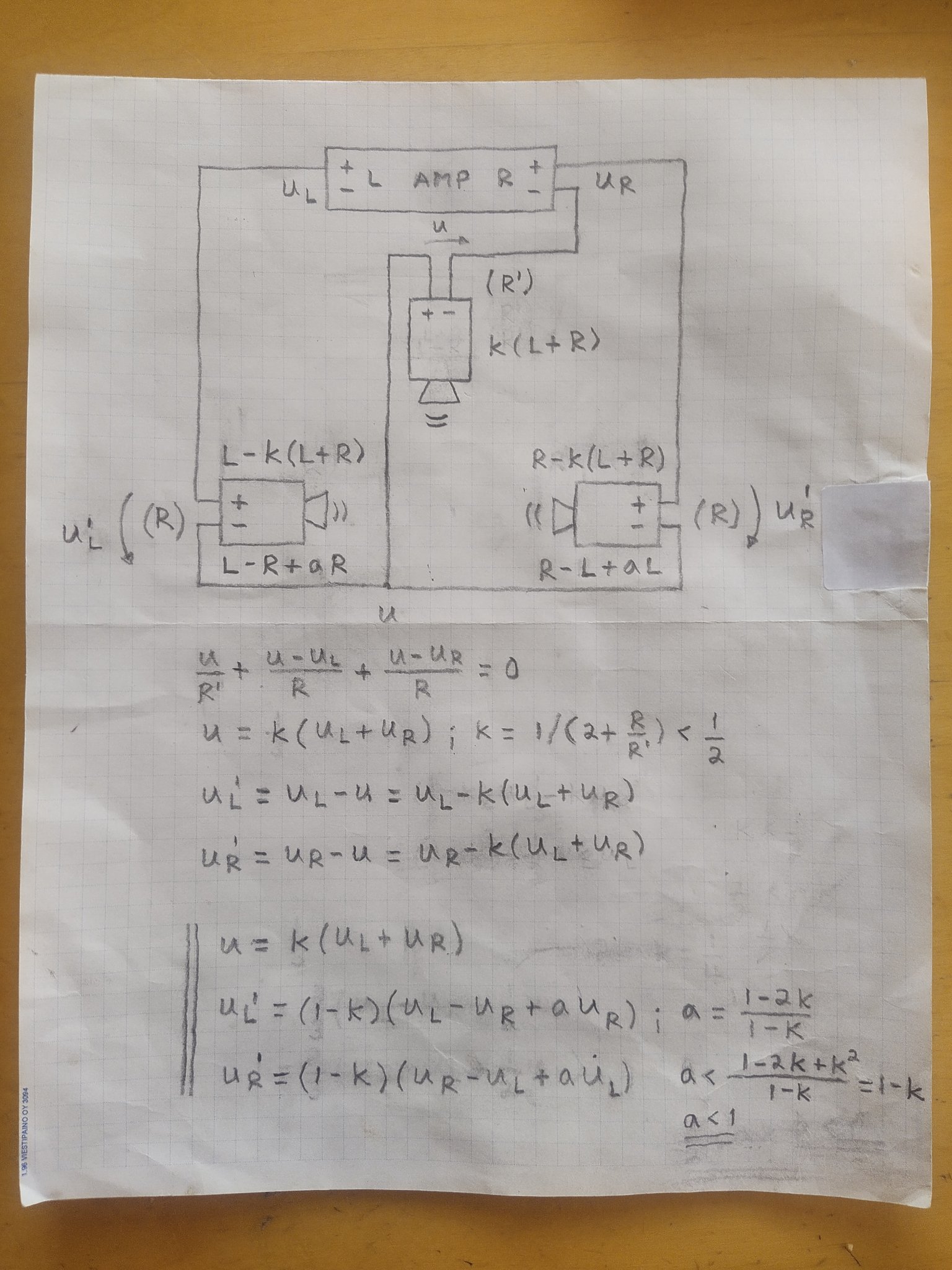

I must say that I disagree with Elias a little bit. The signals in that "cube" should be:
to left: L-x(L+R)
to right: R-x(L+R)
from the middle: x(L+R)
with x running 0...0.5.
(Haloo, Elias, vastaa!)
I am referring to this star connection of the speaker elements. Msg #492 is another story.
(I am talking about false circuit analysis by Elias, sorry to say.)

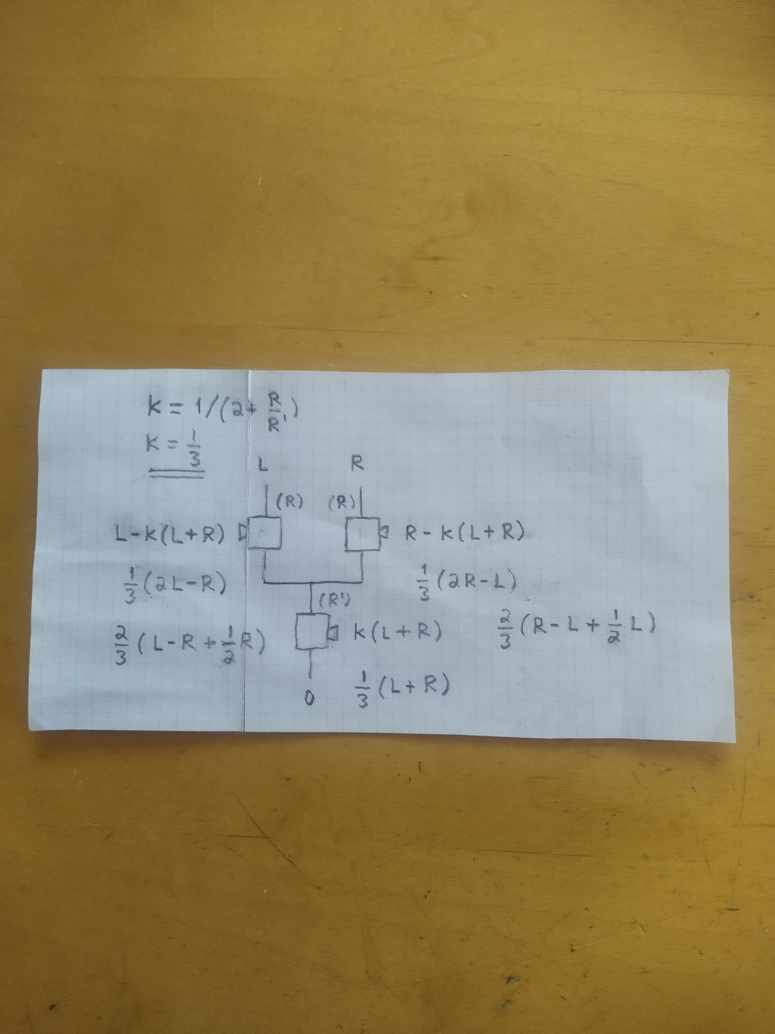

Circuit analysis gave me those formulas. The undeniable truth. 😳
Elias just wanted 2L-R | L+R | 2R-L correct? Which occurs only with x=1/3 attenuation of the L+R matrixed center. I can't find which msg# described this "cube"....
That "cube" is found in the link of the first msg.
Of course you can imagine what ever signals to be fed to those speaker elements, but if you use them as star wired, then the signals are:
to left: L-x(L+R)
to right: R-x(L+R)
Of course these formulas are not the "real truth" because they are based on a model that sees speaker elements as resistors.
