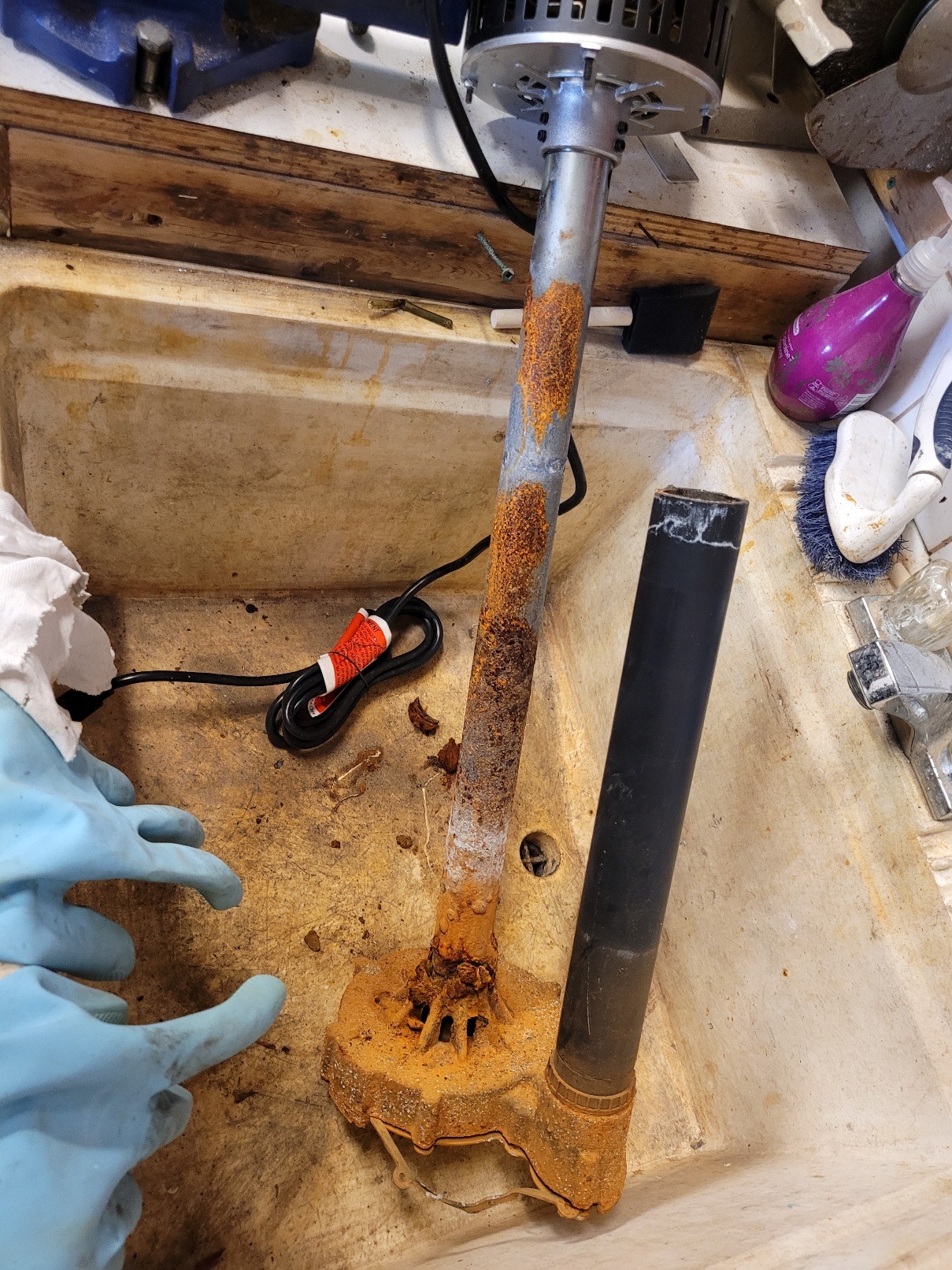

Was leaving for a few days, decided to check our sump pump, just to be sure if it has to work this weekend everything will be ok. Tried it and found it was jam solid… guest it was time to replace it, was in service since 2018. Good thing I had Hot spare ready…

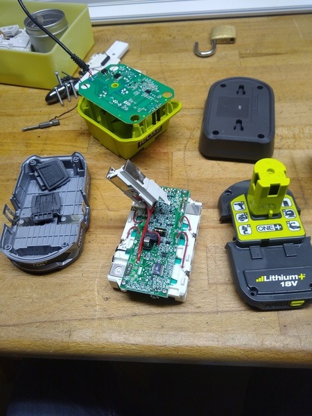

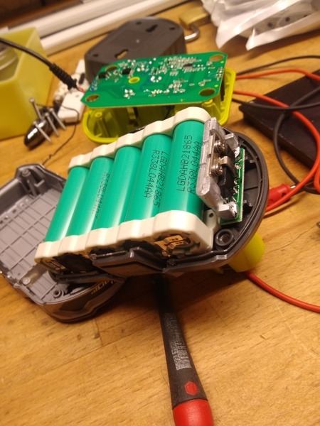

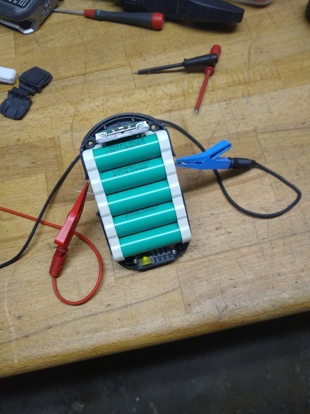

Our Ryobi accu compressor failed today. 18V-accu would not charge, I measured 7.3V output voltage only.
Though seldom in use, it may be 10yrs old meanwhile,
The accu-power switch (2 PowerMOSFETs in series with neg supply) blocked any output.
There was no pos gate voltage - obviously the controller executed a error shutdown.
Inspecting the 5 cells I found 4 of them with a voltage >4V and one with ca 3.6V.
So I charged this cell with the help of my lab supply set to 4.1V and 1amp.
During this process the charge indicator LEDs displayed the progress, starting with one LED
and ending with all 4 LEDs lit. Problem fixed, compressor works again.
At the end this has been a balancing problem that caused a
shutdown of the accu control electronics.

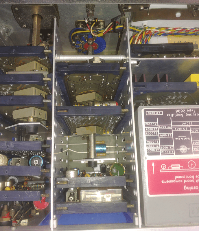

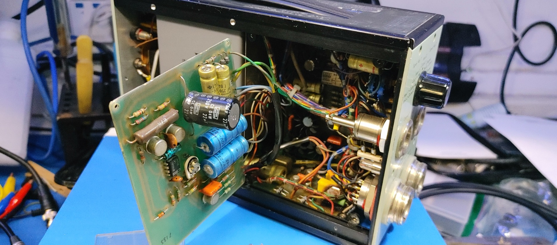

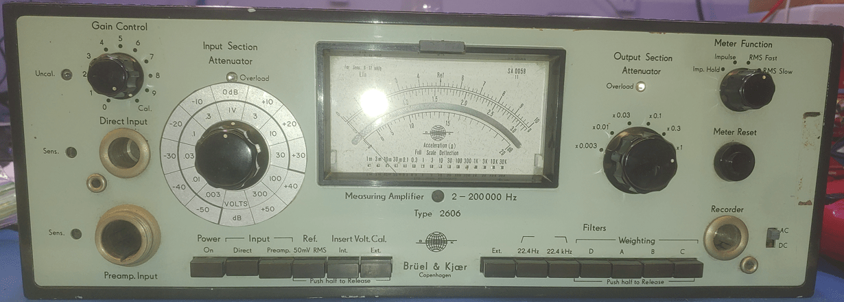

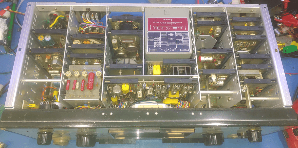

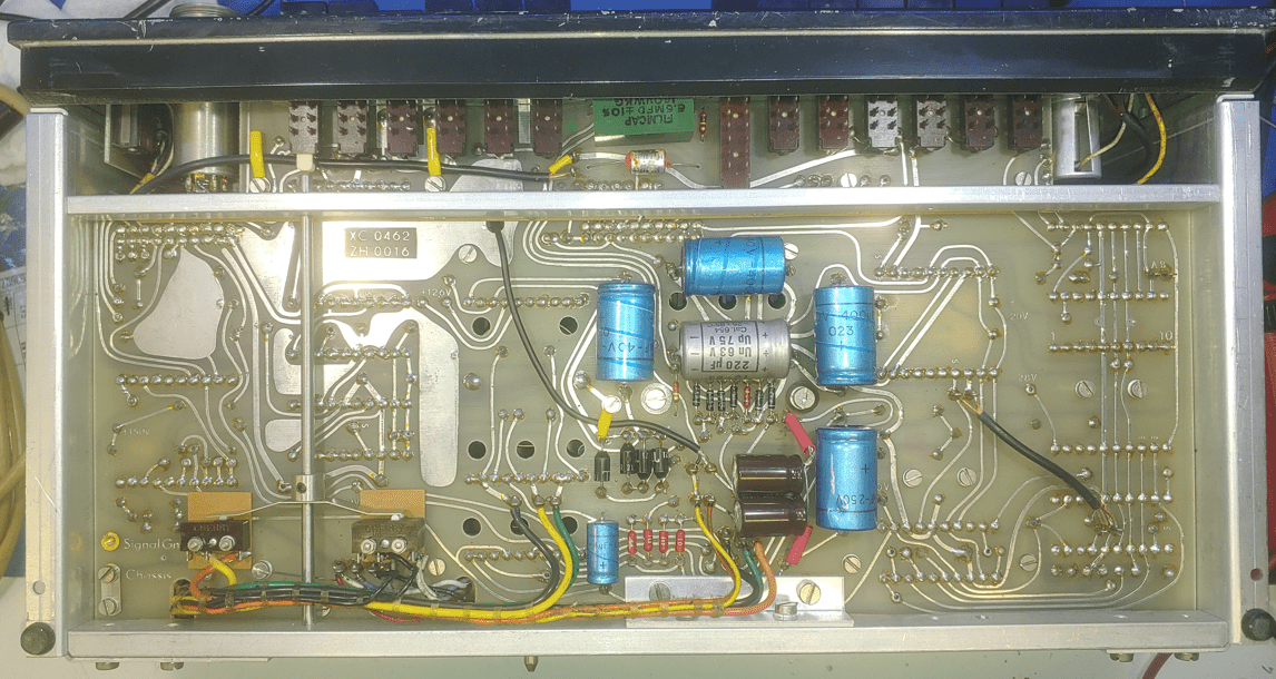

Fixing an intermittant connection in a 1970's Bruel & Kjaer 2606 Measuring amp. This beast predates IC's and has a slew of small PCB's. I had to replace some very old electrolytics as well.. A few pics. It now meets spec (2 Hz to 200 KHz). Its the only version until recently that supports insert voltage calibration, necessary for reciprocity calibration of microphones.

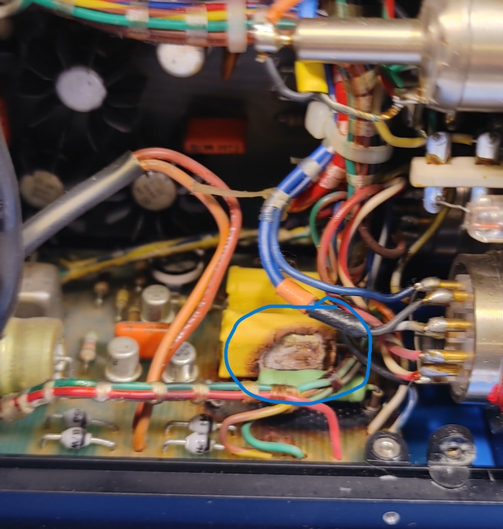

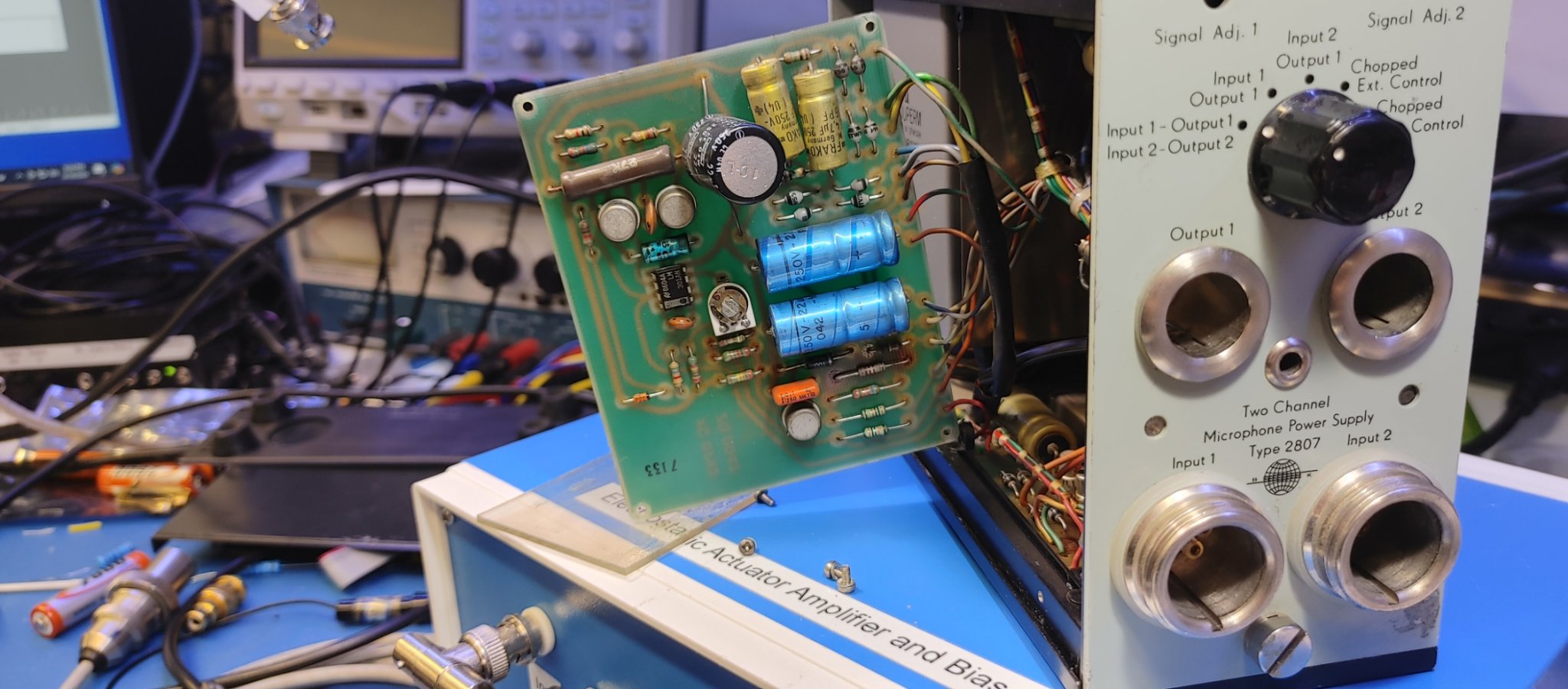

Next "beast" a B&K 2807 two channel microphone power supply. The price was good. However its is distressed. I have seen cooked resistors before but a fim cap with its case burned off is a new one. This had been repaired and the B&K cal seals were intact so I don't know what to make of it. I found a service manual so fixing won't entail deciphering the circuit.
Typical of B&K of this era its a mechanical nightmare to work on. When the manual is here I'll order caps. I have two newer battery powered versions but they don't have the 130V supply for the preamp electronics this has. I'll share some other vintage repairs over the next few days.
