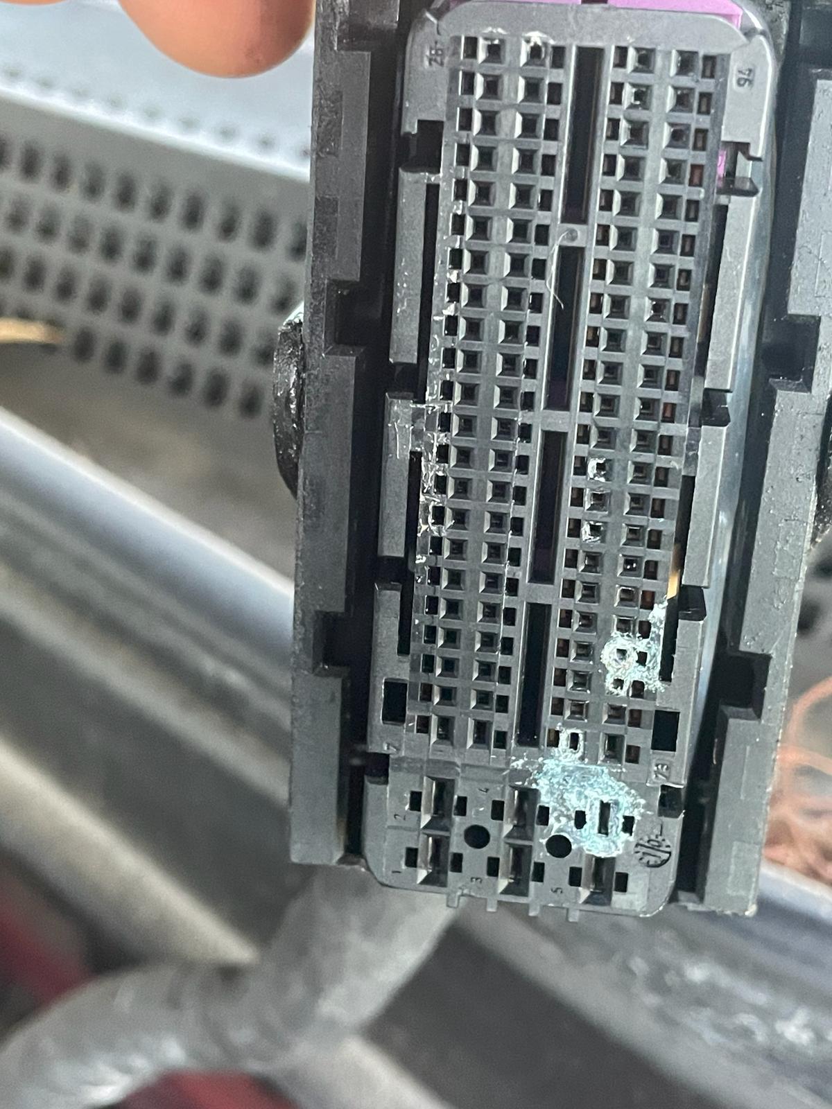

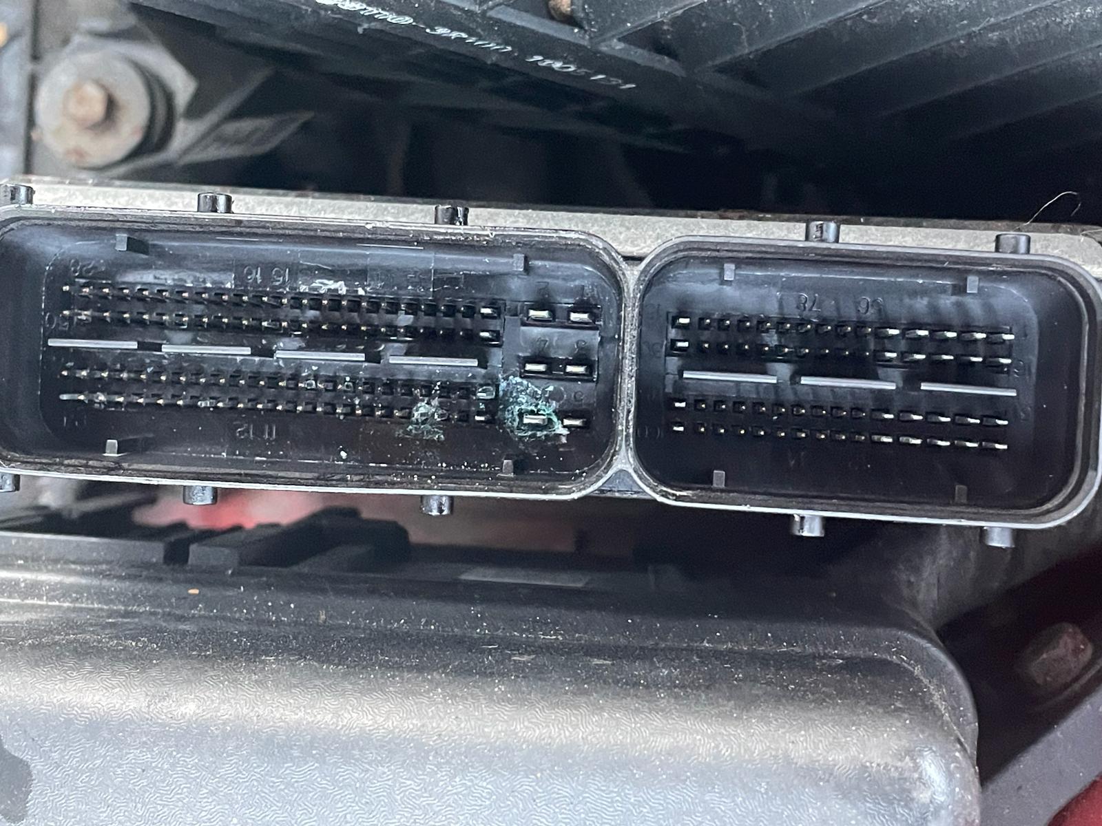

Repaired (sounds impressive) my Wife's 2011 Hyundai Sonata. Had a clicking sound when trying to start somewhat like a stuck starter solenoid but not quite the same tone yesterday morning so said I would look at it in the evening. Got to look this morning and battery was dead. She said the dashboard lit up all the lights and the hazard lights started blinking by themselves when she tried later yesterday. So I figured electronic control issue. Put battery on charge first of all. First thought was computer and sure enough Copper Sulphate on some connectors. This is caused by dissimilar metals in the male connectors on the computer and the female connector in the wiring loom connector. Cleaned up male end with a fiberglass brush and the female end with natural bristle brush and a wipe. Starts and runs again. Just need to find a touch of dielectric grease now and call it finished.

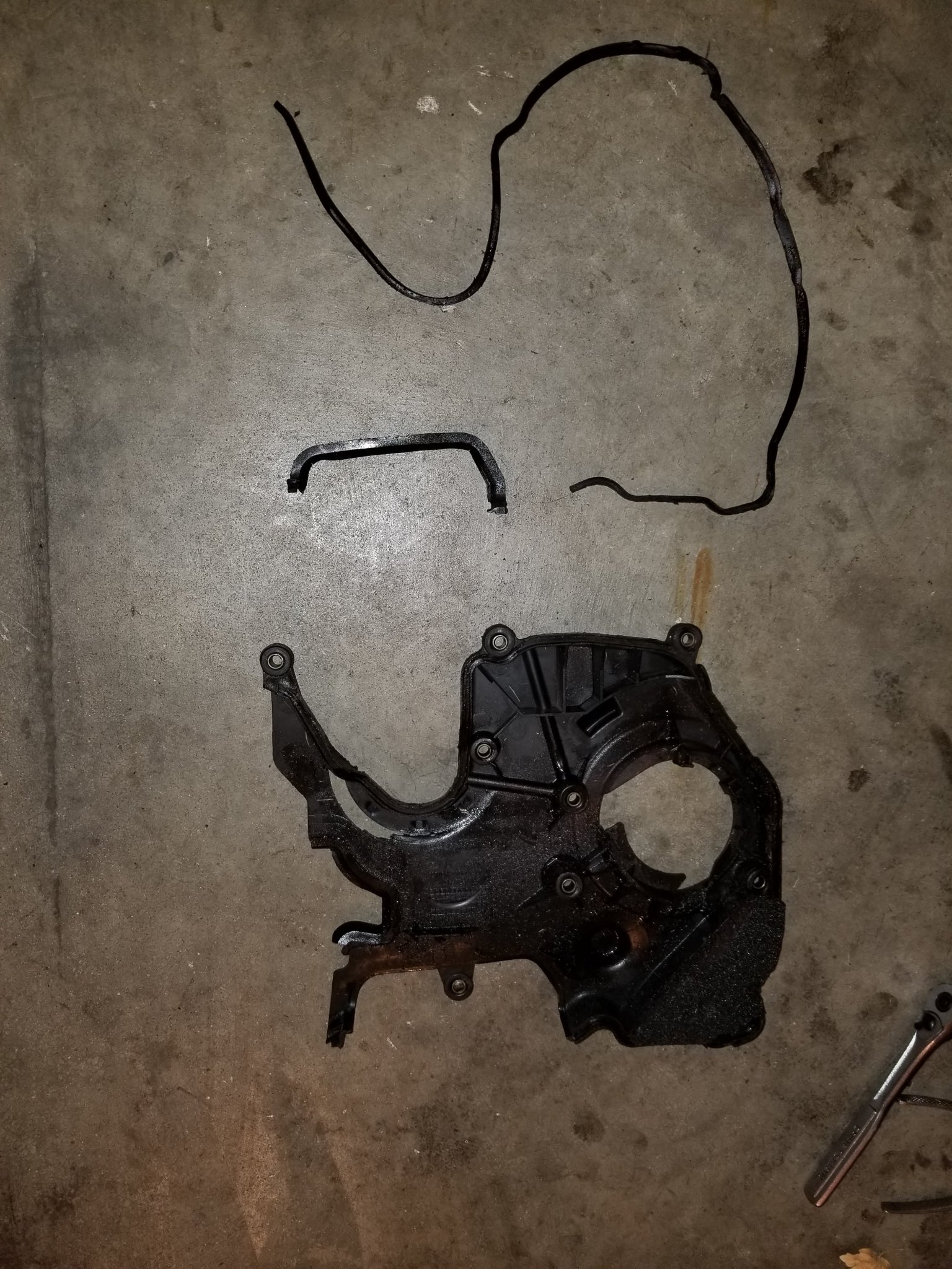

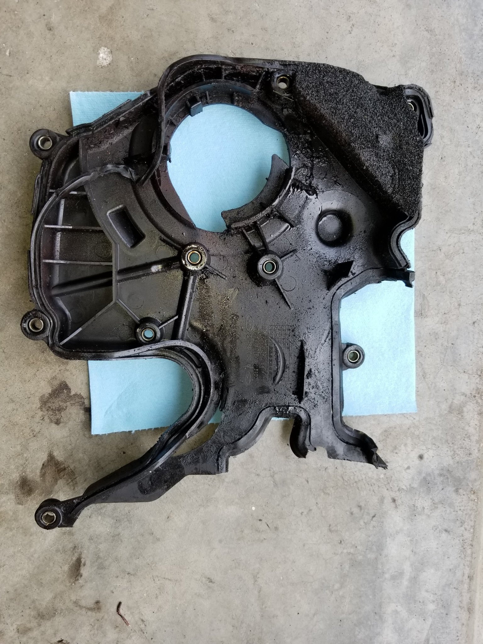

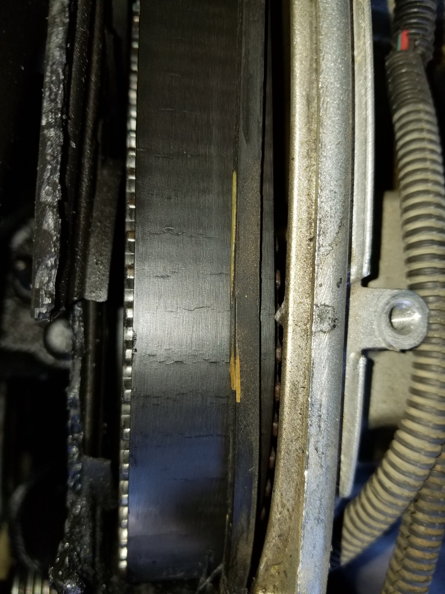

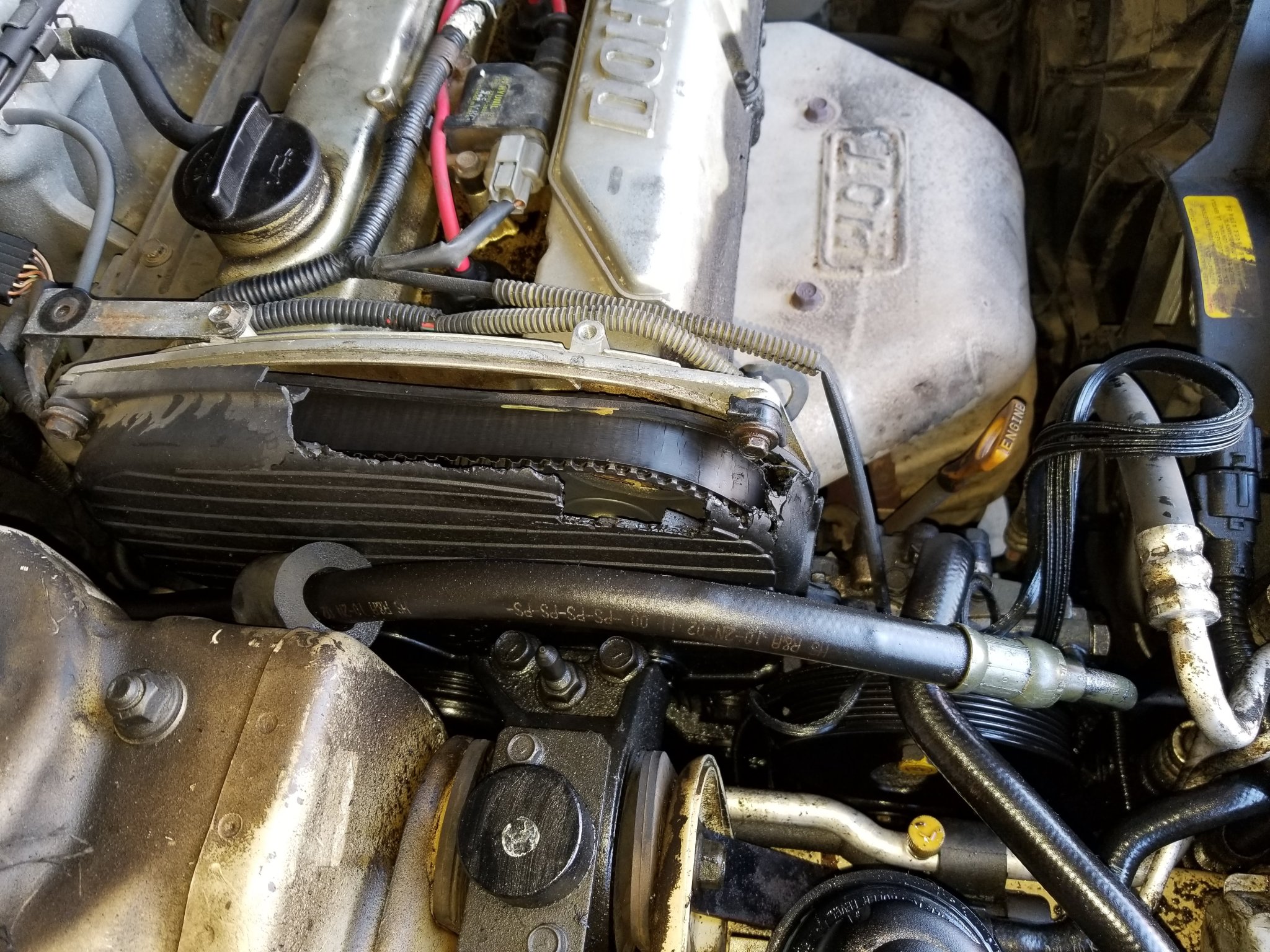

BP1 - Timing belt was overdue replacement judging by the look of it as is Valve cover gasket. The belts should go I think ~50-60K miles between replacements. (Given my experience with Hyundai I would not be surprised if it failed prematurely). Not sure if it's an interference engine, but if it is, you got lucky. I would not touch another Hyundai again. The price is good and I think they look quite nice but that's about it... oh yes, gas mileage is good too but the quality of the materials is poor. Everything just falls apart / breaks and the cost of spare parts is high. My wife's car has just 29K miles now and I have already repaired the sun roof thrice (dealer repair), and cannot open it anymore. The headliner is falling down. Broken door pulls, failed alternator, defective rear disc caliper, three clock spring replacements, Broken shift linkage, Clear coat / paint long gone and the list goes on.

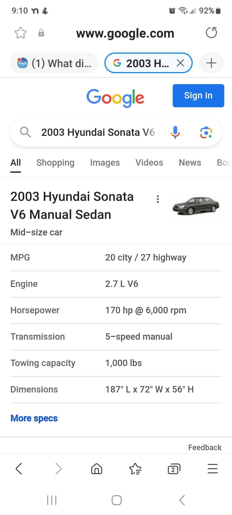

I actually like the V6 Sonata with the manual transmission.
