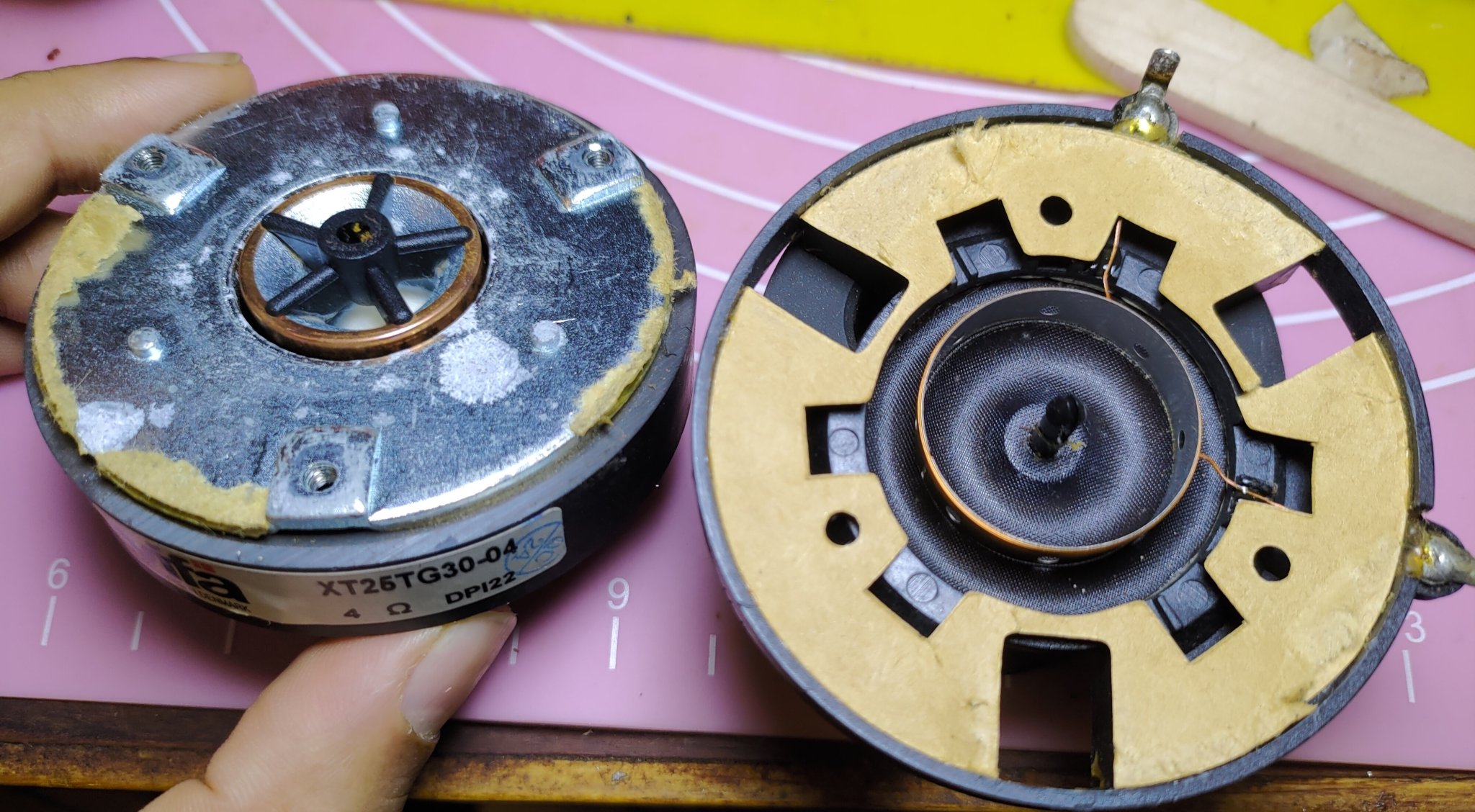

Suppressed highs from left channel. Found out the xt25tg30's VC got "mostly" seperated from diaphragm as glue seem to become brittle after 12 years of service. Re-glued back. Sounds great. May be another 12 years :cool: :)

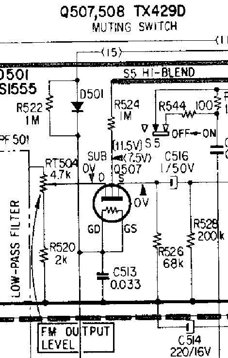

Tuner time!

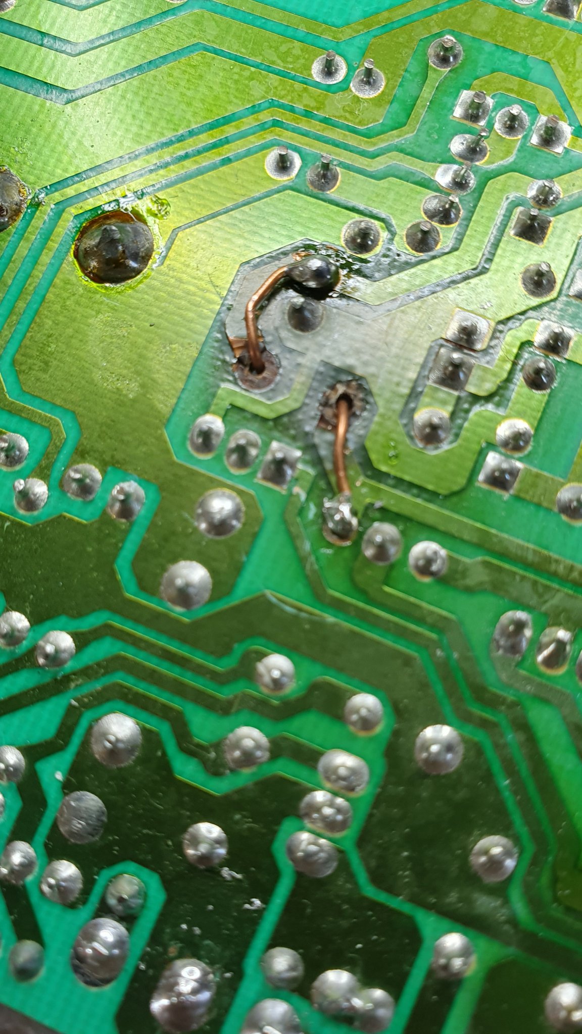

My 'daily' tuner, a Sony ST-5950SD (with Dolby sound - amazing!).
No output anymore when selecting FM (AM is ok but with atmosphere).
The FM muting was stuck for whatever reason, closing these rare TX429D fets.
Bypassed with 680Ω resistors: voila!

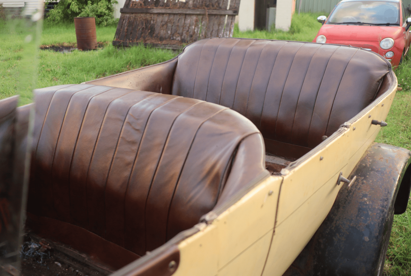

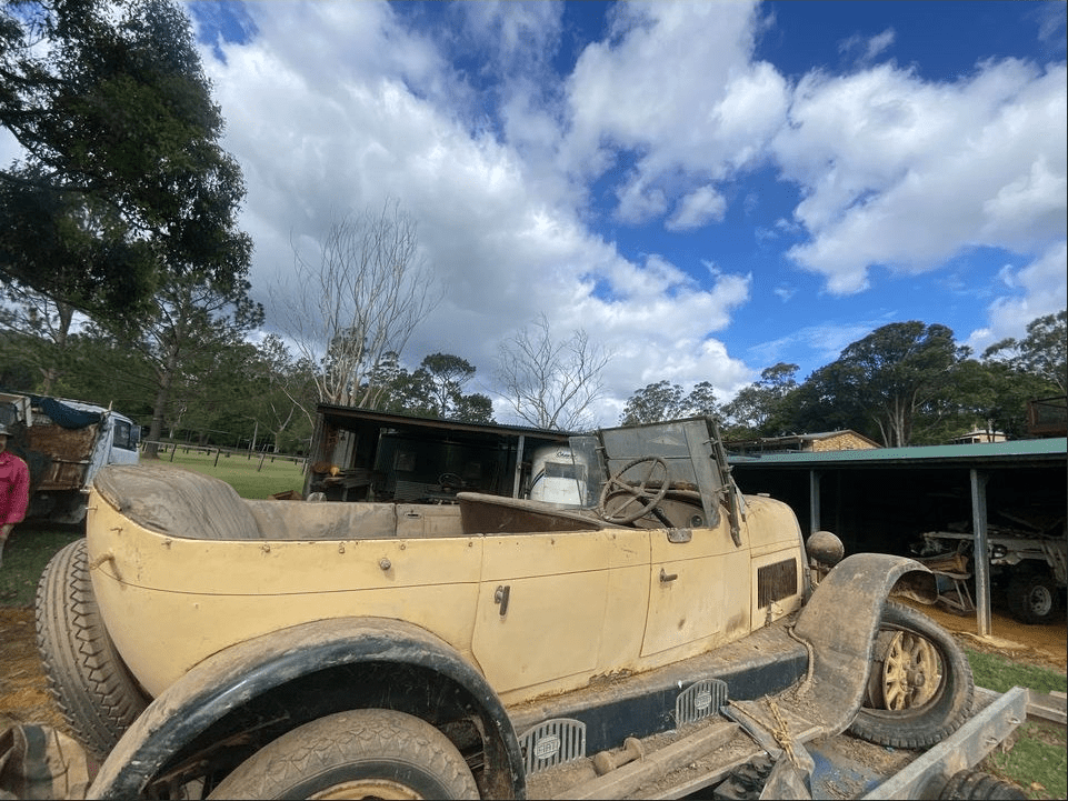

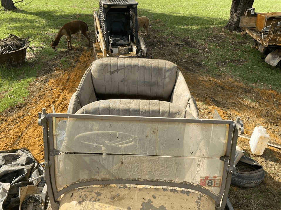

Made a start on the Fiat 501C. Cleaning off 50 years of dust and birdshit revealed a very nice set of seats. I've also ordered a complete new wiring loom for the princely sum of AU$322.00 shipped. Not a lot of wiring in a 1925 car. Before and after of the seats:

That Fiat 501C looks NICE!

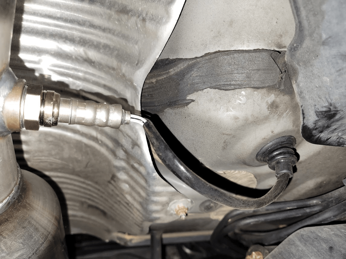

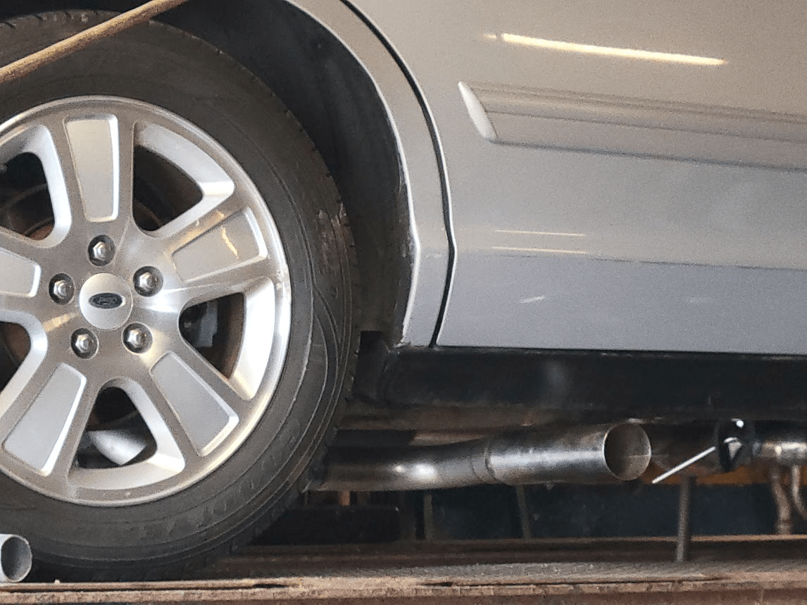

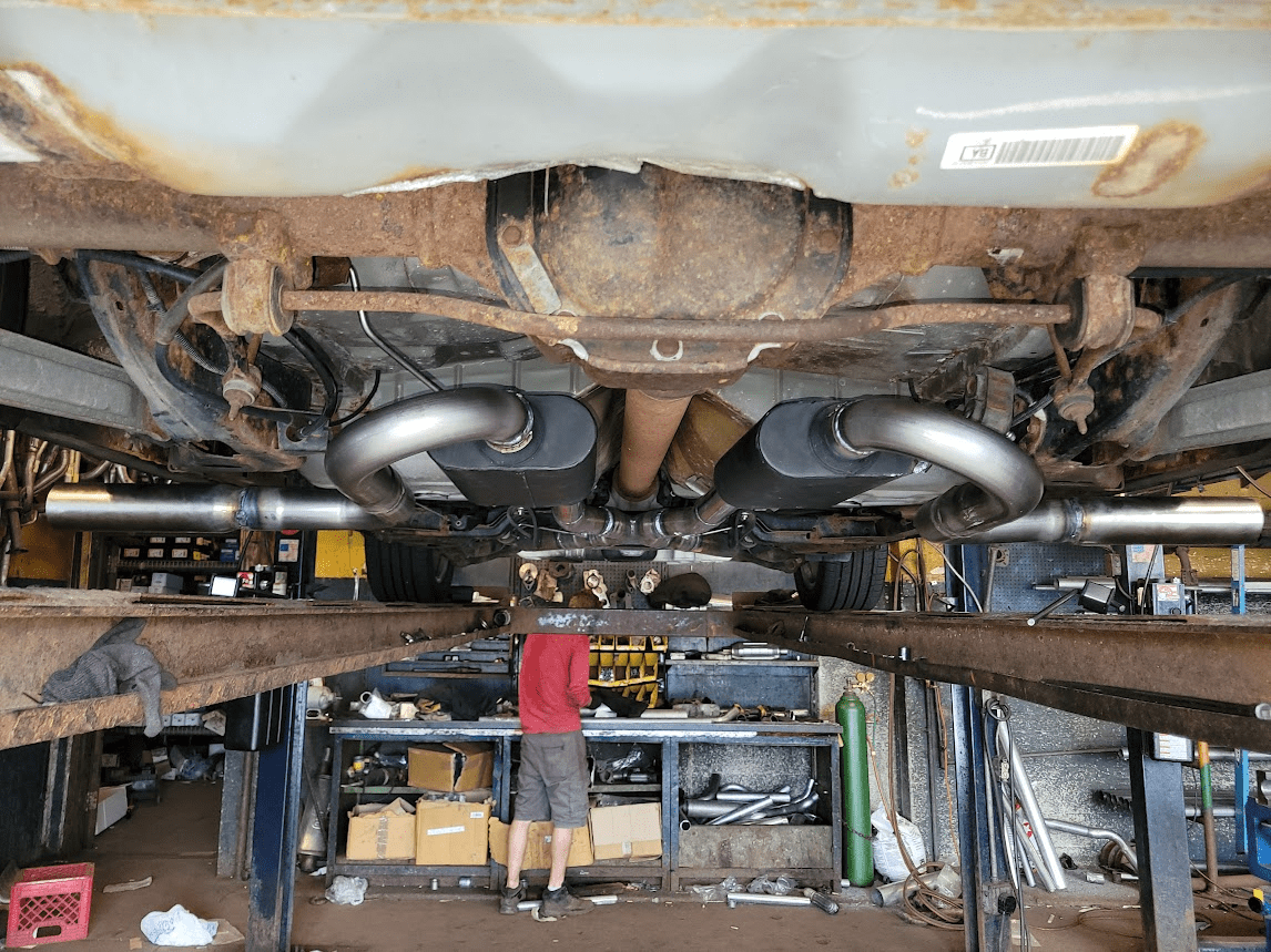

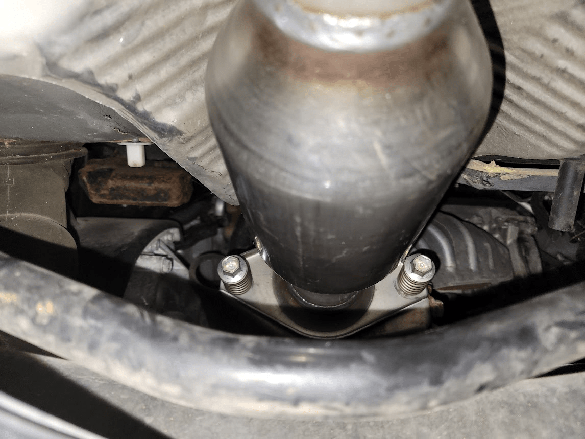

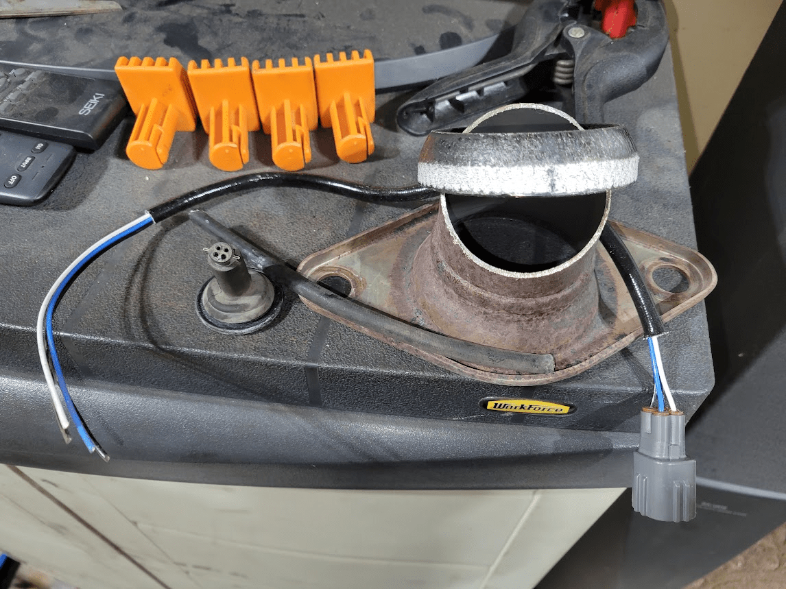

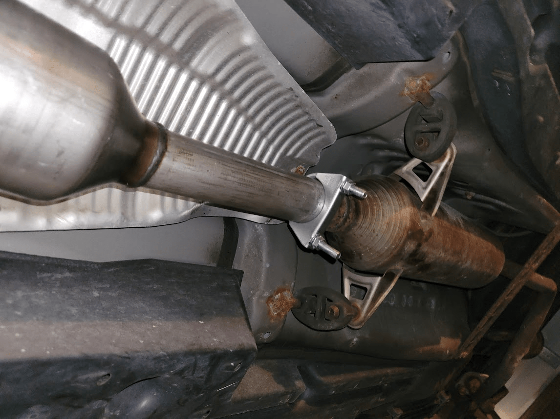

Converter theft is getting bad. I saw there was a really big bust last year stretching across the entire USA. Sorry to hear you were hit.
Surprisingly good for a 99yo car. The latest shock is that beaded 730x130 tyres are AU$675.00 each, not including tubes or delivery (I live 5 hours' drive from the nearest city). Needless to say that's out of the question so I'm looking for some alternate rims. There were three standard rims available depending on which importer built the body and the 19" with 5.00-19 tyres seems to be the most economical.
