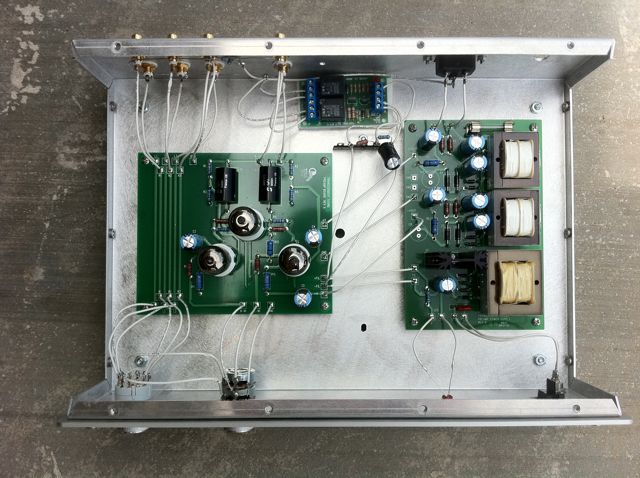

Grounded Grid Preamp
Posted 7th July 2011 at 12:43 AM by alexcp (My DIY projects)
Updated 16th March 2013 at 02:35 PM by alexcp
Built from the kit from Bruce Rozenblit. Very nice one, but is not being used - it has too much gain for any of my systems. I will probably sell it.

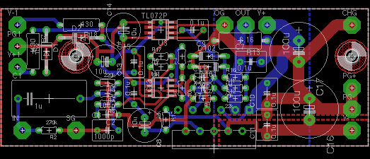

Another Gain Clone
Posted 8th May 2011 at 02:07 AM by alexcp (My DIY projects)
Updated 7th July 2011 at 12:28 AM by alexcp (Added photos)
Unsatisfied with the sound of my gainclone amplifier, I re-used the enclosure and the power supply for a gainclone along the lines suggested by Bob Cordell, whose implementation of an LM3886 based amp was praised by at least one member on the NJ audio society.
I skipped both the Klever Klipper and the toroidal air core output inductor, and kept only 10,000 uF per rail in the PSU. The schematic can be found in Chapter 27 of Cordell's Designing Audio Power Amplifiers. The PCB was designed to re-use the existing mounting holes of the ChipAmp's PCB.
The result? Better than with a plain vanilla chip amp, but still not good enough for music. Perhaps I should not have limited myself to re-use of the PSU et al. but should have taken all the details of my implementation seriously.

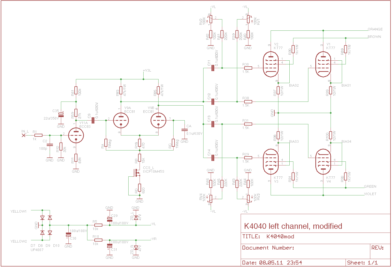

Velleman K4040 mods
Posted 8th May 2011 at 12:32 AM by alexcp (My DIY projects)
Updated 4th May 2014 at 12:59 AM by alexcp
I posted some time ago a note about my Velleman K4040 amplifier. The sound of the amp as built from the kit was unremarkable and definitely not in line with the price. Lacking experience with tubes, I was looking for some time for well documented mods to the kit.
I found two 2006 posts here and here and implemented them rather directly. The only difference is that I used IXCP10M45S instead of a pair of J508 current sources in each channel and replaced the 1N5408 rectifiers with UF5408 instead of adding noise suppressing capacitors in parallel to them.
The mods did not leave much of the original Velleman design in place; the result, however, is a remarkable improvement in sound!
However, two problems remain: (1) I got hum that wasn't present before the mods; and (2) a two-year old running around doesn't get along with eight hot, attractively glowing tubes. The project is shelved until a better time.
For future reference: The toroidal...

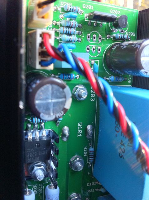

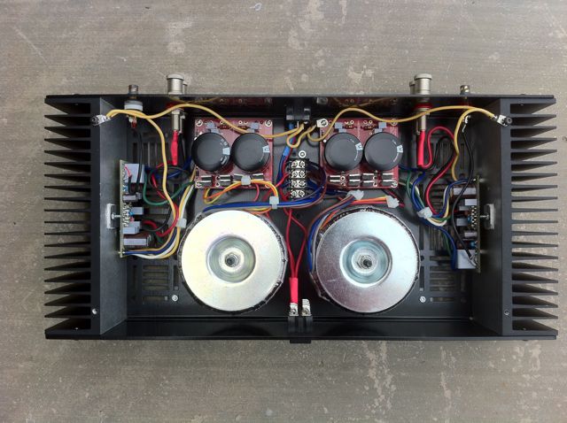

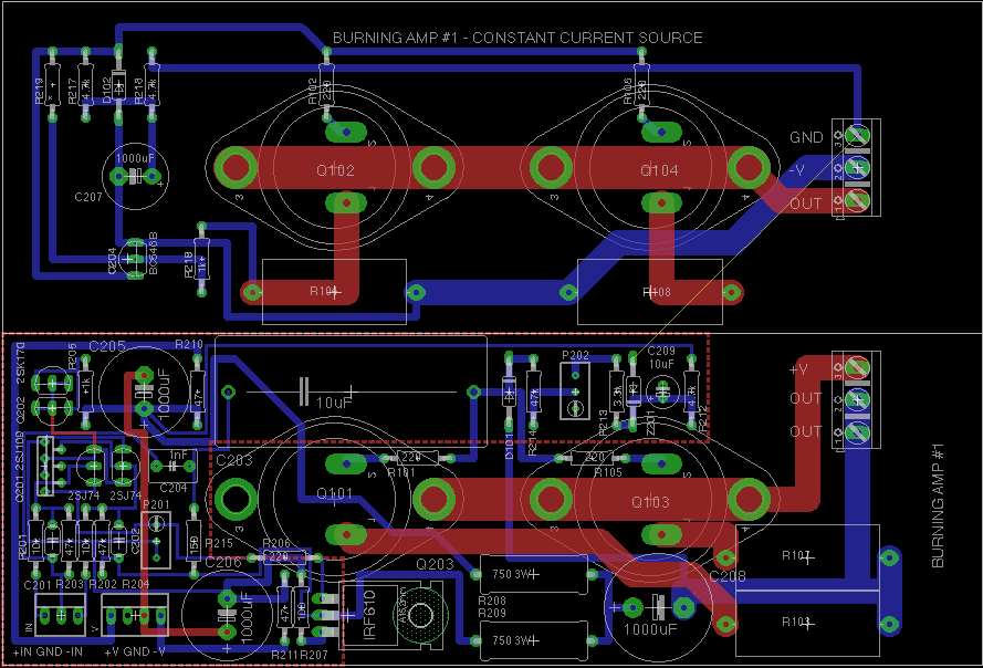

Burning Amp 1
Posted 9th October 2010 at 06:52 AM by alexcp (My DIY projects)
Updated 16th March 2013 at 02:40 PM by alexcp
To get warm and comfortable on long winter evenings, I built myself a Burning Amplifier 1. With its 300W quiescent dissipation and ineffable ((c) Nelson Pass) sound, it is a nice winter time companion.
I used four heatsinks, each holdings two IRF250 MOSFETs in TO-3 packages and a PCB. Each pair of heatsinks is cooled by a quiet 140mm fan. Power supply uses a 400W toroidal transformer and 2x40,000 uF per channel; it is a dual mono configuration. The amplifier is housed in a 5U 400mm deep enclosure from modushop. Their "pierced base" was very handy to keep all the parts together without sacrificing the looks. Total weight is 23 kg (about 50 pounds).
The knob on the front panel was designed as volume control, but it looks ugly, so I will remove it.
