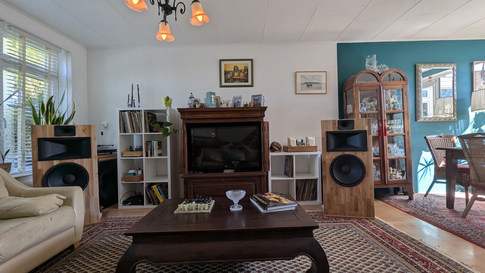

My dad of 82 who never has said anything about the sound. Said when I first demo'd them to him: "The sound is perfect". My brother looked at me and said straight away: "Your last speakers ever". Every day I'm flabbergasted by the sound. I'm extremely happy. My son said last night: "You have outdone yourself" Not mine to take credit for though but good to hear nevertheless.

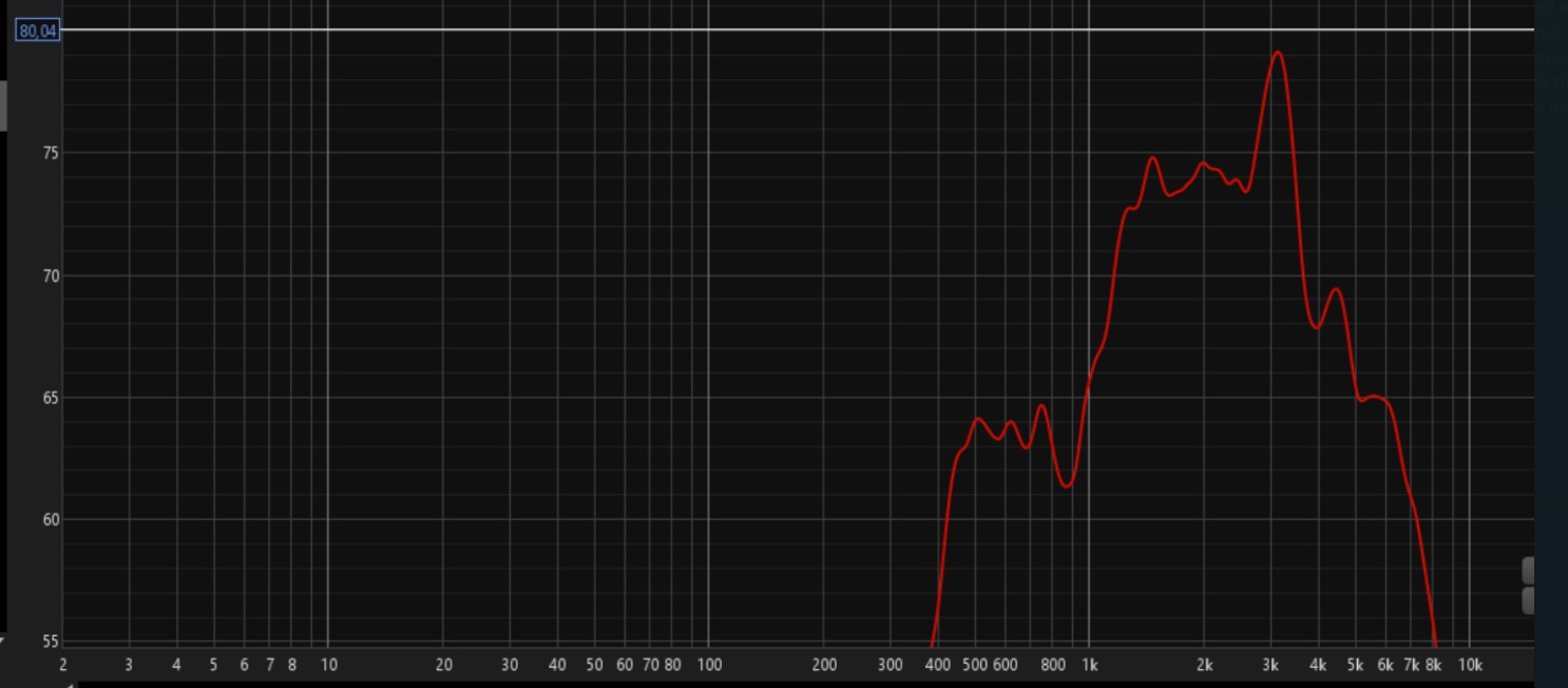

Hi Bas,
nice system and I have no doubt it sounds great allready, the drivers are all very good. I do own a pair of HF10AK's and have tried them in many horns. While the STH100 horn is nice it still has some horn colouration that is only obvious when you comoare it to a horn/waveguide tah does not have this colouration. Best sound I got from them is from a air of 3D printed ATH ST260 waveguides. These are very linear, have almost no colouration at all, at least the least of all waveguides/horns I have tried. It is absolutely worth it. Same for the midhorn, I have not heard your horn but since it is a difraction horn it will have some colouration as well. A little nervousness that is not there with proper "Hifi" waveguides. Take a look at ATH horn, you can buy vey good designs there. Since I had such a good luck with the simplest standard design from ATH I have no doubt that there bigger waveguides sound absolutely great.
Hi Sjef,
Thanks for the help! I was indeed planning to get something better than the Paudio 4525 which as you mentioned is a diffraction horn that was made for a different purpose than smooth sound at home.
I am saving for the Athos Yuichi A-290 or Tractrix round for the mid. I was not aware of the STH100 shortcomings apart from something at 4k. But since I am using them > 6kHz...I did not give it another thought. Will investigate further.
What would you suggest for the mid horn?
Kind regards,
Bas
Reactions: ErnieM
I would seriously look at the ATH designs, at least the small one I have got sounds better than the round tractrix horn I had. The Tractrix beamed a lot up top, that's waht tractrix horns do generally. I thoght the sth100 was a little better. The ATH waveguide is very smooth and with very good of axis response. Might become a bit big for a midrange driver though, you might get away with the 460mm waveguide. They can (and should) be used standalone which makes there visual impact smaller than when mounted in an enclosure or baffle. I have never heard a Yuichi horn, always have been curious about these but I can't comment on them. Many people like them though. Choices, choices, too many choices, the hardest part of our hobby.
