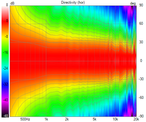

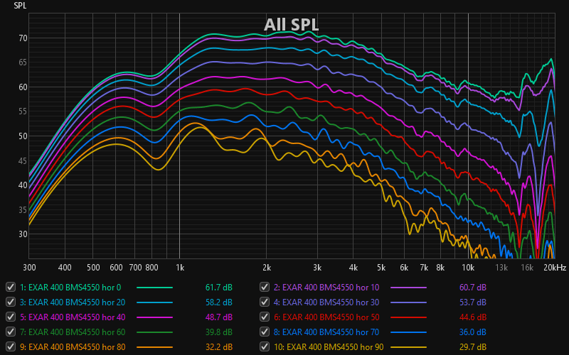

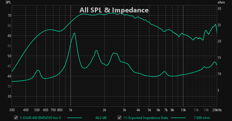

I took some measurements of the BMS 4550 CD on EXAR 400 horn today
Measurements taken 1m away from horn mouth (gated at 4.1ms)
On axis frequency response and impedance measurement together

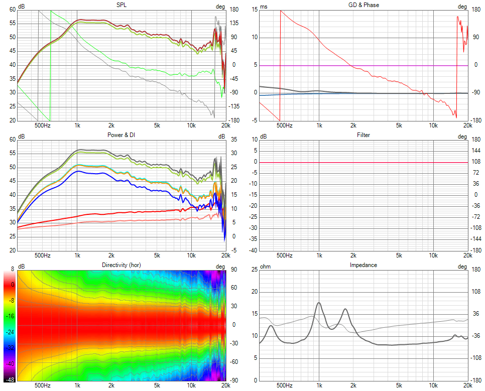

VituixCAD plots
Normalized directivity computed with reference axis as 10 degrees off axis
  • Thank You

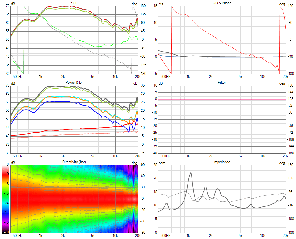

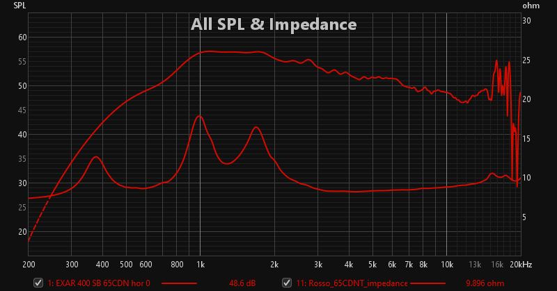

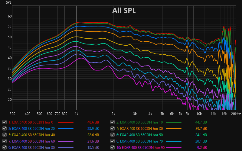

Here is the data for SB audience Rosso 65CDN-T 1.4inch exit CD on the EXAR 400 with a 3D printed throat insert to make it a 1inch exit :)
In below plots, please ignore the absolute SPL levels. The seem low around 50 to 60dB SPL in plots since I had not done SPL calibration for the mic (ISEMcon EMX-7150). In reality they should be hanging around at least 80+ dB
Angular measurements upto 90 degrees
On axis response + impedance curve
VituixCAD plots
I just wish that break up was a bit milder.. :) (Obviously, not because I can hear it, but just so that it might look nicer to the eyes :D )

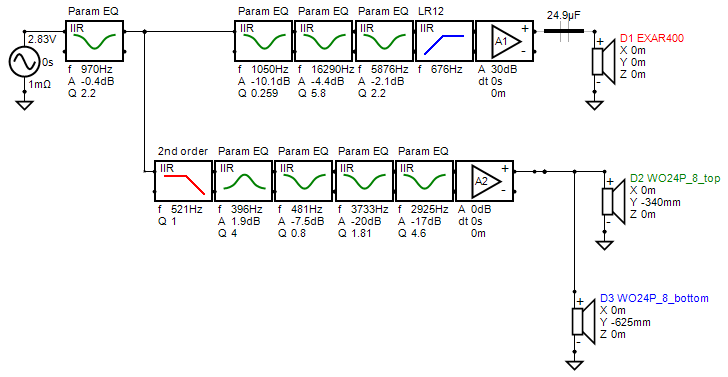

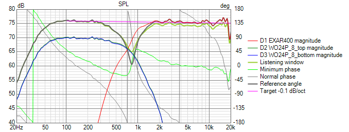

But today morning I got some free time and I quickly cobbled up a quick system out of my Satori WO24P-8 woofers & the SB audience Rosso 65CDN-T.
DSP active two way with DSP and amp duties handled by the Zoudio board (https://zoudio.com/)
Here is quick view of specs (ignore the amp gains on crossover pic below)

That's great. Wonderful job, as always.
Usually it helps to connect not only a capacitor, but also some voltage divider (resistors) in front of the driver. Otherwise, the capacitor interacts with the impedance of the driver in a way that strong peak(s) in the frequency response are created that need to be additionally dealt with in the DSP. With resistors, you are able to basically flatten the impedance first, eliminating this. Typically there's enough absolute sensitivity to start with. And if there's a need to decrease the sensitivity of the HF path, it's better to do this passively than in DSP.
  • Thank You
Reactions: 1 users
I'm not sure about the order but lowering the crossover frequency would certainly help. It's pretty high as it's now - effectively just below 1k.
It could easily be 600 - 700 Hz. The waveguide alone has nothing but a very smoothly decreasing DI down to DC :)
But of course I understand this just as a quick experiment. I think Vineeth aims for a yet different design with this horn...
  • Thank You
Reactions: 1 user

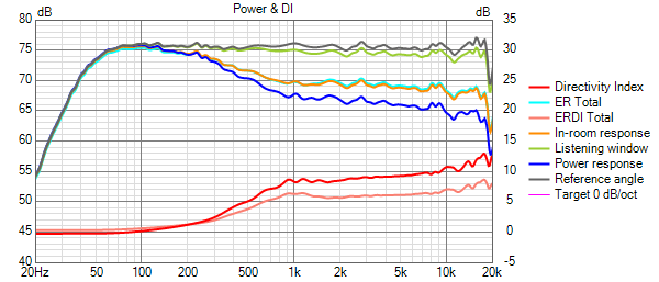

I am not as concerned about the abrupt change in DI from 200 - 1k. Visually it looks abrupt in the plot, but our eyes see the sharp corner at 900 Hz and it seems worse than it is. We don't listen to the DI curve, it is a calculated artifact... a very useful calculation, but still, that is all it is.
I have found that the best indicator of the tonal balance of a speaker in a "normal" room with "normal" reflectivity and absorption is the PIR curve. Vineeth, your PIR curve looks excellent to me. Some people prefer a uniformly sloping PIR curve with a slope of 0.8 - 1.0 dB/octave. However, I prefer one which slopes down by about 5 dB from 100 to 1k, and then is nearly flat above 1k, with a slight downward slope. Your PIR curve is just about exactly how I like it.
  • Thank You
Reactions: 1 users
Even before considering an in-room response, everything should be fine with the source itself, IMO. For this the DI is very helpful as a simple inidicator of the overall quality, certainly not an artifact - it describes pretty well how the source radiates sound, which is what we do listen to. It's all tied together.
(For DI to be a usefully robust indicator, it should be -in general- referenced to a listening window/the actual direct sound, but that's not really relevant here.)
