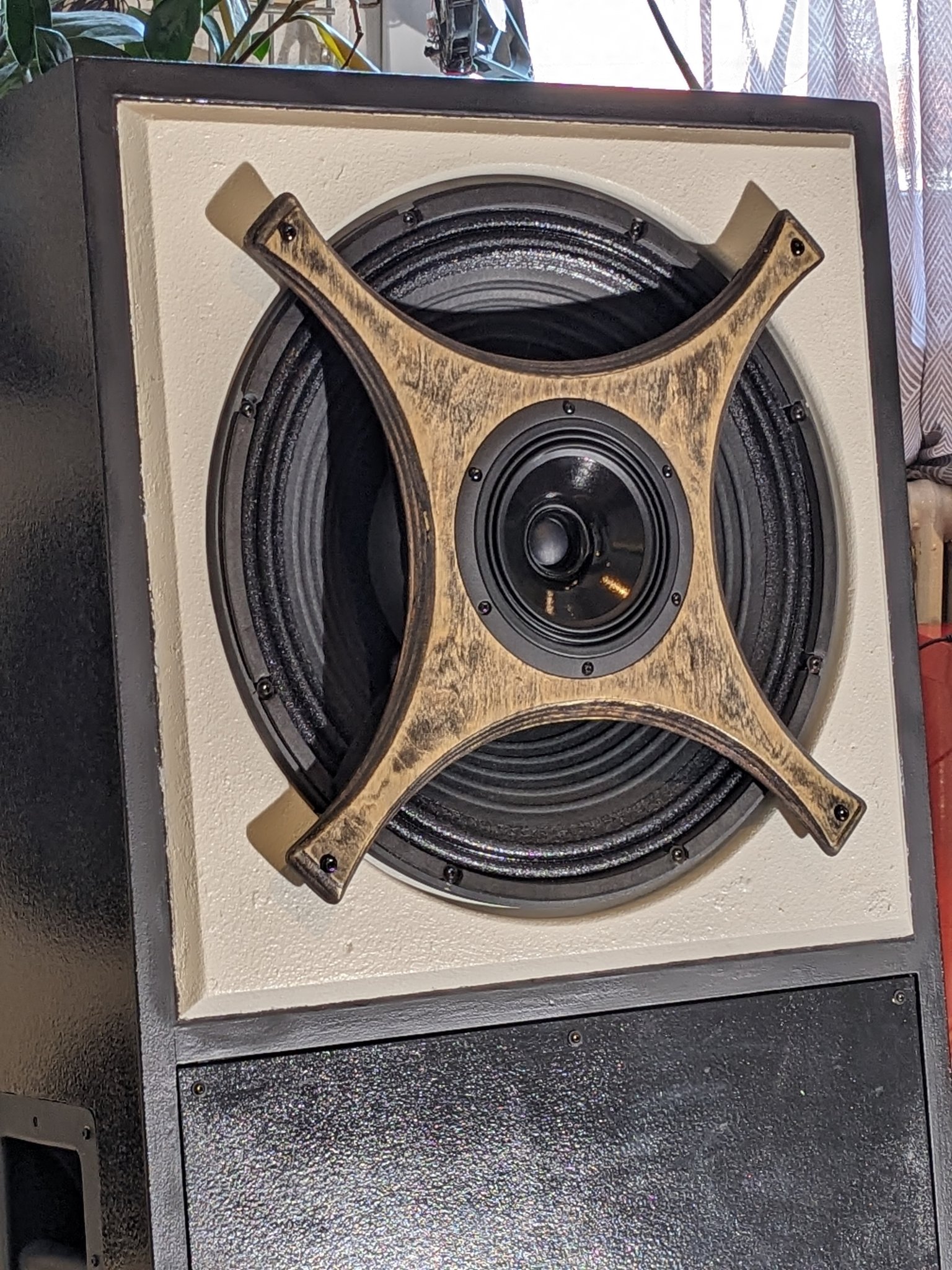

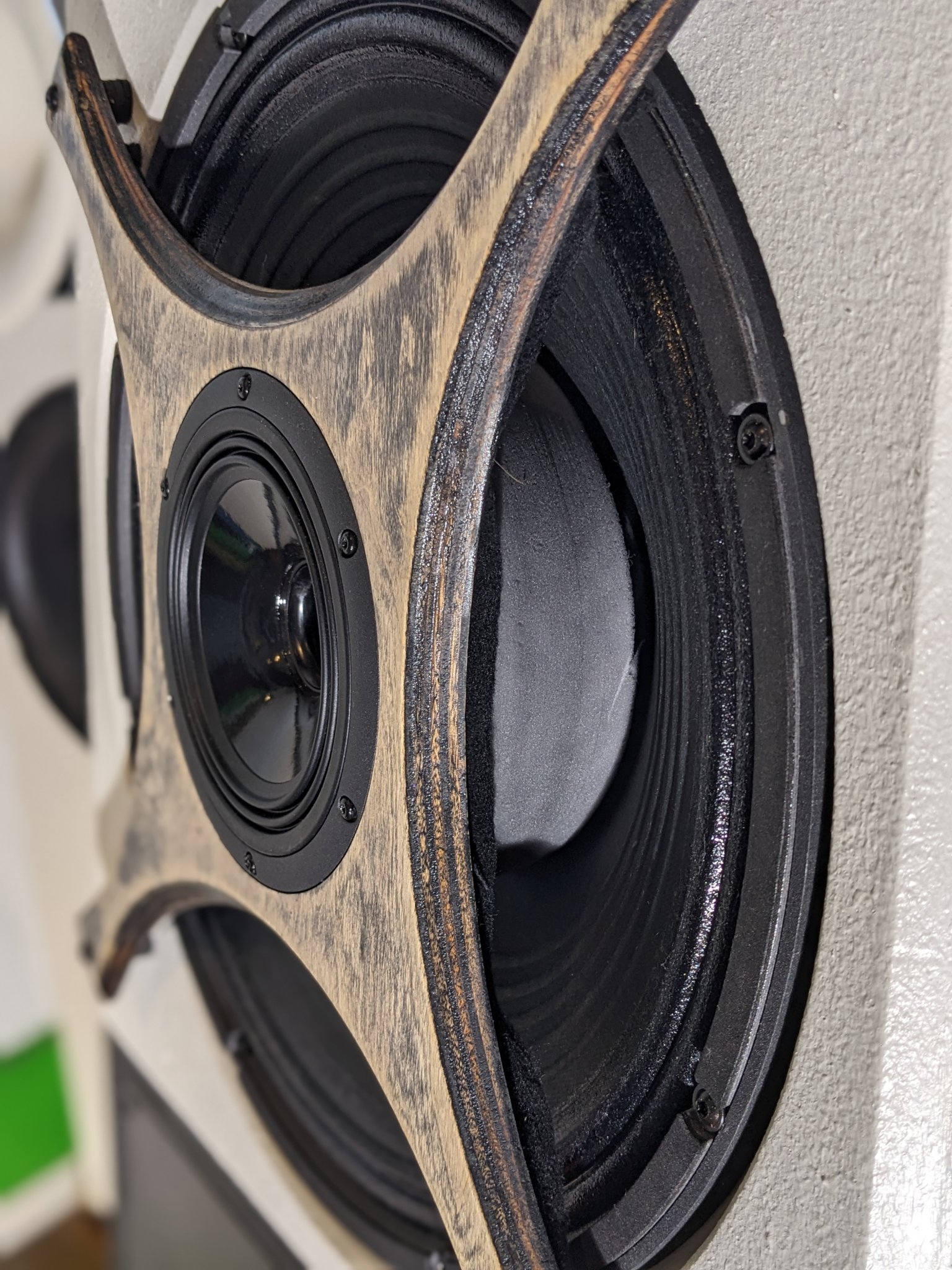

I like your thread very much. Your project with the sica coaxial inspired me to build my own(Pics) , thanks
Maybe you write it, but can t find it.

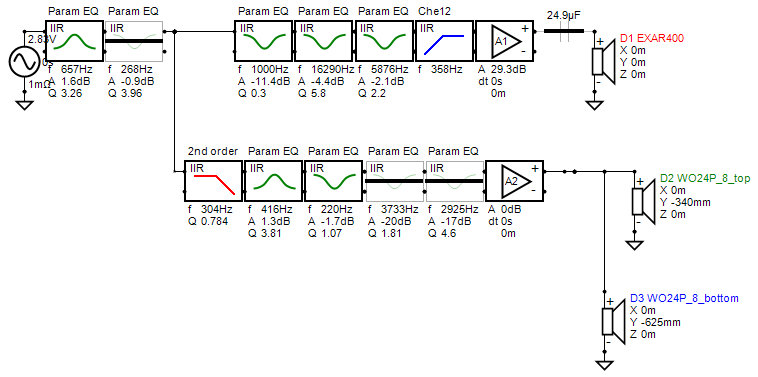

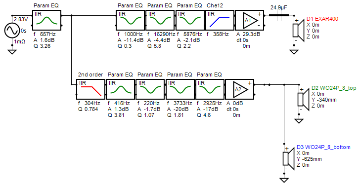

What are the paramet. EQ in 2925Hz & 3733Hz are for?
Is it hearable If you turn it off?
Thanks, best greetings Daniel

Thanks @Eggg3r
Your project looks very nice too..

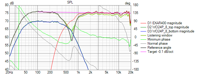

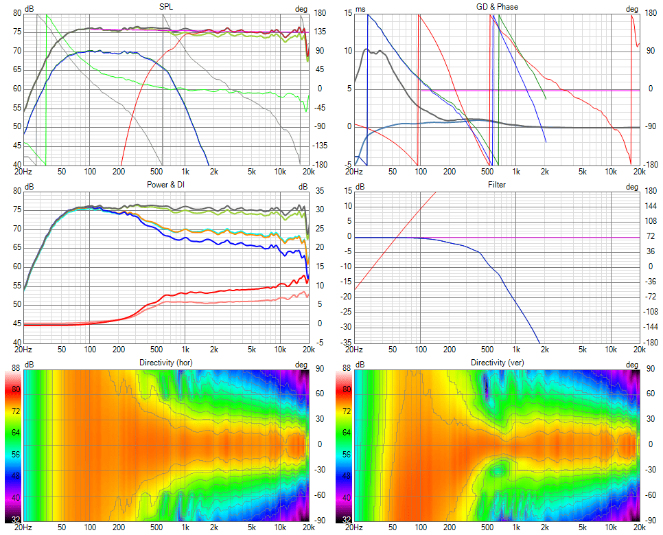

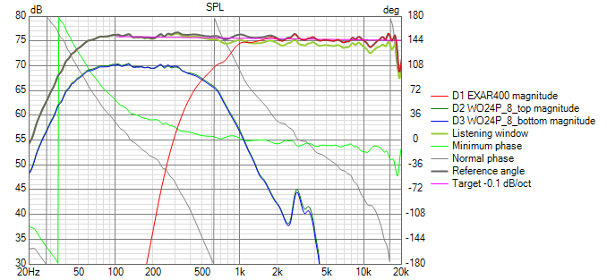

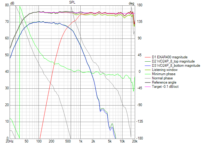

The Satori WO24P's have a very nasty breakup peak.. This driver is unlistenable without enough suppression.
With this lower frequency crossover, it is ok compared to a 1.2kHz crossover which I had earlier in another system (for which I made that EQ).
Crossover without those break up suppression EQs
With EQ

Good point. And the word "artifact" was not the right word. I should have said that DI is a derived metric.For this the DI is very helpful as a simple inidicator of the overall quality, certainly not an artifact - it describes pretty well how the source radiates sound, which is what we do listen to. It's all tied together.
My point is that a visually abrupt change in the slope of the DI curve is not very important, as long as the DI curve continues to increase with frequency, which in this case it does.
j.
But PIR is nothing else, just a different set of polars with a different weighting. Basically still the same data.I should have said that DI is a derived metric.

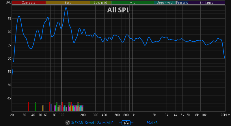

Since the start, I have had doubts about the tonality of the bass to lower mids on this system. The system sounds "darker"/ "thicker" (for the lack of better words to convey what I am hearing) in this region of the spectrum than when I play the same track on my PC and compare it with what I hear on my Truthear Crinnacle Zero headphones. The kickdrums sound slightly over-enthusiastic in the video and in real life compared to the headphones. I have been thinking about what to do regarding this (i.e., whether a simple EQ tweak would fix it or it is an unavoidable room-related artefact). Since the DSP board in this case is not as easily tweakable as DSP on my PC, which I have been using in my previous speakers, I have left the issue as such till now. Maybe I need to experiment a bit more and check if something can be done. Regarding reflections, there is probably nothing that I can do right away due to the living room situation.

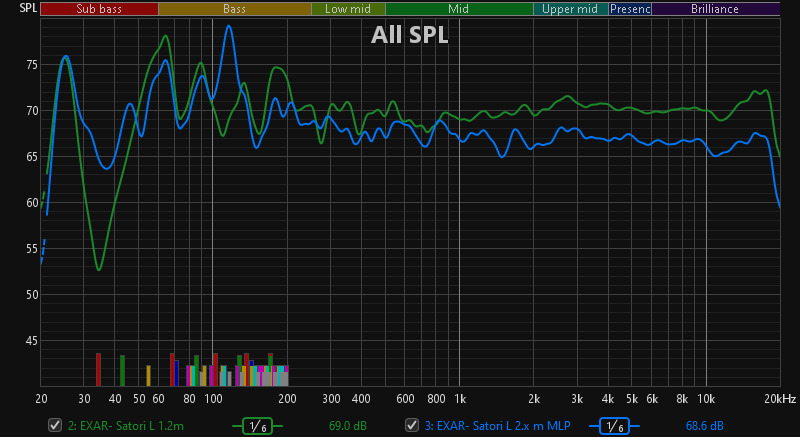

Some tech details about the situation
Frequency response at MLP

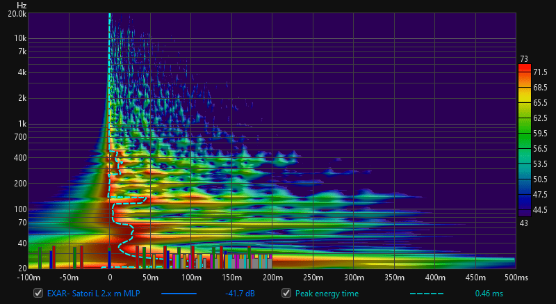

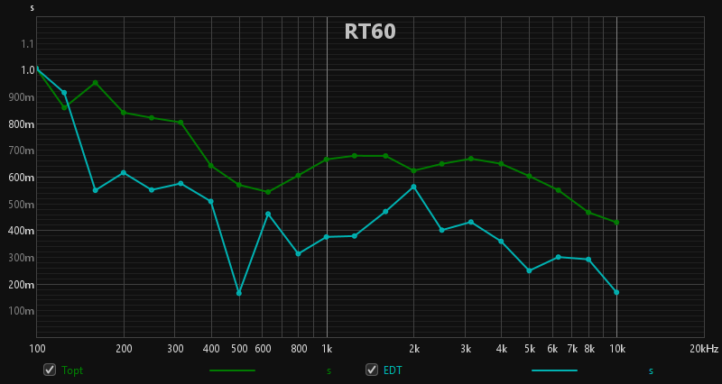

The current RT 60 Topt and EDT plots look like below
Spectrogram
The peak energy dotted line in above curve keeps wiggling around till about 500Hz. I probably need to do something about it too...
