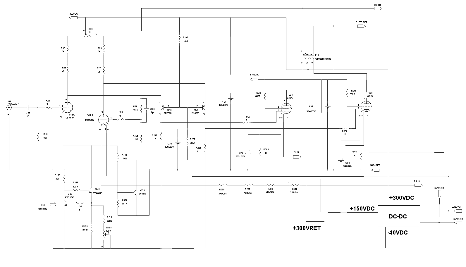

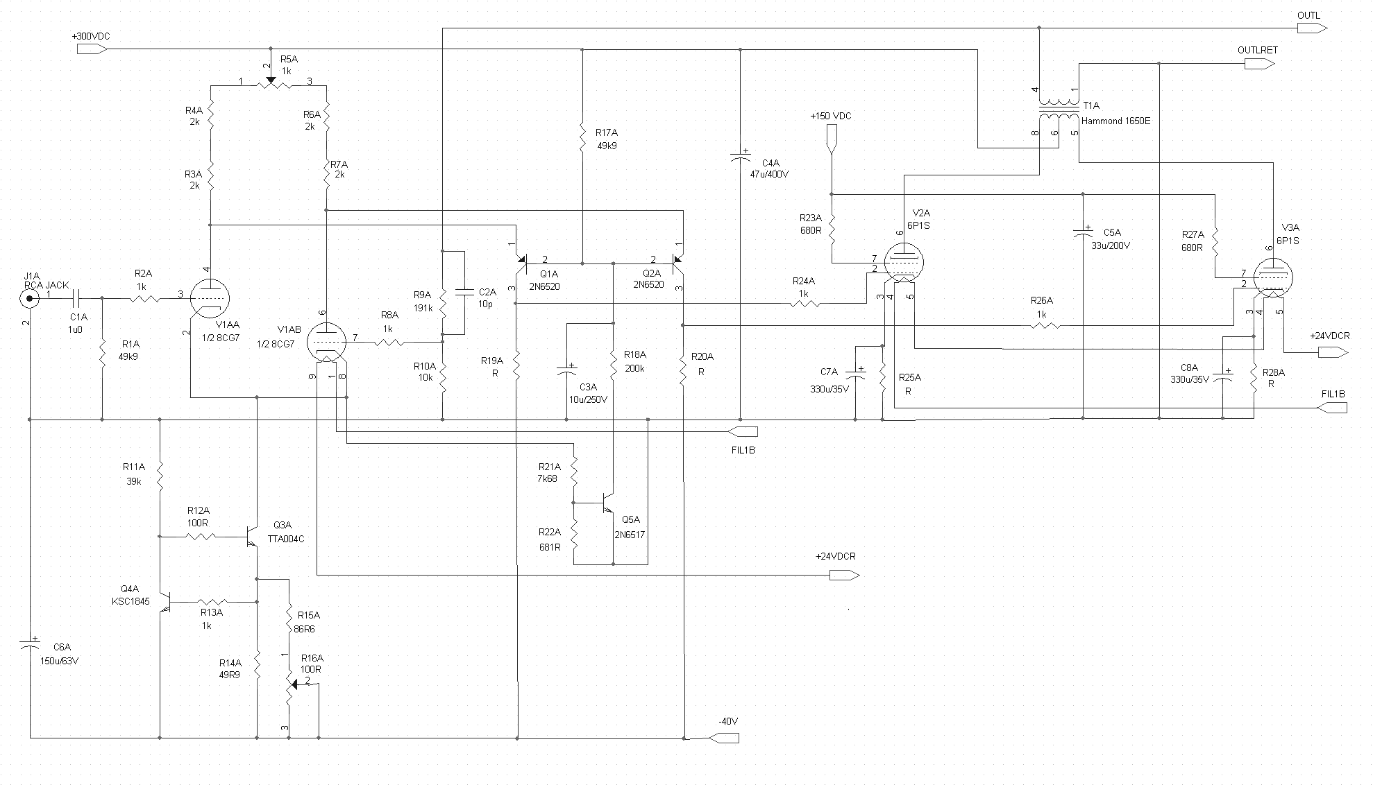

I finally got my schematic sorted out - here's what I have...
You can stick to concepts that make you comfortable, if that's your comfort zone.... I design my own DC-DC converters with dedicated outputs for powering the various functions on the amp. It's what I've been doing for a living for 40+ years - works for me. If you don't like what I do, you have no obligation to go there.
Reactions: berndt and stenak
That's way more parts than my personal comfort zone. The DC-DC converter that powers the amp gets inherent line and load regulation from the switching adapter that feeds it - that, and the balance adjust pot I deliberately put in, should be good enough for this implementation of the amp. I have another amp in the works with automatic balance adjust, but that's a whole lot more parts flung into the mix, and way too ambitious for the simpler amplifier I had in mind here.
Not happening - you apparently don't understand what I'm trying to accomplish with this design. And yes, yes, it is most definitely my call as to what I want to do with this design. I'm most certainly not adding any CCS to my output tubes, especially not a noise factory like an LM317.

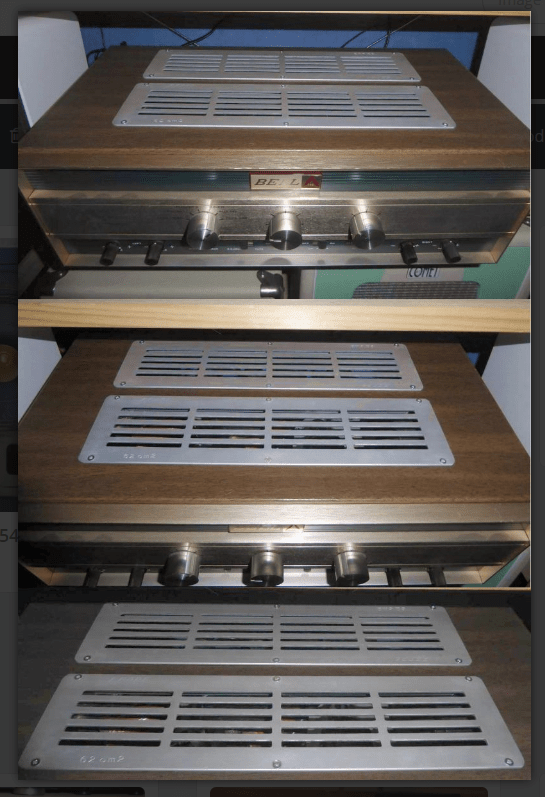

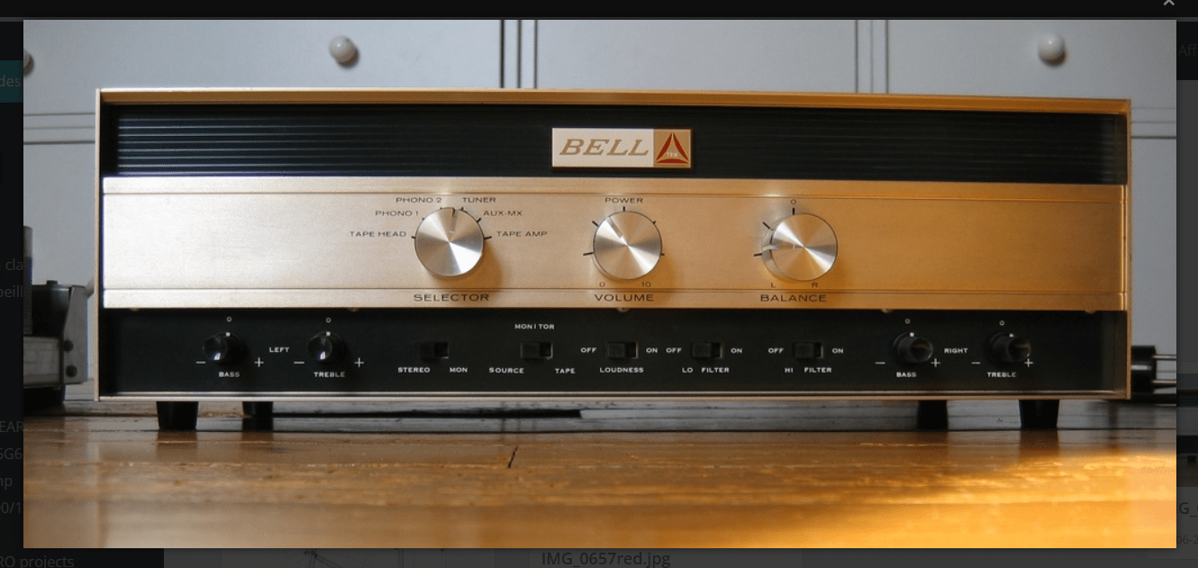

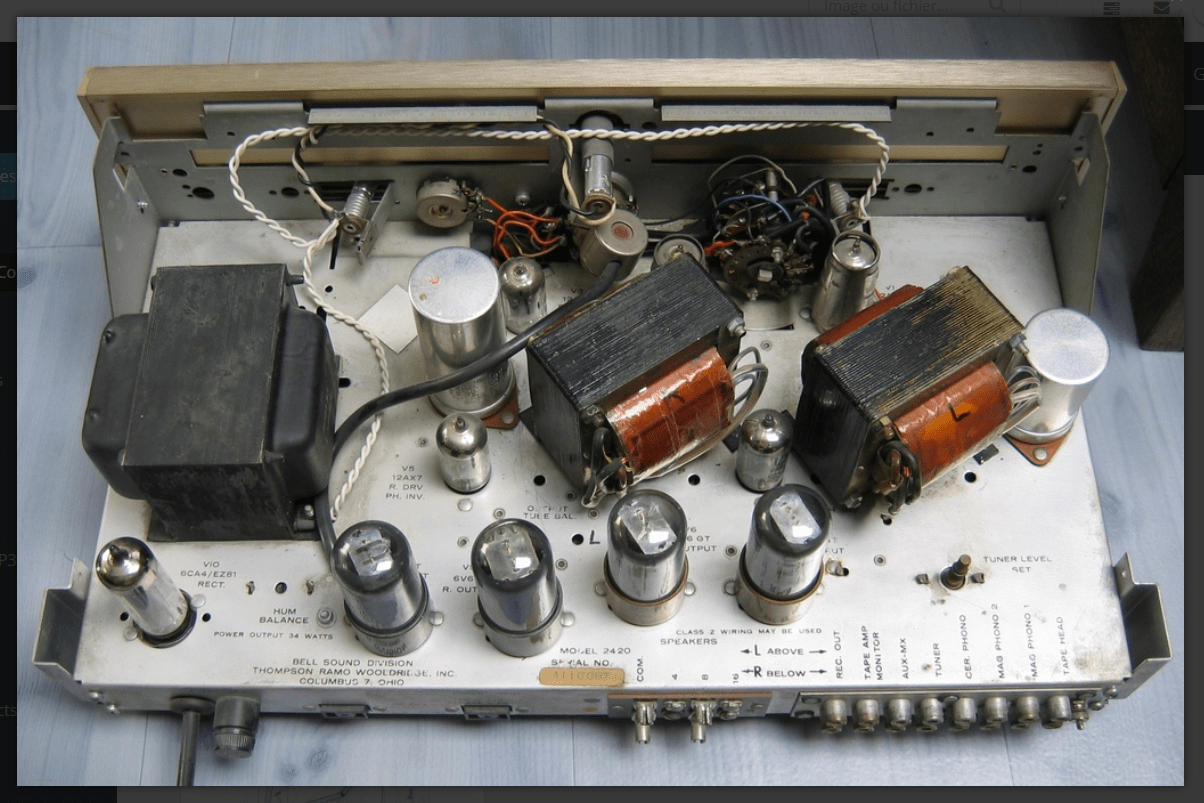

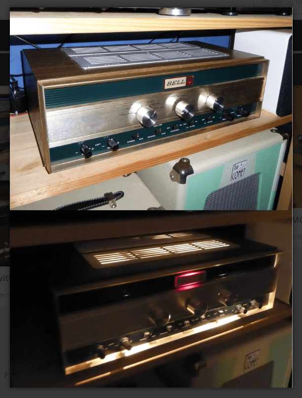

I only have one 6V6GT based amp : a BELL 2420 from 1964 - I love it :
One of the tiny original output transformers was dead, so I replaced both with a pair of Grundig (Germany) 8K plate-to-plate transformers, which are two times bigger and of a much better quality than the original OPTs.
I added a pair of vents on the metal cover, which had none... Needless to say that it ensures a better cooling of the circuit !
And Top Notch : the controls are lighted !

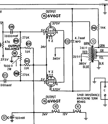

That said, it is a fairly simple design 2x12WRMS output circuit, with 3x12AX7, 4x6V6GT, 1xEZ81 only, which offers all the functions you would expect from a complete integrated amplifier.
A clever tip used in this amp is to heat in DC the two first 12AX7, by using their filaments as the common (decoupled) cathode resistor of the four 6V6GT, providing the 24V cathode bias required :
Simple and efficient...

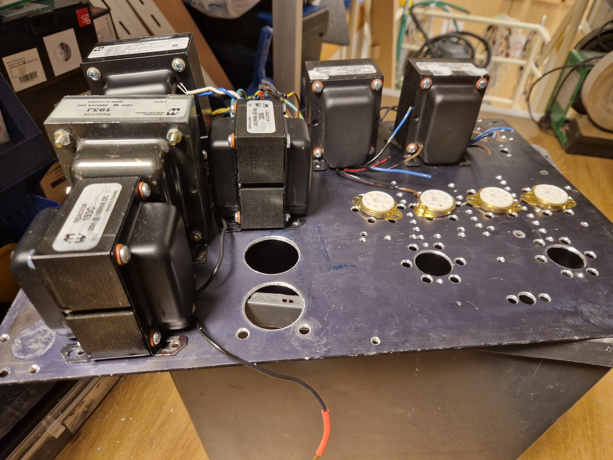

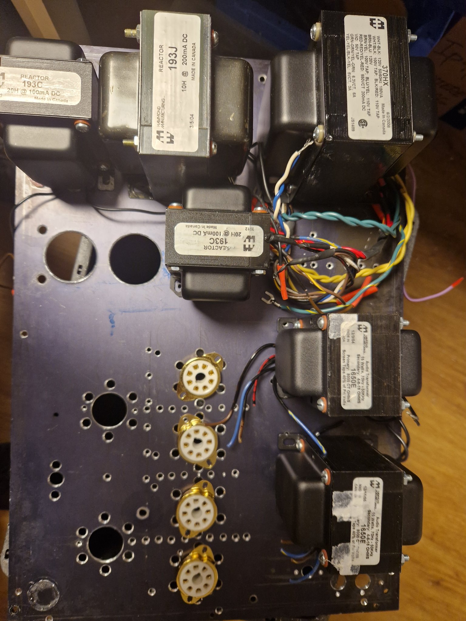

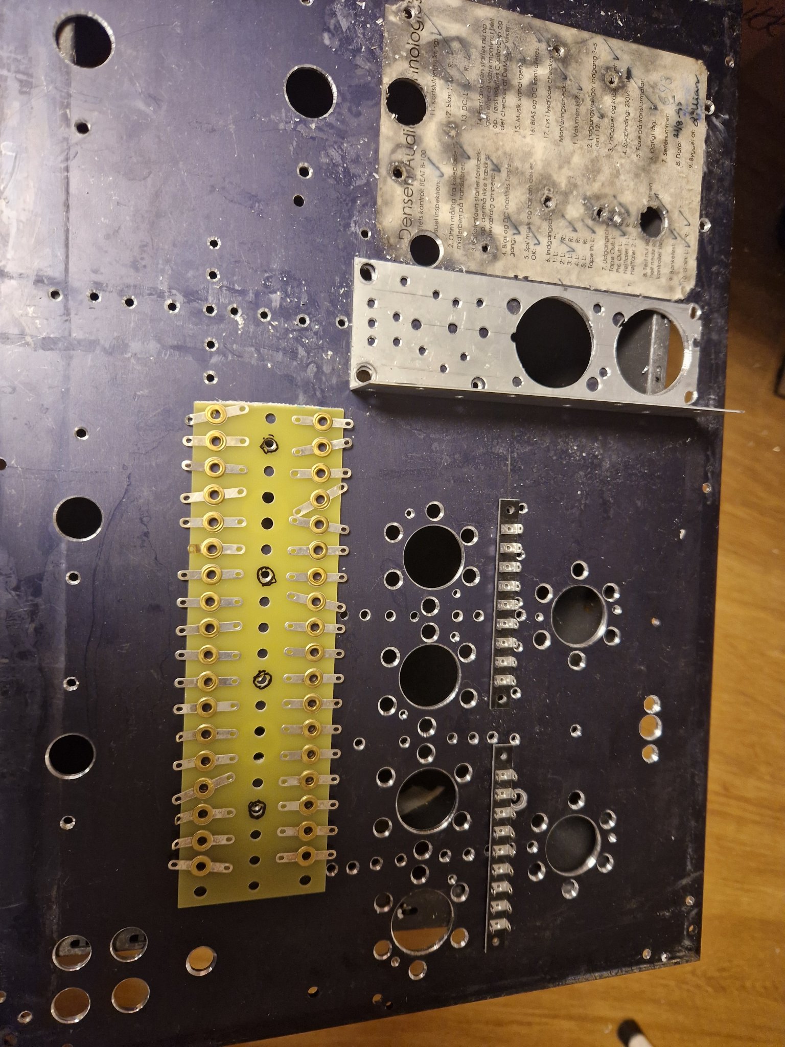

Found an old Densen amplifier that didn't work anymore. Uses the bottom plate which is made of 2-3 mm aluminium. Probably have to reinforce with a little extra aluminum here and there, because the transformers and chokes weigh many kilos. Was thinking of painting the aluminum plate, maybe red?
Making good progress, @stenak. You mentioned it before, and I notice you have one 193J and two 193C reactors installed. Unusual to have that much capacitance for a push- pull power supply circuit. How are you using them? A PS schematic might be good for posterity.
I want to use 193j
(200mA/10H) right after the first capacitor in the power supply, then there will be a split of B+, where there will be two capacitors, and a 193C i each rail , and possibly one more capacitor, before the wire from these will go to the left and right channels. Have used this procedure on my Tubelab Simple PP el 84 amplifier, and it sounds absolutely beautiful.
