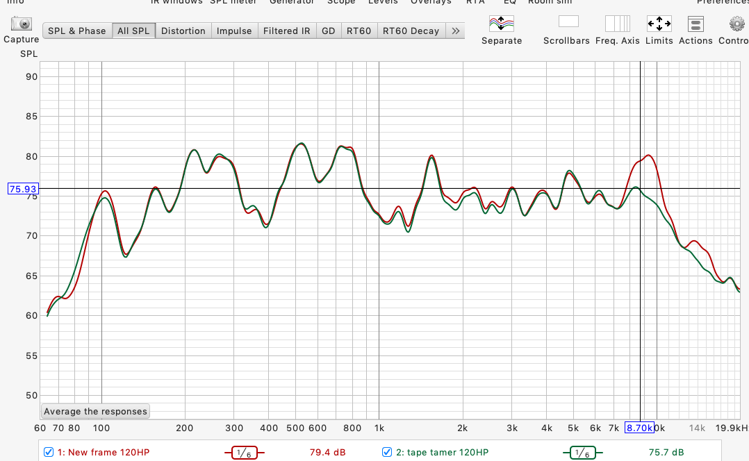

So I did an interesting experiment recently: I built a new frame for panels and I tested baffles. This new frame is like two picture frames that screw together to sandwich a panel, but I used a router to cut a ledge in the front half so it's like an L. I built it from 1"x3"'s that I made from cheap 2x4's. The opening size in the frame halves is 9"x19" but it fits up to a 11"x21" panel inside.
I tested different weatherstripping to sandwich the panel with between the frame halves, and I tested different locations and compressions, overall best was full top and bottom clamped tight (tall aspect ratio panels) and the long left and right sides free. I forgot to try using one spot on L/R sides in combination with top and bottom though.
The more interesting test I did was with baffles. I had the panel in one mounting configuration and then I took some 2x6's and stood them up on left and right sides and measured the result. I made no changes at all to anything, just stood up the boards. Then I turned them 90 degrees from perpendicular to parallel with the panel's face and retested. Then I added a ~15" high and ~3ft long piece of scrap plywood below the panel face to mostly cover the gap between the panel and the floor. I only tested one panel in this frame so far so don't mind the specifics, just the differences. Here's the results:
The dips around 75hz and 275hz are caused by my room - previous outside testing proved that.
So the frame with no extra baffles has a 3" wide baffle already. I added an extra 2x6 on each side here, and the bottom was ~15". I did not do any kind of edge treatment, just normal radius that comes on 2x6's here. The 1x3's have pretty sharp edges, only lightly sanded.

I spent many hours testing some things today and I started with some mounting tests. Here's this test frame:
frame-jpg.1301917
Next time I certainly will not use a router to make those insets because they are 1" wide and about 0.8" deep. Pic is of the back side, the front side has a very thin (~1/8" thick) face of that 1" wide inset remaining.
None of these mounts are independently adjustable, but there's two screws on each side which I thought could help with adjustments. They don't work very well, but I tried.
All the tests are done with this same panel and the exciter and frame were never moved, except one test where I moved the frame forward 1ft just to see how it changes things. When adjusting foam the panel had to be removed, foam moved, then put back in so there might be some small changes to the effective position of the exciter relative to the front frame opening. This was tested in my living room which is completely untreated, but it is medium size and has carpet and a couch at least. Frame is in center of room but ~3ft in front of my 85" tv with mic 6ft away. The exciter is a rattling 'thruster' mounted at approx 3/5 position.
I've attached the mdat. I found later after a lot of other tests when I remounted this panel and moved it back next to the tv there was a big dip in 150hz - 225hz and I discovered that shimming in a piece of foam in the center of LR between front of frame and panel made a significant improvement.

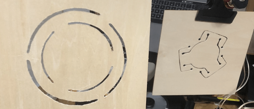

Today was the first day that I've ever setup two panels for a stereo test. I've spent months testing just one panel at a time, completely overlooking the stereo experience. One thing I've always known about these DML panels is that 1 decent panel sounds much better than 1 tower speaker in a few ways, but what about 2v2?
Well, the center image is way more focused and sharp with my tower speakers. The DMLs are very 'open' which is pretty amazing for some things, but it kind of detracts from the experience for a lot of tracks. After lots of A/B'ing and some adjustments to improve the DML center focus I decided that the 'open' sound is definitely worth losing a little center focus for, but not too much.
For testing the center image focus I used CamillaDSP to convert the input to mono and send it to both L and R and then I sat in the middle and listened for how tight that center sounds. I also listened in stereo to various songs to confirm too. I played with the setup to get that center more focused for the DMLs, but the tower speakers were no effort at all - easily very focused and sharp. The center image is pretty important for the experience of many tracks so this is going to need more attention than I expected.
The first thing I tried for improving the image is how I thought I was going to build DMLs last year, which is also a suggestion I've seen here: put some absorptive material behind the panels to reduce rear reflections. I used folded microfiber blankets right behind (not touching) the panels for this but the panels really don't sound as good that way. They sound more "in a box", closed, muffled. It can measure better this way but it definitely does not sound as good. Maybe some large absorption panels several feet away would be better.
I moved the DMLs around the room to try to focus the center but it took me a while to find something that works. First I tried moving them closer together (blocking the view of tv) but that didn't really improve center focus, it only shrunk the entire soundstage a little bit. Then I tried moving them further out into the room, that didn't work. Toeing in and out didn't work. Toeing in and sitting close didn't work. What did work was moving them back towards the wall, about 2ft off the back wall. My tv is pretty big and this wall is the short one so I've only got 1ft or so from panel to side walls. This was the spot that my towers were always in but I had to move them out to be able to put panels there. The result was a big improvement in center focus. Still not as good as the towers, but good enough to trade that loss for the openess and midrange clarity of DMLs.
I know from previous tests that baffles make a big impact on the soundstage but I didn't experiment with any today. Trying things on 2 panels is twice as hard as 1 and I don't have enough scrap wood and clamps to mess with them both :| I am pretty confident that baffles will improve the center image along with the FR.
