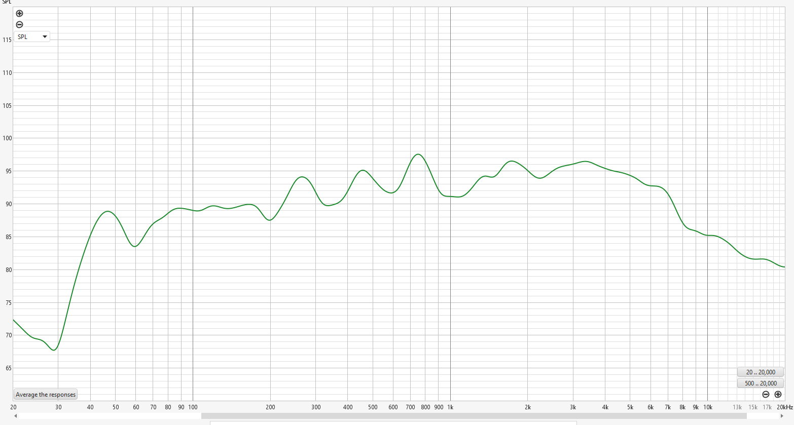

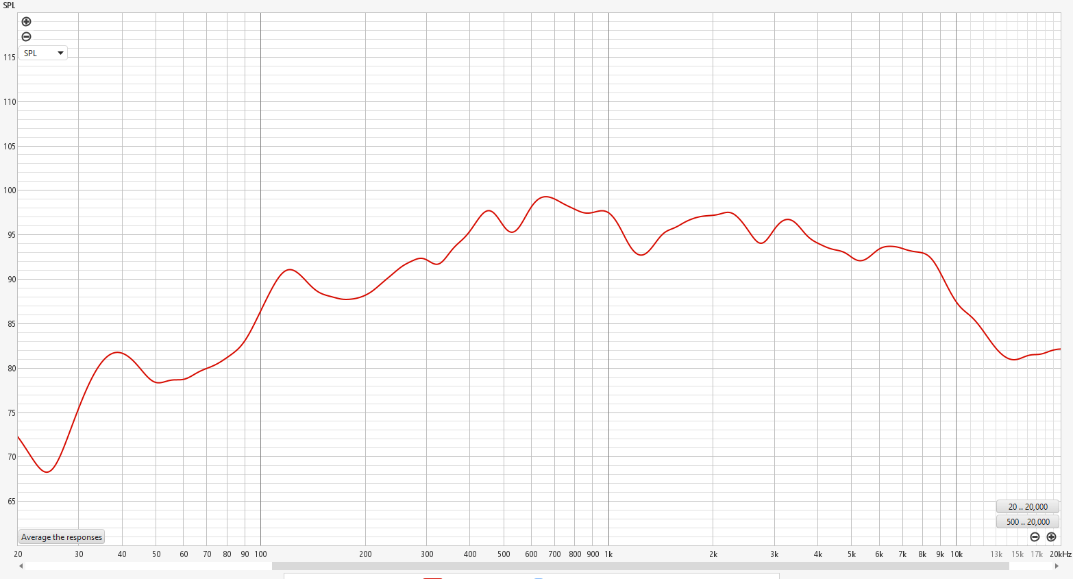

I spent many hours testing some things today and I started with some mounting tests. Here's this test frame:
frame-jpg.1301917

That pipe insulation idea is very interesting. Damps gently, blocks edge, and adds a little rigidity. I have only done a couple tests with 4ft tall panels of 2" thick XPS and 0.75" thick light EPS, and those test results were not good. I discarded the idea. Such a large panel seems too hard to control, using multiple smaller panels is a better solution I think, though I haven't actually tried stacking multiples.
I was stuck with using out-of-the-box dimensions of foam back then but now I have a hot wire table, maybe I'll try a big slice of a 2'x4' XPS panel soon. I do need to cut my last quarter sheet soon to make more test panels so maybe I'll test the whole thing before cutting it down.
I think the full surround makes sense for wider panels but I've been using this narrow tall aspect dimension right now and generally having surround on top and bottom only gives best results.
I ordered some butyl rope the other day and I'm going to try lining the edge of a panel with it or using it instead of foam in the frame. One problem with the pipe insulation might be noise that the panel makes when rubbing on the foam, if it rubs anyway. When doing preliminary testing of panels on my carpet floor I've noticed that the carpet on the panel edge does add measurable distortion. Adding my hand as a weight on top of panel helps lower that but it is still present. I think using CLD technique around the panel mounting points might bring significant improvement. Butyl rope should help to easily and cheaply test that idea.

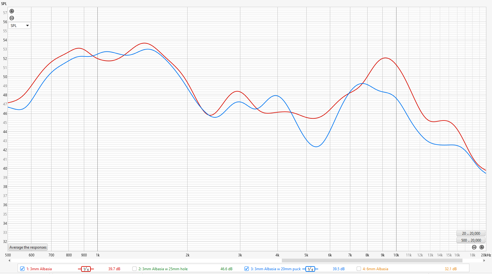

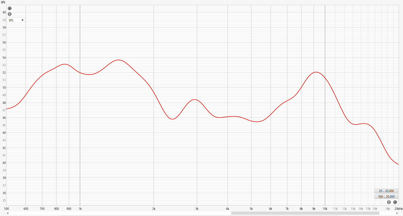

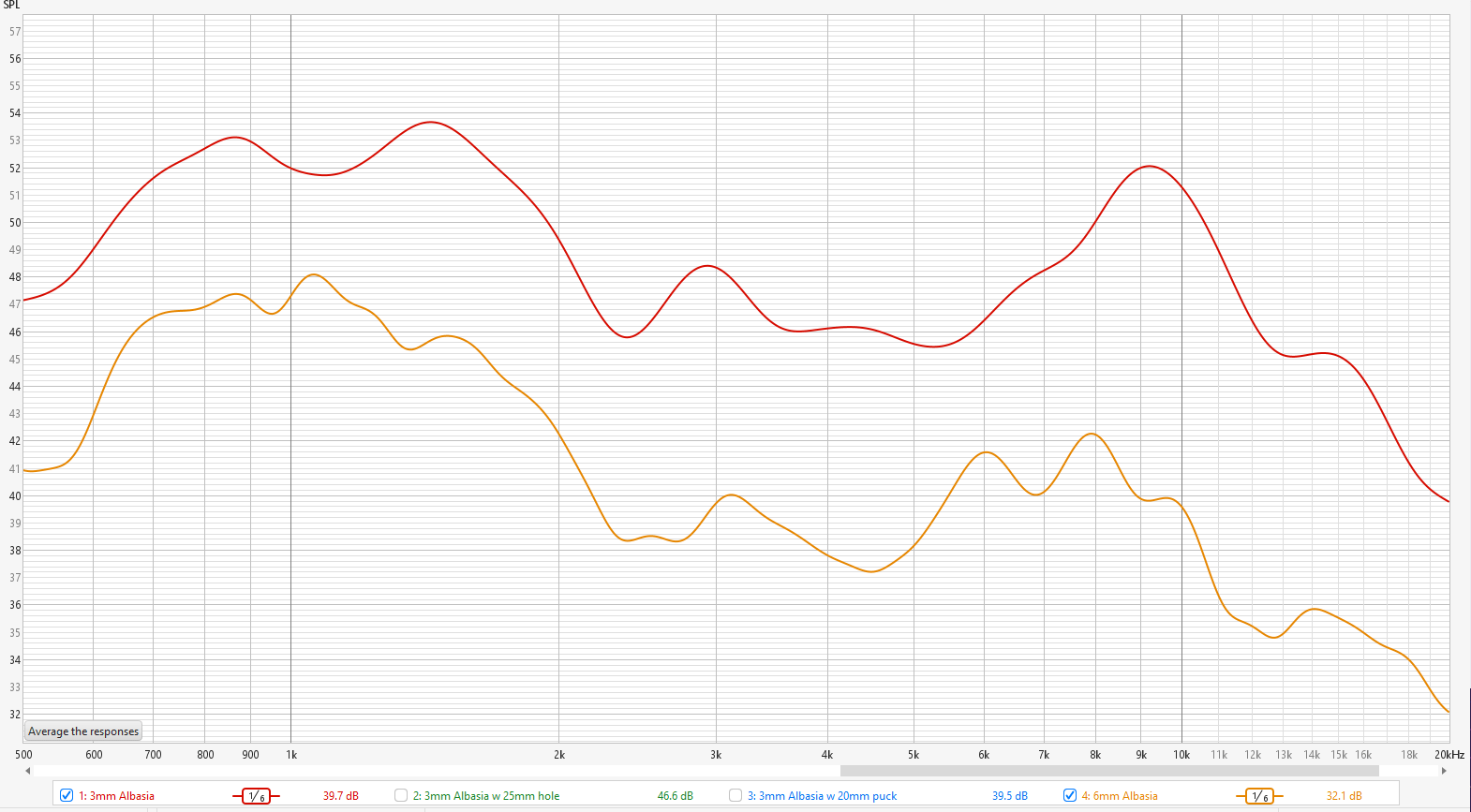

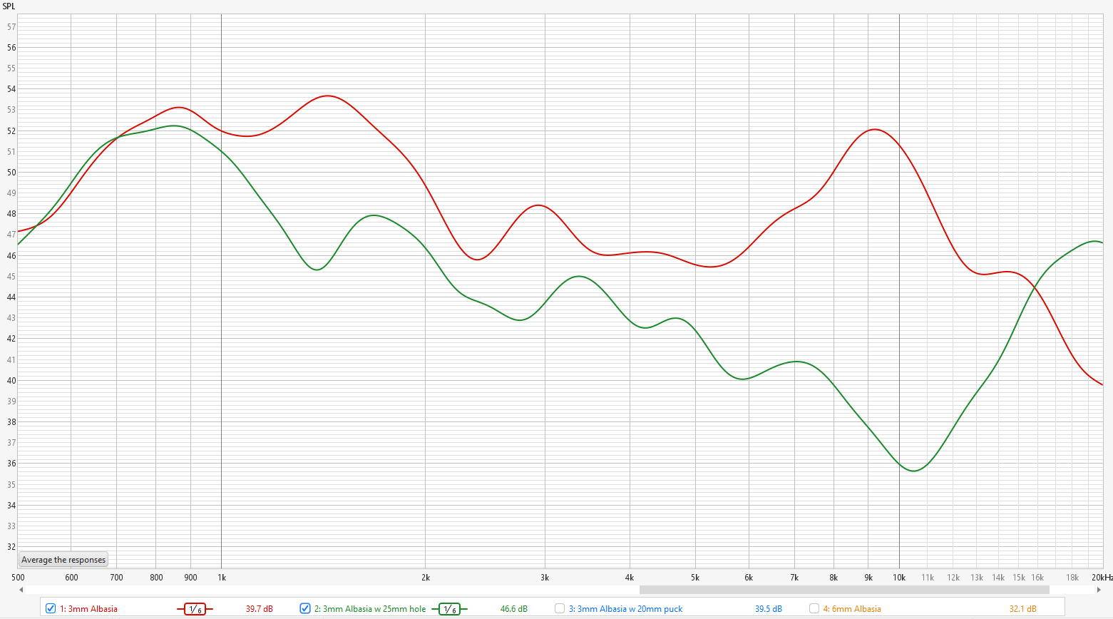

I've also wondered about the size of the point on panel receiving excitation. I 3d printed some different mounting plates in the past to try different sizes for the point of contact, and some through-hole mounts as well. I didn't have any frame at the time though and I only tried it on some not-so-good panels so those tests don't really mean anything anymore. Best result on foam board back then was using a larger point of contact, through-hole, with a large washer-nut on the front side. 3" was the diameter I believe. Building a custom coil brings the question of how to best shape its point of contact with the panel, as well as questions about the ideal specs. I don't know anything about voice coil design, really
