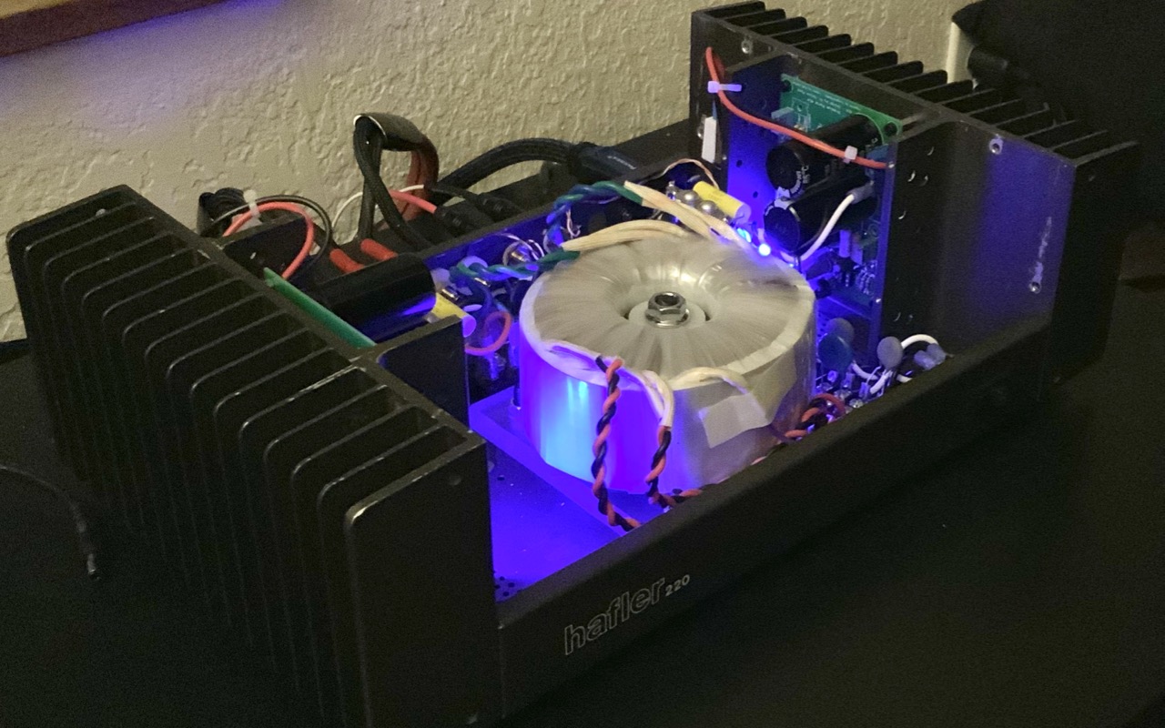

Some construction notes
The DH-220 donor chassis has proven to be a good match for the enhanced ACA, and has plenty of room for a good sized transformer and reservoir capacitors. Probably the biggest effort in prepping the metal was enlarging the original power cord hole for a proper fused IEC inlet. Otherwise, the locations for the RCA inputs and speaker terminals are well suited for a stereo or bridged version of the ACA. Several of the other holes in the bottom plate may also be re-used for the new hardware. The best thing about the old chassis is the pair of well-sized heatsinks. With total power dissipation now running at 44 Watts on each side, the heatsinks are just nice and warm to the touch. No where near hot yet. The new PCBs fit conveniently between the pair of large internal flanges, and I've bolted the 25W power resistors to the rear surfaces.
I've recently adopted the practice of bolting the toroidal transformer onto a slab of Acrylic, which is in turn bolted onto the bottom plate of the chassis. I use rubber stoppers inside the center hole of the toroid to further dampen any mechanical vibration. Though I'm using a steel bolt through the center of the transformer, its flat head is recessed into the acrylic, so there is no electrical connection with the metal chassis. I've wired the dual primaries in the same manner as recommended for the various FirstWatt clone amps, in this case using a pair of 15 Ohm, 3 Amp thermistors. The bridge rectifiers on the secondaries are the GBPC type 35A, 400V. (These nasty little buggars drop over 3 Volts as bridge rectifiers, but are otherwise bullet-proof.) The DC negative side of the bridge rectifiers are connected to the chassis through separate CL-60 thermistors. No other connection is made between the chassis and audio ground.
I've used CAT-5e twisted pairs between the RCA inputs and the PCBs, routed carefully under the rear lip of the bottom plate. No other shielding of the input wiring was necessary. I did take the precaution of wrapping the AC power input wires with copper tape, and grounding that tape to the chassis.
Of course I am saving the unobtainium lateral power MOSFETs for another project. ;)
ACA-220
After a couple more days, the sound of the new build has improved noticeably. It is now less laid-back (in a good way) and has a greater sense of ease and flow. Something some folks call PRAT; it now has that and sounds more compatible with my Naim front end. There is also more tonal and micro-dynamic detail coming through.
Compared to the parallel-monoblock ACAmps that I have been enjoying, it is very, very close and even better in some ways. This build sounds like it has no problem driving my speakers, up to its physical limits of voltage and current. If anything, the inner details surpass the parallel-monoblocks. The lower bass may be slightly less full, but that sense changes from one recording to the next. I double-checked by hooking up the parallel-monos, and the background noise with no music playing is virtually the same. Both amps are incredibly quiet. However when music is playing, the newer build appears to present it from a blacker background. The subjective effect is greater clarity and dynamics.
The ACA-220 as it stands is going to remain unmodified for a while and used as a new benchmark, as I try out other ideas with other PCBs and chassis. Another DH-220 arrived yesterday (yes, It's a sickness), so I am free to tear down one of my other 220s to use for donor chassis and hardware.
Another build note: Rudi's boards measure 75 mm by 100 mm. There would be just enough space to install these in the diyAudio store ACA chassis, but the brackets would have to be modified to allow room for the standoffs at the four corners of the board.
This the current configuration of the ACA-220. The PCB also holds a pair of 10,000 uF caps plus two 0.22 Ohm resistors in a Pi filter network. As mentioned earlier, the position for the LM1084 is unused. Off board components include a 22,000 uF reservoir cap and a 1.82 Ohm power resistor.
The amp was built to accommodate several power supply variations, including different voltage transformers and an enclosed SMPS instead of a transformer. The next build will explore some higher voltage options.

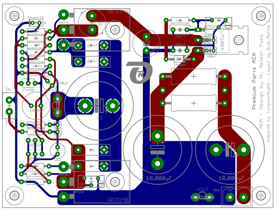

The PCB layout is courtesy of forum member Rudi_Ratios, and so isn't mine to give away. He seemed interested in offering a group buy at some point, but only after I've made my final recommendation, and we've made a round of adjustments to the layout.
One of the main features of this layout is support for an integrated regulator, the LM1084. While I've installed the support components for this, I haven't installed the regulator itself yet. There are several scenarios where a regulator may be very useful, but I haven't done those yet. So far the CRCRC filter seems to be doing a marvelous job.
A couple other features that I requested have been partially used so far. R16 has been added to filter the power going to the Drain of Q4. The RC combo of 200 Ohms/100uF seems to work well for the standard voltage that I'm running. When I switch to higher voltages, I'll probably use 1.0 k for R16. Sort of a cheap way of emulating a cascode arrangement for the input buffer. There is also provision for two parallel devices in the Q4 position. I haven't tried this yet, either, but again there are a couple applications where I think it could be useful.
Thanks for the input. I was already planning on incorporating the 7824C VR 1.5A as an option so that is kind of nice, using a 48V SMPS, but also was thinking about upping the voltages like yourself.
You think the added Q4 capacitance will have that much of an effect, or is diminishing returns? Also, are you thinking of increasing the 100uF cap once you increase the voltage?

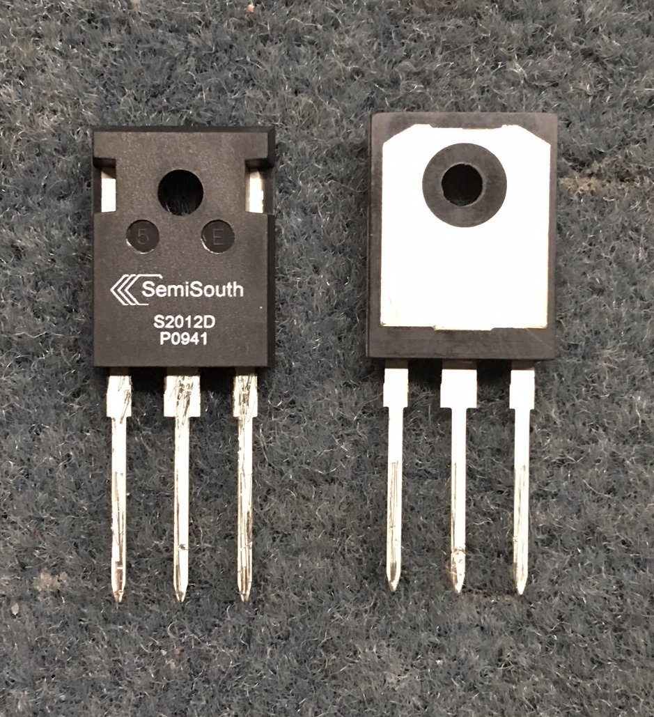

It is with great enthusiasm that I write this and it is
with great disapointment that I must add the following.

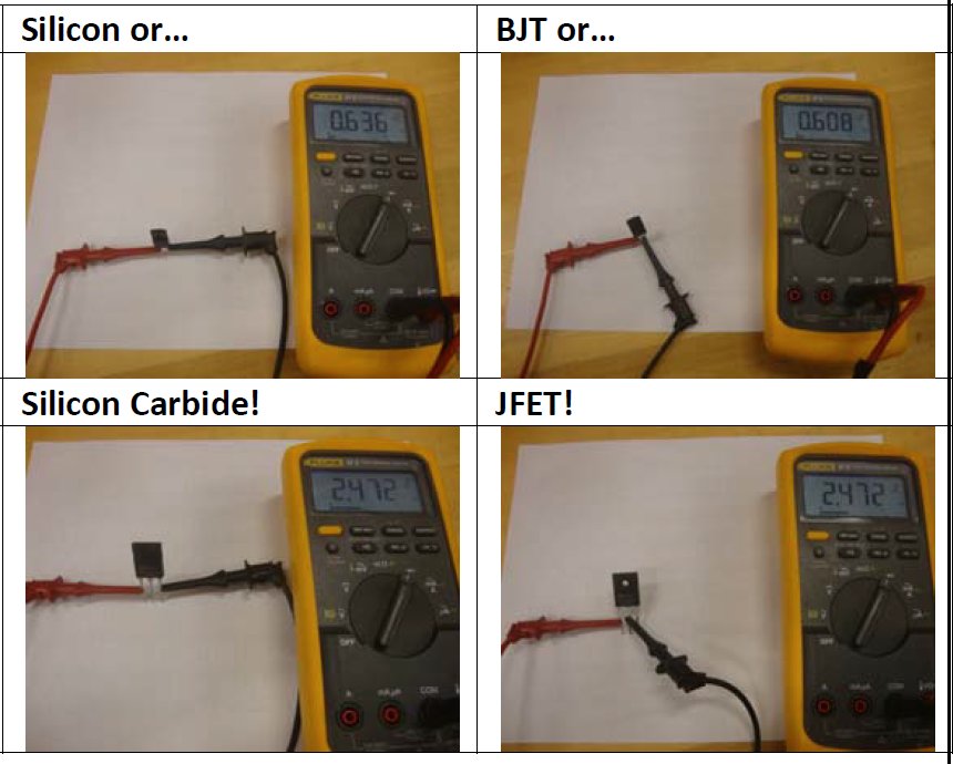

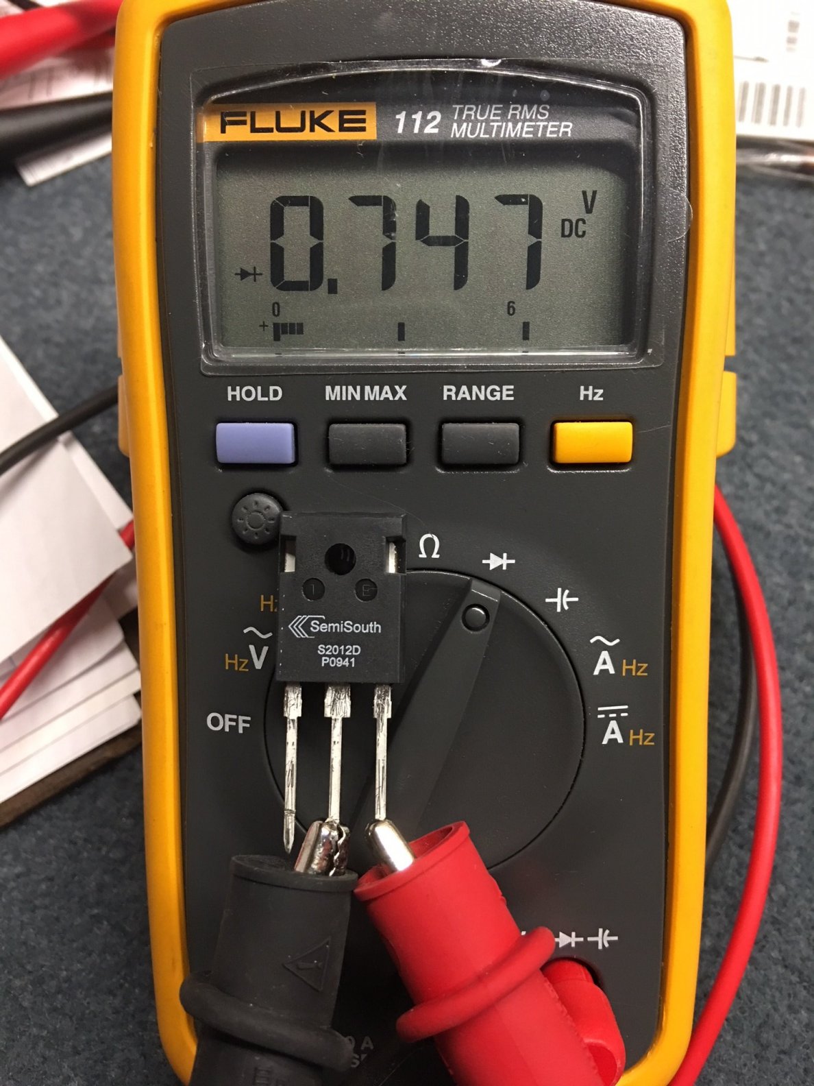

While attempting to find out on my own what
chromenuts discussed when using the semisouth part,
I had hoped to duplicate it.
After some further research was I disappointed.
In short I bought these: LINK
They measured like this: LINK
Then I found the inventor's tests: LINK
Which turned out to be nothing more than an SCRs :(
If only for a real pair or two.
Well Cheers anyway,

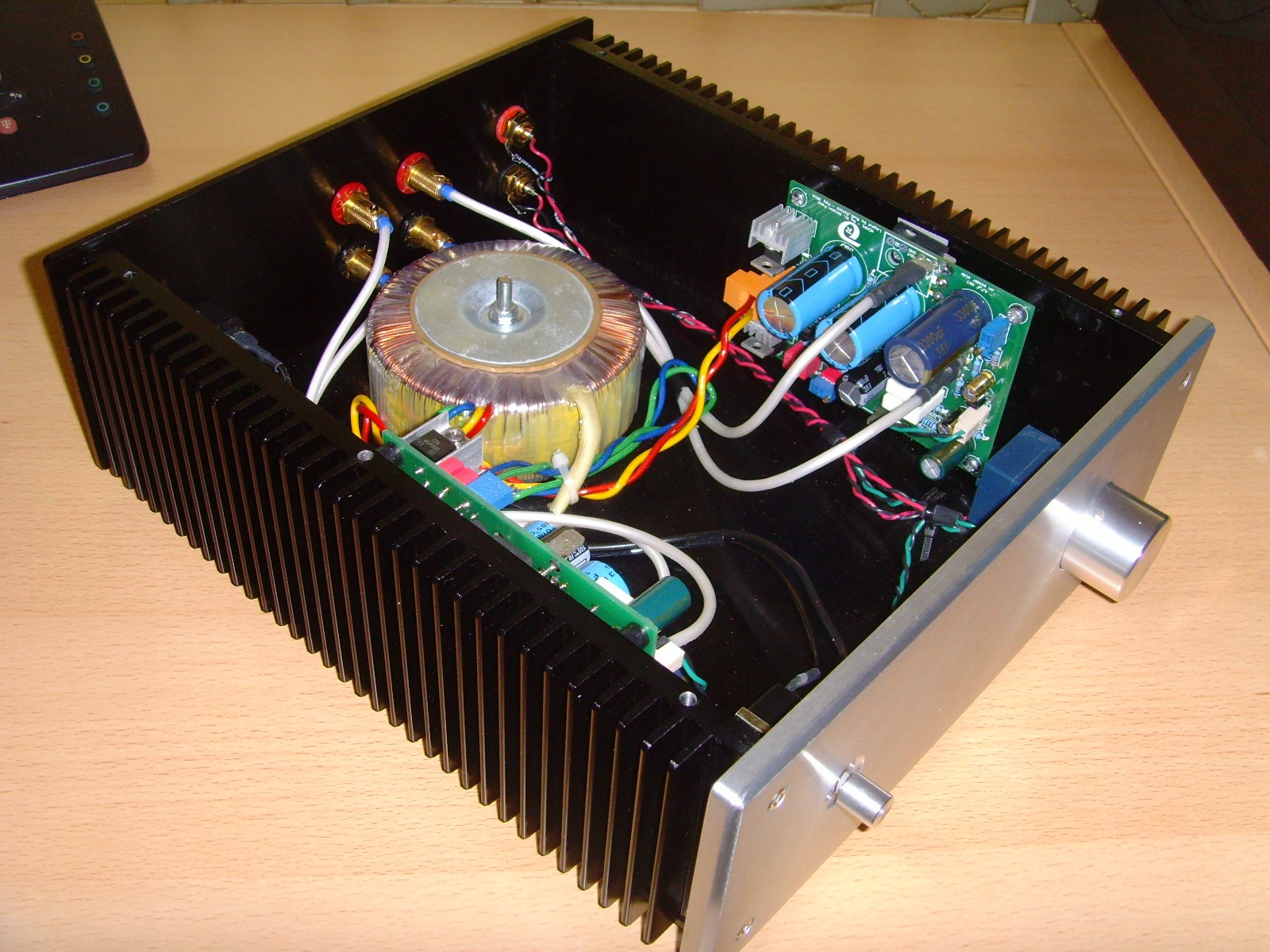

I have built my 1st ACA-amplifier 6 years ago (see image#1) - according to Mr. Nelsons Pass' AMP-Camp instructions and recommendations - for example: to use a Notebook 19VDC PSU),
but I have been disappointed about its sound, when I have listened to it for the 1st time.
I had connected it to my PC's SOUNDBLASTER Prodigy Soundcard (no bad choice, as I have been told oftenly) , but: the ACA#1 sounded "slow, offered little emotion, "dripped the sound
into a river like a raindrop".
I wondered why Mr. Pass has designed such a "average / poor - sounding" amplifier and talked about its design with several of the ClassA-experts of this forum.
I have then changed my original design to use a 24V CAP-Multiplier-PSU (see image #2) , which sounded definitely better!
The reason (one of its reasons as I have been told): the internal COB of the used IRFP240 drops, as its VDC raises, and contributes to a "smoother" sound!
But: since a CAP-Multiplier-PSU does not provide any line-regulation, I have changed my ACA#s design once more and am currently using a LowNoise PSU-Regulator (LM1084)
for its PSU - see image #3 for the current layout.
This is when I met you - TungstenAudio.
I have begun to solder the current layout and will give you my accoustic impressions as soon as I have finished the PCB.
Best regards - Rudi_Ratlos

Hi Rudi!
Great to see some of your previous work and the new layout. I hope the boards got fabricated with thermal vias for the ground pins of the big caps. I’m busy building the next amp in a Hafler chassis. This will make full use of the voltage available from the Antek AS-3222, and allow for regulated voltage of 24.5V, as well as unregulated of about 26.5V from the CRCRC filter. I also have a pair of AS-2225 transformers waiting to supply even higher voltage, though I now wish they were AS-3225’s instead.
I have received my Mini Dissipante 3U chassis from Hifi2000, and have different PSU plans for those. With all the configurations to try, a couple more boards wouldn’t hurt. ;)
I’m not aware of a pre-built 24V PSU that would be significantly better than the Mean Well GST120A that is sold on the store as a companion to the ACA kit. The linear power supplies that I have been experimenting with more recently are relatively straightforward, but do require some familiarity with this type of construction. Note that I am also stepping a little out of bounds in current and voltage relative to the standard ACA.
Have you tried the other modifications mentioned earlier in this thread? You may find those to be worthwhile before trying an upgrade to the PSU.
I think you might be pleasantly surprised at what the ACA can do with the standard 24V SMPS brick. If you read through the main ACA thread in the sticky section of this forum, you will notice that a few builders have incorporated enclosed SMPS supplies inside the chassis. The 'standard' ACA Mini Dissipante 2U chassis is a bit of a tight squeeze for this, and usually requires that the SMPS be mounted on its side. This type of construction requires that one be comfortable and familiar with the means to safely bring AC line voltage inside the chassis. As a starter kit, the standard ACA keeps the AC line voltage safely enclosed inside the PSU brick.
If you build a second ACA, then you have some very attractive options available to drive your speakers with a pair of monoblocks, rather than a single stereo amp. Those options are definitely worth exploring with the stock brick. The illustrated ACA 1.6 build guide shows how to do this.
