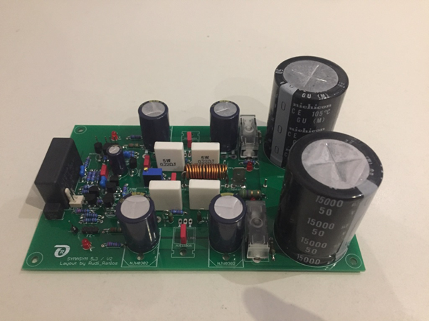

I have been busy supporting a German DIYer building a "7.4.1 Home Cinema Soundstage" in the past weeks.
My support resulted in a very compact version of Michael Bittner's "SYMASYM 5.3" (see image #1).
My DIY friend has already built a couple of PCBs, and he is absolutely content with the SYMASYM's performance and its sound!!

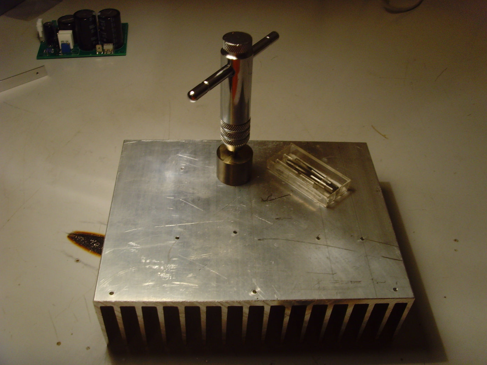

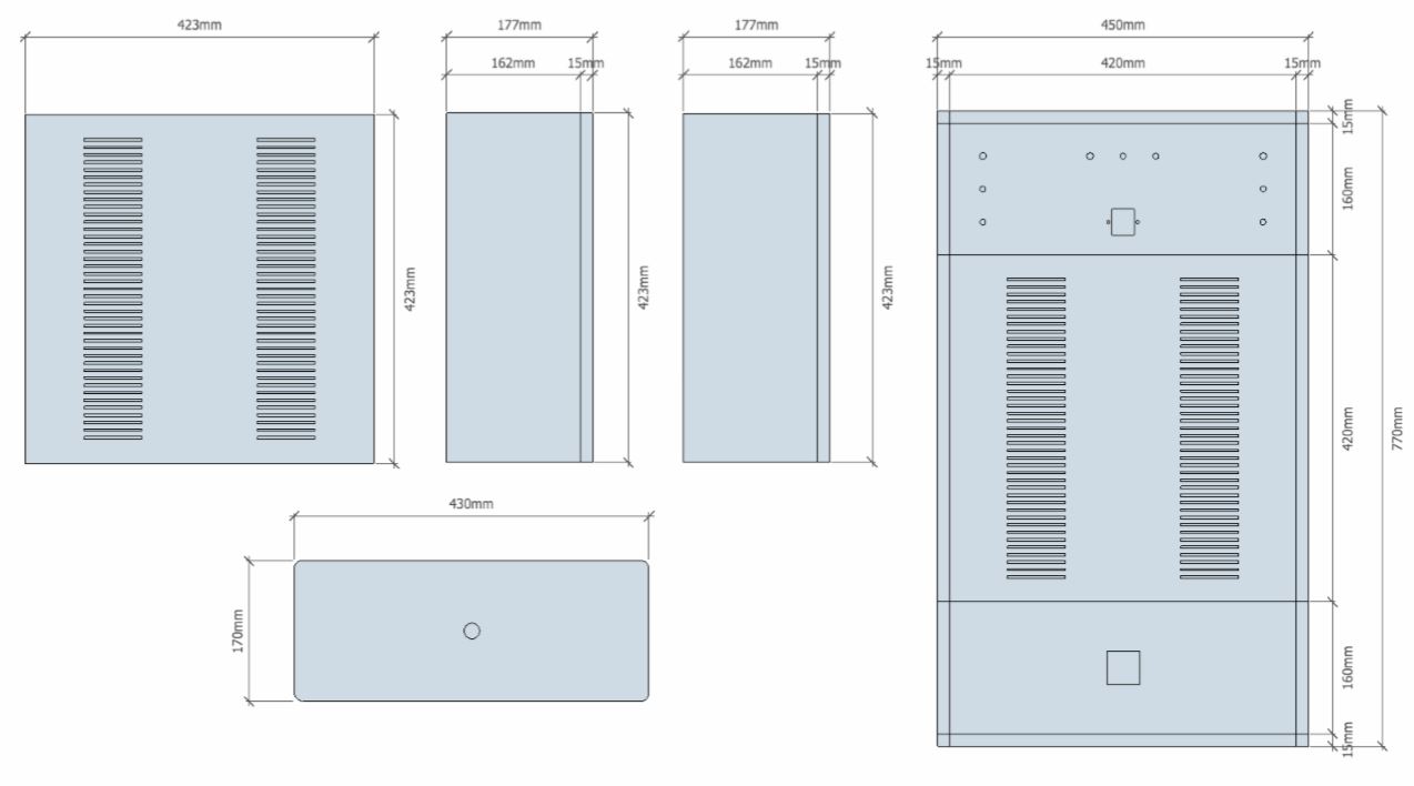

As a "Thank you" he is offering me an ALU-case "for Nothing" (see image #2) that he designed himself, using the Sketchup Software,
and use for his Home Cinema SYMASYMs.

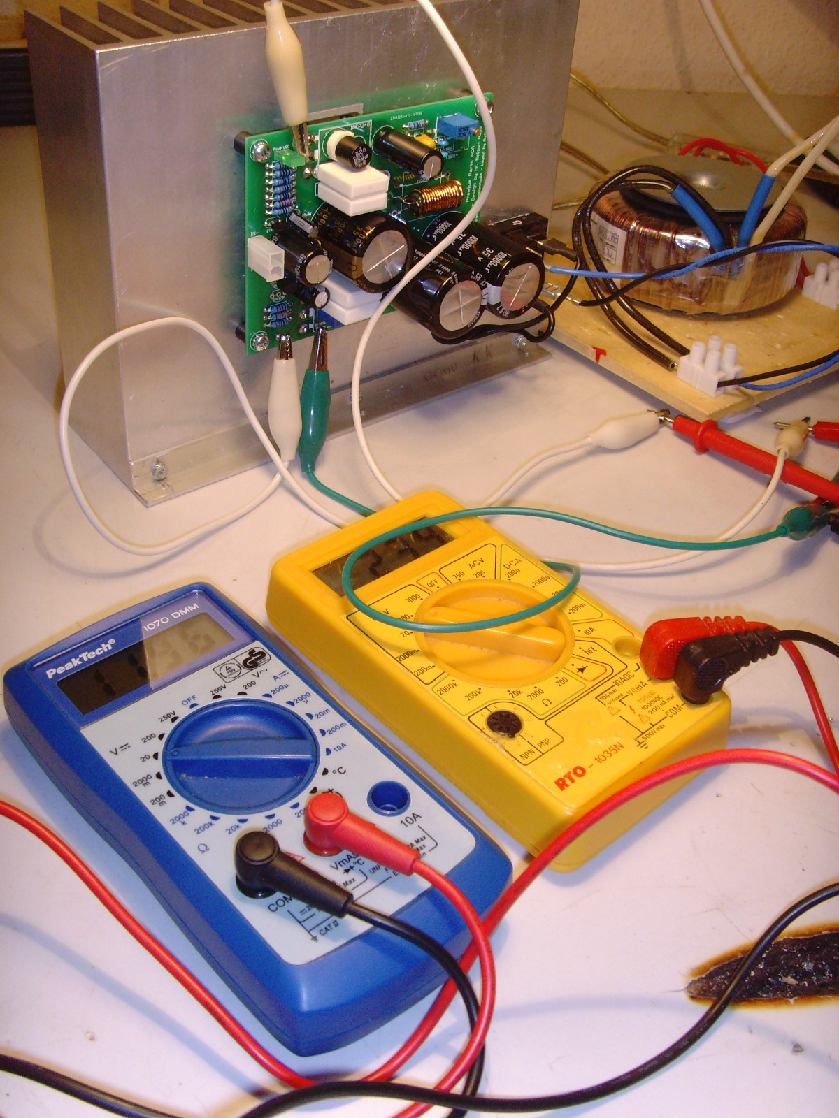

I have now time to proceed with the build of a new ACA#1, this time using your modifications (your resistor values, for example, …).
See Image #3 and #4, taken this morning, when I tapped the heatsink and adjusted the bias / quiescent current for the ACA.
As you can see from the picture, my new ACA is driven from a 2 x 19VAC / 160VA INDEL torroid transformer, the rectified AC voltage being
backed up by 2 x 10.000µF Nichicon electrolyt capacitors with a R/L filter between them, and then fed into a LM1084 PSU.
In effect: this is a dual-mono build, and I cannot imagine any better / simpler / lower-cost PSU for the ACA#1! This is my impression !
My HP / Agilent DMM and my oscilloscope show a ripple of about 20mV on the adjusted 24VDC. This is not bad at all!
As soon as I have built the second channel, I will tell you about my sound-impressions.
Best regards - Rudi

Hi Rudi, that's looking good!
Dual-mono is definitely the way to go. There should be plenty of room in that chassis. What bridge rectifier are you using? If I read things correctly, you are only getting 1.2V drop across the bridge. Mine drop about 3 Volts, and I would really like to have some of that voltage back!

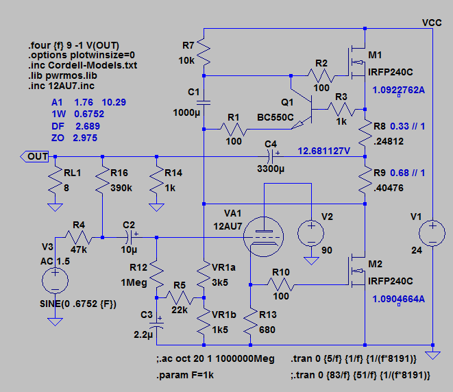

Hi James, the ACA is a very robust and versatile topology. Since you already know how to work with tubes, here is an idea you may find interesting.
Very interesting. In order to make a proper (non-) sissy version, the 12AU7 really needs at least 200V B+ supply, or better still, 300V regulated. I would go with a Mullard 6189 per channel, with matched triode sections connected in parallel for lower noise and better drive capability. Maybe a single ECC99 would work for both channels. The filament supplies need to be independently regulated for each channel.
This also gives me ideas for replacing the input JFET with an easier to source component like the LND150 depletion mode MOSFET, which would bias very similarly to the 12AU7. Bonus for not having to build regulated filament supplies, which can be a bit of a pain since most HV transformers just barely put out enough voltage on their filament windings to allow for proper regulation.
Good idea with the LND, but there is a practical limit to usable HV without a negative bias supply. An ACA with 12AU7 input tube @ 90V is estimated to have ~0.9% negative phase H2 @1W into 8 ohm. Have fun. :cheers:

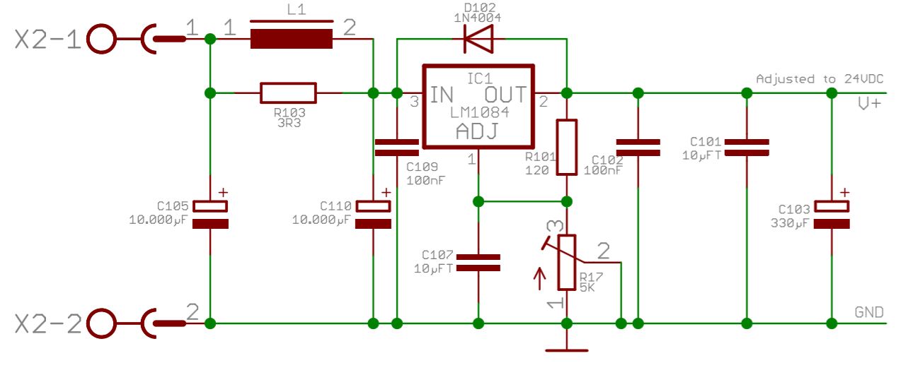

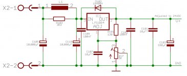

Gentlemen, find attached an image of the schematic of the PSU that I am using for my current ACA#1 - build.
Best regards - Rudi_Ratlos
Good point about the Cathode follower being DC coupled to the input of the IRFP240. I'm used to AC coupled tube gain & follower stages. I don't have any transformers on hand for that low a B+ (90V).
My sim shows 140-150V DC as highest practical limit and each triode draws ~6.7-7ma. For testing, a couple of back to back 500mA 12V transformers (from wallwarts) will give you ~80-100V AC. Add > 200V silicon diode bridge, a tube rectifier, a couple of capacitors and a small dropping resistor to get 90-100V DC. The 12V AC also doubles as heater supply. Just my 2 cents. 🙂
Rudi's Regulator
Hello Rudi and Fellas.
Your showed Regulator is interesting me.
Not fully clear is the position of L1 in schematic?
Should it be placed between 3,3 ohm resistors or one option: C-R-C, C-L-C
filtering?
I have some Hmd. 10mH 5A for use in MoFo, so i could use/build your regulator
to use there or build a premium ACA. 😉
