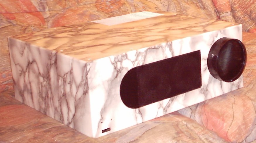

heya ace,
got mine finished too some time ago...
http://www.diyaudio.com/forums/showthread.php?s=&threadid=54000
cheers
slize

Heya Slize, ya i saw that, i was actually going to comment on it a while back but got side tracked and forgot along the lines. Nice work buddy, nice design, keep up the good work
Trev
