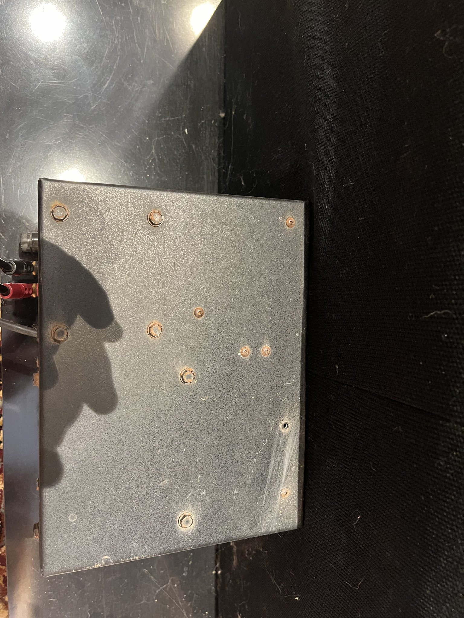

Thanks for your reply. Sorry it took me a while to respond but here is a picture. I got one of the three remaining screws out. If these are similar to my old 1+1s anyway it’s only the screws around the perimeter holding the transformer chassis in place.Please share a photo showing the overall interface chassis, and of the screws you are trying to remove. Several different chassis styles exist for the Model 3s, so I want to make sure I understand what you have.
That appears to be an MK-121 B or C enclosure, and you do NOT want to remove any of the screws on the top of the enclosure. Those are for attachment of internal parts.
You want to remove the screws on the sides of the chassis. This will allow removal of the L-shaped interface chassis. There are large screws inside the side plates (visible after removing the interface chassis) that attach the panel array to the side plates, and also the side plates to the base (the base-attachment screws generally do not need to be removed).
If you are having difficulty removing the screws, I suggest a small drop of your favorite penetrating oil (WD40 or similar) on the screw, and then it soak a while. A loss of volume is typically caused by a defective bias supply: rebuilding the bias supply is covered elsewhere in thus thread. Parts are cheap and generally readily available.

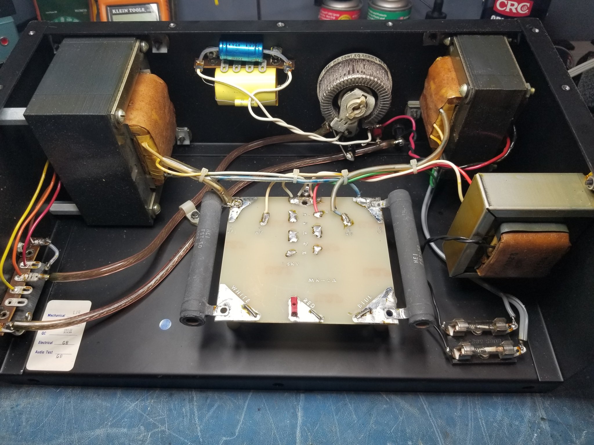

I picked up as set of acoustat model 3 today. The guy I bought them from said he hooked them up and they were no louder then a set of headphones (he found them at a goodwill). So I brought them home and wired em up to my audio research d-110b. They actually do work but you can tell they are not right and one is much louder then the other. I could clearly see they were taxing my amp (by looking at the meters) to get not much volume out of them. I pulled the im interfaces off and measured voltage. One has about 600v and the other about 1200v. So I figured a rebuild is due on the HV supply. These dont look like they were ever even opened imo. After doing some research there seems to be a lot of variables to these interfaces. It appears I dont have the medallion xformers or the "c mod" I'm reading about. Basically I want to get these functional without going crazy to make sure the panels are good. I'm pretty sure I know the ceramic caps and diodes I need but looking at the schematic I cant seem to find the value of the two bigger caps. It looks like they are .01uf on the schematic (I might not be looking at the right one) but these would be big for that value. I dont completely yet understand fully how these interfaces work so maybe they are that big because there high voltage. I will post some pictures, if anyone has any advice or recommendations I would really appreciate it.
I'm thinking the caps and diodes at a minimum. When I tested the interfaces they were on my bench and not wired to the panels at all. I would agree it's just the diodes but il definitely recap while there. Ceramic caps are cheap and there is only one electrolytic in there. The big ones I'm guessing are film caps but I'm really not sure. There is no markings or anything on them wich is pretty strange to me.
It does sound like both the bias supplies are putting out a low voltage. This is most commonly solved by replacing the (5) ceramic disc capacitors and (5) HV diodes in the voltage multiplier. Below are suggested replacements. There is no sonic advantage is replacing the ceramic caps with something "better". The ceramics are designed for the task, and anything "better" would not fit the board. Be careful in using the speakers with a malfunctioning bias supply - it's very easy to overdrive/damage them in this state.I picked up as set of acoustat model 3 today. The guy I bought them from said he hooked them up and they were no louder then a set of headphones (he found them at a goodwill). So I brought them home and wired em up to my audio research d-110b. They actually do work but you can tell they are not right and one is much louder then the other. I could clearly see they were taxing my amp (by looking at the meters) to get not much volume out of them. I pulled the im interfaces off and measured voltage. One has about 600v and the other about 1200v. So I figured a rebuild is due on the HV supply. These dont look like they were ever even opened imo. After doing some research there seems to be a lot of variables to these interfaces. It appears I dont have the medallion xformers or the "c mod" I'm reading about. Basically I want to get these functional without going crazy to make sure the panels are good. I'm pretty sure I know the ceramic caps and diodes I need but looking at the schematic I cant seem to find the value of the two bigger caps. It looks like they are .01uf on the schematic (I might not be looking at the right one) but these would be big for that value. I dont completely yet understand fully how these interfaces work so maybe they are that big because there high voltage. I will post some pictures, if anyone has any advice or recommendations I would really appreciate it.
Vishay 564R30TSD33 capacitor, 3300 pF, 3000 volts
Mouser p/n 75-564R30TSD33
GP02-40-E3/54 Vishay Semiconductors | Mouser (http://www.mouser.com/ProductDetail...=sGAEpiMZZMtbRapU8LlZD0HbIjlpuZ44XerUncvtHjs=)
As for the two large tubular .01 uF capacitors on the board, those are special high-voltage types, which explains their large size. These rarely fail, and replacements are hard to find due to their 6kV rating. The originals were custom-made for Acoustat, which is why they are unmarked. I'd say leave them alone unless you have determined one or more are defective. If defective and you can find replacements, replace all four.
The 500M-ohm resistor is not wirewound, but a special high-voltage type. These also rarely fail, and replacements are hard to find. It is rated at 2-5 watts with 5-10 kV voltage rating. I'd say leave them alone unless you have determined one or more are defective.
Once you get the speakers working properly, I would recommend the "C-Mod", which is easy and cheap to do, and parts are readily available. Medallion transformers are no longer available, and even if you could find the (2) LF transformers and (2) HF transformers, their price would likely be beyond what you are willing to invest (probably more than you paid for the pair of speakers). Good luck!

Gotchya. I'm not running the speakers at all. I just had to figure out if they worked or not before disassembly. I also plan to do the c-mod and I figured out what it entails so no help needed there. I do have one question before I order parts. How long do those 4kv rectifier diodes live in these hv supplies seeing as there is more then 4kv going through at least the last one? I understand how the caps take it as none are really seeing the full voltage.
If you look at the voltage traces at the circuit nodes, you can see that each diode in a Cockcroft–Walton voltage multiplier must withstand 2x the peak input voltage.
In the case of the Acoustat HV supplies, this is about 2kV, so about half of the 4kV rating.
None of the diodes experience the full output voltage across their terminals.
