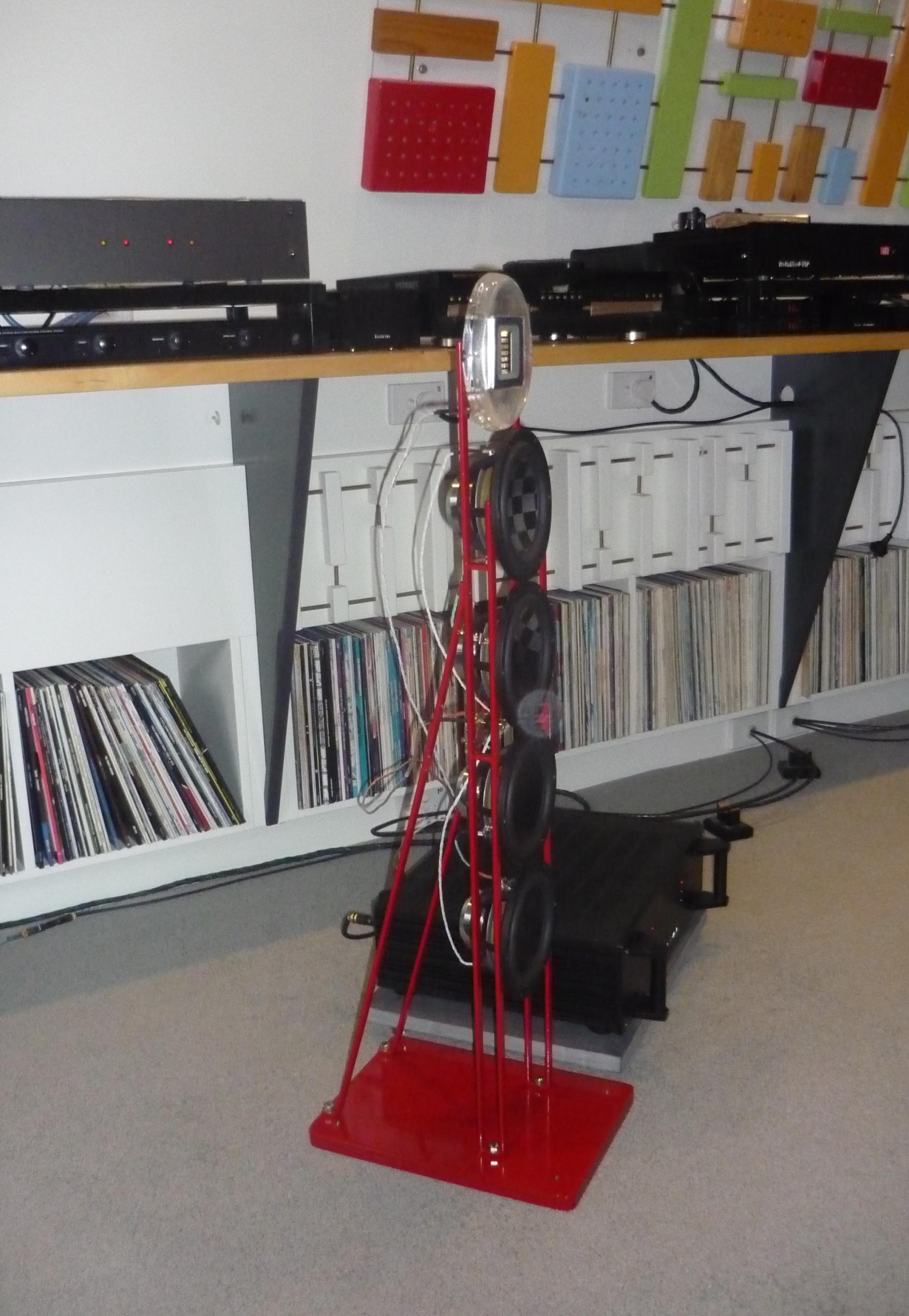

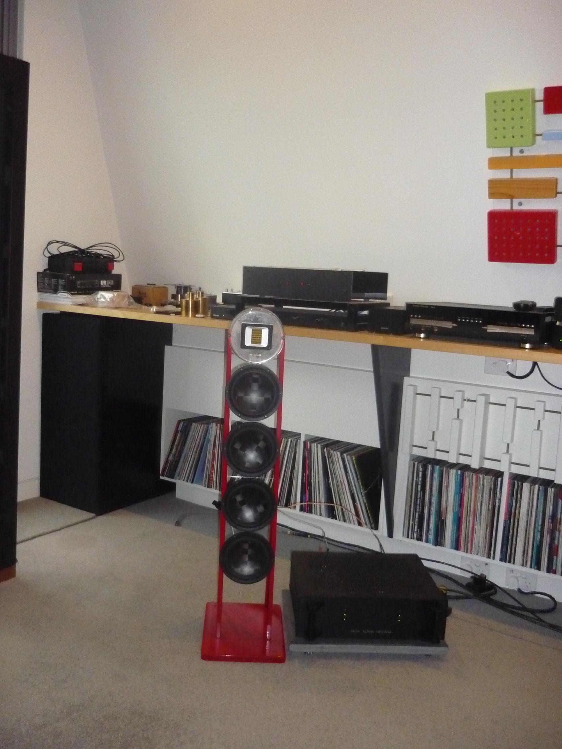

For grins I connected my 5ohm PTT6.5 and RS28F TL’s to my 8ohm Alpha Nirvana today. Not expecting it to work well, but surprised that it sounds glorious. Not a problem at all driving this load:

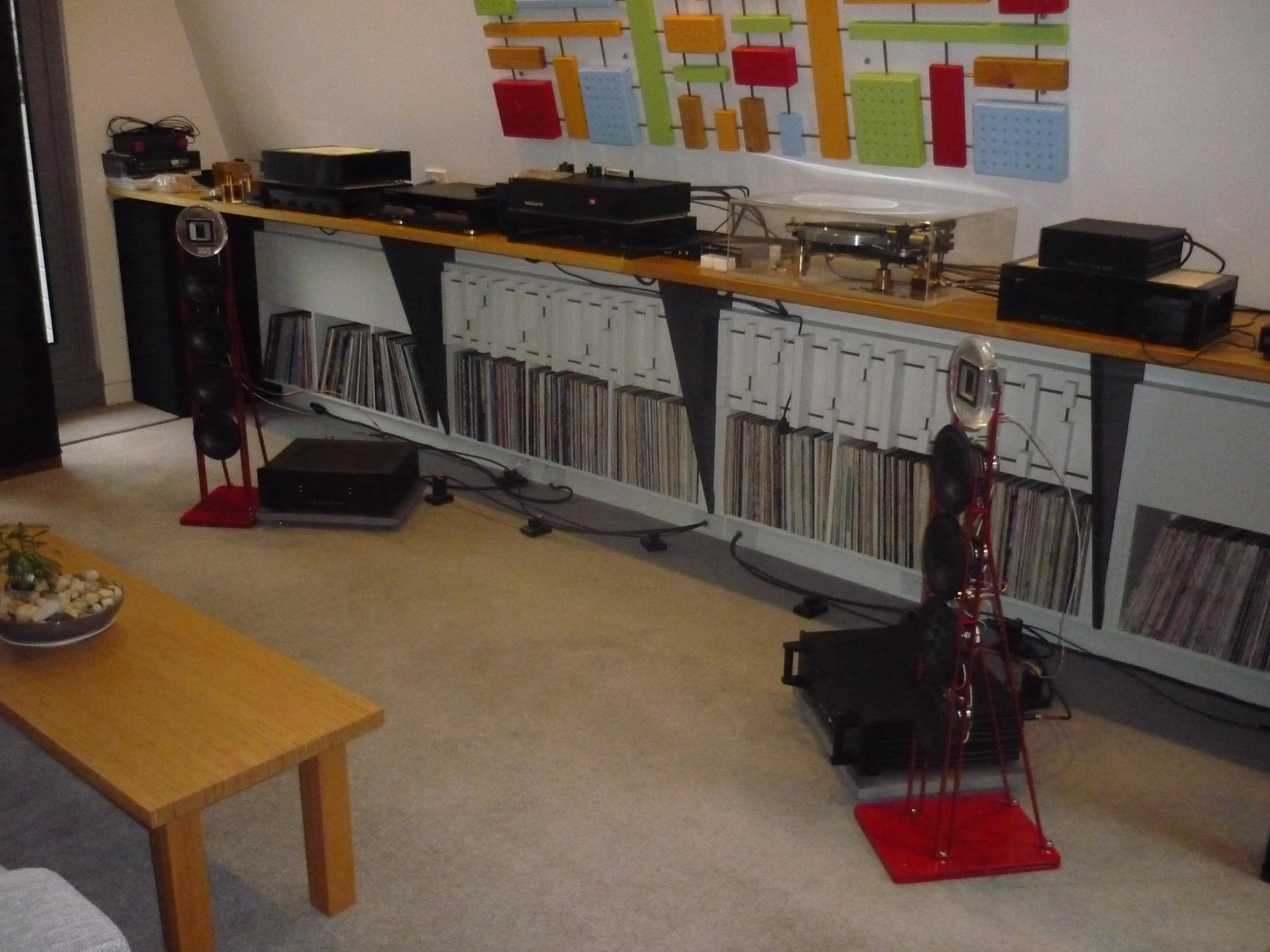

As you posted yours, X ... I thought I would post my new spkrs (which have replaced my true-ribbon Maggies) being driven excellently by my 2x stereo AN 4Rs. (Don't think I posted them, previously.)
They use (each side):
* an SB Acoustics 'Satori' ribbon tweeter (AT60NC-4), and
* 4x SB Acoustics 6 1/2" Satori mid/bass drivers (MW16TX-4).
They are 2-way active and hand over to a pair of 15" sealed subs at 160Hz. A nanoDIGI 8x8 provides the XOs and EQ needed for the lack of baffles.
Don't know what the impedance graphs are but the drivers are nominally 4 ohm - with 'Re' specified as:
* AT60NC-4 : 3.9 ohms
* MW16TX-4 : 3.4 ohms.
Have never been able to get the red 'clip LEDs' to come on - even on transients, playing louder than I normally listen at!
And the room looks so much bigger, without the 'room dividers'!
Andy
Baffle less speakers!
A new class of spkr, X - "zero baffle"!
(My inspiration was the Aussie Kyron "Gaias" ... they're A$250K! But they don't need subs. )
Nice setup Andy! Are the AN’s in the black boxes next to the speakers?
Thanks - yes, the AN 4Rs are the black boxes next to the speakers.
Andy

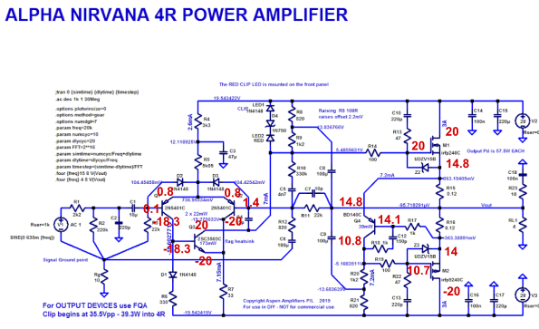

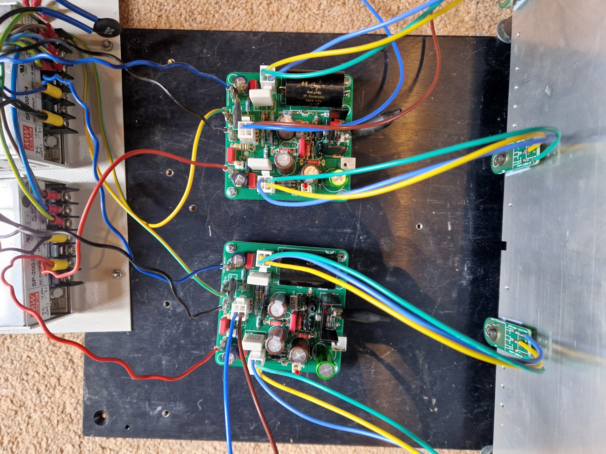

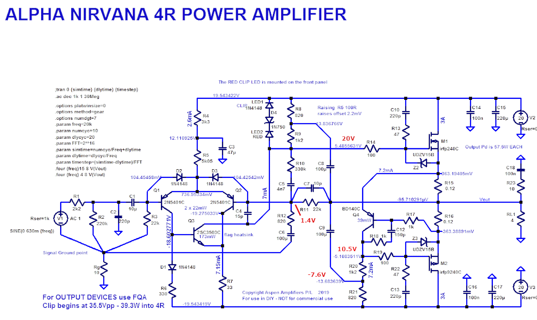

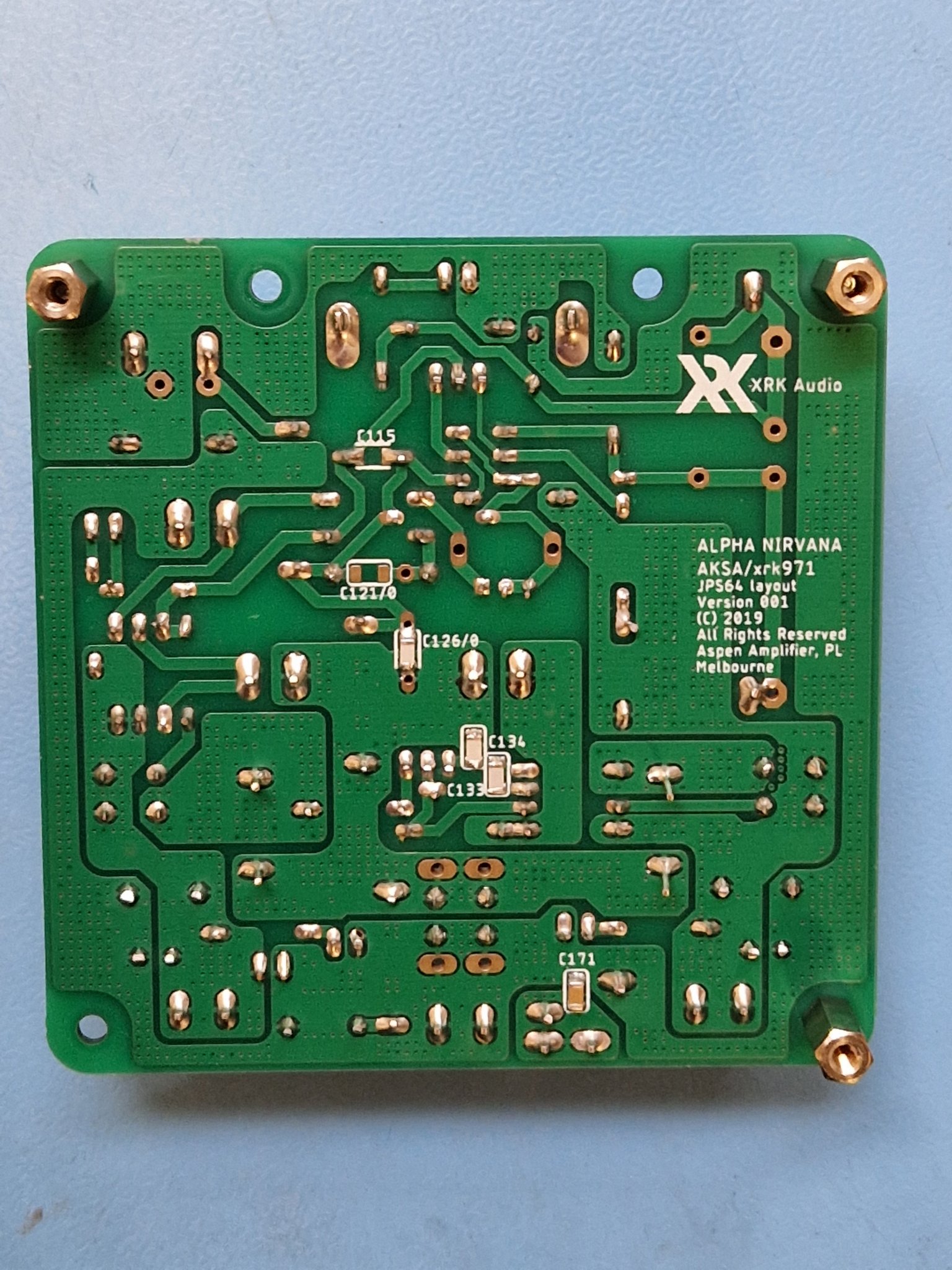

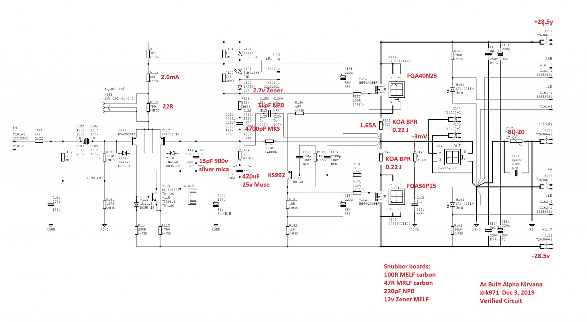

Sooo.... not the champagne moment I was hoping for last night. I have one board working in my test set up and the other not. The gate on the N channel is at the voltage rail of 20V, the gate of the P channel is at 10.5V and the dummy speaker load gets nice and warm! I haven't taken many measurements yet but what I have I've attached. I'm an assembler not an engineer so I'd really appreciate a little help. I built both 4R boards in parallel, with 0.22R bias resistors until I get heatsinking sorted.
I checked each resistor going in and also again before I started stuffing the rest of the components ( from known sources). I've checked both boards are the same and inspected for shorts and dry joints under a magnifier. I can swap the FET boards of the bad channel onto the good and the good still works so I know it's not the big FETs.
So my question is, is it safe and valid to troubleshoot the board with the FET boards disconnected? It would make it easier for me to do so.
You need the output MOSFETs there to get the true system DC setpoints. You don’t need to connect a speaker load. Without the outputs, you can check the input stage and VAS. Just measure the output DC offset - looks like there is a major imbalance that’s either caused by a cold solder joint in the CCS (bottom circuitry on the P channel) or the VAS stage driving the gate in the N channel. The gate voltages are way off.
Please take notes on the DC voltages relative to GND at all active pins of all devices and annotate in red like you have done. We can debug and pinpoint the exact cause with this info. It sounds like it’s not melting the MOSFETs so you can take data. Be careful with probe tips not to short stuff. You can destroy parts very easily this way if not careful. Hugh said it’s like backing a car into a tight garage. Do it carefully and deliberately or you scrape the sides of your car.
Since you stuffed both boards in parallel and checked your resistor values before hand - it can only be a solder bridge or a cold solder joint - or a bad or reversed electrolytic cap. Check the 220uF bootstrap caps for reverse polarity or conductivity.
R113 should be 22R, you have a 200R pot there - did you set the pot to 22R? I know this is the 8ohm version.

Thank you for taking the time to help. I checked the + & - rail to ground resistances, they settle about 400R on both boards. Can't see any low resistances on the other caps swapping the probes on my meter around. I have set the pots to exactly 22R...now... ahem! I really can't see any shorts or dry joints, wonder if I have a bad transistor? Annotated voltages on all transistors/FETs:
Thanks again!
You were spot on Hugh, I had put the damn thing in the wrong way round. How embarrassing! Many thanks to you and X. Music is happening, I'm off to eat humble pie for lunch....Check Q3. You may have the wrong transistor, or the 2SC3503 is bad.
