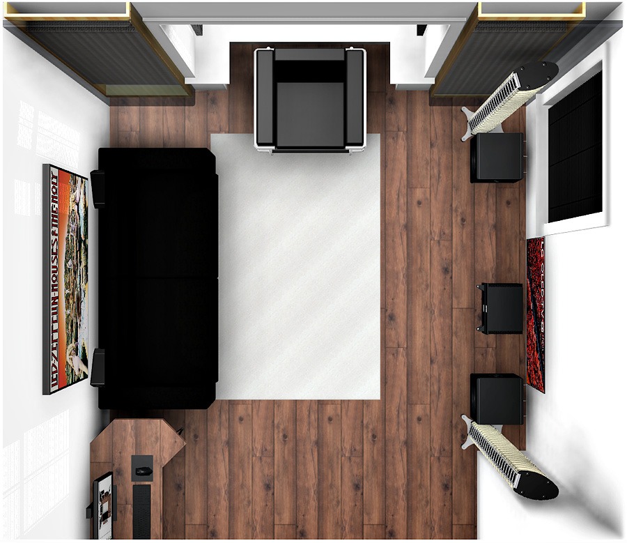

In the next few months I expect to start the build of a corner vertical array pair of speakers.
This will be used in a fairly small lounge living room with multiple sources, digital and analogue.

  • To put them right in the corners, out the way. I took the pic attached when moving the furniture around just to show where they would go, right in the corners outside where the current speakers are standing at the time of the picture. I should explain that the current speakers are not normally diverging and the polystyrene sheet next to the TV is just old packaging! – the sound bar etc would go. The room is very asymmetric, the left “corner” of the listening area being created by a pillar that holds the structure for upstairs. I don’t know what happens with the structural beam running across, in terms of reflections.

Wesayso is gonna be your guiding light here and I suspect you’ll hear from him soon……he’s very helpful.
My issue with your intended install will be the power response mismatch with the left side being much more open in presentation and the right side having a perpendicular boundary……arrays have very wide horizontal dispersion....I can’t see a physical way of effectively balancing the very different wavefronts…..the wall to the right is going to reflect a lot of energy back into the soundfield. I’d ask those questions first……this seems like a classic ‘should I’ questions instead of ‘could I’.
Interesting Mayhem, and thanks, i am certain that you are correct there will be a mismatch, and the right hand side will differ also when the blind over the window is open or shut, however, as there will be EQ anyway, one assumes something useful can be done with that to help a bit?
But surely this is the case with most home systems, perfect symmetry etc isn't available and this will be reasonably adaptable as it requires capable EQ anyway?

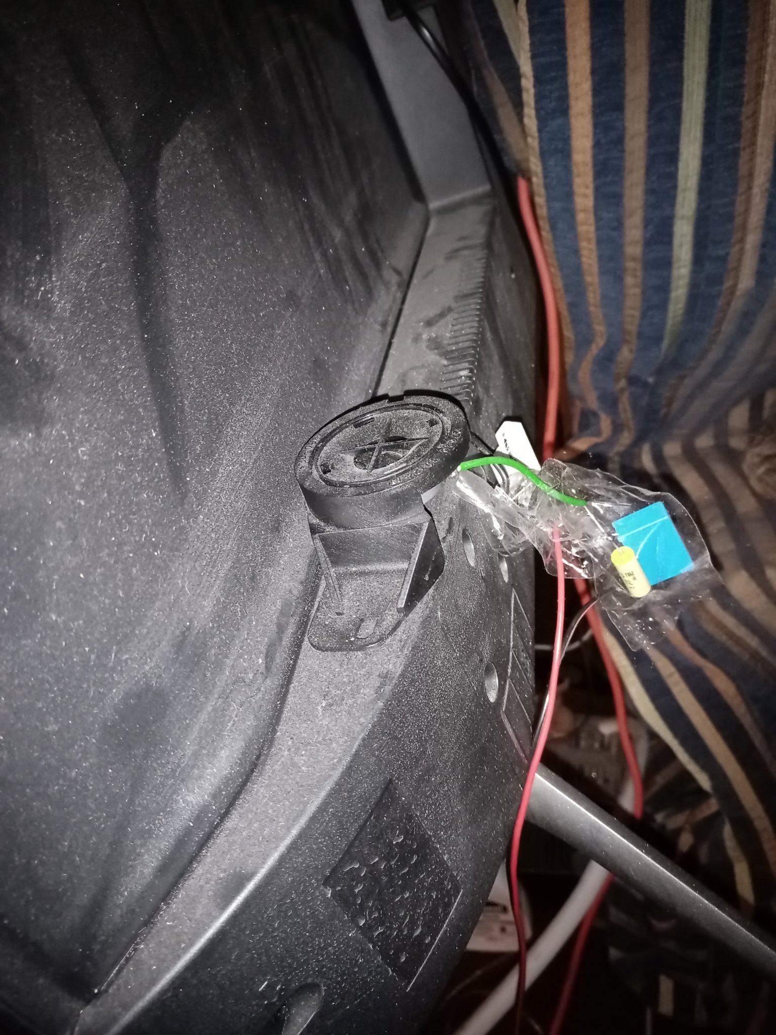

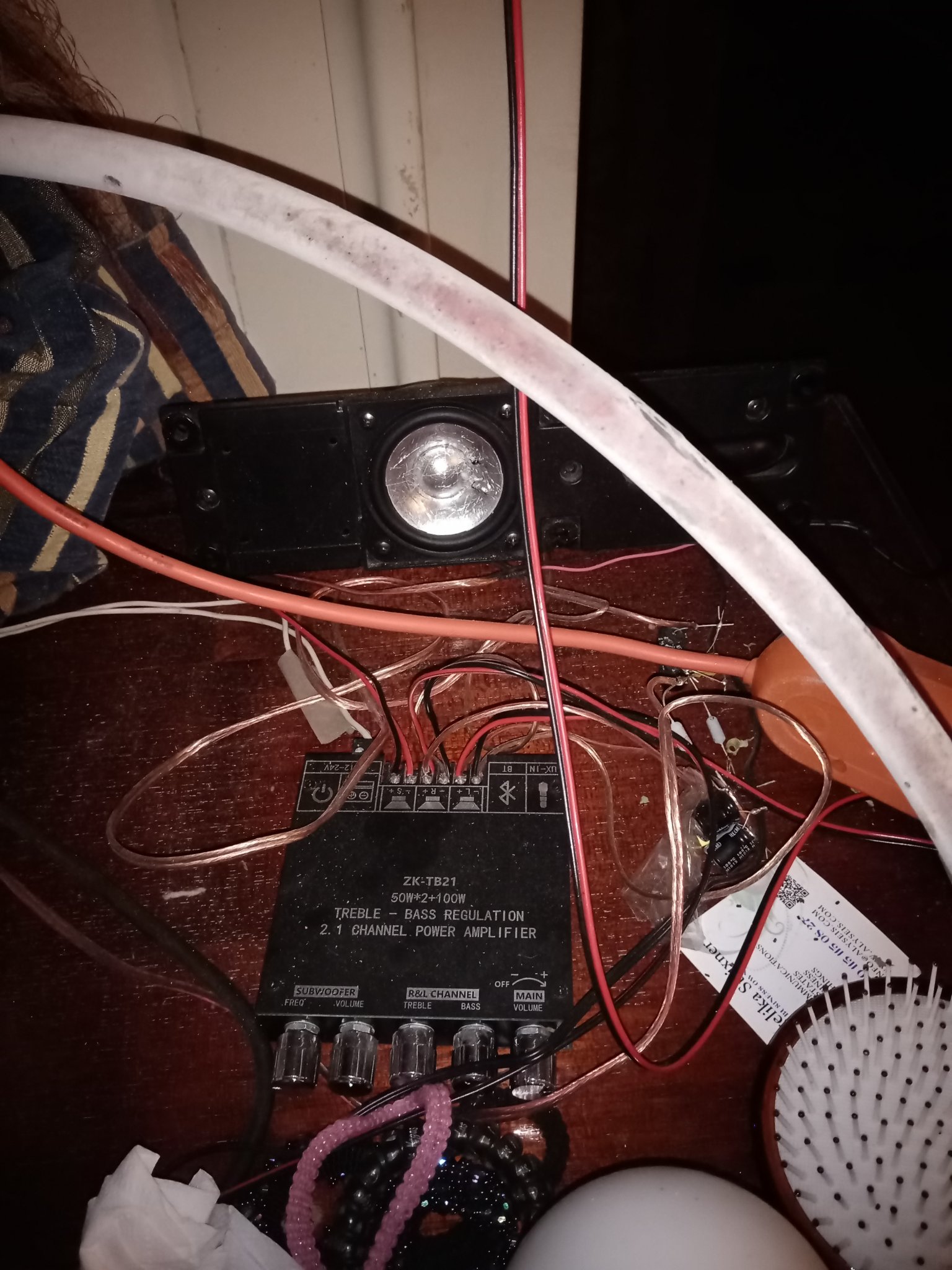

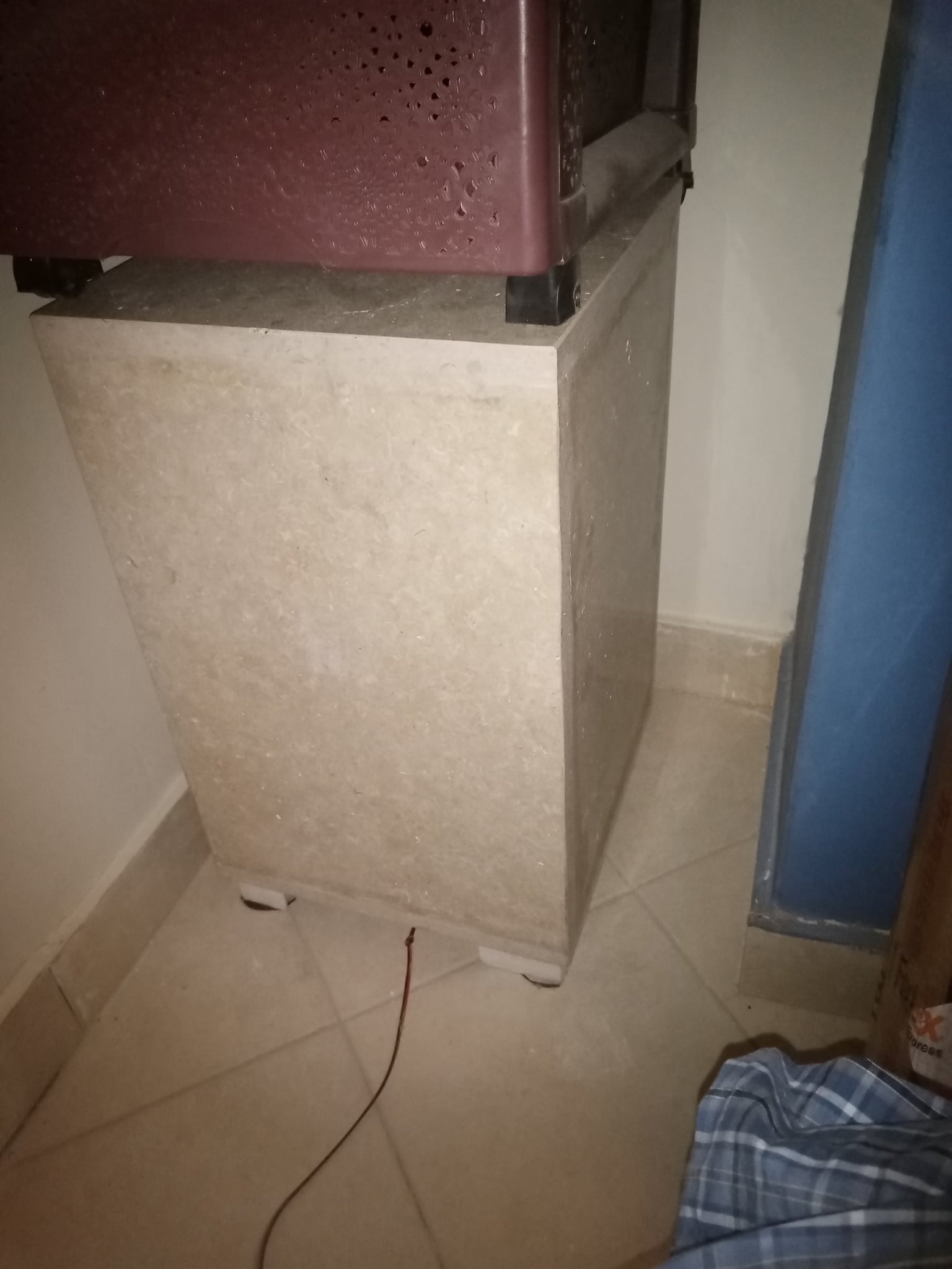

I can tell I have a very good result with a stereo pair 8cm fullranges (closed box with stuffed/ damped reflex port) close to back wall and crossed over with just 340uF to a marble subwoofer active 12db.
Could merry a subwoofer to the small FRs without sonic faults with the help of a 2.1 amplifier offering 12db slope and loudness adjustment of the 20cm single woofer in corner placement.
https://www.diyaudio.com/community/...-concrete-loudspeaker-box.406856/post-7547864
Behind the TV a hidden stereo pair of small audax like tweeters, with 6db 1.5uF, 12 ohm impedance. Facing to the ceiling for indirect sound field in the highs. These tweeters were made for the use with only one capacitor.
Try inverting the tweeters and listening to it, showed improvement with right polarity.

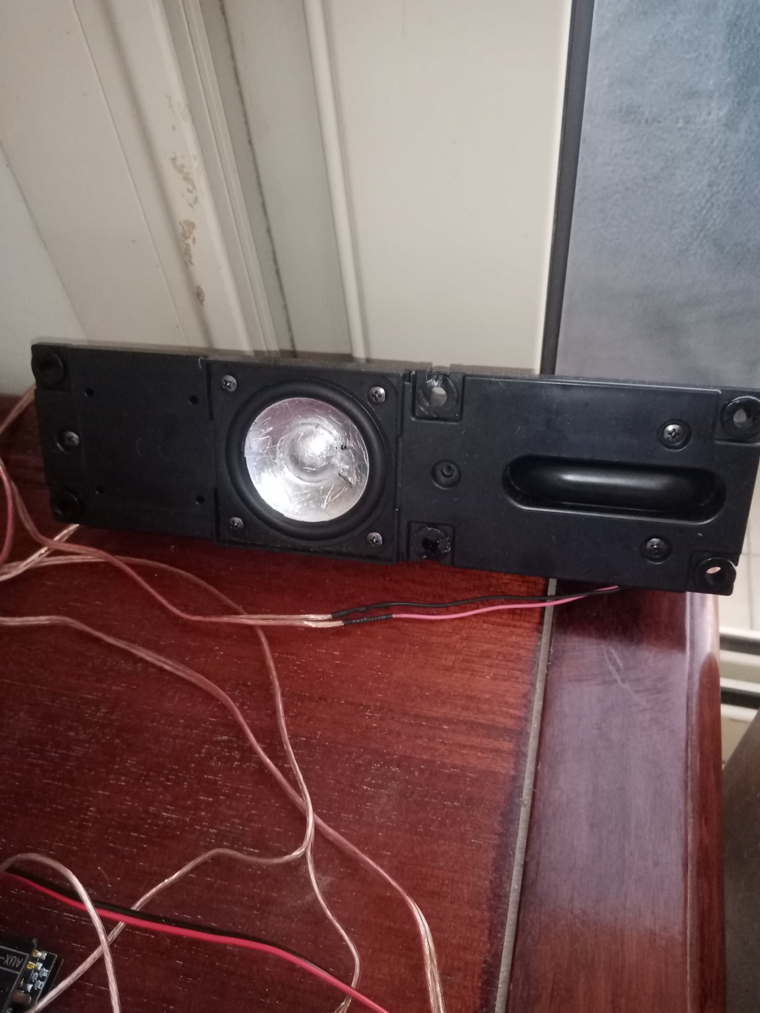

These little JVC fullrange are linear from 70hz to 18khz. They were designed as a drop in speaker for TVs which once had more depth than the modern TVs now.
Have put aluminium foil to the paper cone fullrange diy sandwich.
What I want to say: you can try first a single FR before making an array and in your room and because of asymmetry in your room - omit the corner.

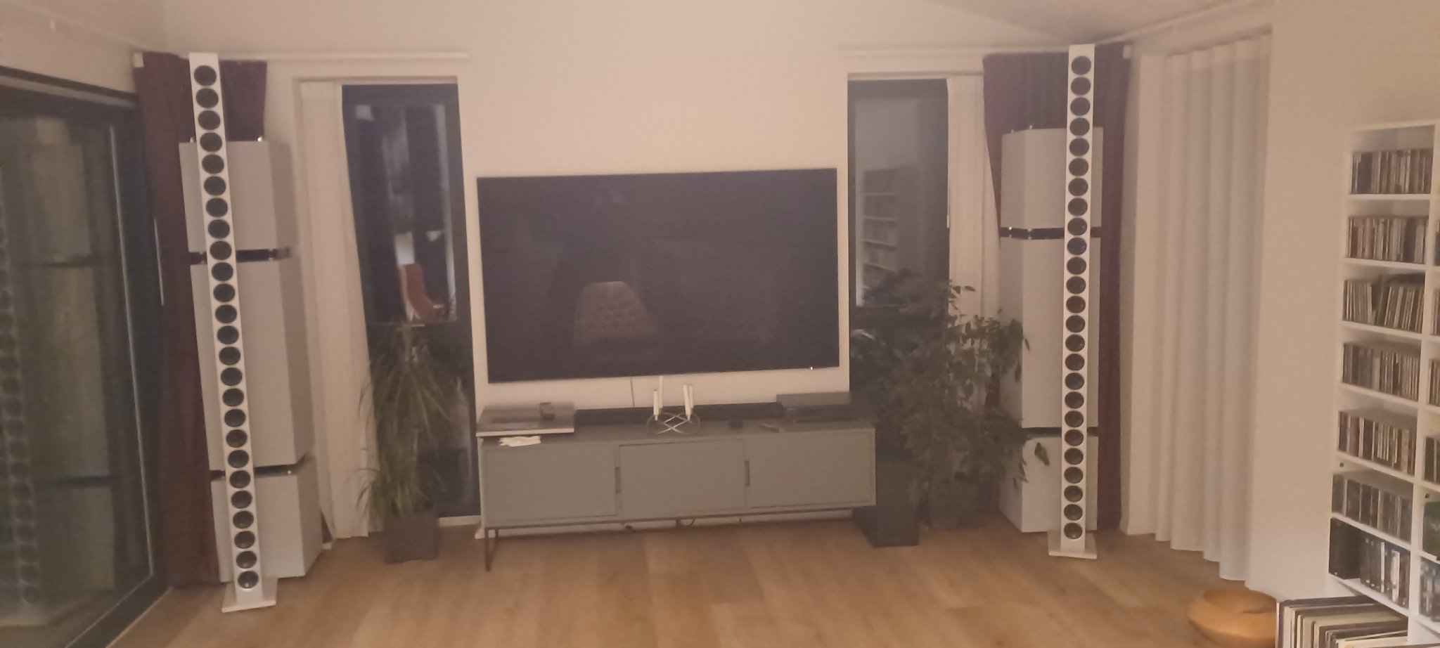

Listened some time to an array with four of the JVCs I mentioned per side.
Had no problem with combing.
Already four 8cm FRs per side are quite impressing. Clearly giving you a sound like being in the near field although I was sitting in touch with the back wall (3meters away from speakers)

Hi Mike, I guess you've seen my 400+ page thread (lol). Working on a synopsis here. No need to be as fanatic or crazy as me to get to a point of being able to enjoy arrays. Many have done it with way simpler solutions or means.
There are a couple of things to understand though. As mayhem13 said, arrays with the TC9 driver have a pretty wide horizontal dispersion.
If I were in your shoes, I wouldn't completely cram the speakers in the corners. I'd build them free-standing and get an absorbing panel on that right side beside the array.
(Free standing speakers have the advantage that you can play with toe in (believe me it's worth it) and have a little play with distances to walls. Look for 2 about liters per driver for the TC9 if you want to extend it (pretty) low)
The panel (filled with something like that itchy fluffy kind fiberglass isolation or a more modern variant) should help to be able to get somewhat similar sound from both sides, which is what Stereo is relying on. I have such a sub optimal placement too and do use a large panel next to my left array.
I have two more panels, one behind my couch and the other beside the couch on the left side. You could do without those 2 and still get acceptable or even good sound.
But to have a shot at good sound, that right side really does need some help.
