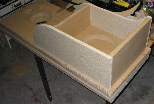

My new dipole project:
40 x 100 cm baffle of 44 mm MDF.
Scanspeak 8545 and 9700 plus MGR 12" woofer.

I will report the progress and post a picture now and then.
Tomorrow I´m going to bring the baffles to my brothers work and get the holes for the drivers done properly with a CNC machine.
I found the best way to mount the drivers on an open baffle (taking advantage of the fact that you are not having to work with a closed box) is to mount them from the rear.
This means that you can hide the fixing holes and in fact do away with the need for screws or bolts.

The big day is coming closer, I just painted the first layer on my baffles. Unfortunately, for various reasons I wasn´t able to use the CNC router to cut the holes for my drivers but I have other ideas up my sleeve to compensate for this.

Rear driver mounting: Wouldn't this affect dispersion and off axis response with all but the thinnest baffles?
Swept back wings vs flat baffles: Is there any advantage to flat baffles other than a shallow depth? I already ran into a big cavity resonance, but that was quickly remedied with the skill saw taking 2" off of one wing. On my cardboard test baffles I like the sides folded back for a slight imaging improvement, plus it works wonders for stability.
