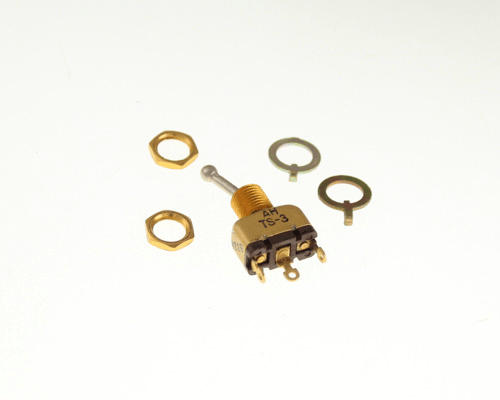

I had a closer look at the miniature switches.
It's an Arrow C TS3 made in england.
Don't know if its "on - on" or "on-off-on"??
Closest thing I've found is this.
https://www.tedss.com/2027002990
Looks like the U.S.A version.
Same external dimensions.
This version is "on-on".
This appears close but body is double width x length.

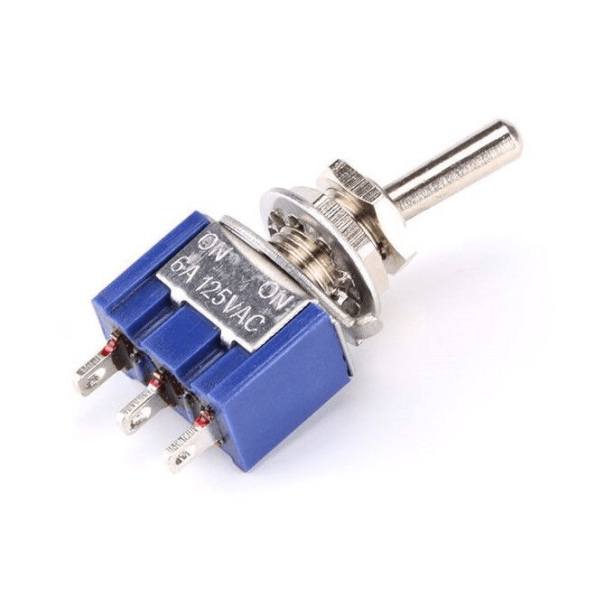

I'd avoid the "Arrow Hart" as it initially says "on-none-on" which could be interpreted as "on-off-on".
An "on-on" is a simple changeover switch. The "Blue Switch" is clearly an "on-on" latching switch so it's OK.
The clue is the ON ON stamped on the switch body.
You do NOT want an "on-off-on" switch for the following reason:
On-off-on toggle switches are variations of the on-on design. They add a third, neutral off position in the centre.
In on-off-on switches, the off position is the default resting position and both on positions will click back to this once released.

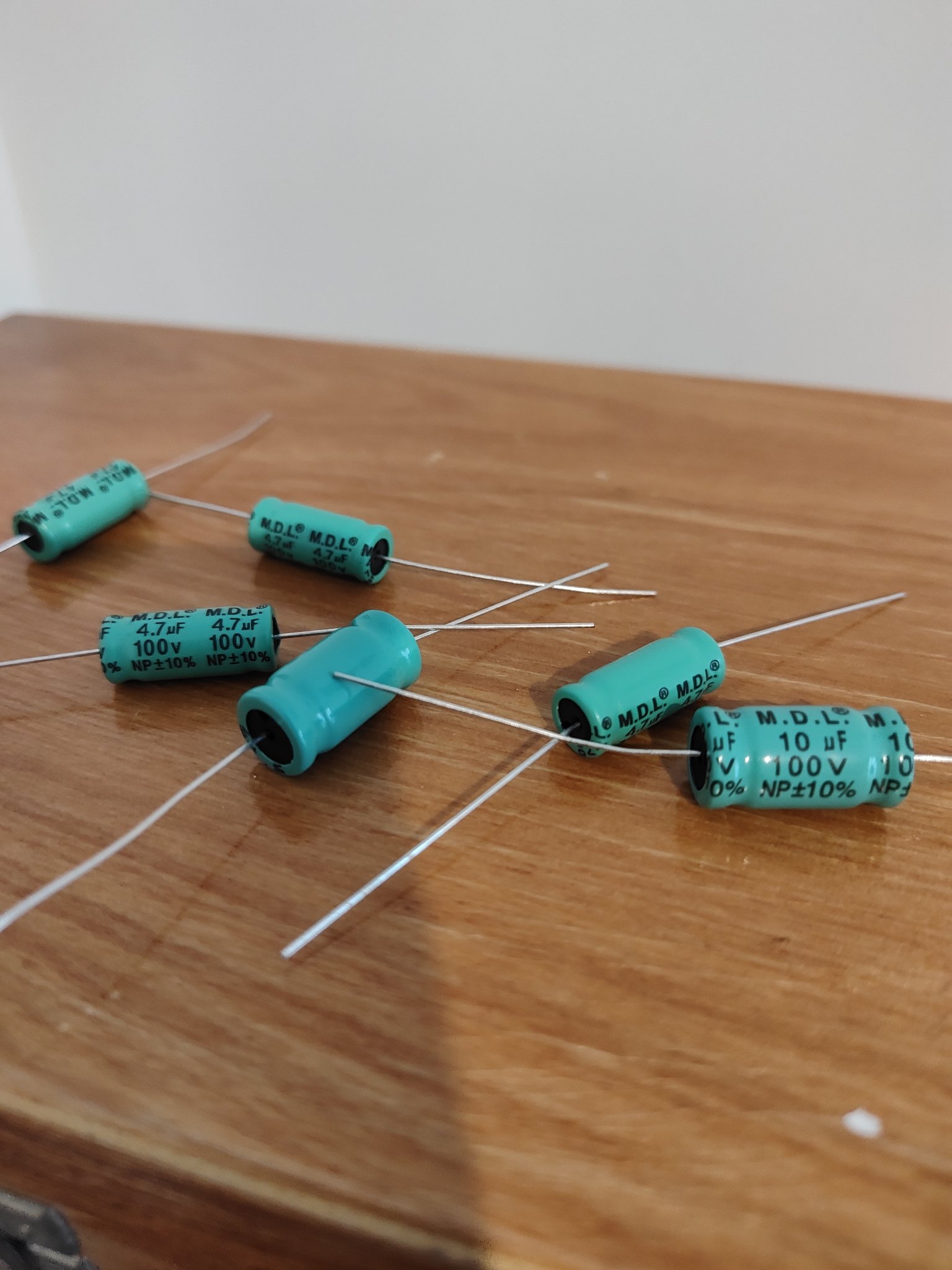

Also picked up the caps from Jaycar.
With 4.7µF buzzing around in my mind I selected these over the 5µF.
Will they do or should I wait and swap them when I visit Jaycar again?
You must be confused! Jaycar do not have 5 uF capacitors, just 4.7 uF ones.

All you have to do is replace the old capacitors on the circuit board with the new ones.
I don't expect you to be undertaking "continued testing", just getting the speakers up and running for the owner.
