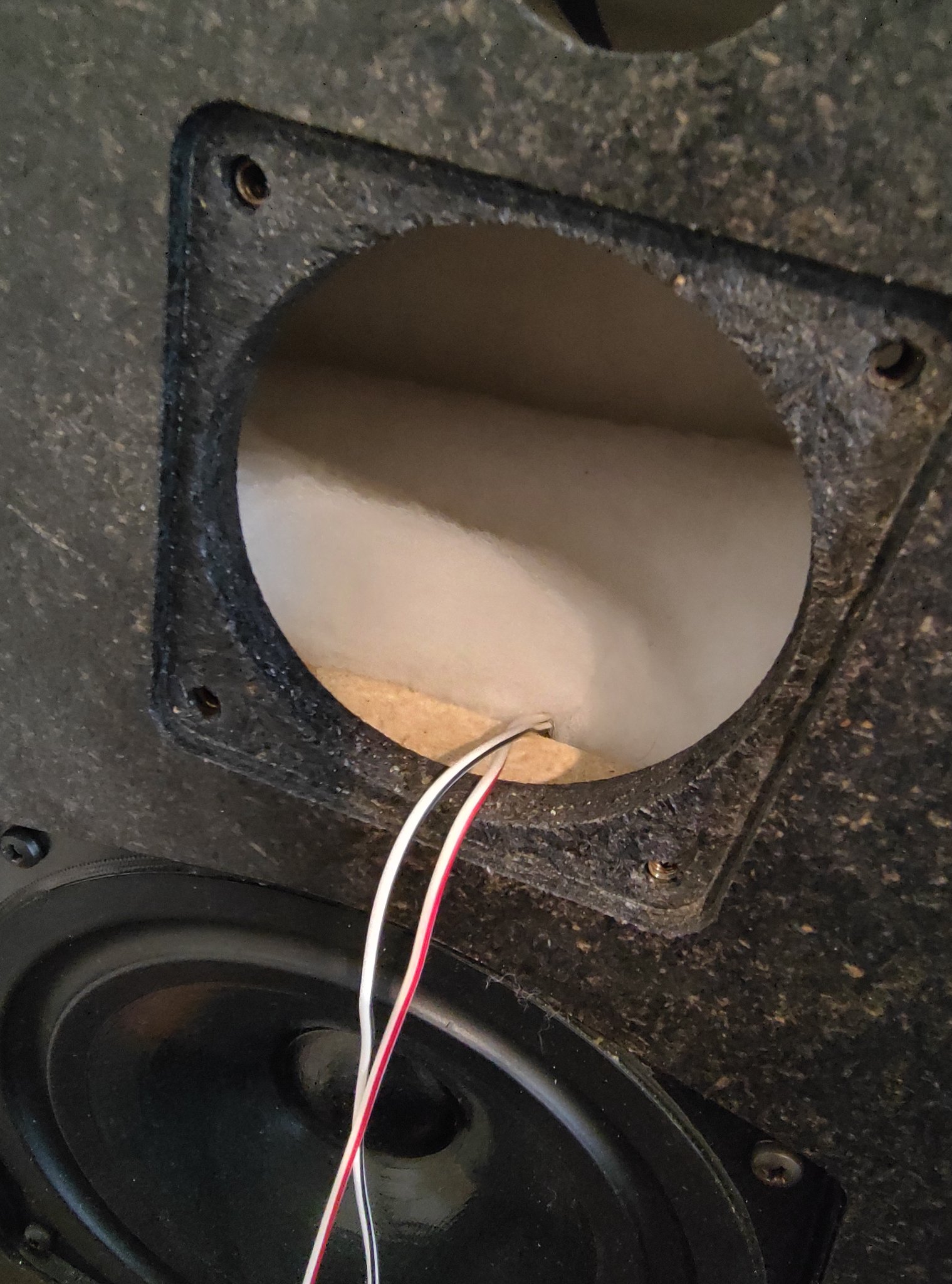

Cut out or hole is 85mm diam.
This meets Visacon SC 10N spec for cut out.
Recessed or routed section between faceplate edges and the cut out are 95mm diam, with 114mm diagonal diam.
104 diam circular tweeter will leave 5mm recessions visible at each corner.
Circular hole is 85mm diam.
Square recess is 95mm diam.
Visaton is 104mm diam.
I thought just screw over the top which leaves 5mm recessed baffle area visible at each corner.
I can fill that and repaint the baffles.

As long as the result is airtight. It may be more likely to be airtight if you follow my suggestion in post #80.

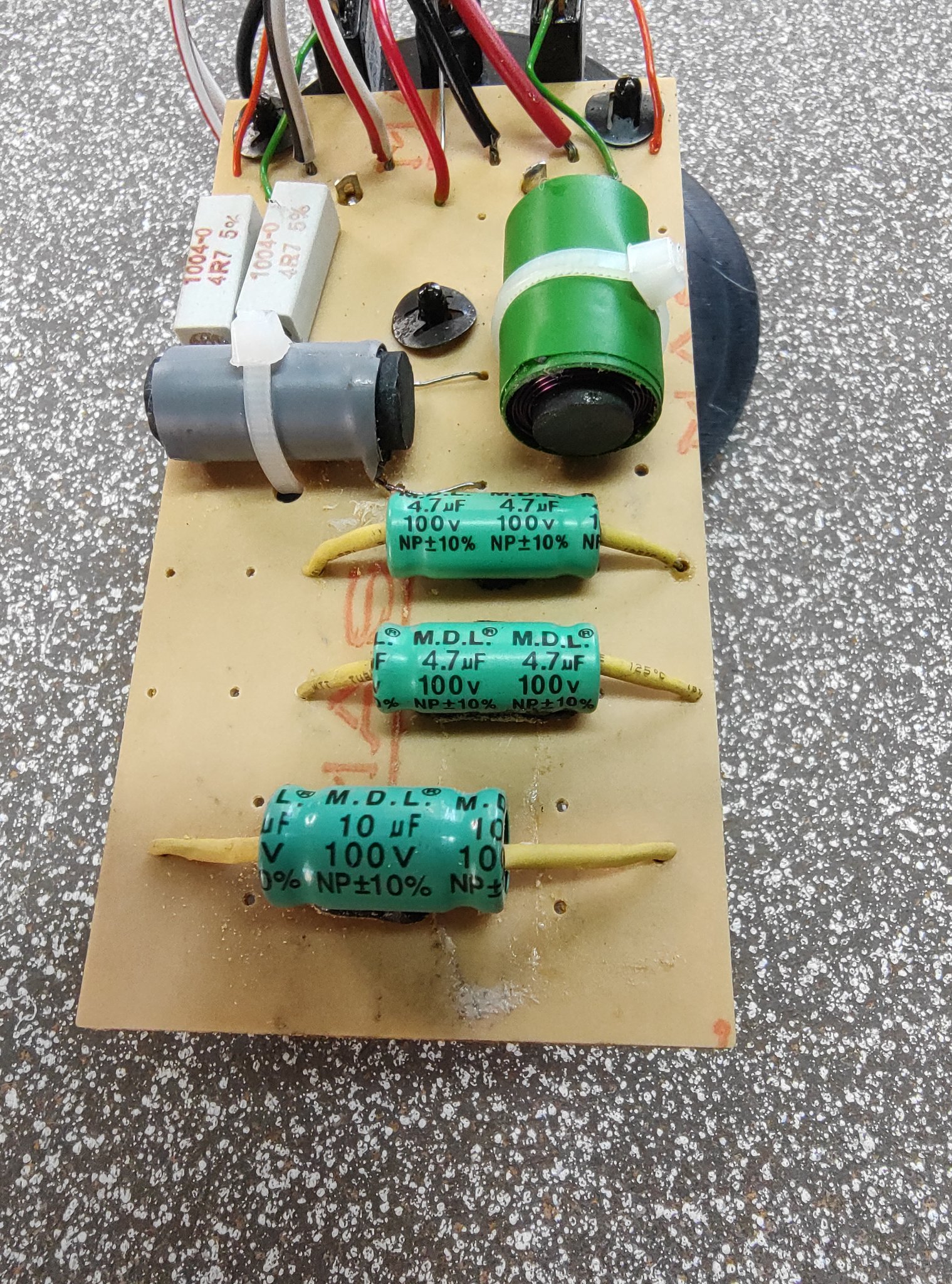

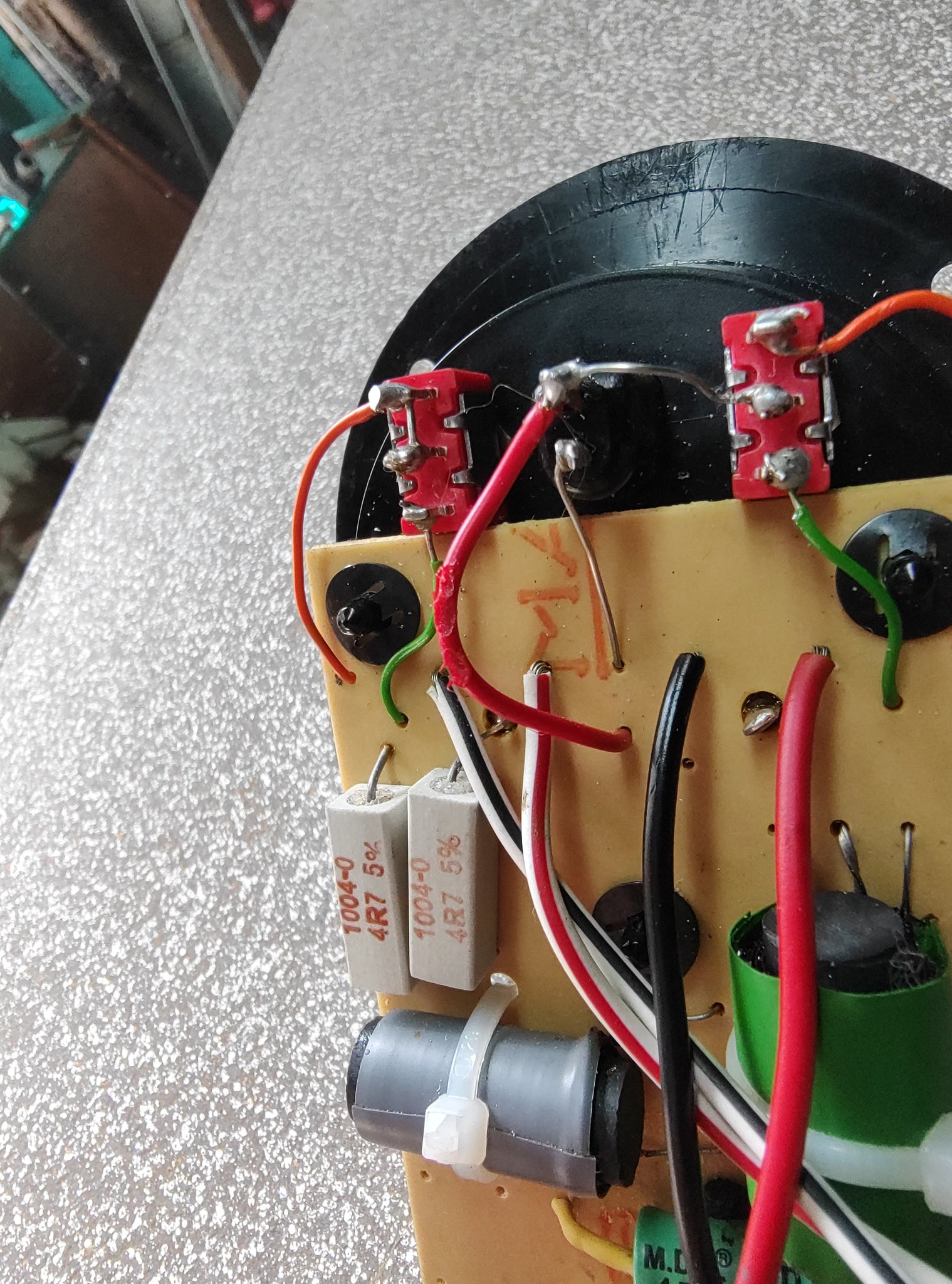

I was very careful about the wiring done.
Left switch had jumper from its centre terminal to the upper terminal (where red wire will also terminate).
Right switch had jumper from from its centre terminal to the termination located between the switches.
Orange and green wires to terminal one and terminal 3 on each switch (orange to top terminal, green to lowest terminal).
Orange and green wires terminating on left side of circuit board to left switch.
Orange and green wires terminating on right side of circuit board to right switch.
Using the six holes vacated by the old caps I fitted 10mfd cap into holes at bottom of circuit board.
2 x 4.7mfd caps into remaining pairs of holes above the 10mfd cap.
Caps are all non polar.
EDIT: The square recess can be made flush with the baffle surface using filler and the Visaton surface mounted.
I'm with you on this.
Quote: I'll fill all of the recessed area between the circular hole and the square edge.
(y)
