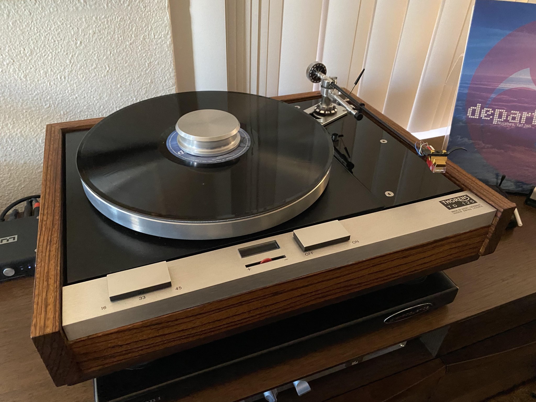

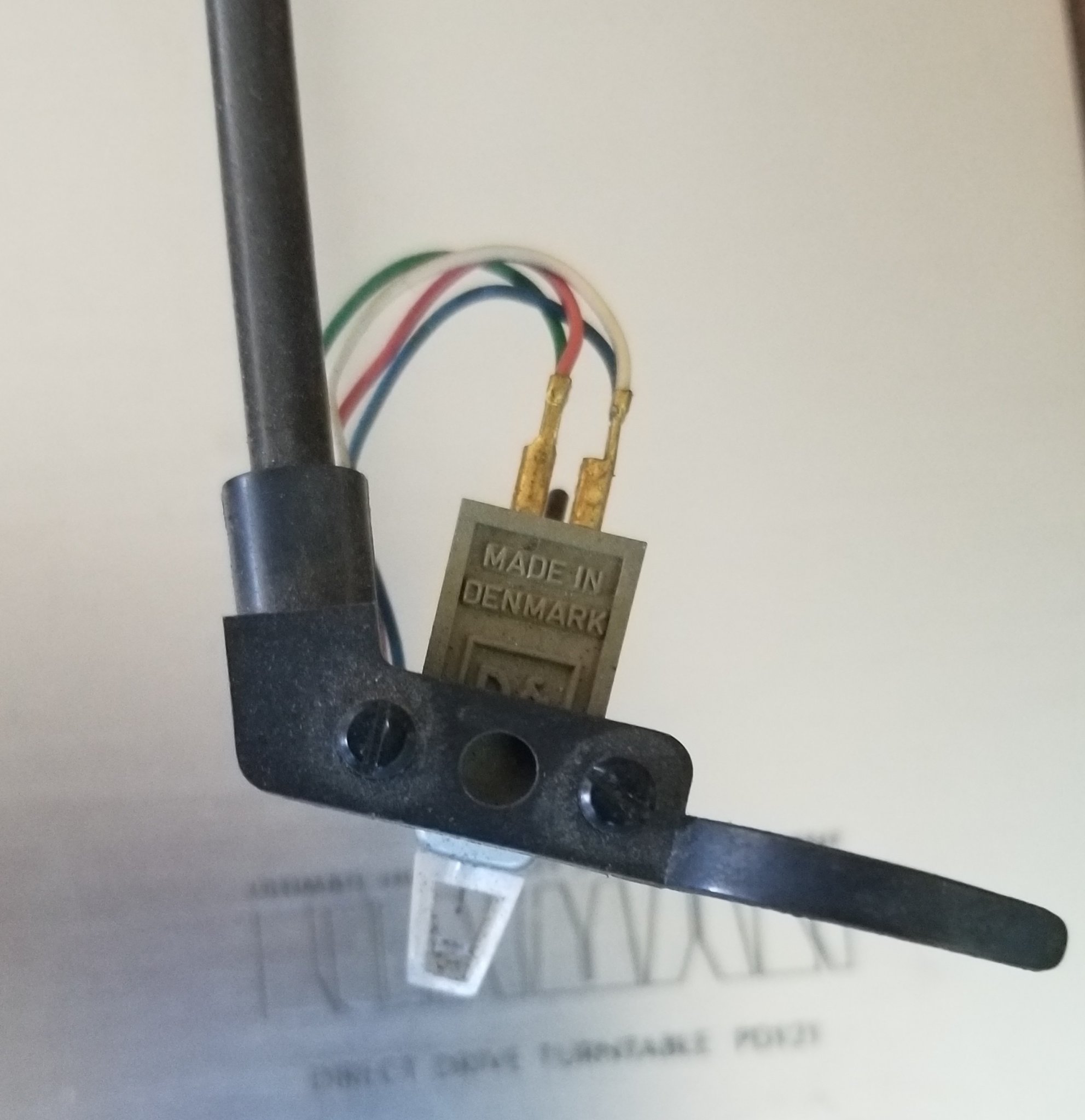

Greetings all,
I came to a possession of a turntable with the above-identified cartridge. When looking for the technology (MM or MC), it seems to be neither, is is described as a "moving magnetic cross" or a "moving iron cartridge" whatever does that mean.
The question is, what phono-preamplifier do I need? Any DIY recommendation?

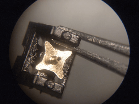

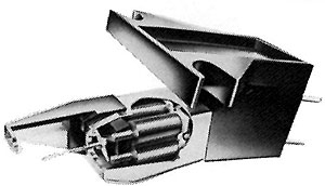

There's a description of the moving micro cross design in this article: https://www.stereophile.com/phonocartridges/408sound/index.html
"Moving-iron designs ... use stationary coils and magnets and a small piece of "moving iron." In the original B&O design, what moves is a cross-shaped piece of ultra-low-mass, high-purity iron attached to a soft elastomer damper stabilized in a plastic frame. The iron also incorporates a minuscule tube into which the cantilever is inserted. Each arm of the iron cross is associated with a fixed-coil/magnet structure and as the cantilever moves, it varies the distances between the four arms of the iron cross and the four fixed-coil/magnets, thus inducing tiny voltages within the coils. The advantages of this arrangement include ultra-low moving mass, even compared to an MC design; relatively high output (because the stationary magnet/coil structure can be made large); high suspension compliance; and low vertical tracking force (VTF)."
There's also an image of the moving micro cross:
And, this a cutaway of an MMC 3R:

No it is not B&O as per my reply to Galu. it does not seem to have connector, but four wires,connecting to the cartridge.If you have a B&O turntable, I would think, that you´re in for an impossible task.

@mefistofelez
Just to recap,
Treat it as a MM cartridge.
Assuming the diamond isn't worn out, that is a phenomenal cartridge and absolutely worth using. Particularly as you seem to have the proper arm for it. Would love to see a photo of the entire setup.
Just to recap,
