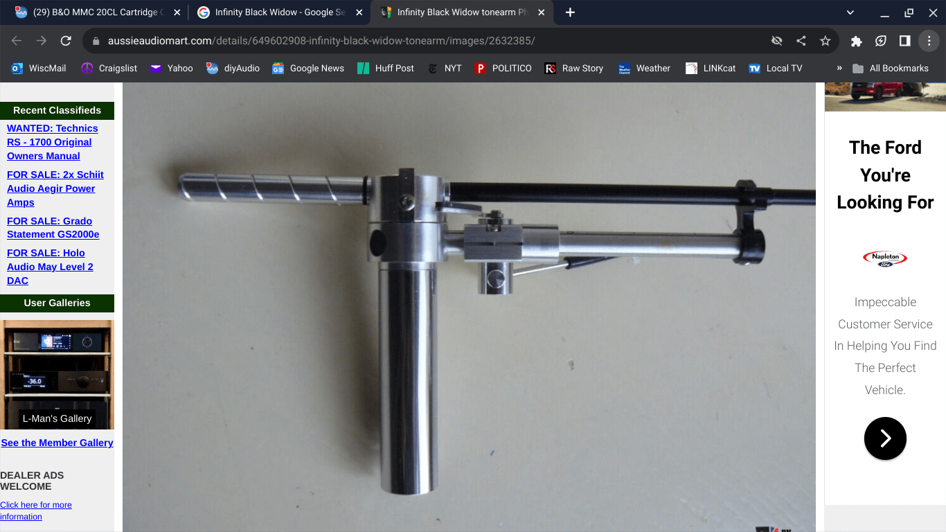

Was wanting to see the entire table, but that’s good enough.
Luxman PD121 with an Infinity Black Widow tonearm. Very nice indeed, somebody spent a pretty penny when that was new. Do your best to keep it in good shape and it will serve you well.
The Black Widow is considered a “ULM”, which mean Ultra Low Mass tonearm. (Somebody mentioned that earlier). It’s an excellent arm, no question. If you find yourself needing to replace the cartridge you need to get a cartridge that will work with it, as not all will. (Cartridges) You’ll need a “high compliance” cartridge, (meaning the cantilever suspension is squishier than average) and also preferable to have a lighter rather than heavier cartridge. Or you can call up SoundSmith and have that one rebuilt, which may be your best option. (Again, if needed.) But in the meantime, the B&O is a stellar cart for that arm and I suspect it’s going to all work out wonderfully.

Congrats with the turntable/arm.
As @6L6 so perfectly writes....... If you "must" use a B/O cartridge in other arms, Infinity Black Widow or
Audio Thechnica´s AT-1100 are excellent choices.
Just make sure, the arm is mounted correctly (pivot to spindle distance) and the cartridge is setup correctly (protractor).
Then you´re in for good sound.

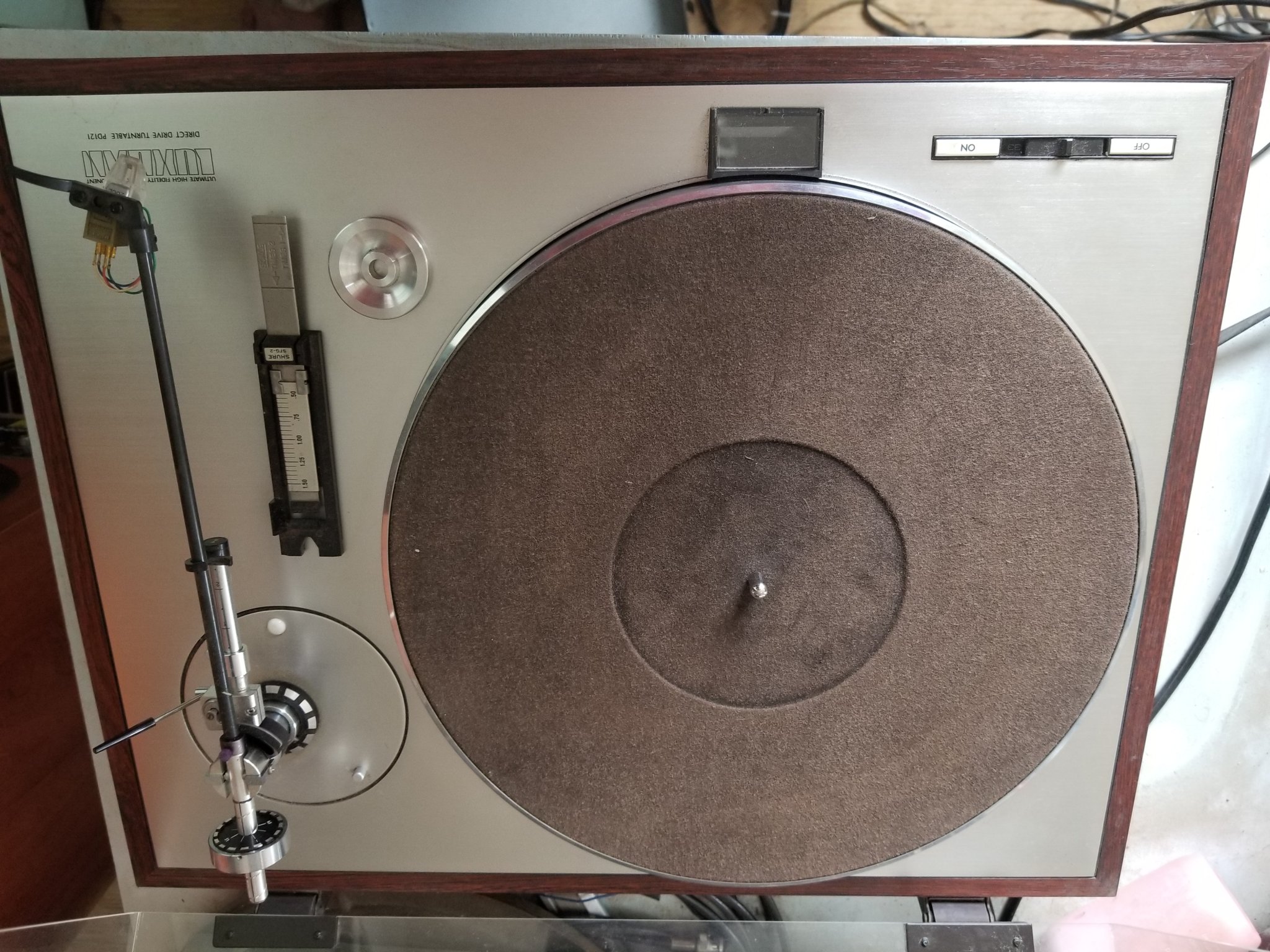

This is the best I could do, the lid is in the way.

I tried to do an imaginary measurement from your picture.
Really difficult from the angle an camera distortion from the picture.
BUT....... It actually looks (to me) like, the Widow arm was just placed in the same hole as the previous arm, which
might have been shorter.
"Pivot to spindle"...... Try and move the arm in over the platter, until the cartridge is right over the spindle. The needle tip
is supposed to go past the spindle with 14,3 - 14,4 mm. From the picture it seems to me to be far more (I could be wrong)
This measurement is called "Overhang".
When this is in place, you use the "Protactor" to align the cartridge, after the arm has been placed correctly.
Beneat is a couple of helpful links. Be sure to read the whole Vinylengine-thread. Quite informative

@rayma
You´re missing the point here.
The base plate, onto which the tonearm is mounted.
If the hole in the baseplate is NOT in the center, rotating the base plate will alter the "pivot/spindle" distance.
Either that, or drill a new hole in the base plate.
