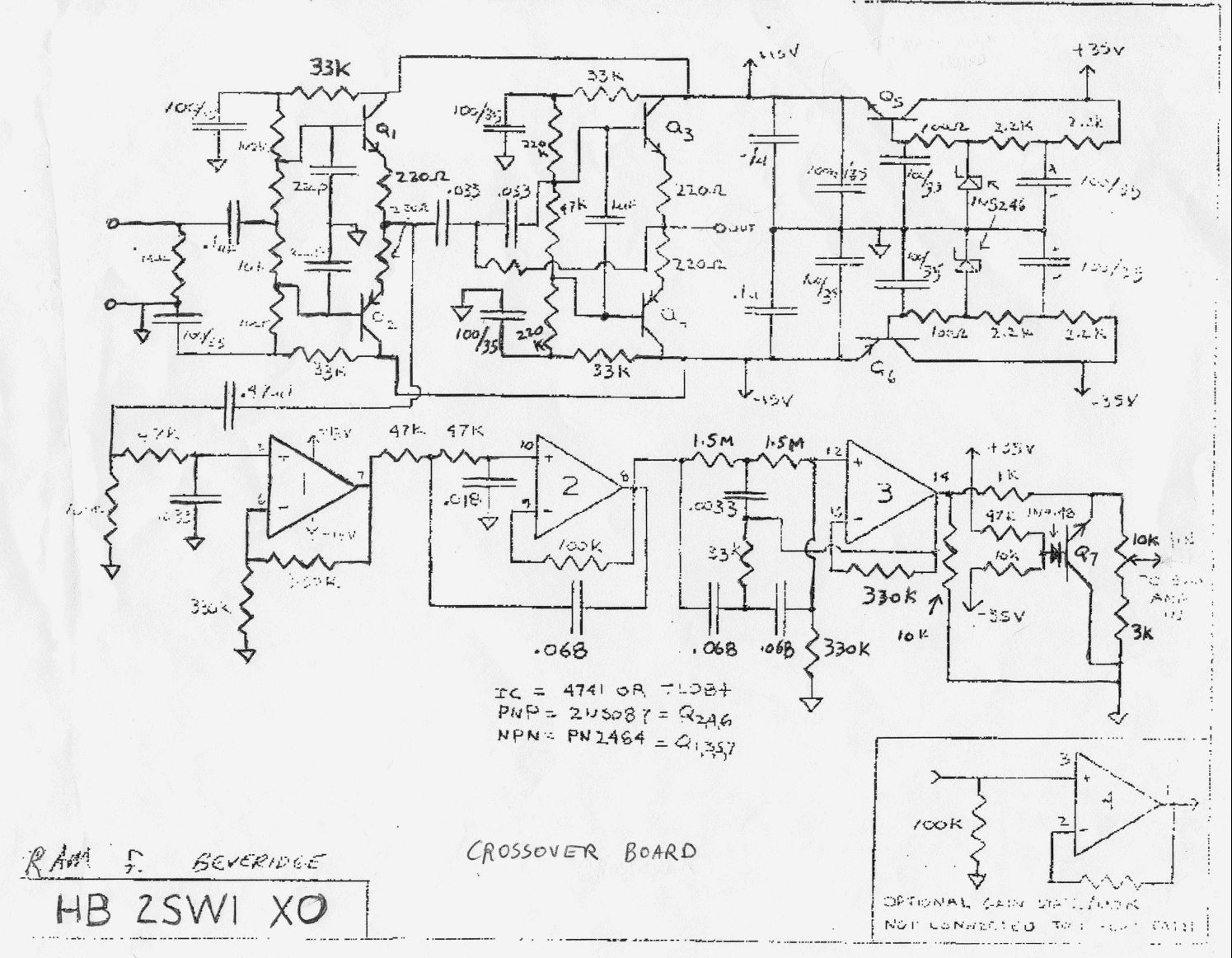

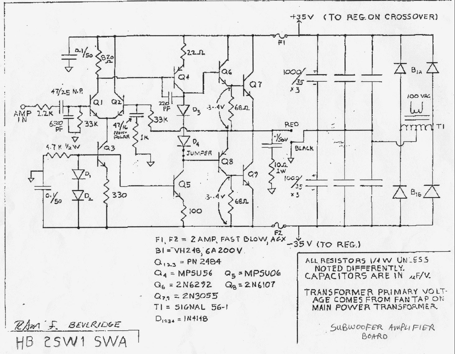

Attached are the drawings I have for the 2 sub boards.
One makes the unregulated rails & has a 50 Watt(ish) woofer amp. The second board is the low level XO and regulators for the opamp rails.
In my amps these boards, and their dedicated power transformer, are removed. My rear panel RCA jack is wired directly to the driver board input. The value of C101 has been increased to make it broadband. All control is upstream via DSP.

Thanks @cvanc- This is a much better quality print than what I had found. I am going to first try to passively cross over the panels 1st order at about 100hz and use a pair of powered subs. I use this approach with my model 3's that have been converted to direct drive and it works really well. I have an active crossover as well to try.
The internal sub amp and crossover will be disabled. Thanks for confirming my approach for now.

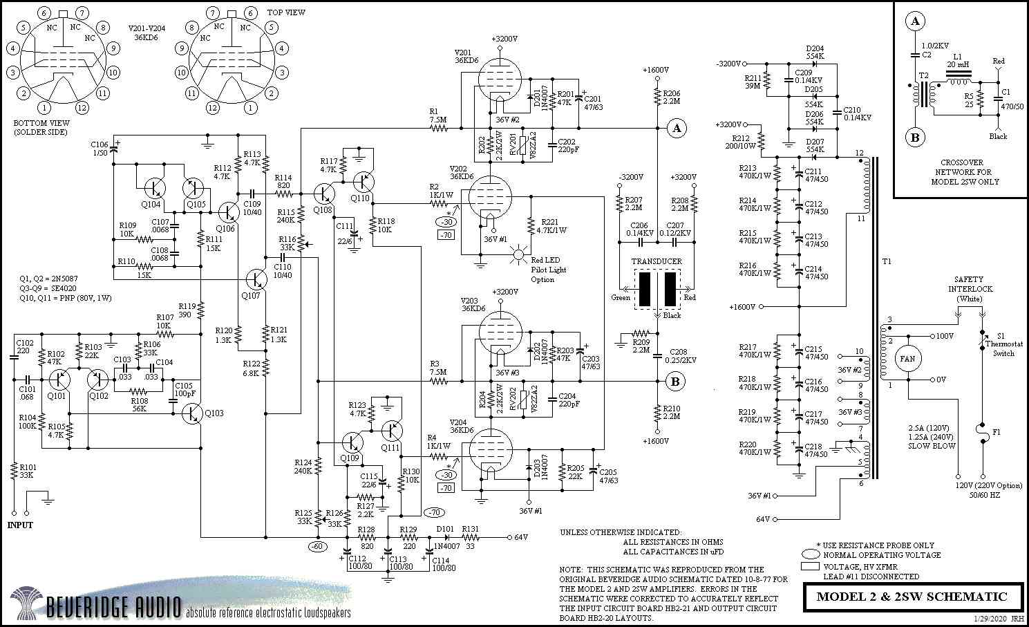

Thanks @cvanc - I have run into a snag.
On the phase that includes V203 and V204 I am missing my 1600v a the node indicated as "B" in the circuit diagram. I have the 1600v at the power supply but loose it on the other side of 2.2M ohm R210
I have my 3kv of course
I have pulled off C208 and lifted the 7.5Mohm R3 and the 1.1Kohm R4 but no love.
The other phase is ok.
Something is pulling things down. My components appear to test good but maybe something is happening dynamically or I am missing something very obvious.. frustrating day ..

Hmmm, you lost the 1650 on only one 'totem pole'?
But the other totem pole has normal-ish voltages?
That tells me the associated 2.2 Meg resistor on that side is open.
FWIW my two amps are stuffed with 1 Meg in all these locations, not 2.2. I've never found why this value was varied.

I wish it were that simple. Already tried and tested for the 2.2M resistor. Something is loading it down- I should be more specific it is not 0 volts but a few hundred. I've lifted C208 and R3&4 but no dice. I will keep on looking . There is not much left but the cathode bias cap and resistor. I ve ordered new varistors but the one there tests good.
I did have a flare up in a tube before this happened ... but to be honest I don't think I check anything but the the 3.2kv and 1.6kv prior to that.

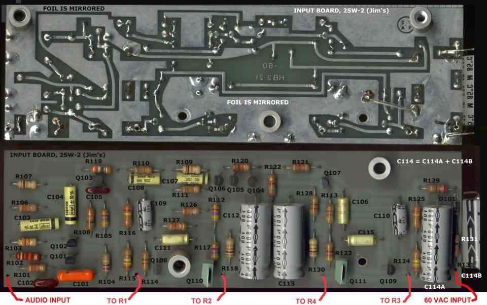

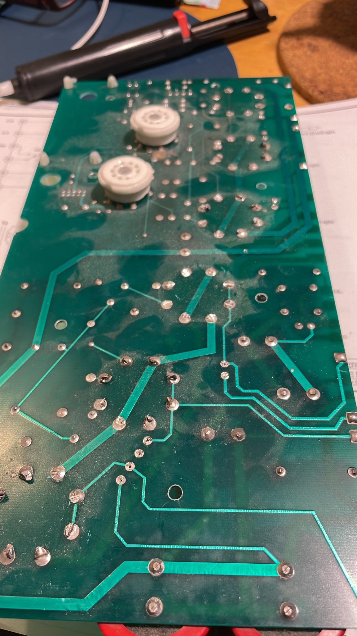

I have solved this problem - 50% self inflicted.
There is a jumper on the input board that connects 2 ground planes together- it was muddled at some point and connected with PVC wire that was burnt and ugly. I replaced it with buss wire in a teflon tube and soldered it back where it was.
It was originally the wrong location and I simply replaced it back in the same location. It grounded a node on the board that should not of been and it is connected to the amp board and pulled everything down.
So , carelessness on the previous "tech" and carelessness on my behalf. I was focused on the amp board and carbon tracking or shorts.

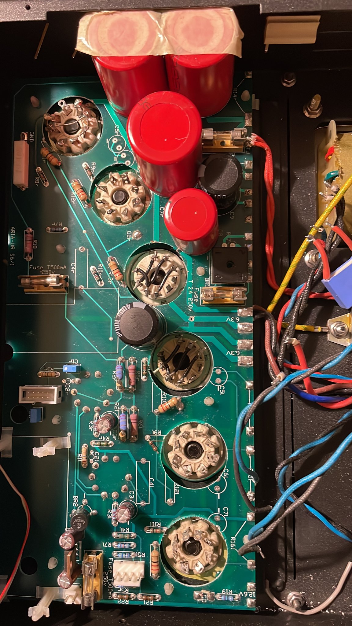

Hi @cvanc ,
Thanks for checking in and all the support thus far. Yes, after being stumped for a while- and finally getting that corrected- both amps are behaving. I am about ready for testing on the panels.
At this point, if they work out, I think I will change the tube sockets as the one's in there are pretty loose. I was able to find some NOS type identical to the originals on ebay. Socket changeout will be a job and a half.
I also removed each panel from the cabinets vacuumed them and in one case the lead fell off the stator- I had to grind back the epoxy find the wire and re-attach, The repair looks good. I also took the time to change all the eyelet connectors - they were corroded or in bad shape, Finally I changed the panel banana connectors on the plate as they looked worse for wear. That whole exercise was a ton of work. I am not sure what would be done today but the arrangement of screwing in the panels to the cabinets with spacers is really a pain in the butt. There has to be an easier way.
Next I will probably disconnect the crossover and sub amp and go direct to the input board for a passive first order cut off to the panels of about 100z.
Getting very close.

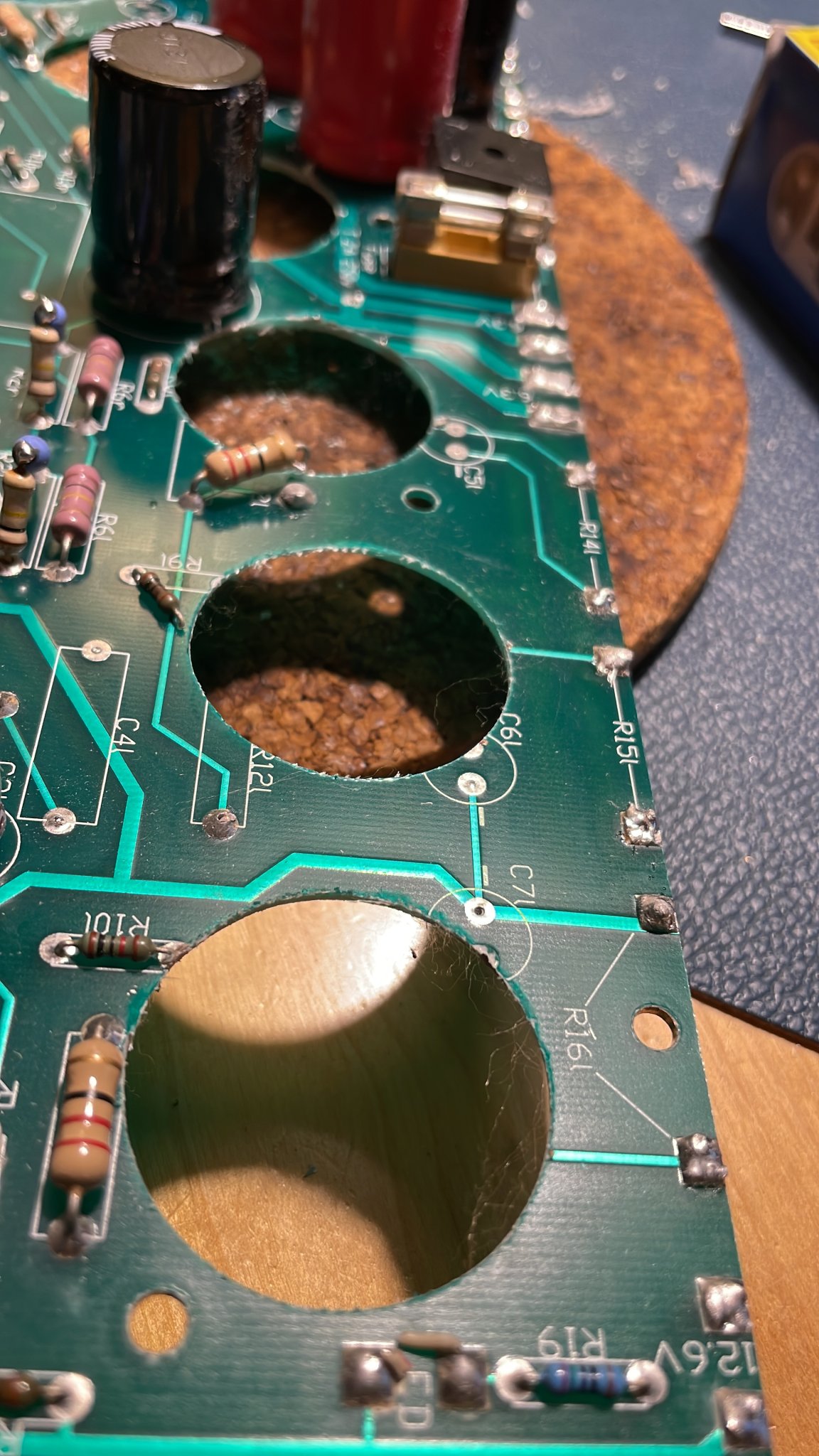

"If you are happy with your new sockets then the best way is to cut away the old ones and desolder the bits that are left on the PCB. This will give the least stress on the board."
Yes, for certain, although the boards were in relatively good shape for 40+ years old-- the trouble shooting and previous work played hard on them. So, one pin at ta time is the way to go. Between soldering and de- soldering - only 96 connections to go! :)
STOP STOP STOP
Here's where you get to learn about those Mother-effing tube sockets.
One of the main failure modes for Beveridge amplifiers is 'tube droop'. The tubes are held horizontal and eventually they just fall out of the socket from their own weight. When the pins open up it's spark city and things fail.
Further, and here's some new data for you, the bases (pin end) of the tubes are much hotter than the rest of the tube, in my rig anyway.
So kill 2 birds with one stone - replace the sockets with individual machined pins like those used in a Nixie clock or some such. I bet it would be a tighter contact, plus open airflow right where you need it is always a help.
It's a real project getting old sockets off. You will damage the board even if carefully removing contacts one by one. The boards are fragile and the foils are fragile.

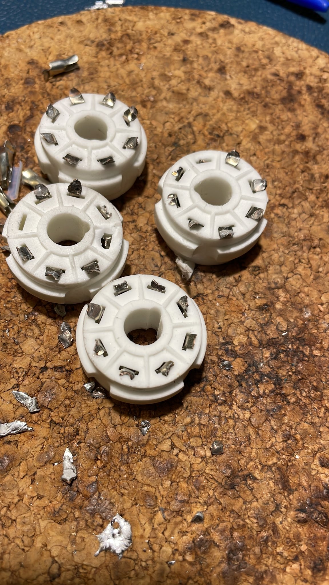

in case you will disgard the old sockets just cut them with a plier. No de- soldering of the entire socket. Just the left over pins. Much easier end it will save your board.
Reactions: 1 user
Yes--- snipping the bakelite sockets is the way to go.

My project has stalled as use the summer here to take advantage of the weather and other outdoor activities.
@cvanc and I have been trading emails and he has helped tremendously with some questions. My amp units have been refurbished totally and work on the bench. I have done maintenance on the panels, cleaning, new connectors , and new banana sockets etc. Also corrected an error that the previous tech accomplished that I duplicated and frustrated myself for weeks.

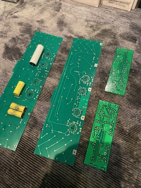

In the meantime - I had mentioned that I did not attack the tube sockets as the boards are in good shape but the foil is fragile and I know that the socket removal will be a ton of work and hazardous to the foil. The current sockets are loose and "functional" but no amount of tightening in this state will work or is permanent. The hazards of loose connections on this design could be catastrophic.
@cvanc has hooked me up with the design of new boards masked and plated through holes- this is a major improvement I am grateful.. I will be populating the boards shortly as I have assembled all the necessary duplicate components. I will have the originals as spares and the new ones will go in the amps. Getting HV components in small quantities is difficult from 1 source. The usual suspects of Mouser and Digikey have limited selection. Ebay, Surplus Sales of Nebraska I also went direct to Caddock for some HV resistors.

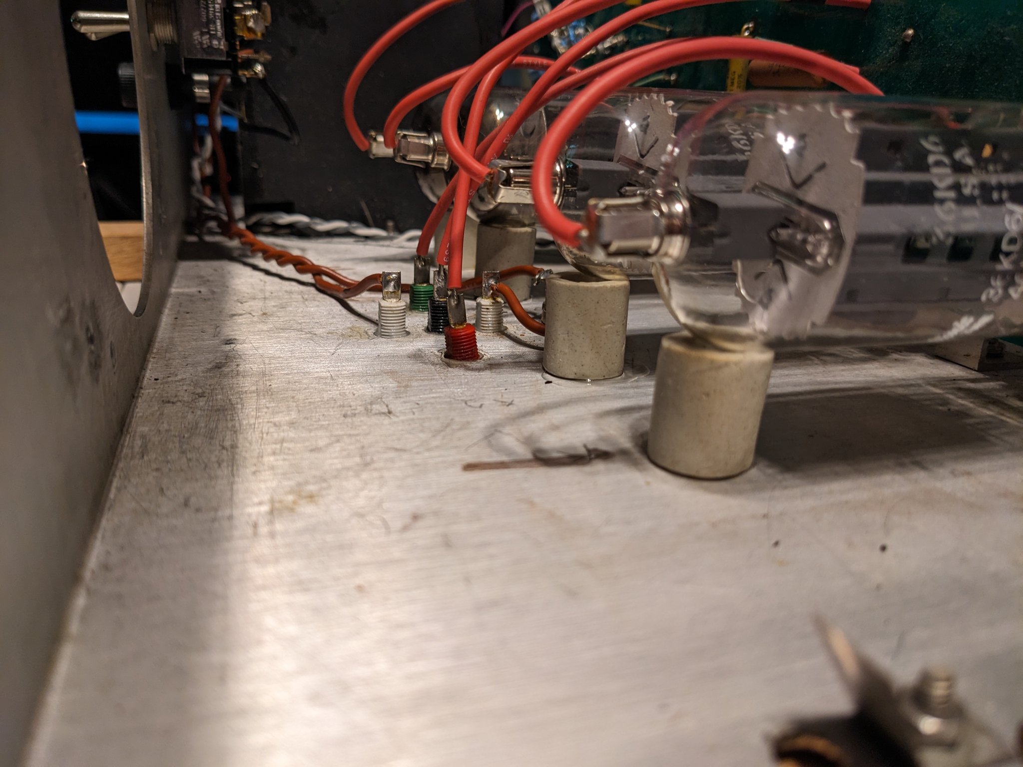

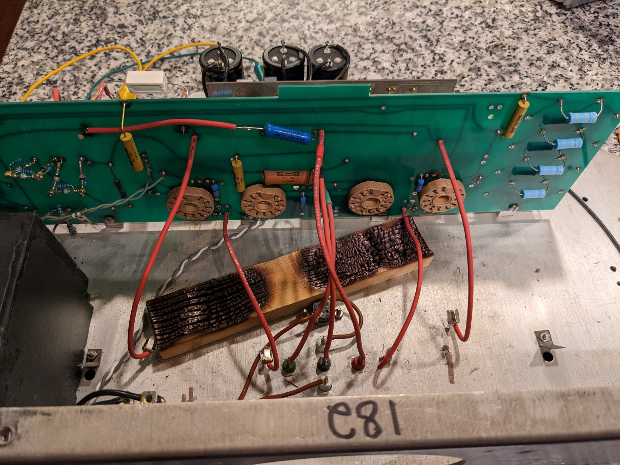

"Perfectly good tube fell out of the socket" is failure mode Number One, folks!! And what fun it is when it happens. The transformer has seconds to live unless you do something about it.
You can coexist with the sockets as long as you do two things:
1) It's not at all hard to re-tighten the socket contacts with a dental pick & a flashlight. This is what I do and I'm a Ninja at this by now lol. But I have open fan holes so access is easy.
2) ADD TUBE SUPPORTS so the tubes simply can't droop. I use a piece of wood but yeah I don't recommend it - see photo. I recently got some ceramic standoffs and will put them in soon.

Also, I just put in these ceramic standoffs for tube droop and they look real good https://www.amazon.com/dp/B0951YCQP4?th=1
