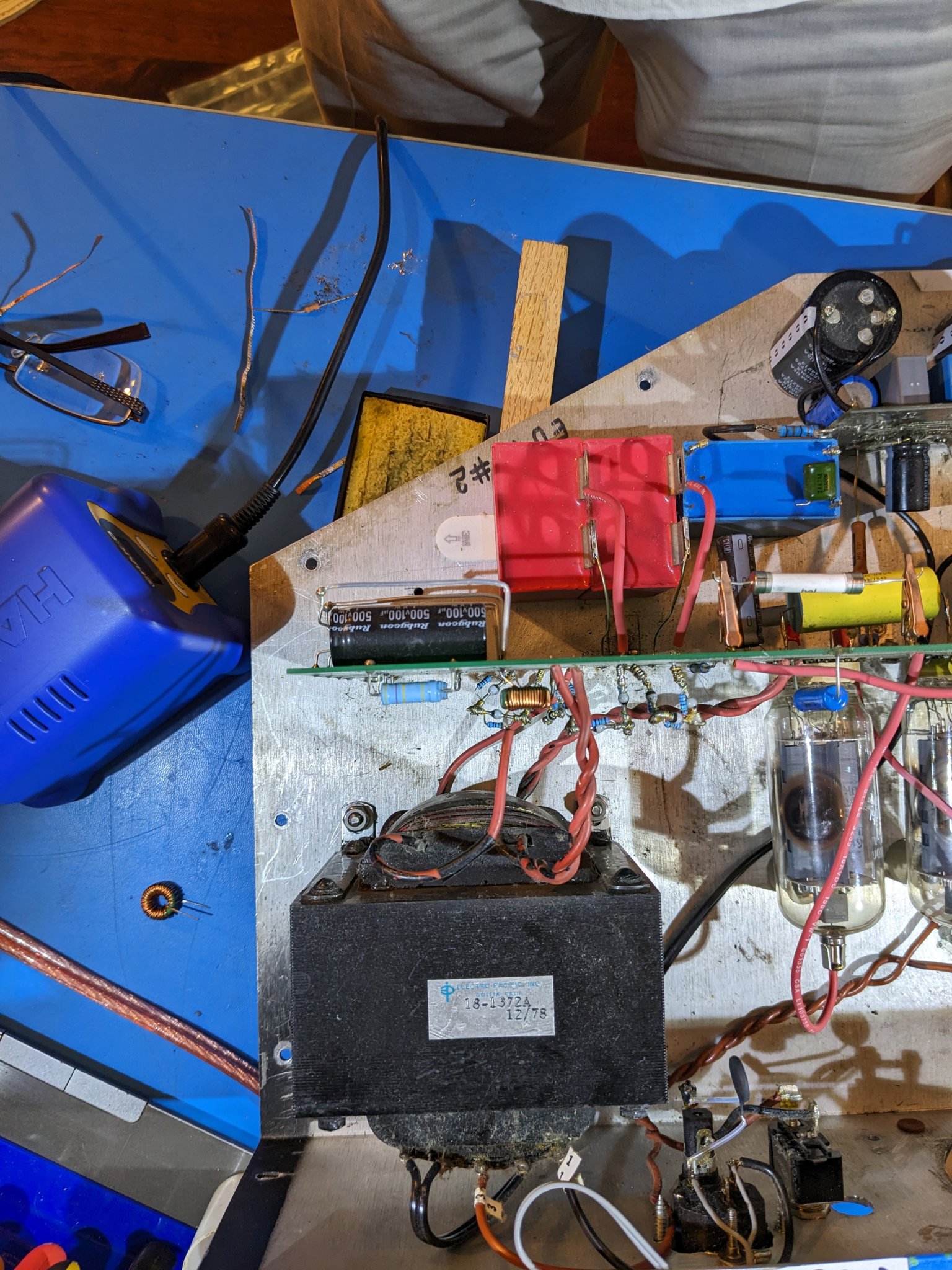

Undoing tube socket problems:
"Perfectly good tube fell out of the socket" is failure mode Number One, folks!! And what fun it is when it happens. The transformer has seconds to live unless you do something about it.
You can coexist with the sockets as long as you do two things:
1) It's not at all hard to re-tighten the socket contacts with a dental pick & a flashlight. This is what I do and I'm a Ninja at this by now lol. But I have open fan holes so access is easy.
2) ADD TUBE SUPPORTS so the tubes simply can't droop. I use a piece of wood but yeah I don't recommend it - see photo. I recently got some ceramic standoffs and will put them in soon.

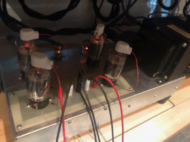

After months of back and forth on the bench I finally got around to connecting the Beveridges up today to put some signal through them.
On the bench they did confound me a couple of times. My first attempt this past weekend of hooking them up was unsuccessful and more bench time.
Today they sang!
A couple of minor problems- one amp has some white noise but plays well. It may be one of the transistors... I will have to investigate and perhaps swap input boards and narrow it down. Further, One of the panels was popping on loud passages- however, I discovered that the stator wire insulation pulled away on one panel and was arcing to the the frame... I fixed the wire and will have to re-install the panel. I am fairly confident that is the problem.

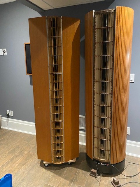

You are going to need to clean the ESL panels. You must remove each panel from the cabinet and clean both sides. If the grill foam is missing and the lens is exposed you can bet the front side of the panels will be filthy.
The is a delicate operation as the epoxy stators are crazy brittle and crazy fragile. I cleaned mine with a vacuum and (gentle) compressed air.
While out you can inspect the membranes on both sides. Look for areas where the metallization is eroding away.

Hi Carl,
The panels were all cleaned and vacuumed meticulously. The arcing in my case was clearly observed on one panel where the wire teflon sheath for the front stator of one panel slipped and bare wire was in close proximity to the grounded frame. I fixed that and will re- install the panel tonight.
The stators are indeed brittle- where the stator wire comes off front and back - wire broke away in one instance and I had to grind back with a dremmel and re-solder some high tension wire for that panel. Last night I taped around the arcing panel wire whose insulation slipped for the repair and in pulling the tape off---off came some expoy material and the wire in semi free space--- I re-affixed that too and the panel is ready to go back

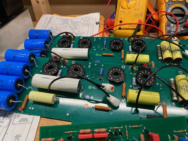

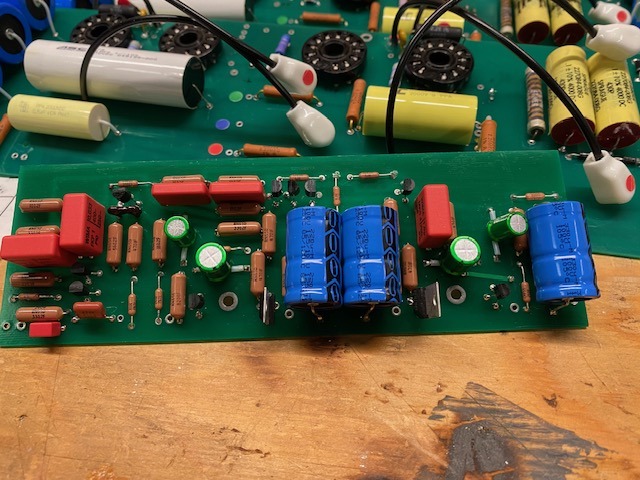

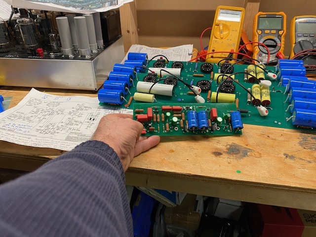

I am close to finishing of all of the new boards for the Beveridge amplifiers. One input board stuffed today-one more to go. The amp boards are done. These NOS tube sockets have a vise grip on the tubes- that will be welcome considering the old boards almost let the tubes fall out by gravity.
Testing with the new boards will begin soon.
