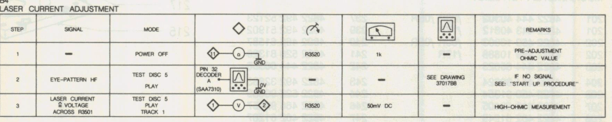

The service manual says that the correct values (using a test cd) has to be:
- 50mV for laser current across a specific resistor.
-400mV (+-40mV) for Focus across certain point and ground.

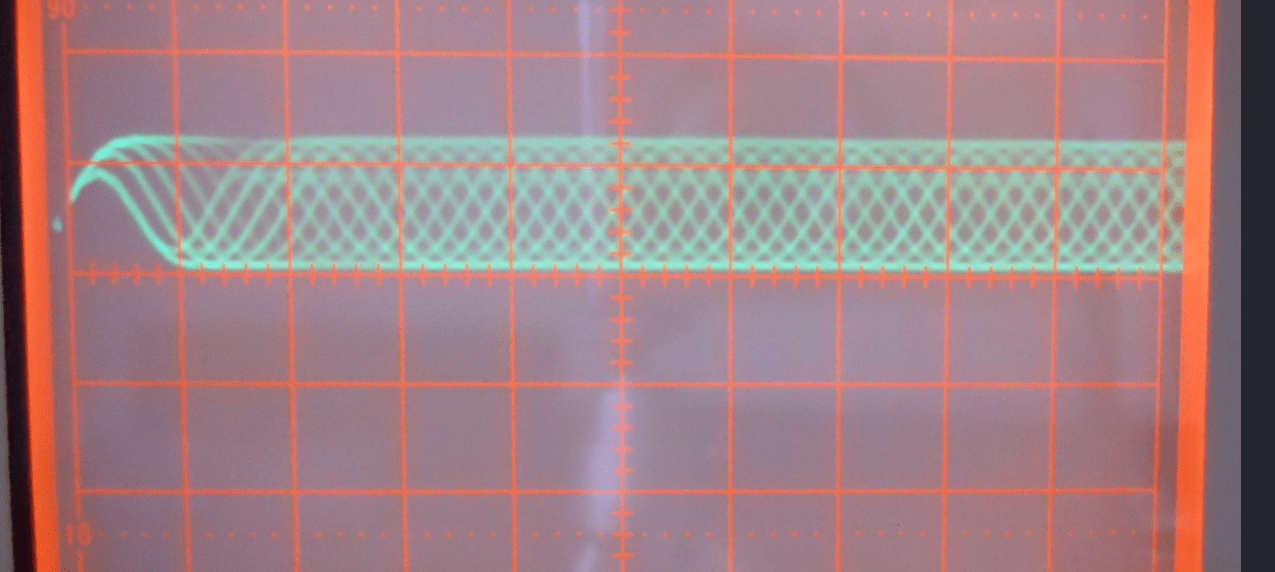

I used a scope to look at the Eye pattern. I cannot see "RF" on the service manual, only HF signal. Is it the same?
Here you have a photo of the scope:
As you can see, the Volts/Div scale is set to 500mV. The scope is very very old and the image is not very clear, but the pattern is visible.
When I turn down the Laser Current Pot, the wave amplitude goes down.
If I turn up the pot slowly, the wave increases until the amplitude on the picture. When I increase the Pot (mid way), the very top of the wave makes like an artifact that I describe as spikes on the top of the mountains of the wave. But if I increase a little bit more the Pot, the spikes disappear. So the most beautiful wave I can set is the one you can see.
Also, the laser current voltage is still low. I'm trying a lot of CD's and the highest value I can read is about 35mV.

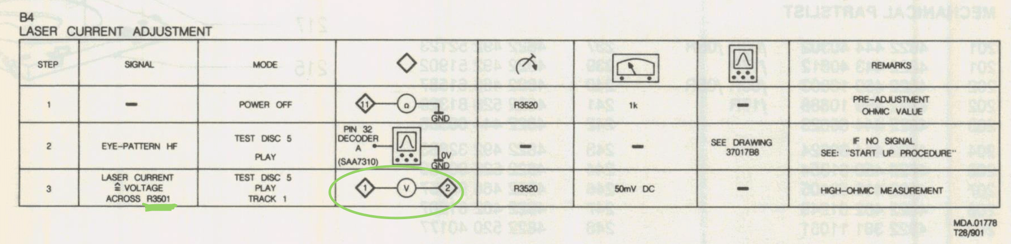

The thing here, is that maybe (maybe) the service manual is wrong.
As you can see, the manual says that I have to check between points 1 and 2 (or R3501 resistor).

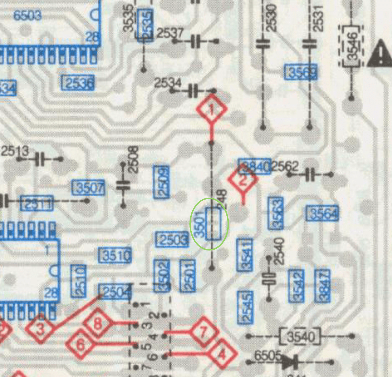

If you look at the board:
Points 1 and 2 are NOT the same as resistor 3501.
If I check voltage between 1 and 2, voltmeter goes out of range (obvious, because this points are wrong). So, what I'm doing is to check directly across the resistor itself.
When I was repairing the unit, I noticed a LOT of errors in the service manual: wrong tags, wrong part numbers, wrong tracks, wrong voltage indicators, etc...
So, maybe something similar is happening here?
Please, could you look at the Philips CD620 service manual and try to determine what are the correct points to check?

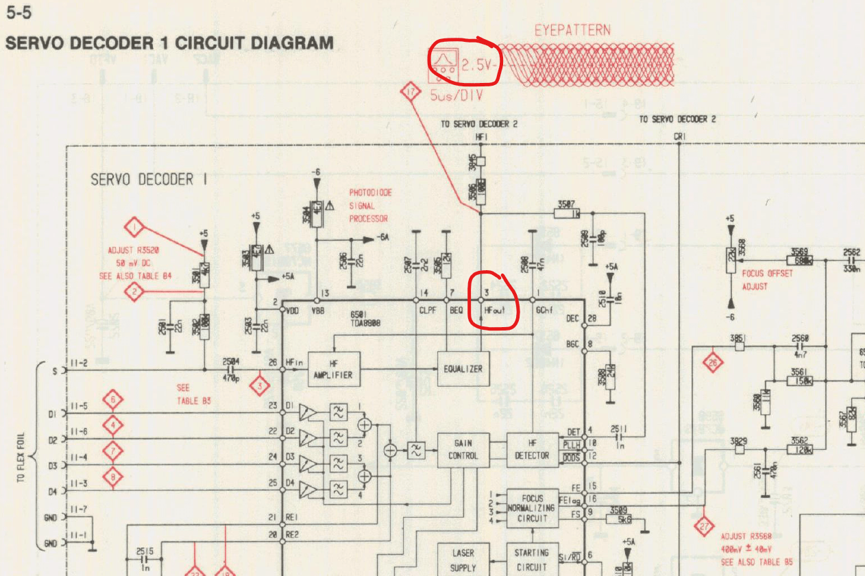

The signal on the scope looks extremely noisy. It should look clean and clear like this:
It can be important to use the correct ground points for the scope to get the cleanest signal. Any of the grounds around the chip should be fine.
The manual shows the RF (HF is the same) as being 2.5 volts peak/peak on pin 3 of the RF amplifier. The input is on pin 26 and if you were measuring at the input then your amplitude looks about right (1.2 volts pk/pk) going off the 0.5 volts/div on the scope. Ideally you should be using a divider probe (10:1 probe) and making sure the probe is correctly calibrated to the scope (use the 'Cal' output to do that on the scope). Check it on pin 3 though as that is a low impedance point and less prone to noise pickup.

Well, my english is very bad I didn't fully understand some of what you said:
“The input is on pin 26 and if you were measuring at the input then your amplitude looks about right (1.2 volts pk/pk) going off the 0.5 volts/div on the scope.”
You mean that if I was measuring on pin 26, then the amplitude I shown in the picture is correct?
Edit:
Mehh... forget it... I was measuring at pin 3 (output) so obviously the amplitude is not correct. I bet the laser diode is wearing out. I'll continue measuring with your instructions just for learning... but I think the problem is in the laser.

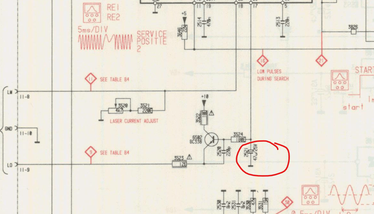

It is possible the laser is low emission, also possible to be some issue with the optics but ultimately it all comes down to the same block of parts which is the pickup.
Have you replaced this? If not then do so and also turn the laser power down before before retesting with a new cap.
Wow. Never thought that the laser power could be modified. I checked service manual and the cdm4 itself and didn’t found any pot to adjust the laser power.

I thought you had already turned the laser power up and still could not get the required levels :)
If you have not touched the laser power preset then just replace that cap before doing anything else and just see if it is now OK.
Set the RF level using a representative disc (good commercial quality normal CD) to 2.5 volts pk/pk at the point shown in the diagram.

Ok so, I’ll turn this pot down, will replace the cap and then turn it up again looking for a good HF amplitude. If in cannot be reached, then the laser (or optics) are bad. In this case one good solution is to buy a cheap player with cdm4/19 and change it (and cross fingers).
If the player works fine and there are no skips, I would stop here. Of course replace the capacitor in question. I think your only problem was the insufficient ground point of the oscilloscope probe.

Thinking on this cap................ OMG..... :oops::oops::oops:
Checked the service manual and is the cap located just in the same corner of the board that was broken. I bought this player in a non working condition because it hit the ground. When opened, I noticed that a small corner of the board was broken and 2 tracks sectioned. I soldered new cables to restore this tracks and the player worked again. BUT this capacitor is just in THIS corner so.... I'll recheck all this section of the board to see if something is wrong...

You could (but be very careful) measure the voltage across that 12 ohm resistor from the emitter of the laser regulator transistor and calculate the current. A bad laser will have a higher current draw for a given optical laser output. I think these might use the Sharp LT022MC laser diode and currents from memory would be around 55 to 65 ma.
12 ohm? You mean on the CDM?
Administrator
Joined 2007
100ma is way over the top and a reading 49mv that then falls points to a duff laser. Yes, the 100ma is flowing in the laser diode chip. It will be running very hot (the tiny laser diode chip) and the output will fall away.
