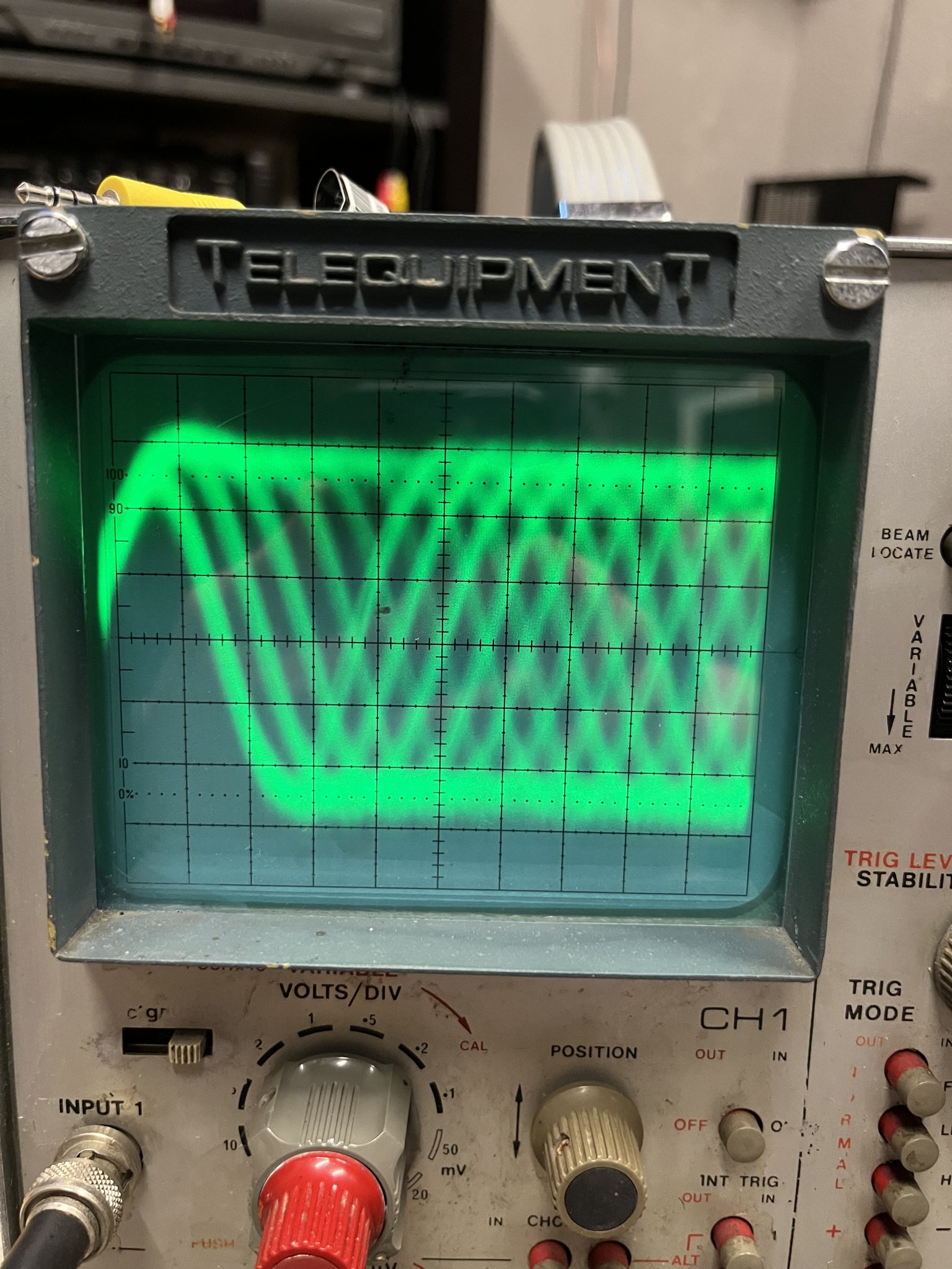

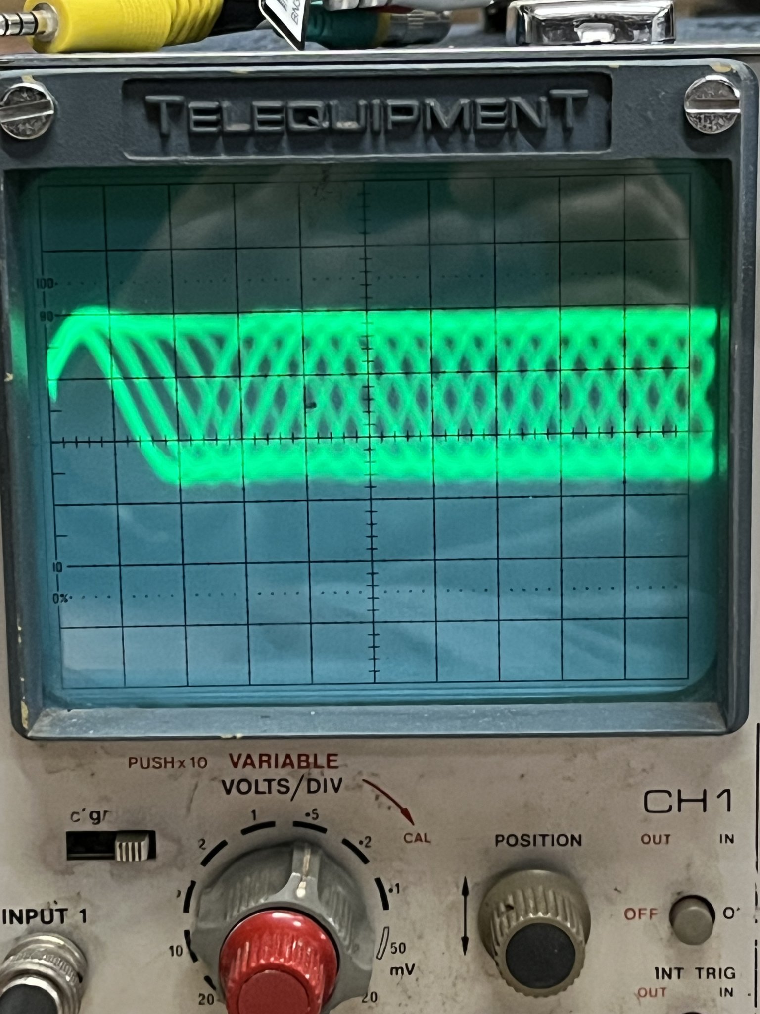

Checked RF signal across RF output and ground (same chip gnd leg) and obtained a much clearer signal than older posts:
Still low level but a beautiful wave.
Oscilloscope is set to 500mv/div (I think)
With “new” lens and well adjusted current and focus, still having a low? signal.
Maybe its a oscilloscope failure or maybe its my fault cuz I have not idea how to use it properly.

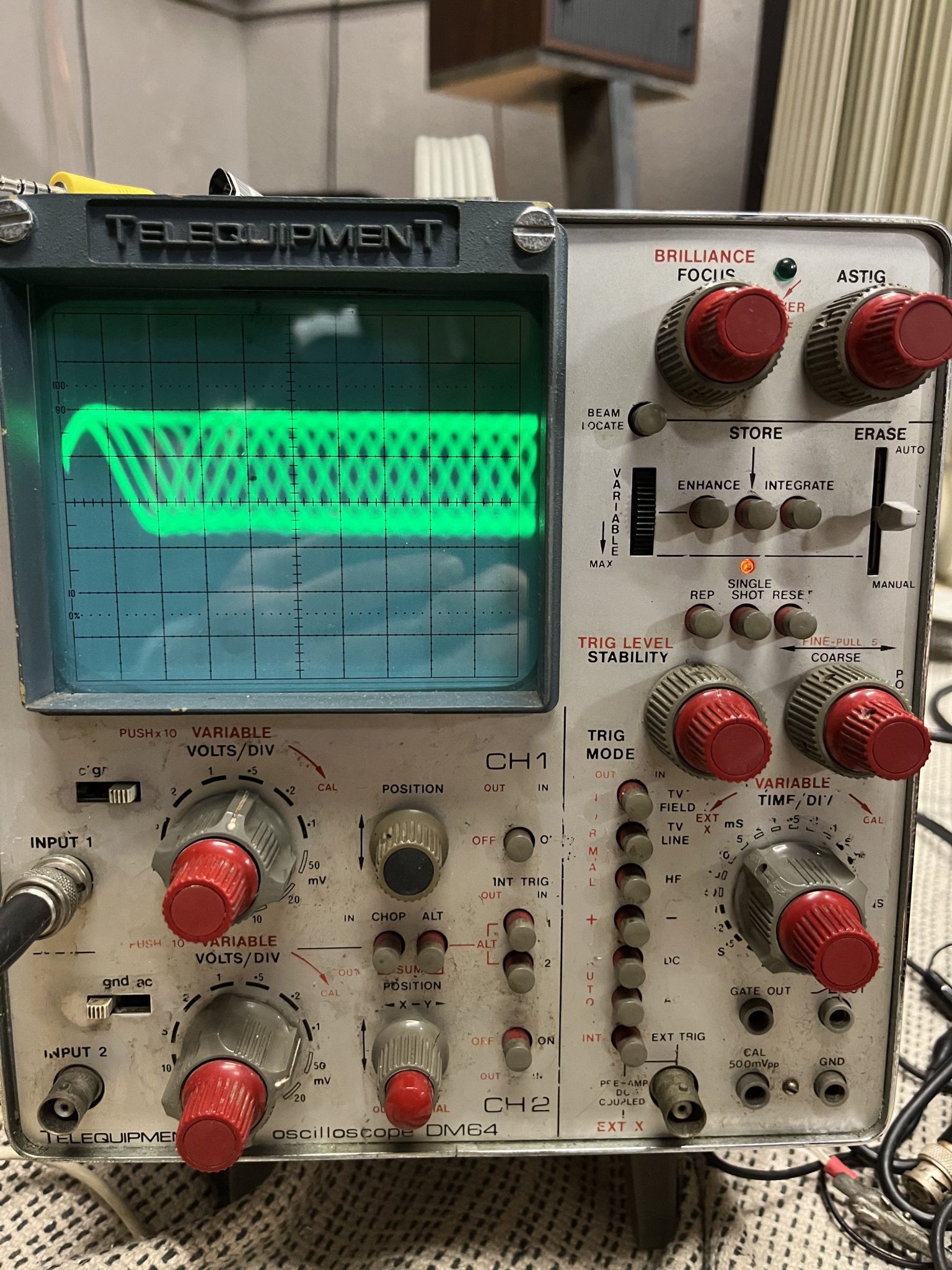

Here’s a full image of the oscilloscope panel:
Probe is well calibrated and set to X1. If I change it to x10 then the signal goes very very low (obvious).
The calibrate trimmer in the probe only has effect in the x10 position and the amplitude goes low because you have to set the scope from 0.5v/div to 50mv/div to account for that. You then mentally make the leap to multiply all results by 10 as you use the probe.
Check the probe in the x10 position using the Cal output on the scope. I see it says 500mv on the output and that should be very accurate. With the probe in x10 you should see a perfect squarewave of 500mv peak to peak (so one square of deflection when set at 50mv/div). If the waveform is not perfectly square then adjust the trimmer in the probe.
Depends where you are measuring. Refer back to post #4 Pin #26 (HF in) would be around 1.2 volts peak to peak which is around what you are showing.

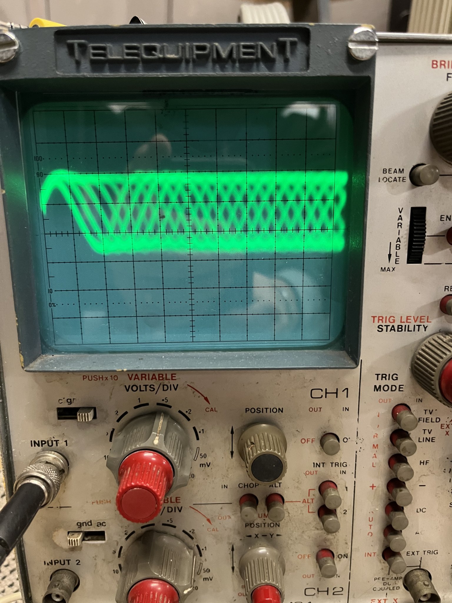

Well calibrated using x10.
Measured using x10 and still reading 1,3V peak to peak (pin 3).
If I measure Pin 26 (hf input) it shows nothing and player makes a sound like (TAK TAK) and stops playing.
What you are looking here is Pin 3, using x10 and scope set to 20mV scale.

I would have expected pin 3 to be 2.5v according to the circuit details.
I'm just having a rethink... I would really need one in front of me... but looking closer I think I'm wrong in what I said earlier. The HF in is going to be the input to an inverting amp stage and so that explains why you see no signal.
The 2.5 volts isn't the amplitude of the RF, it the mean DC level. So your measured 1.3 volts peak to peak sounds about right and is the typical value seen across many makes and models.
Sorry about that, my error there.

I noticed that different cd’s shows different RF signals. Some cds shows very clear signals, and other cd’s (just a few in my collection) shows a very blurry signal.
Do you remember a post where I said that the player was well adjusted, but hearing a specific cd it started to jump?? This cd is the only that shows a very blurry signal.

RF amplitude is determined by pit shape and quality, same for blurry eye patterns. Reflection quality also matters (translucent CDs don't reflect all the signal back).
Philips specified Philips test CD #5 for that very reason. Other manufacturers specify various CDs as they have a known amplitude and pit shape (quality). If you run through your music CDs, you will find a wide variation. Some will be warped, eccentric or translucent as well. Pinholes and scratches are local, variable defects as well.
