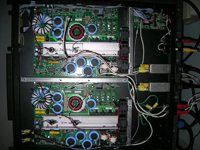

Hallo Sander
This is an outstandig implementation, perfect workmanship, clean design, very professional! Congratulations! As a beginner, with yet limited experience, may I ask two questions?
(1) You are using unbalanced inputs, rather than XLR. Did you compare the two and found no difference in performance? You just tied the unused input to ground?
(2) I see that you are using a power line filter. If I recall correctly, Bruno once recommended against it, because the Y-caps could cause ground contamination with power line noise. However, it all may depend on how grounding is implemented. Maybe you could shortly comment on this?
I'm in the process of finishing two UcD180AD monoblocks, a picture will follow shortly.
Kurt
Kurt,
At that time I had more use for it as a single-ended amplifier, my current setup uses two Hypex UcD400s that do have a balanced input however. IMHO balanced inputs are superior to single ended, provided you carry this through throughout your system, only having one component with balanced in/outputs is rather pointless.
Well, that's correct, however I'm using a medical grade line filter which does NOT have Y-caps, so I do not have that problem.

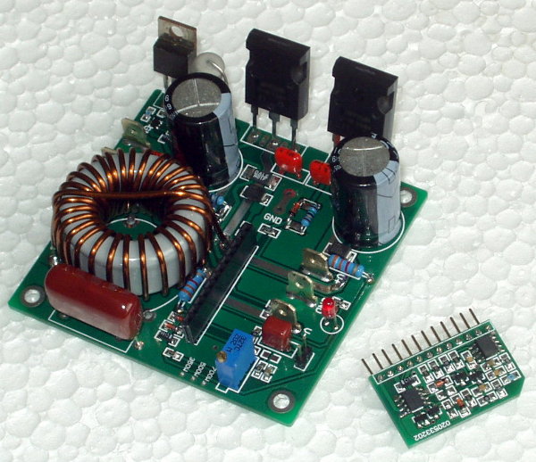

BWRX said:
Care to share any more info about this module? 😎
Nothing special...
+80V/0/-80V supply in full-bridge. One Cycle Control modulator exactly as in the patent.
I have made it for sub-bass, but works fantastic at full range. Oscillation is about 300Khz.
After some unsuccessful attempts to transform it in BD modulation I decided to leave it as it is now.
My humble opinion is that OCC is a great and simple error correction technique.

Thanks a lot for your answer. I didn't know that the medical grade filters are implemented differently (just thought they would use higher quality components). That's quite interesting, I might give this a try.
Regards -- Kurt
