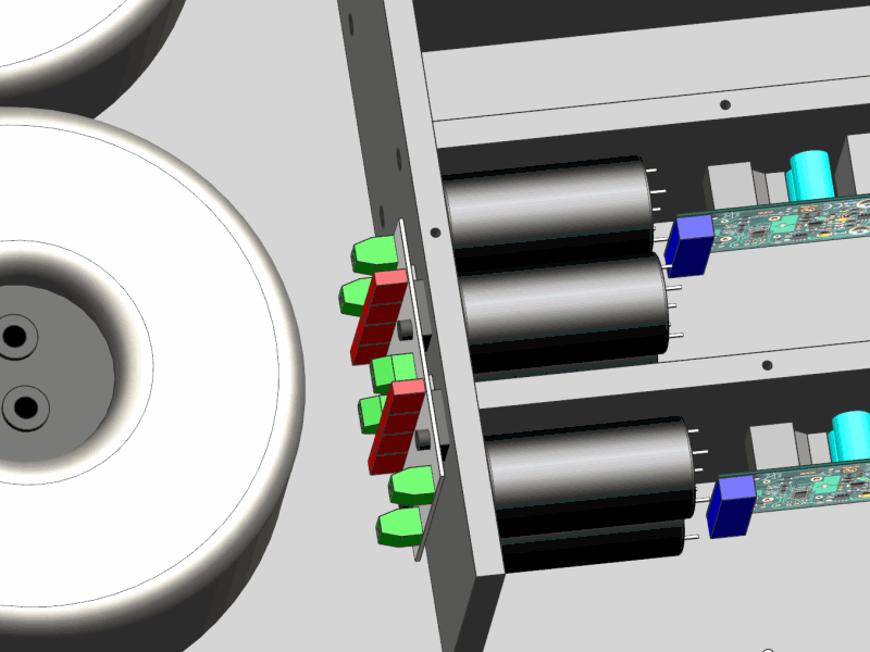

What software did you use for working out that layout?
Ok, I'll make swiss cheese out of those hot plates. D***, I'm hungry now! 😉 A rediculous number of strategically placed 3mm slots should do it, right?
What software I used? My head, it's pretty soft sometimes 🙂 For visualizing it, I use UGS NX3, a pretty awesome piece of CAD/CAM software we use at my university.
classd4sure said:
I think I agree with Lucpes here. It's hard to tell by your drawing how you plan on mounting the supplies on that plate, looks like they're kind of integrated. You'd likely be better off isolating them from the divider, flipping the whole thing over, and going with the shortest possible runs for DC to the modules. The bulk storage caps on the modules arent' the biggest, so you really want that path as optimal as possible.
You can still do it and keep all the AC portion shielded from the modules if you work it out right.
Sorry, it just seams so easy when I explain it to myself 🙂 The power supplies are only screwed onto the divider, as the vertical approach takes up less space and makes for shorter wires. The green cubes on either side of the PSU is where I connect the caps+amps, so if I go this way, the wire lengths will be cap length (70) + width through divider (10) + distance from divider up to connector (~10), which give us about 90mm wires. They won't be more than about 10mm shorter if I flip the divider over.
As you can see from the detail image, the caps' connectors are on the amp end, so I'll only have 10-20mm of wire from cap to amp.
The only way to get the wires considerably shorter, would be to stand the caps up, but in addition to the fact that I don't really have room for that, it would mean longer leads to the amp and a messier PSU layout.

Yep. If looks are important you can also just vent the bottom plate of the amp towards the PSU end of the modules, and put exhaust vents on the back plate towards the top. That should keep fresh air flowing around the heater and give you good circulation in the little compartments. You might also want some venting around your transformer as well (I would). Exhaust could then be on the sides.
Thanks for the CAD name, I knew it was no autocad. I shall acquire :devilr:
