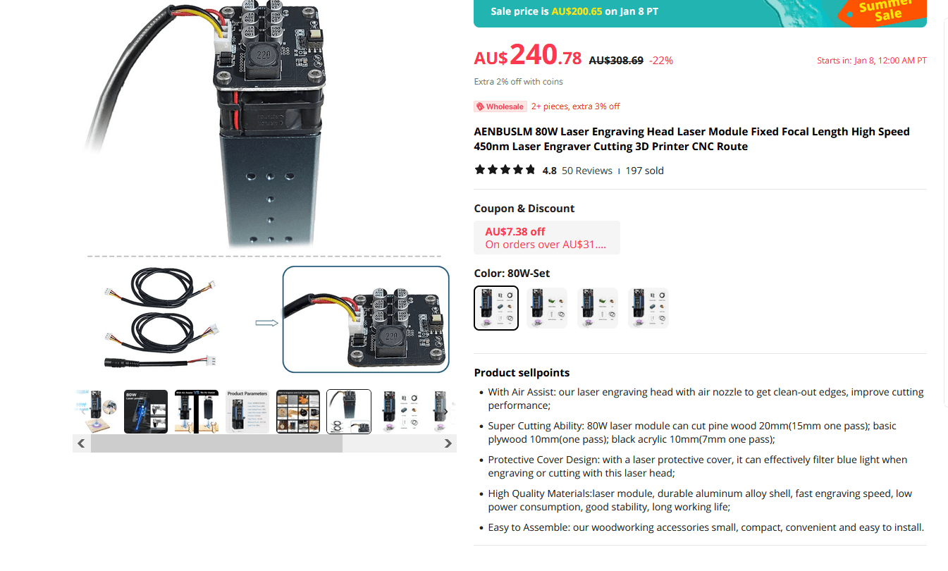

Laser cutters
This is something I would like to learn more about. Looking for a DIY or commercial design that can cut 18mm fairly quickly and is not over AUD1k. Does such a thing exist?
18 mm steel is a lot more power than 18 mm wood.
Member 'haiqu' got a good deal on a used machine, IIRC, but freight to you could be a deal breaker.
Calipers tend to shift around, and many digital ones switch off after a short time to save power.
Which was the reason for me to recommend DRO, those have nice big displays...
New 8' x 4' Chinese laser machines (for steel) are in the $5000 range and up for brand new machines, imported and installed, I think they are good to 10 mm.
For wood, you need a CO2 laser with the ultra pure gas inside alone costing you about AUS$2000 for 10 kilos...machine price is above US$100k for a new Chinese one, German is about 4x that...

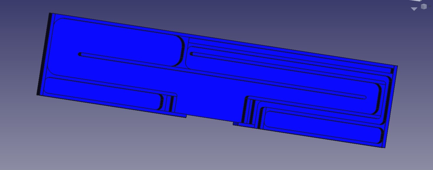

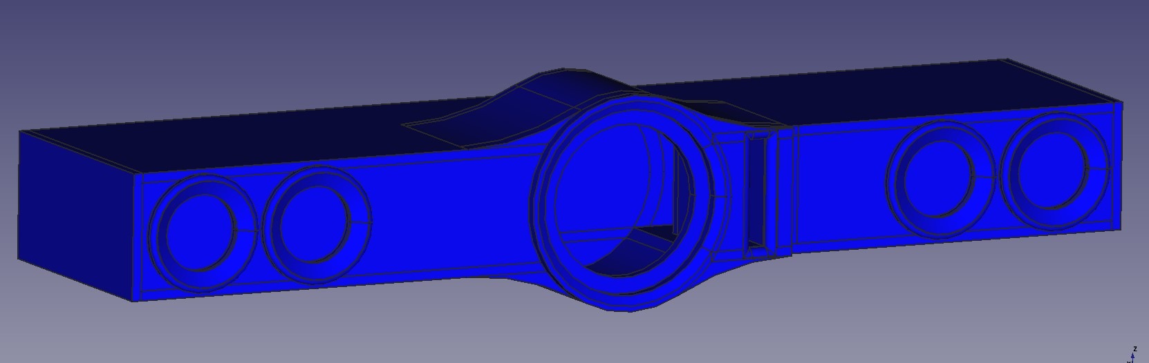

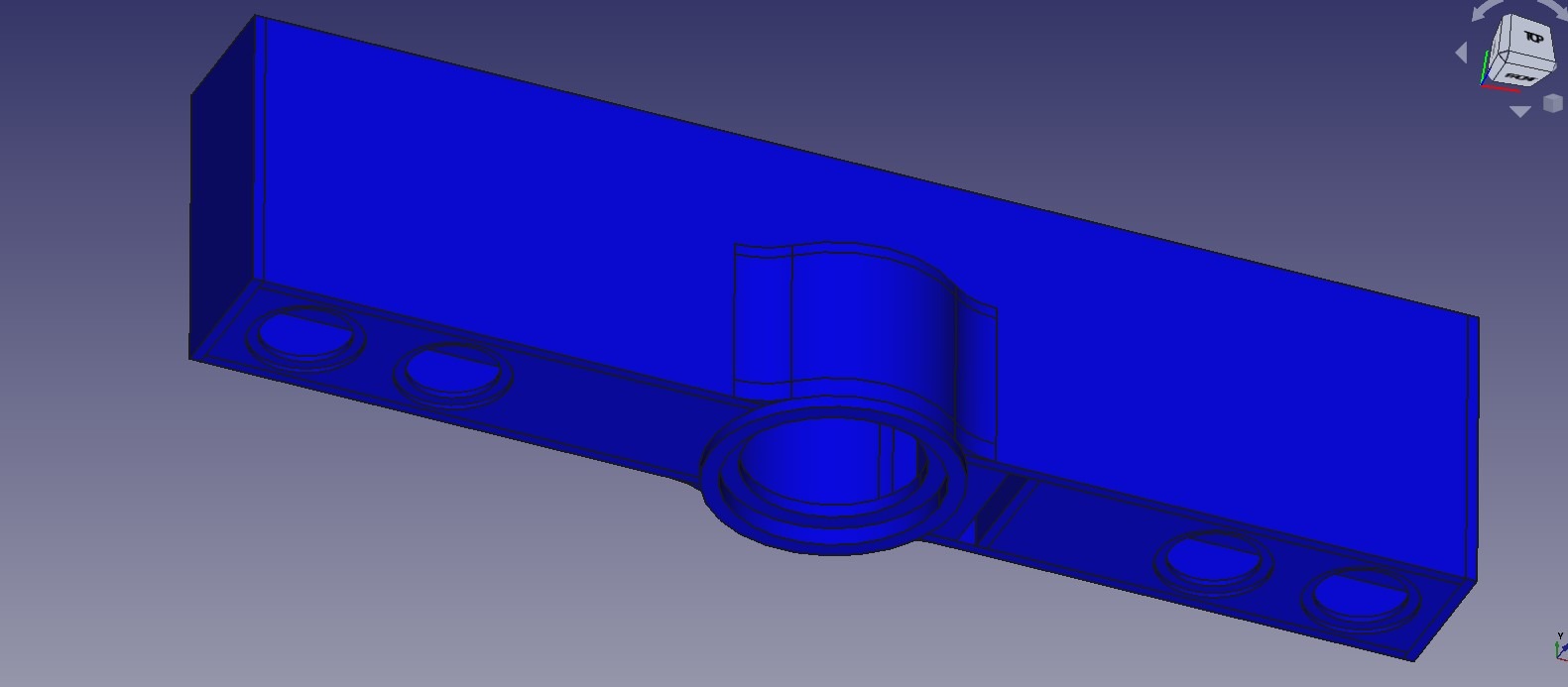

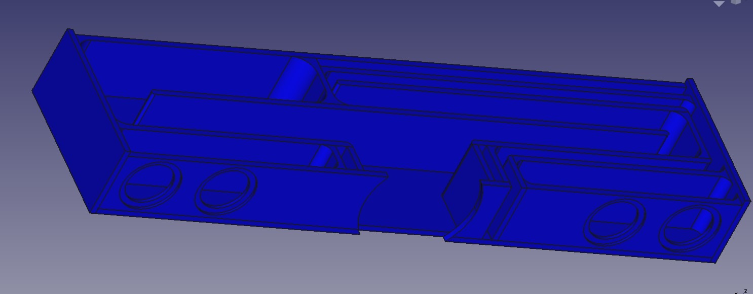

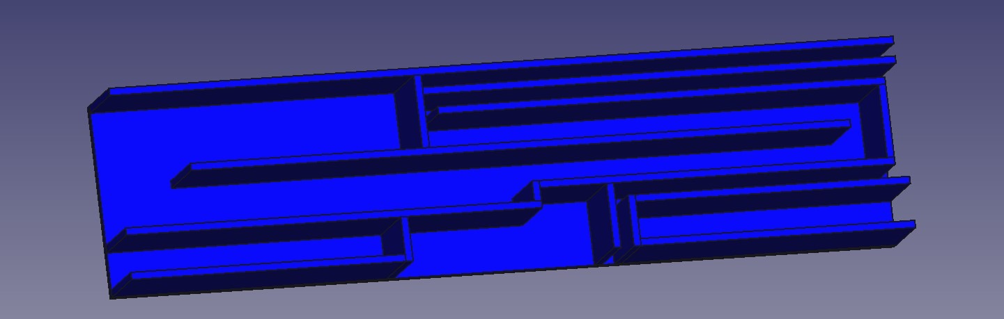

This is from my Tiny 40hz sub thread and regarding the 20hz tune TL that I call Kittybar TLc

Naresh, thank you for that. Please help me make sense of this module, then? Looks like it can handle 18mm in woody boards in 1 to 2 passes. Could this not be built into a DIY slide saw for straight cuts or fitted to a cheaper engraver frame of about 1mx1m which are around AUD500
