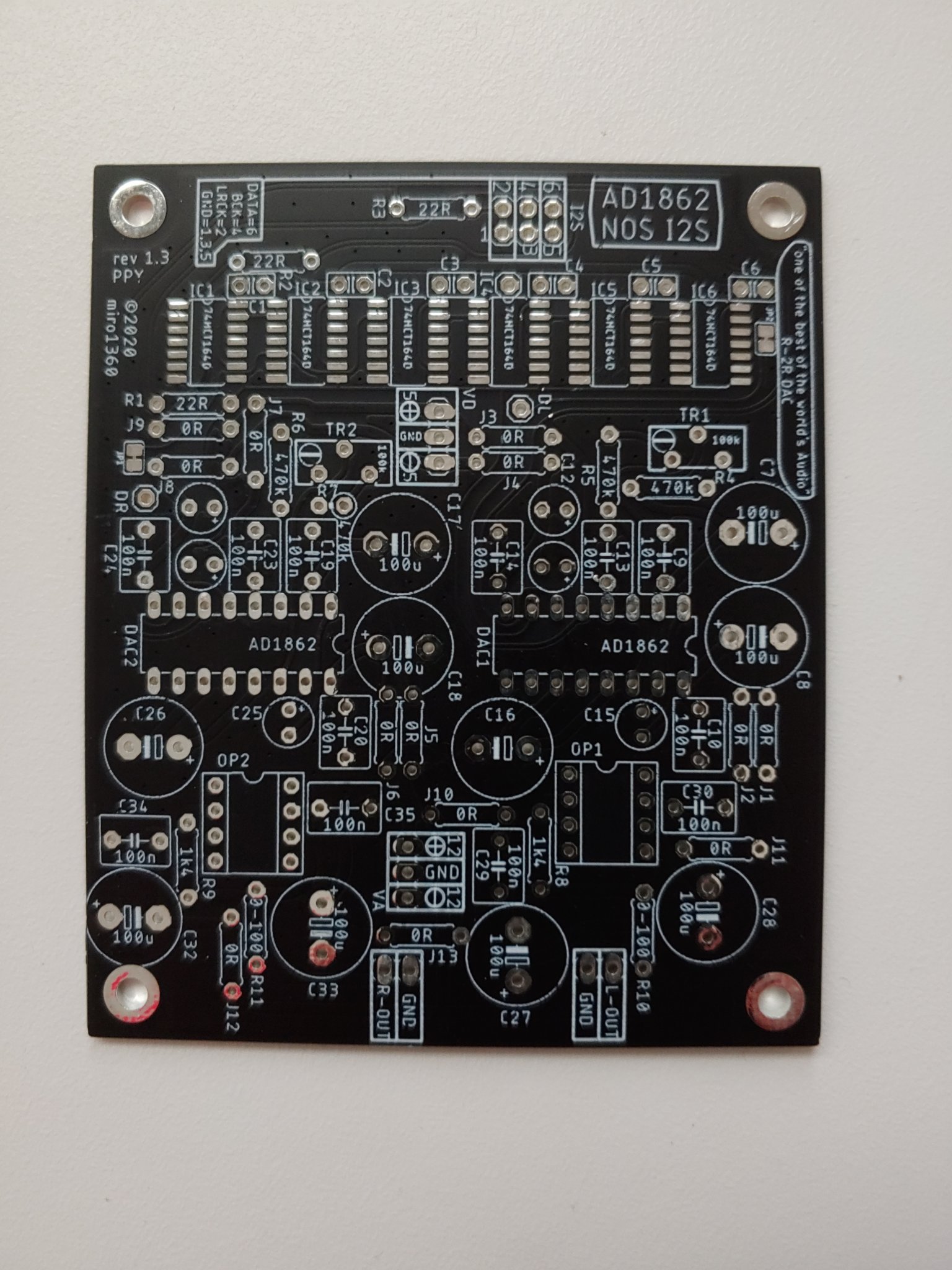

DAC AD1862: Almost THT, I2S input, NOS, R-2R

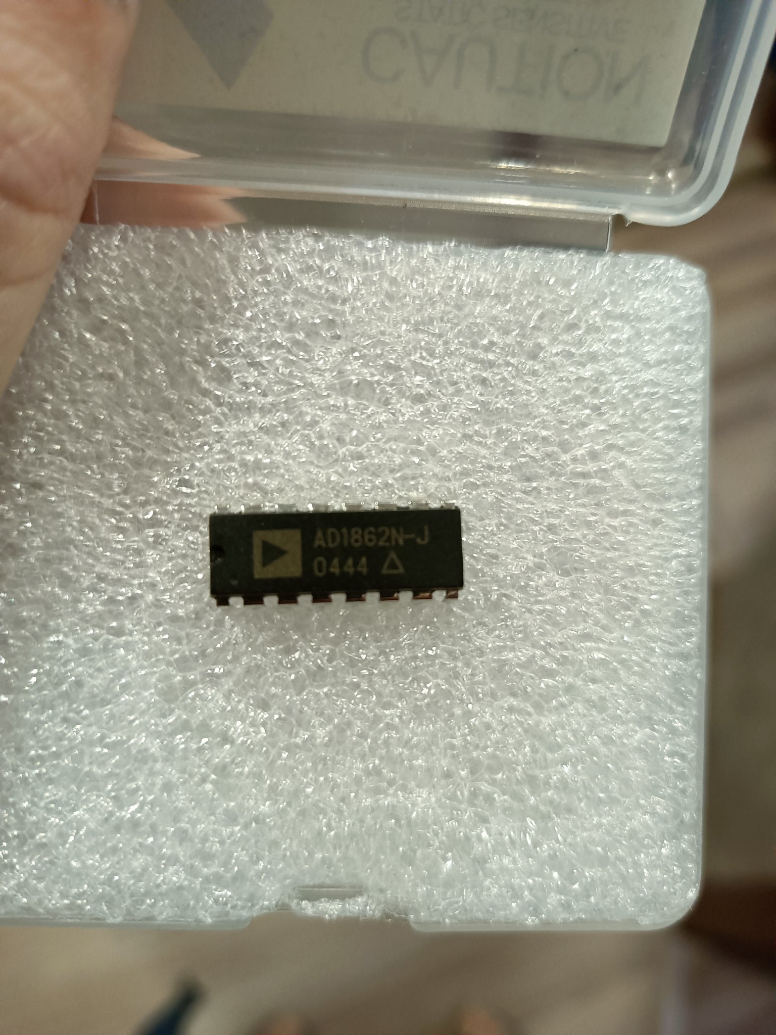

I got a chip but he's dead also.
I don't know it is original or fake. I only saw a few photos on internet.

You can do that from flip-flops, but you must generate the LRCK directly from the master clock (like the HC4040 does) ... it divide the MCLK (or presious crystal clock) directly and generates the proper LRCK.
If you are referring the old (jittered) LRCK for generating new LRCK through flip-flop, you will get jittered LRCK because one flip-flop works only like a valve controlled by the MCLK (if jitter in old LRCK is larger than one MCLK cycle, it will be transfered to the new LRCK --- that is why you need the clean generation based on division instead of referencing the old LRCK).
Wow, larger jitter than MCLK, OK that is a case I never thought of! Does this really happen...?

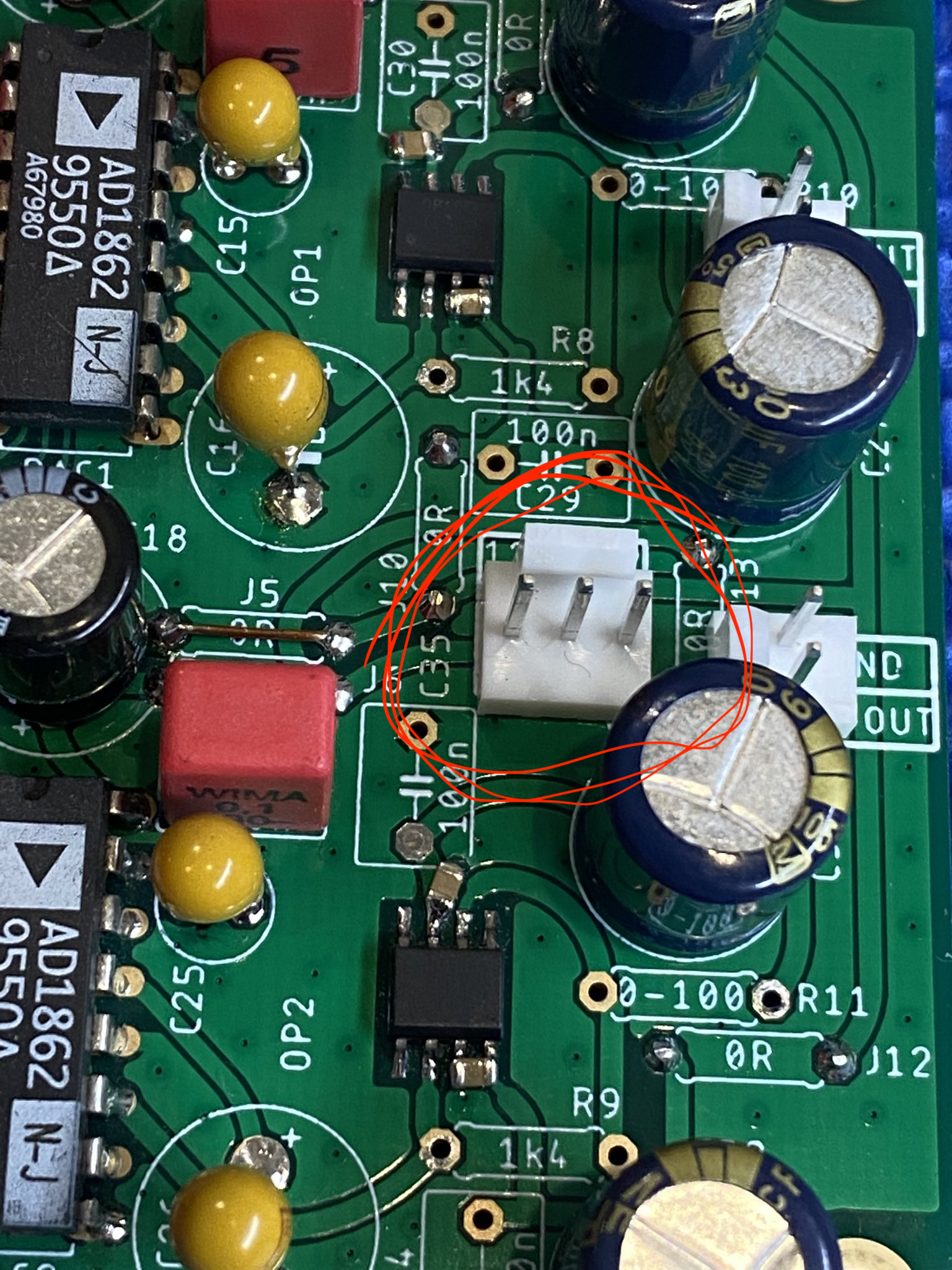

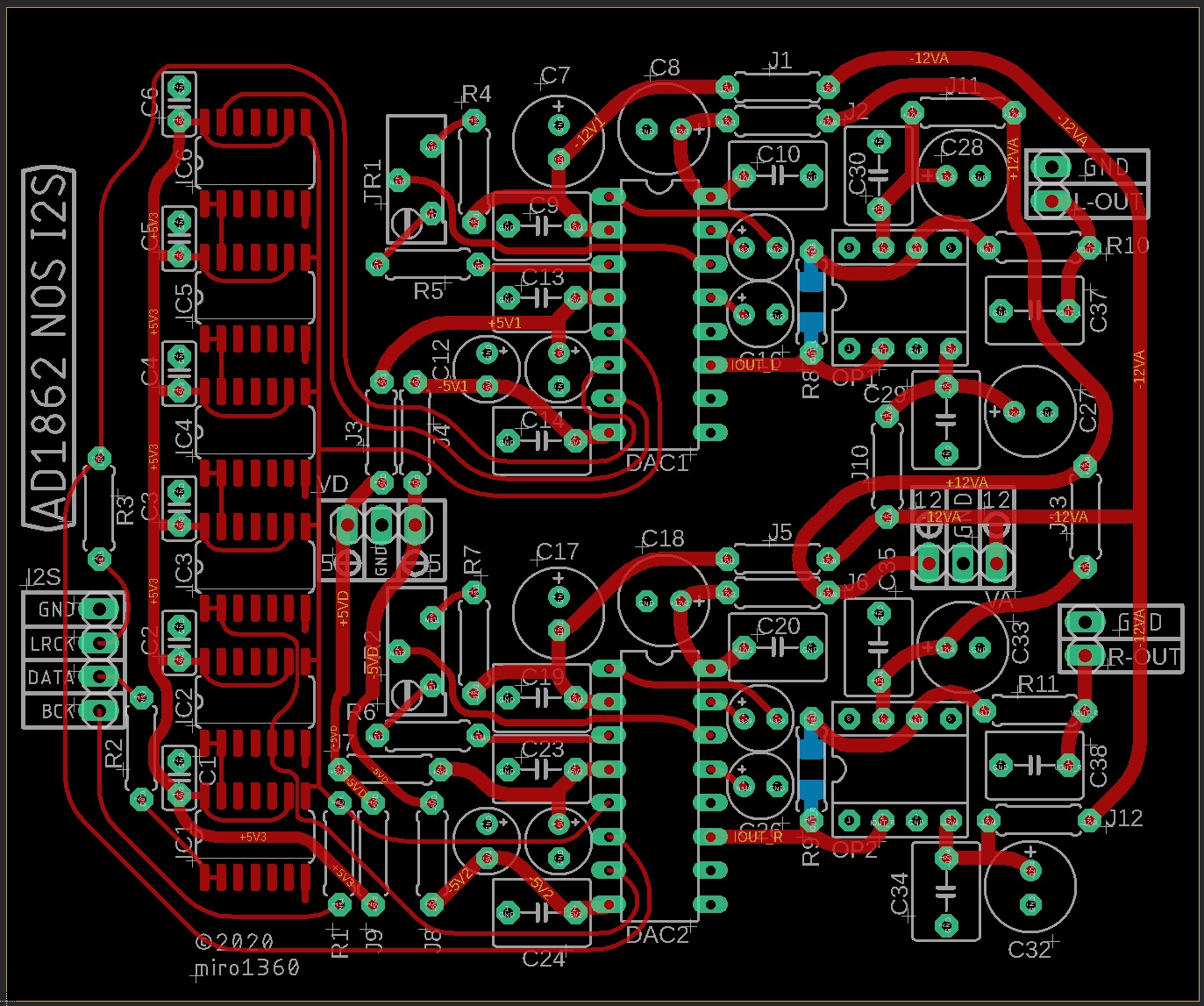

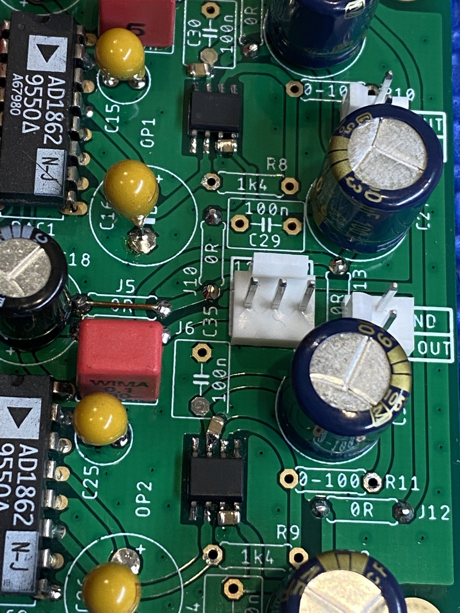

Yep, I find the decoupling of this one the best of all. The output of the chip to the oap is also straigth forward and the decoupling cap 47 uF filter is near from the pin chip which is (theorically speaking) important. On the oap both 0.1 uF are close the power pins (permitt a hack a la Vunce with smd cap or mine with a little wire to the gnd via with 0805 CDE FCA 0.1/16V ). And this 2.5 mm pitch for the oap lythics 🙂 and the gnd pins of the lythic and the mkp very close 🙂 .
But for me ufl pads and close I2S source evem more important so I would like to test the jlsound stacked or direct ufl pcm option with 2" uf-l wire. Just curiosity as I will not do a JPLCB order to fullfill this curiosity.

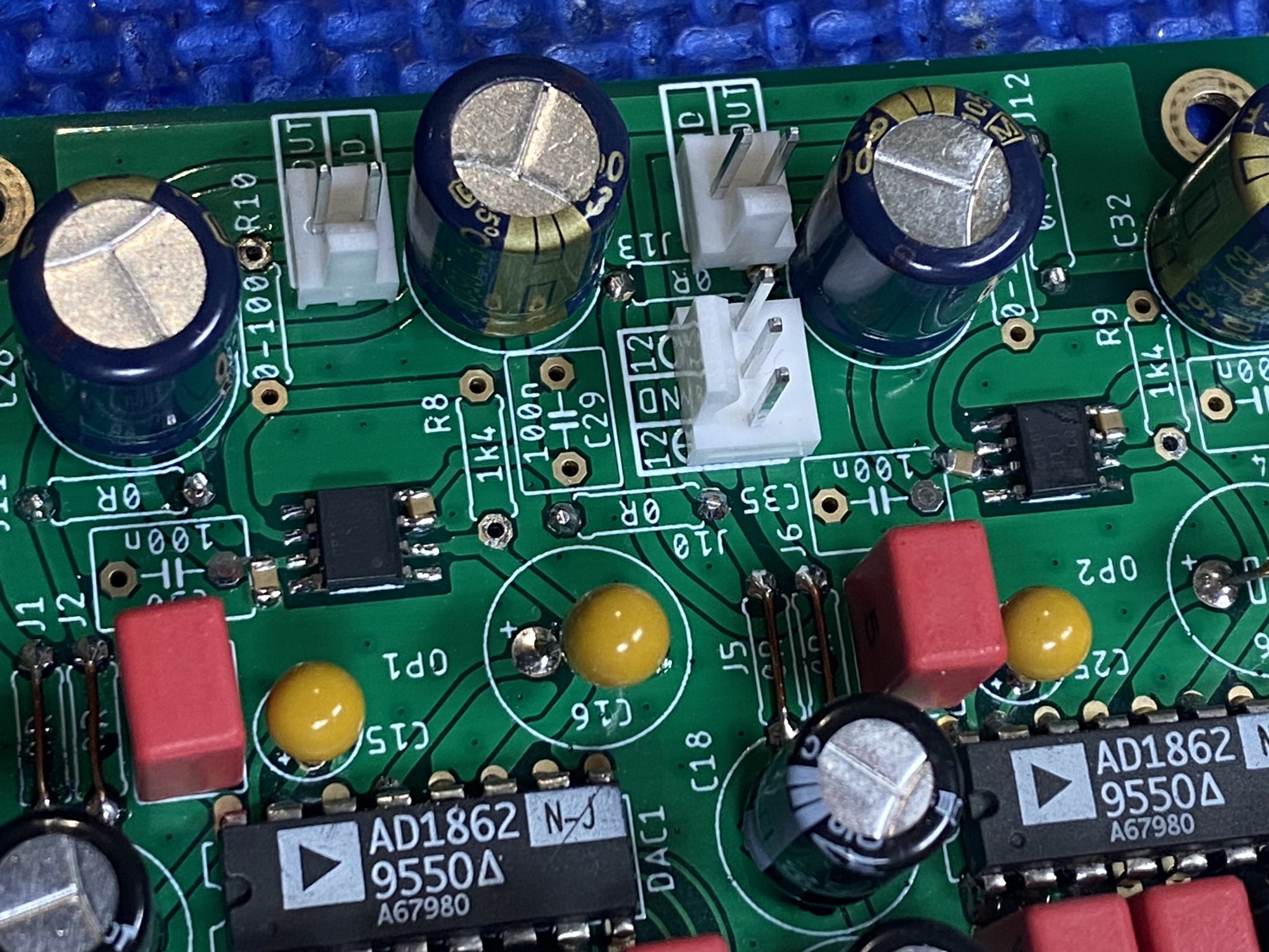

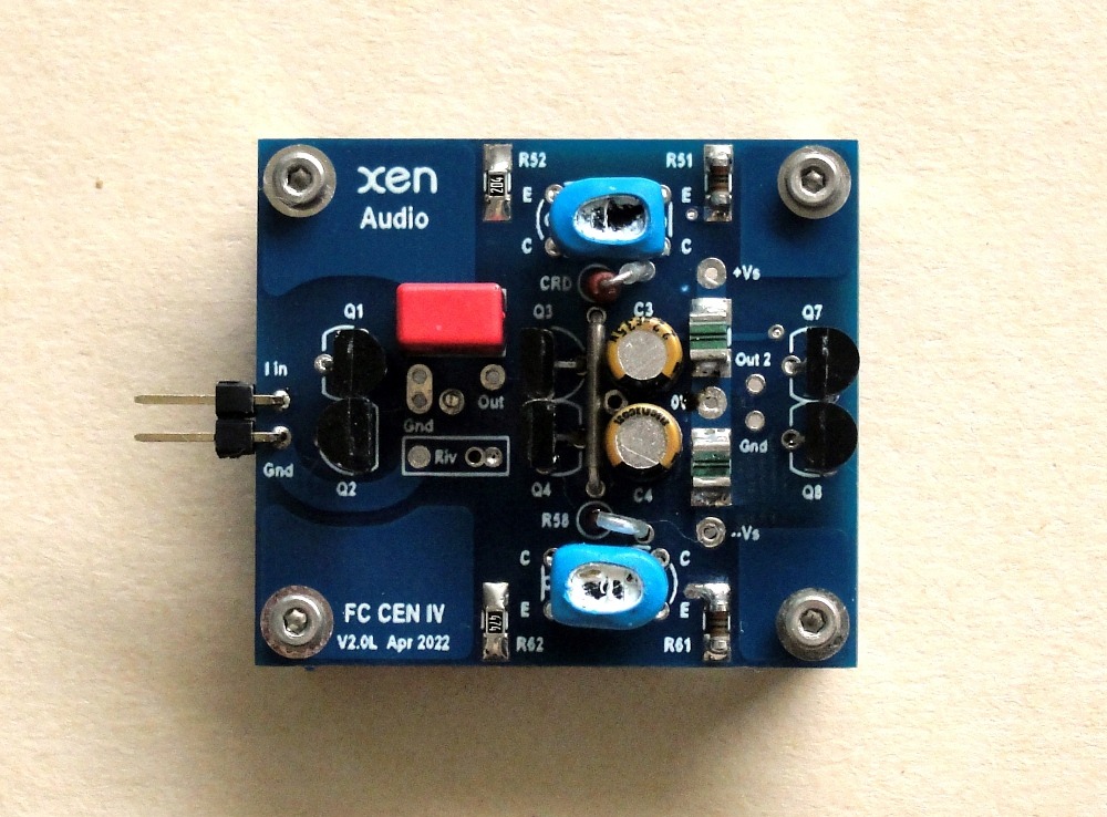

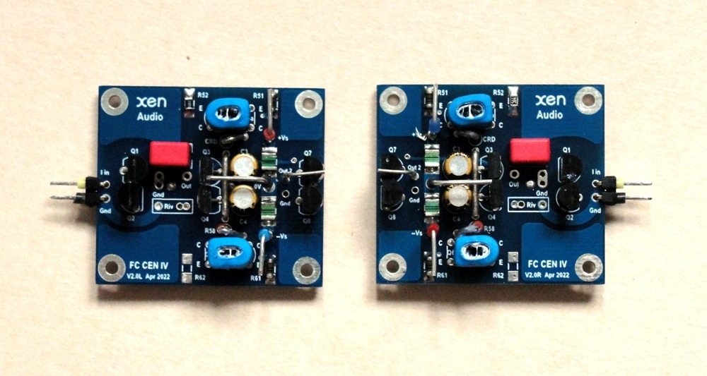

Through hole Version 2.
DC stable to +/-3mV, which is equivalent to +/-1µA with 3k Riv.
And that is with a total bias of 35mA.
Beta tester already lined up.
Publication only follows thereafter.
Patrick
A cool tht for papies 🙂 . Zetex bjt ?. Damit... 22 uF Nich FW ? Better something else cap...of course my pref only.
Vunce Hack 🤣
Well done...C29 mkp is indeed a little too far according some oaps... but the mkp vias could still serve with a higher 1 uF mkp or a SAL lythic or as well a solid modern tantalum... ears and the system one has having being the final judge...no universal solution as usual. But definitly a good idea than ceramic for the HF decoupling very close of the pin with 0603 casing 🙂
Tantalum are not today those we used 15 or 30 years ago. They are also solid tantalum that not fire easilier. Reverse voltage still a problem though as lythics btw. I do no like too much them for analog, after all still a tantalum kathode. But each hifi syst is different and they can help sometimes.
Fca caps as SAL are not tantalums. In my syst Fw has a soft veil that soft everything and has not real transparency...Ymmv as you said. But the Nich ES for direct DC coupling I do not give some credit to Nichicon as far the sound is the first factor. But I like their gold letters on casings...
I like though the acrylic pen cap on your board though.
