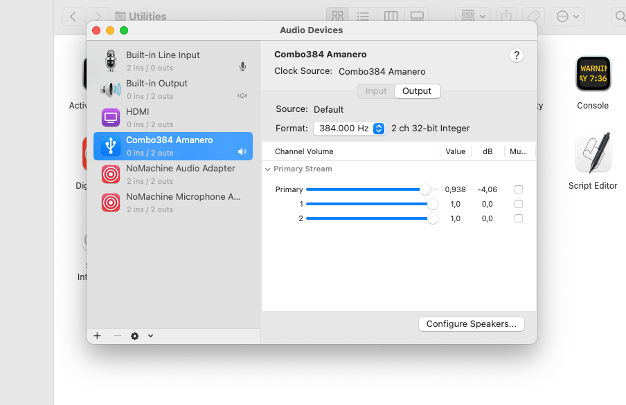

Thanks. I have observed a lot of unexpected behaviors from these DAC chips like TDA1541 doesn't like the USB signal from an IPAD USB port, AD1862 doesn't like the signal which is 24bit and higher than 96 KHZ, in both cases the USB interface remains Amanero with upgraded crystals and to get a better output from AD1865 DAC one needs to set the gain resistor to above 1.5k, these are just to name a few.
The AD1865˛&PCM63 works both at pure 24bit 384kHz, and the AD1862 works only at 24bit 192kHz, at 384k it has an undertone. Both with the same PS and same JLS card via shift registers. I don't think it matters, I'm just saying. :cool:
It works 32bit here on MacOS - DSD is written on the display :ROFLMAO:

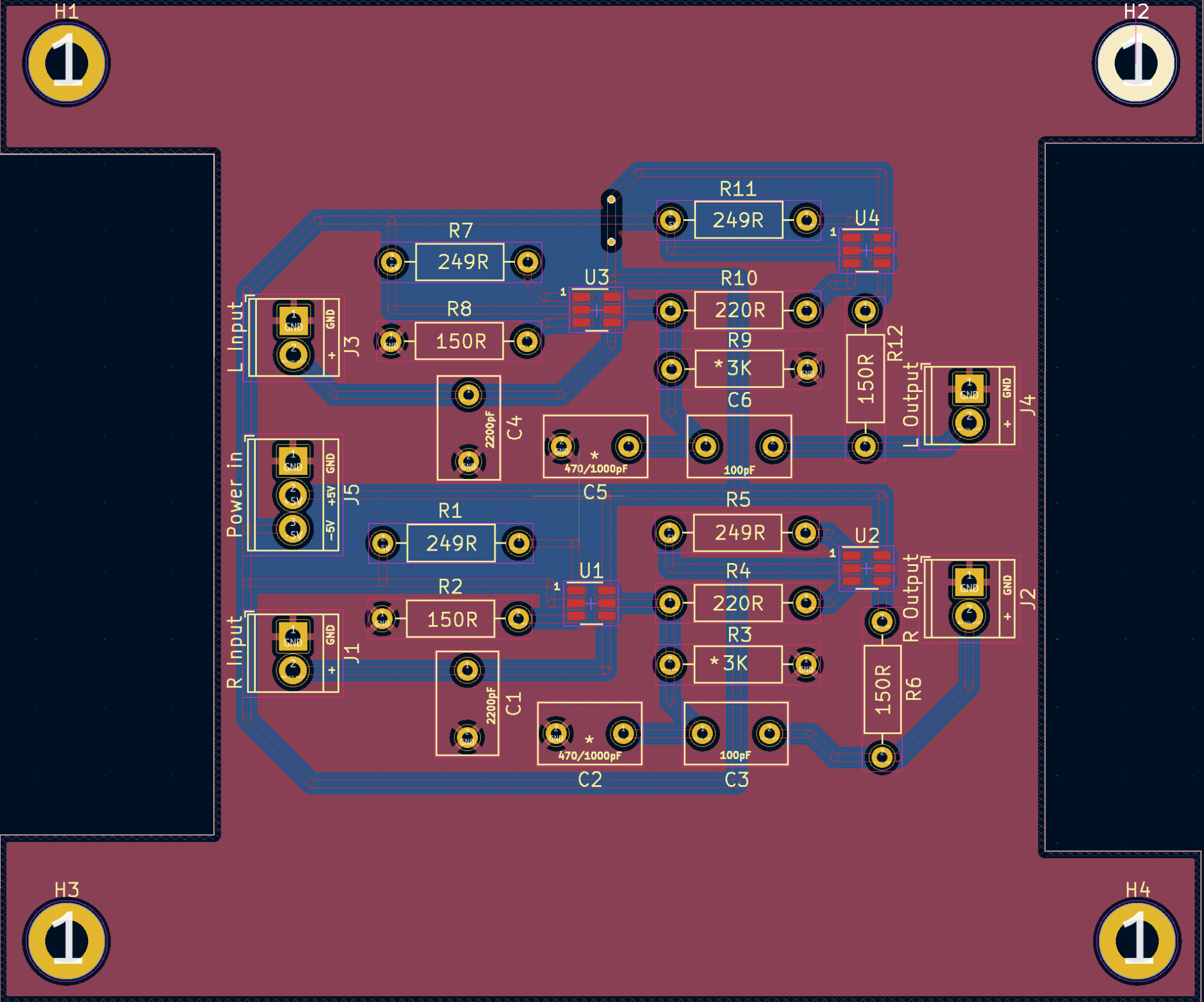

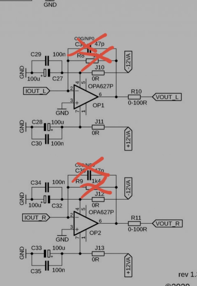

Planning on building the opa861 based i/v for my ad1862 proposed by crymen. Do I just hook the L and R outputs of the ad1862 board to the inputs of the I/V board then the outputs of the I/V board to the RCA terminals? Then just leave the dip8 unpopulated on the ad1862 dac board? Do I need to remove any resistors or capacitors around the Dip8 socket?
