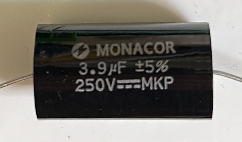

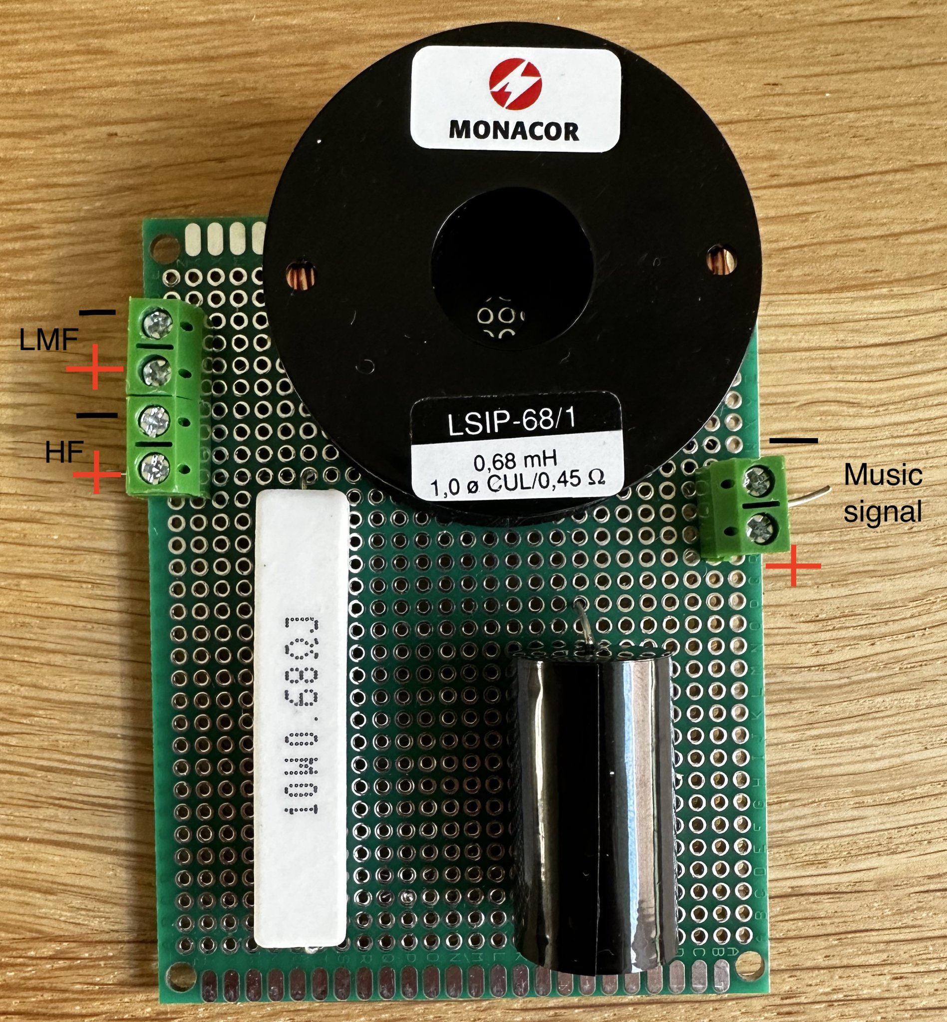

Hi there, I'm another owner of a set of non-working X300A speakers. I tried to create the crossover filter based on the information in this thread and I'm having some issues after completing the first speaker. At first, only the tweeter was working on a really low volume. I was pretty sure I connected everything correct, but after some basic troubleshooting (different amp, different cables, checking the crossover filter again etc.) I tried switching the woofer and tweeter connections on the filter. Volume is better now, but the speaker is really lacking bass.
Components I used for the crossover filter:
Inductor: https://www.conrad.nl/nl/p/monacor-lsip-68-1-luidsprekerluchtspoel-1331929.html
Capacitor: https://www.conrad.nl/nl/p/monacor-mkpa-39-luidsprekercondensator-1332094.html
Resistor: https://www.ruttenelektroshop.nl/product/rf0e68-weerstand-10w-068-ohm/
I'm not really sure how to proceed with troubleshooting at this point. I hope someone is able to point me in the right direction..
Check your crossover carefully to ensure that the inductor is in series with the woofer and that the capacitor and resistor combination is in series with the tweeter.
You may have to post images of your crossover construction, making it clear which pairs of wires go to the amplifier, to the woofer and to the tweeter.
Please verify the values of the inductor and capacitor you have bought, as I can't read their links.
In case further troubleshooting is required, do you have a multimeter?

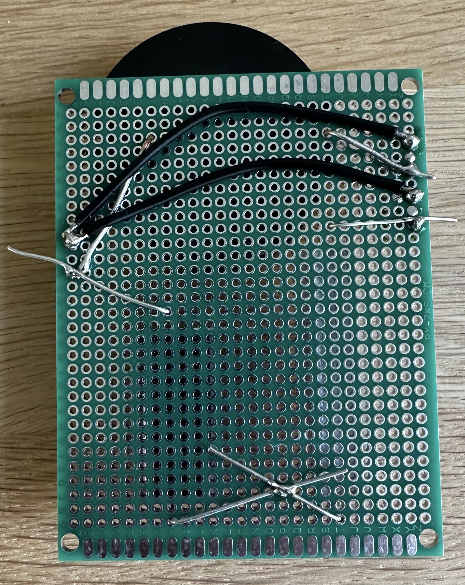

See attached photos. I rarely use a soldering iron, so it might look a little rough. But all the joints seem to make contact. I do have a multimeter if needed.

Do some tracing of the signal pathways for me, as I'm easily confused. ;)
Here are the pathways you should have:
Woofer section
Signal Out: amplifier positive to inductor to woofer positive
Signal Return: woofer negative to amplifier negative
Tweeter section
Signal Out: amplifier positive to capacitor to resistor to tweeter negative
Signal Return: tweeter positive to amplifier negative
Oh my, now I feel bad. I did not notice the reverse polarity for the tweeter in the crossover schematic you posted. I basically used the '2 way 1st order XO.gif' image posted somewhere in the thread while soldering (which has amp positive going to tweeter positive if I understand it correctly).
Just did a test by reversing the tweeter wire ends on the HF side of the terminal and I now have a fully functional speaker :D
I am really really happy with the result. I recently brought the speakers to the shop where I bought them a long time ago. They were deemed irrepairable (at least for a reasonable price) and the alternative they had on sale was significantly higher priced (I think it was the LS50 Wireless II?). Now I will be able to enjoy this set for some more time.
Thanks a lot for helping out Galu!
