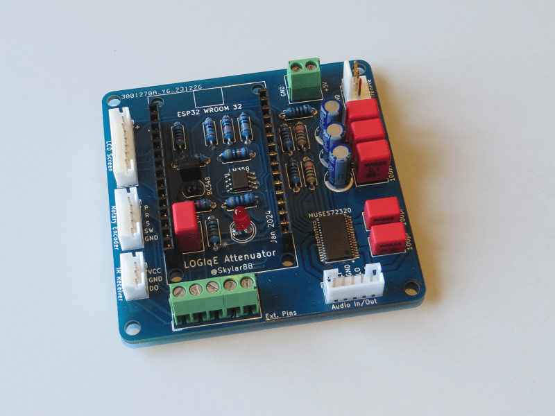

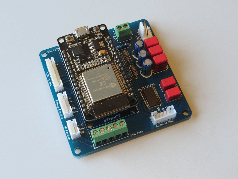

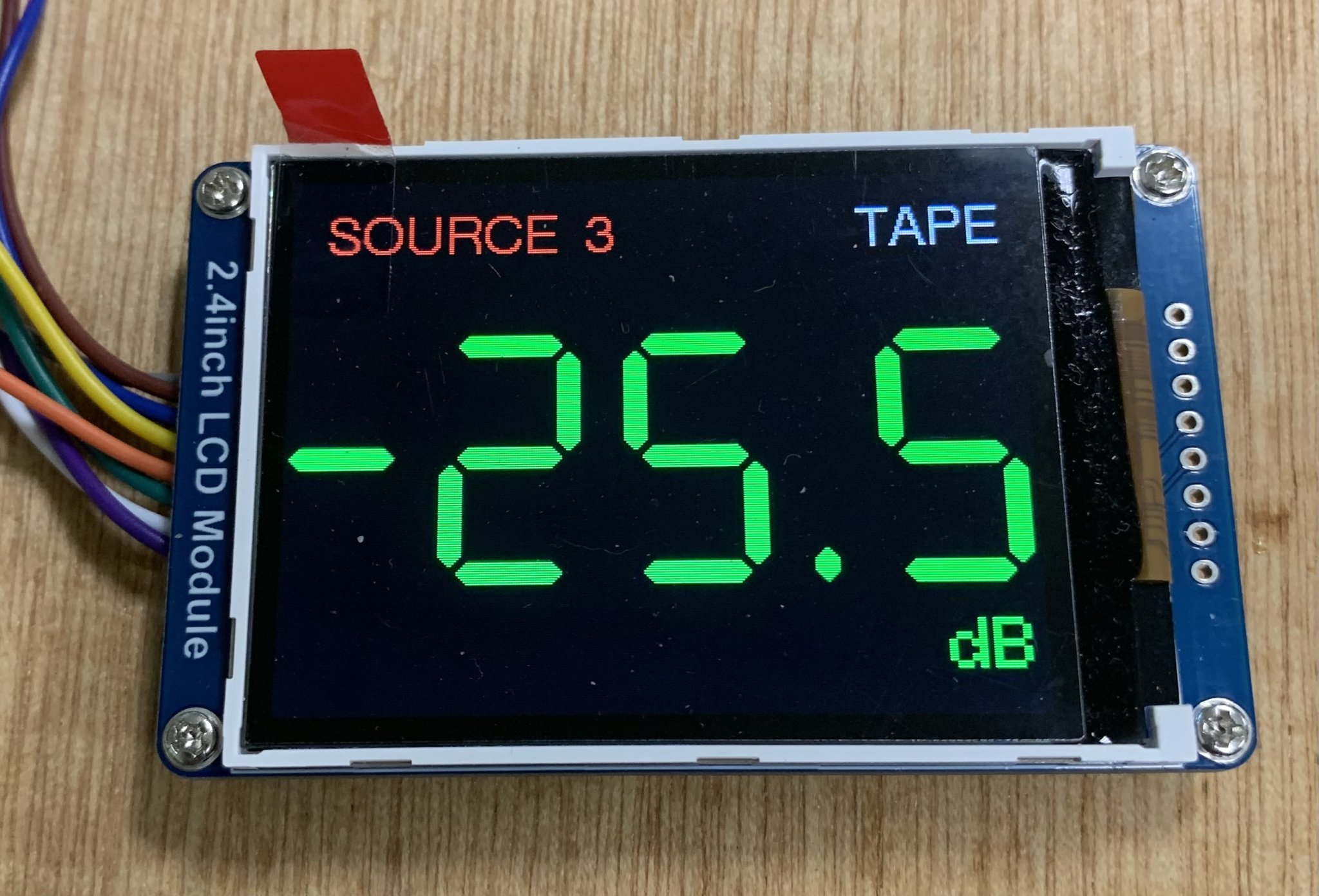

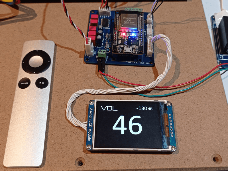

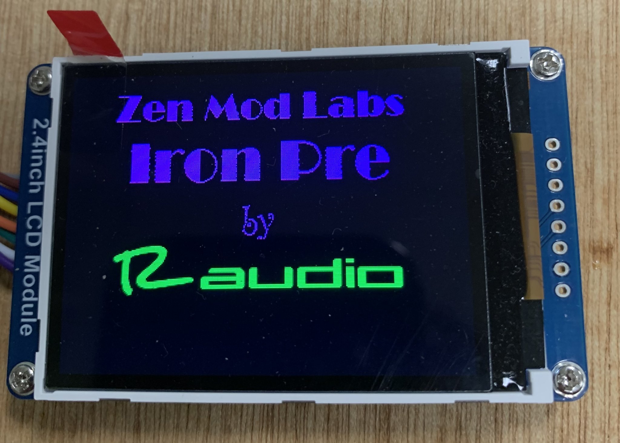

I'm happy to announce that my Muses board has also been completed and working as expected. From the outset, I aimed for a high-res LCD screen because I like smooth fonts without jagged edges. That necessitated an MCU with enough memory and speed to accommodate the big font files. An ESP32 WROOM was used and the beauty of that MCU is that it can be programmed via the Arduino IDE, is very fast, has plenty of memory and it's really cheap.

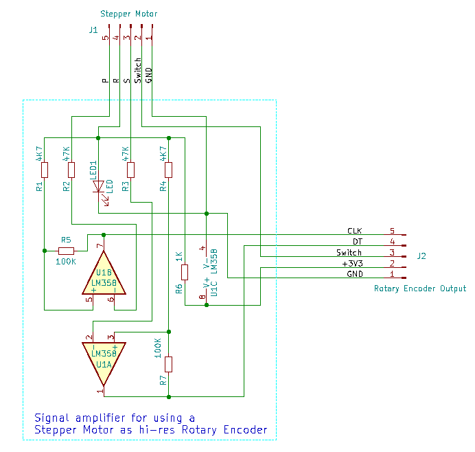

My board houses both the Muses chip and ESP32 MCU, so no external connection between the two is necessary. There is also an amplifier for a stepper encoder with its components hiding below the plug-in MCU. I really like the precision and tactile feel of the stepper encoder compared to the rough click-clack feel of an average rotary encoder. It adds a luxurious touch to the whole attenuator concept. And I didn't even have to buy the stepper motor. It's from an old Teac Floppy drive. A micro switch will be mounted behind the stepper motor to provide a push switch action for selecting different menus, etc.
At this stage, the firmware is proprietary as I'm still refining it, although it's already working very well. There are a few enhancements that I will be concentrating on now that the hardware has been sorted out. I may make flashed MCU's available later. Still deciding what the best way will be to make my solution, which I call the LOGIqE Attenuator, available to others. Sharing the code may be problematic, because it's using so many libraries and font files, that it requires a properly set-up environment to compile.

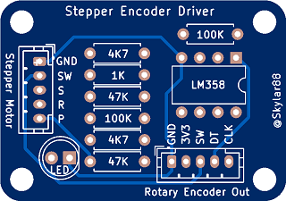

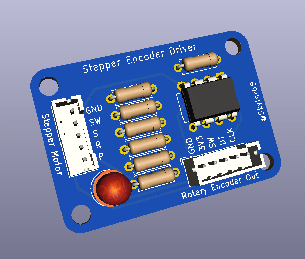

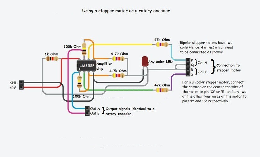

Stepper Encoder Driver
OK, here you go. It's a very simple circuit. Everything you need to know is explained in the attached PDF, but I'll post some stuff here for quick reference.
The board is 28mm x 40mm.

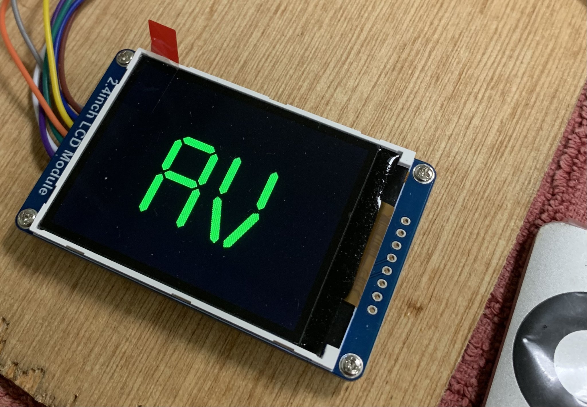

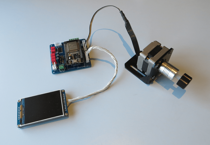

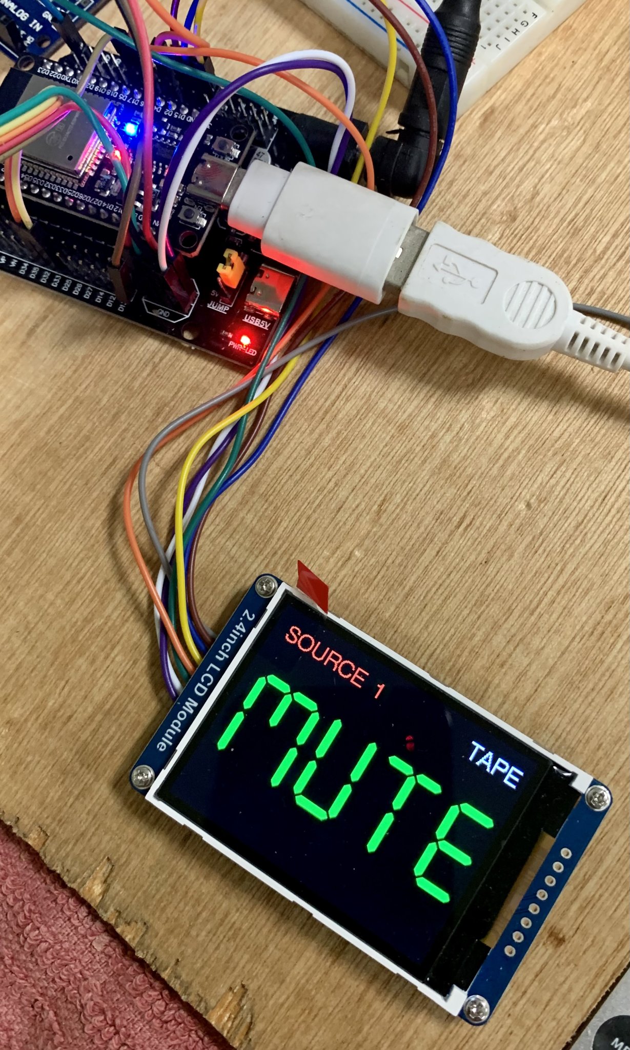

Finally got the ESP32/Waveshare that @Skylar88 so highly recommended prised out of the hands of the customs mafia. He’s right, after the learning curve there’s no going back to the Arduino. Even the learning curve isn’t an issue - well supported online. So, thanks for that enthusiastic endorsement @Skylar88.
And thanks, @jpk73 for that nice debounce library!
A few shots of progress - definitely not the finished article but…fun!

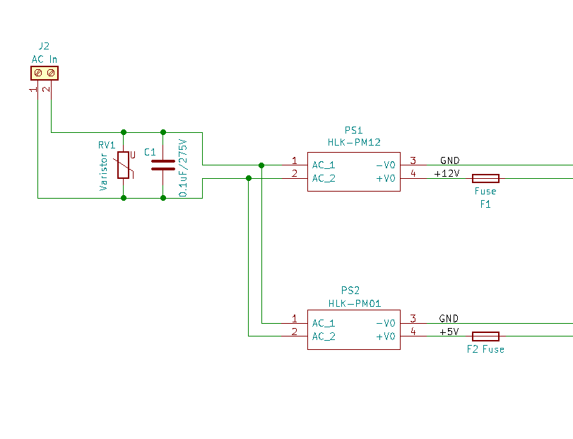

I'm busy designing a power supply board for the MCU controlling the Muses board and the input relays of the Iron Pre. It will use 2x Hi-Link smps - one 5V for the MCU and one 12V for the relays.
I've had the whole IronPre setup, including Muses and MCU measured with a PA analyzer and it measures OK without any kind of filter, but I would like to add some kind of filter in front of the two smps, just to help me sleep better, and while I'm designing the board. I've come up with a simple "filter" consisting of a 0.1uF/275V cap as well as a TC73 thermal fuse for each of the smps. There is also a MOV (Bourns MOV-10D561K). (see diagram below)
Would anyone care to comment on my choice of filter, or make suggestions? Please keep in mind that the AP measurements were already quite acceptable without a filter.
Edit: I had originally planned to use an AmyAlice filter, but given the clean AP measurements, I don't see a need for it.
