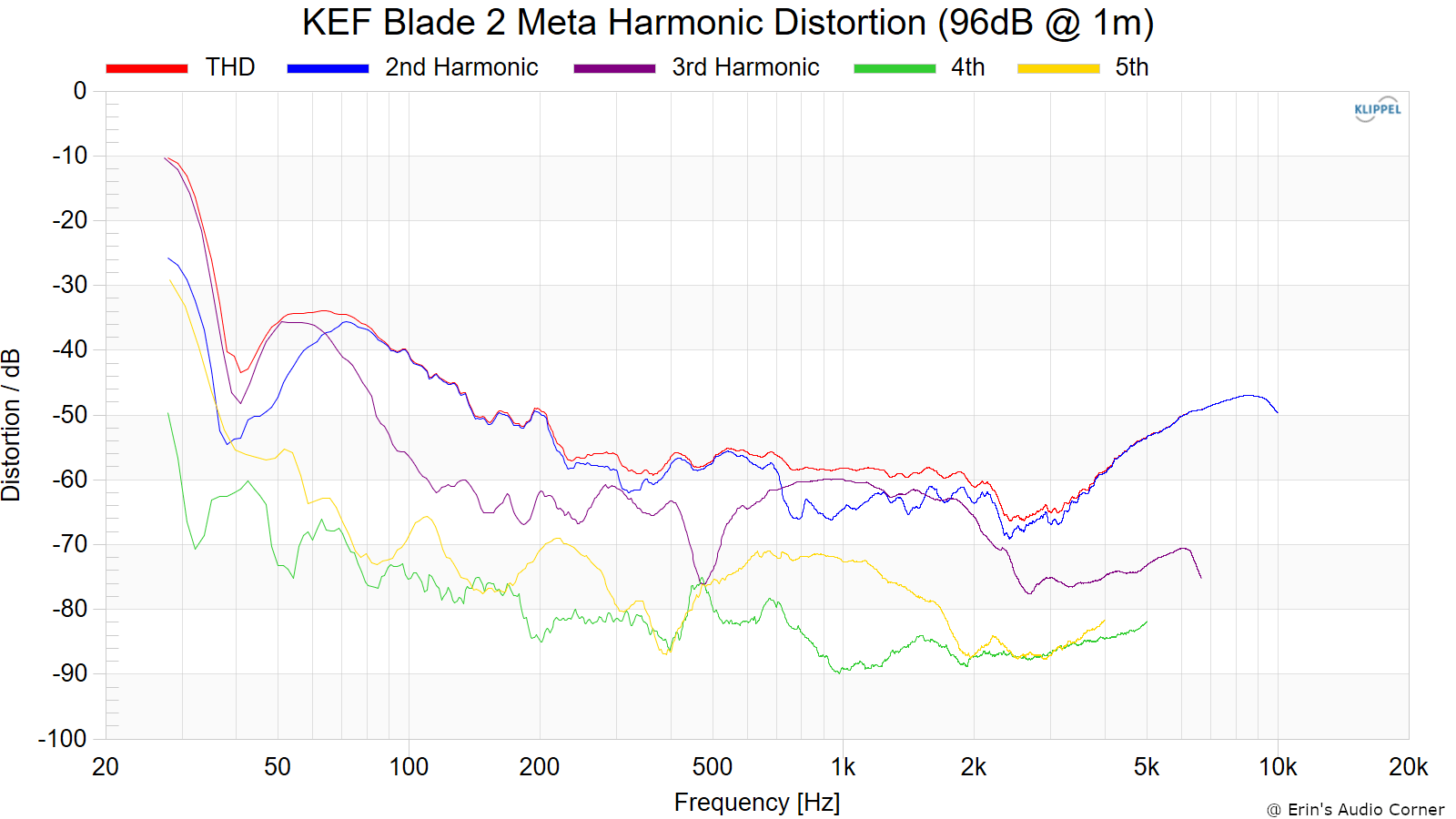

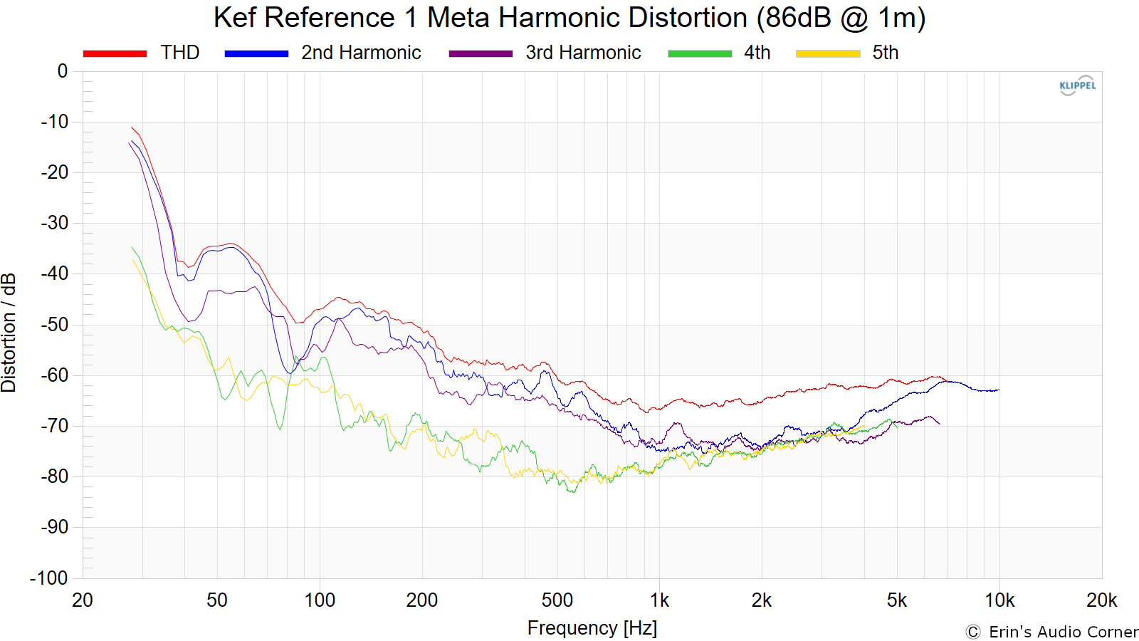

What's interesting is that it answers a question that is posed on sometimes- what happens when we use multiple woofers.

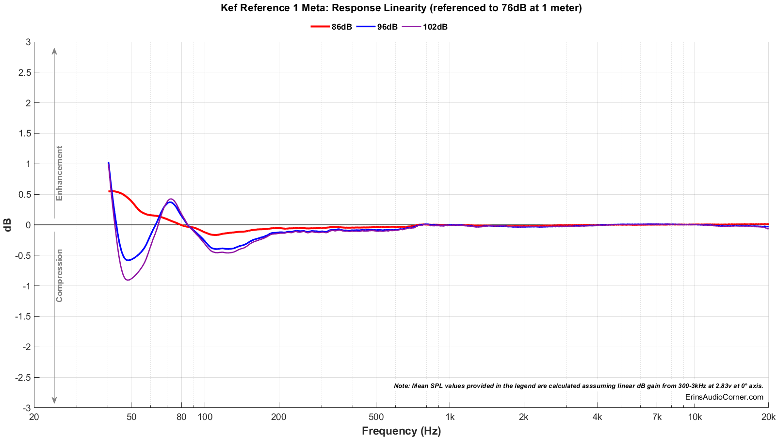

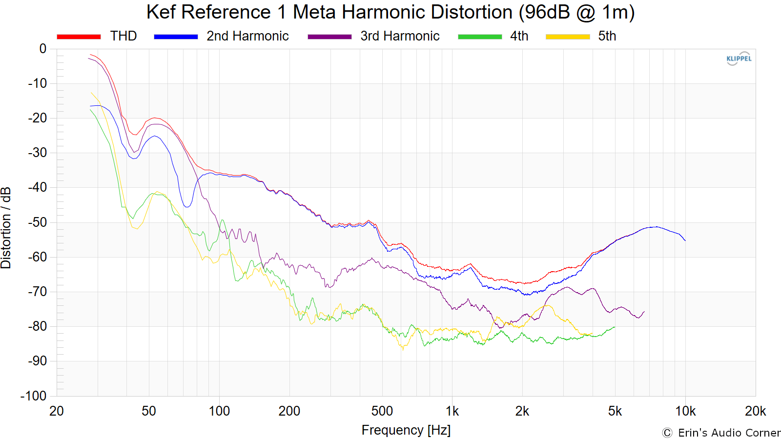

Here's the Reference 1 Meta, which uses a single 6.5" woofer.

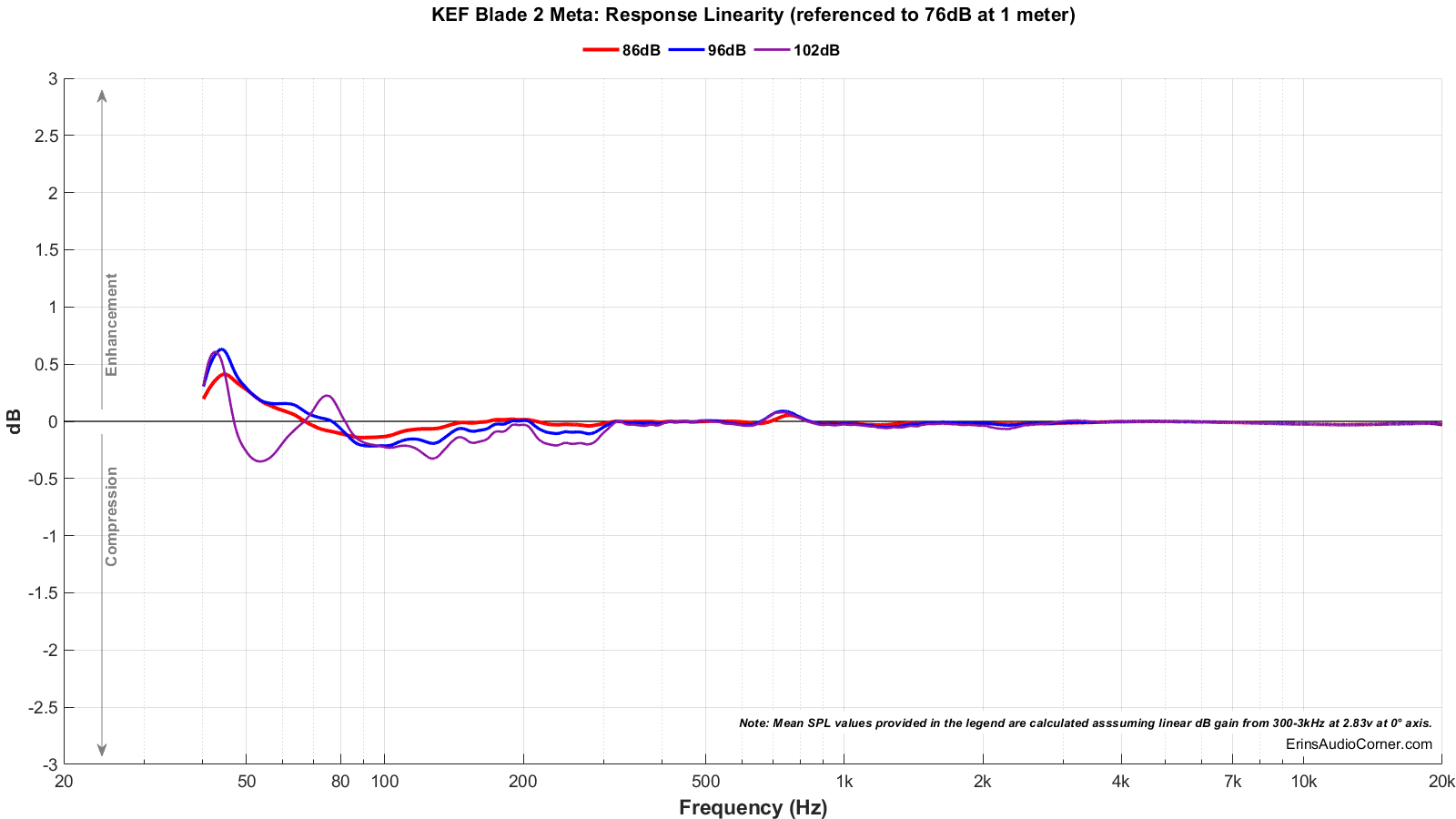

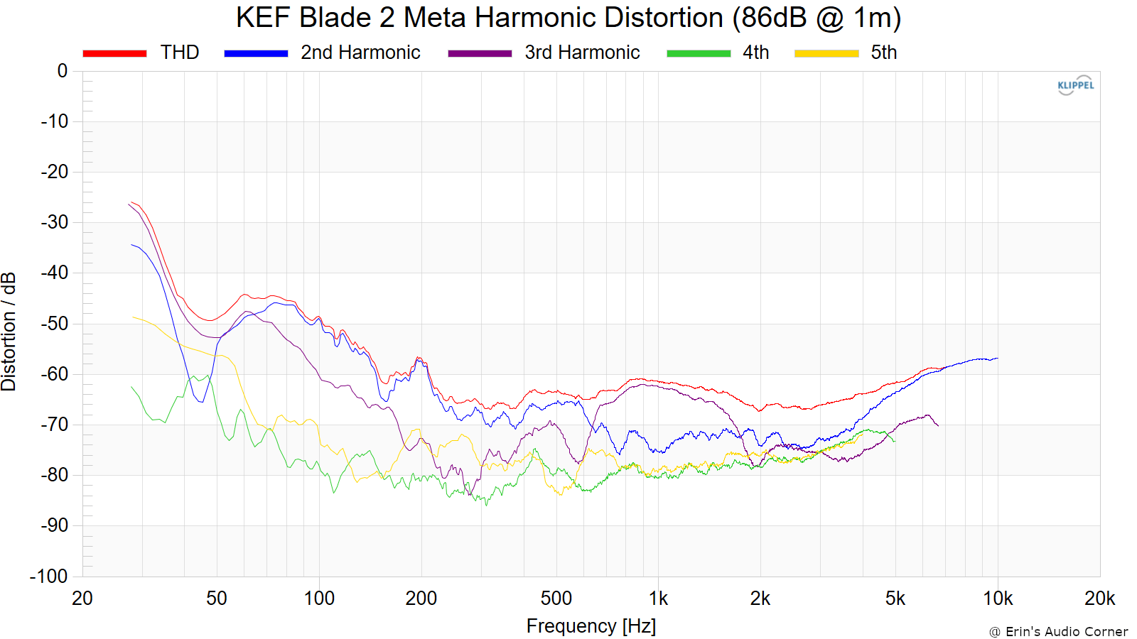

Here's the Blade 2 Meta, which uses FOUR 6.5" woofers.
Now what happens at 96dB @1m.
Again, first the Reference 1 Meta:
Blade 2 Meta:
Let's also look at the dynamic range compression tests:
The Reference 1 Meta:
Blade 2 Meta:

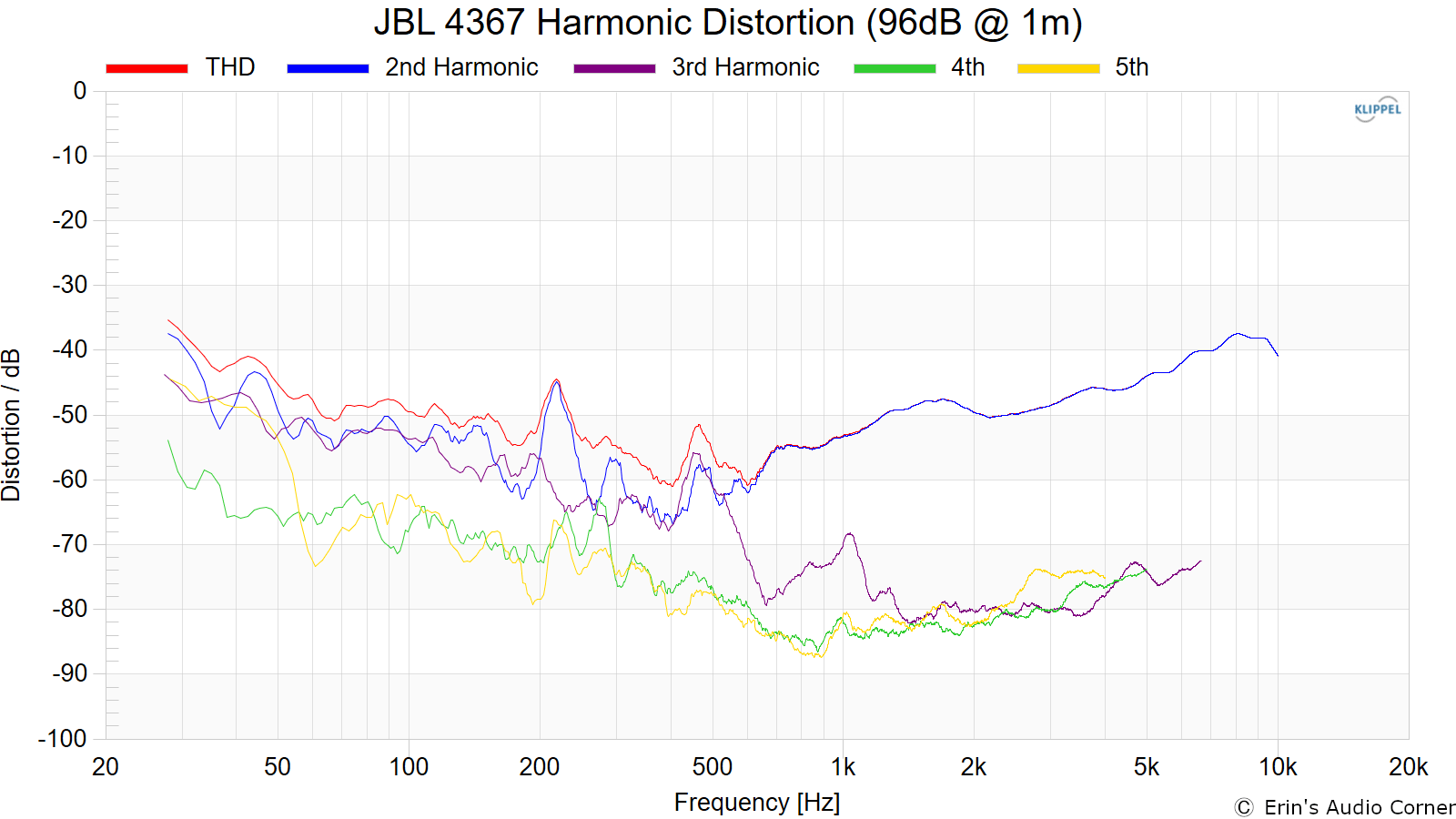

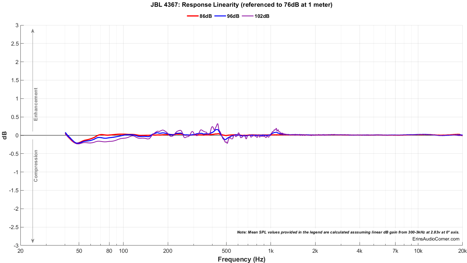

How does this compare to a single large woofer?
Here's the JBL 4367, with a single 15" woofer...
www.erinsaudiocorner.com is a treasure trove of hard data like this, and if someone wanted to do a study to see if there was a correlation between distortion and dynamic range compression, there are almost 200 speakers on that website...

The 2216nd woofer uses a special VC wire that reduces resistance low TCR and reduces power compression. It also has dual 3" edge wound coils. You might want to look for a more conventional 15" driver to use as a comparison. It's an exception not the norm.

In my humble opinion, it is about the size. With the size comes lower distortion.
See, small woofer will have higher distortion, even if you use multiples of them. Multiples of crappy woofers does not create better woofer.
